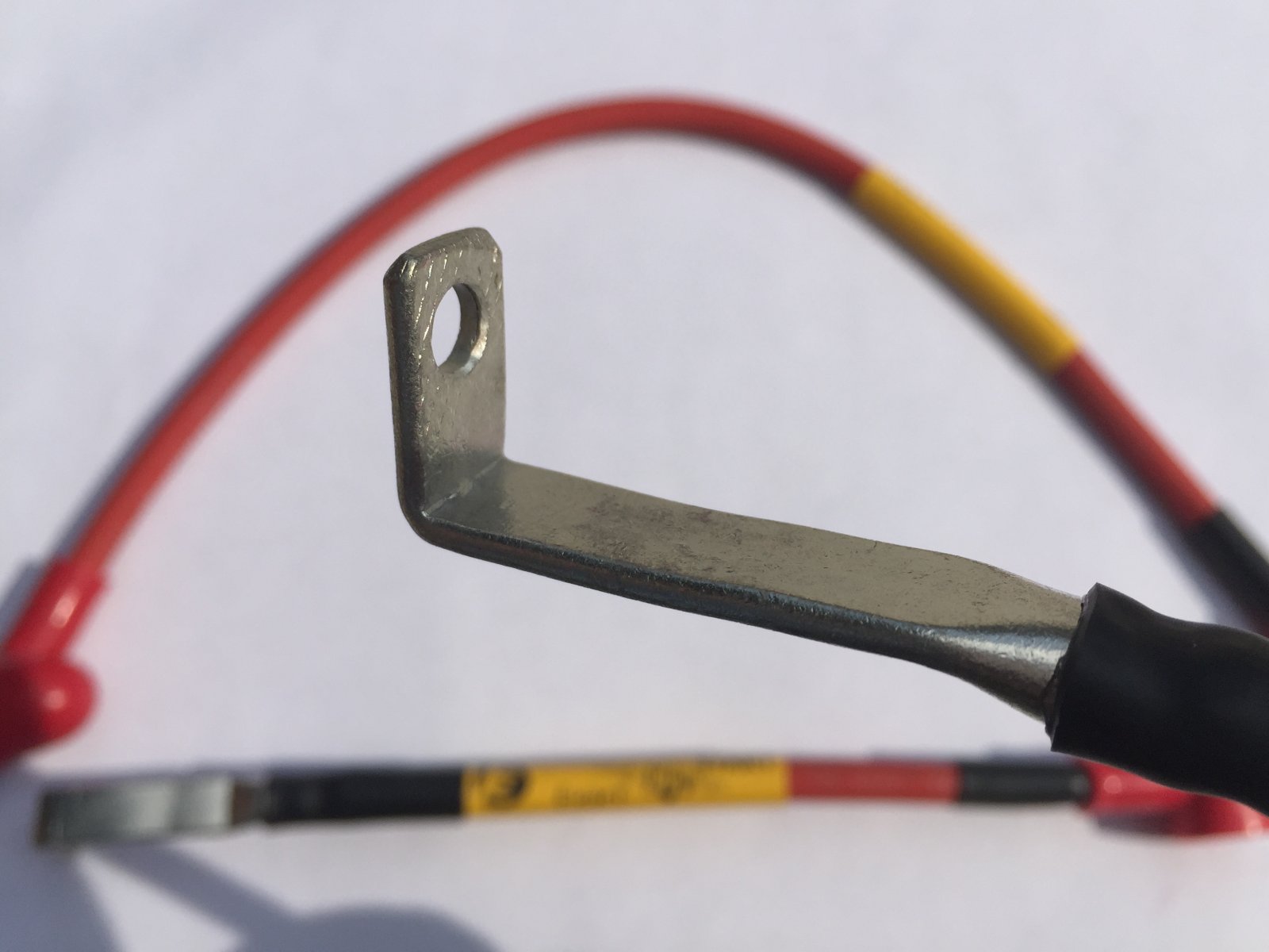

  12. Cable kit will cure any starting issues as long as there are no fundamental problems and you have a decent battery.
    It's amazing what a difference a less resistive set of starting cables makes...
    Talk to @Exige on here.
  13. I've never needed one but it can't hurt. Mind you, £80 for a crimped cable?!
  14. I paid a lot more than that for my American sourced cable kit by the time Id paid shipping, vat and import duty. Well worth it though for the instant starting I now get.
    80 quid? Bargain!
    Don't forget, it'll save your sprag clutch too.
  15. I just cleaned my original cables up with a fibreglass pencil and that made a world of difference to starting. And I'm running a big bored 996 with nearly 15:1 compression ratio.
  16. As I say, 10yrs without an issue on that front but I do understand the benefit. I just don't see the need for anything more complicated than a £10 one from Halfords. Apparently I'm thrifty!

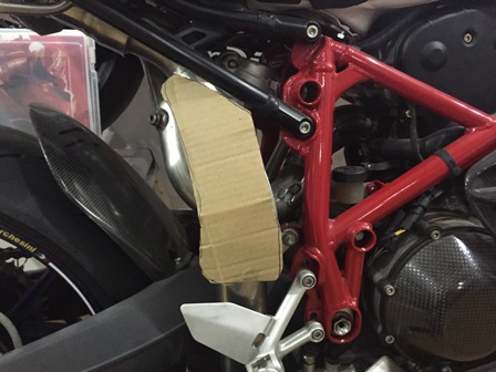

  17. I thought the same about the price of a carbon heat shield, so made one from cardboard but it just didn't seem to work too well - not sure why :(
    In all seriousness though, if you read the specs and realise they are bespoke tooled terminals and the best available - and only available due to them being developed specifically for a bespoke motorcycle that really deserves better than originally specified by the manufacturer.
    As a contact at Swedish Ducati Dealer who is looking at importing my cables suggested (for example) a 1098 sprag assembly is no longer available - you now need all the 1198 bits to convert when it goes: part cost $1000 and that doesn't include labour.
    Sure you can throw some cables together for less and some do (on many applications you will have to start hacking at the battery box to make them fit), but you are only doing what the OEM did in the first place. If you want the best possible, I have taken the trouble to develop it at my cost and brought a system to market that our bikes are worthy of - and as mentioned above, considerably better value (and better I feel) than the current USA systems.
