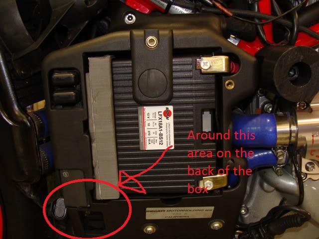

  2. :p guys i cant seem to find the relay and the bloody battery box doesnt come off.. there are cables ands tuff attached to it and its very hard to remove them all. can someone post a pic of their starter relay and where its located? if anyone has a pic of it of course

  4. you dont remove the wires.. you just pull the box and there should be enough slack on it to find the relay.
    the relay is at the bottom left corner as you look at the battery box.

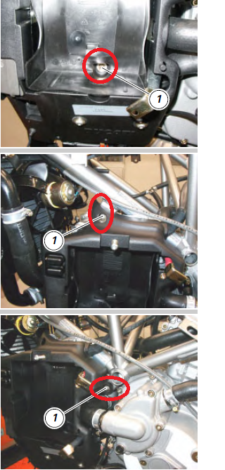

    Back on track.......There are 3 allen head bolts to remove. Taking the lead off the starter motor gives you a bit more slack to manoeuvre the battery box to get at the heat shield screws.
    Have you checked that your plugs? Plus tried the -ve jump lead? I would try these first before taking the battery box off.
