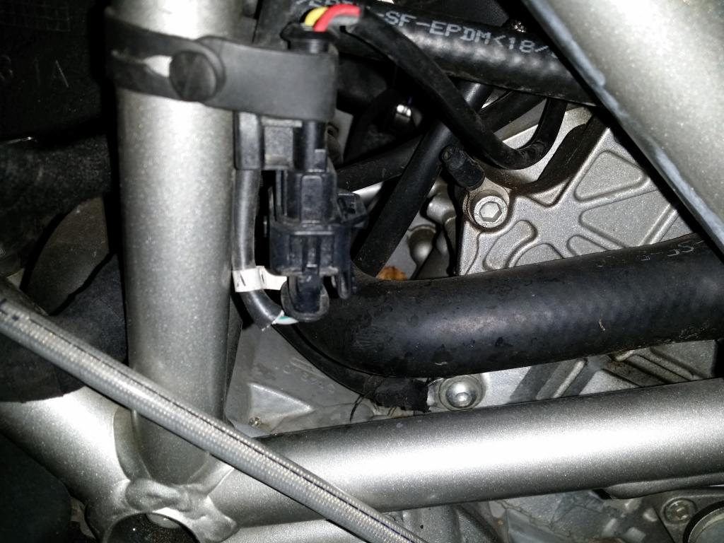

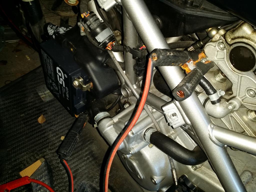

    but ie noticed my bike doesnt even have an earth wire? look at this pic. its been cut off, but in the workshop manual it shows there should be a wire running to that point.
    ive used a jump lead to act as an earth cable and the bike shows better progress... this time its like spluttering and coughing as if its about to start, but again, it doesnt start.
