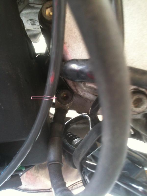

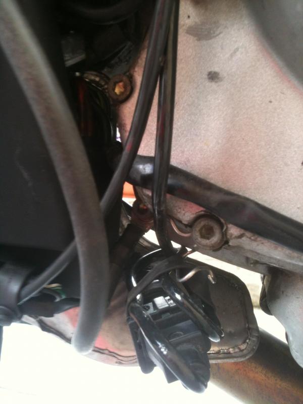

  2. Thats not good, and would definitely cause starting problems. Your starter cable may not have a very good connection, despite it's size. Do you have a length of cable you could make a quick lead from? Undo a case bolt, wrap the wire around it then and it back in so it has a good connection then fix it to the negative terminal and try again?

  3. I suspect the upper cable eye tag you show in the photo was once an ancillary item such as an alarm that has now been removed. Your bike wouldn't have ever ran without an earth to the frame/engine,certainly won't hurt to do what you are now doing with the extra earth cable to help though.

    that picture i showed you is the earth wire connection, as shown in the workshop manual, so either the previous owner moved the earth lead elsewhere and left that unconnected.. i dont knw, but it doesnt look right... i dont have any thick cabled lying about, so im gonna go to halfords tonight and buy some, connect it, and try again.

  8. Your earth lead is still in place

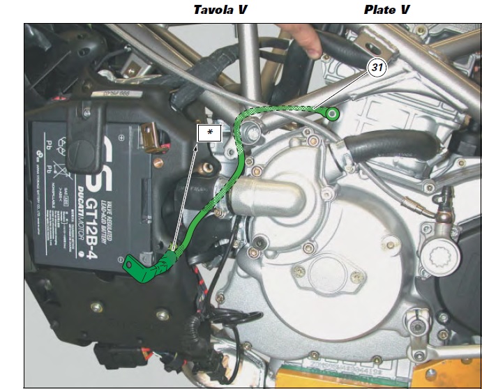

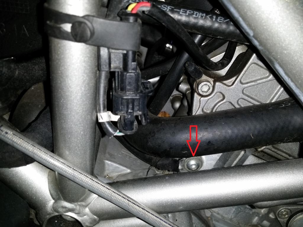

    The mod I have been recommending to people is to install an auxillary earth lead from the -ve terminal of the battery to the bolt of the starter motor (it has 3 but only one is visible). You can see the bolt if you look from the battery side towards the middle of the engine.

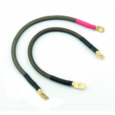

    Get yourself a pre-assembled lead from a motor factors for the job
