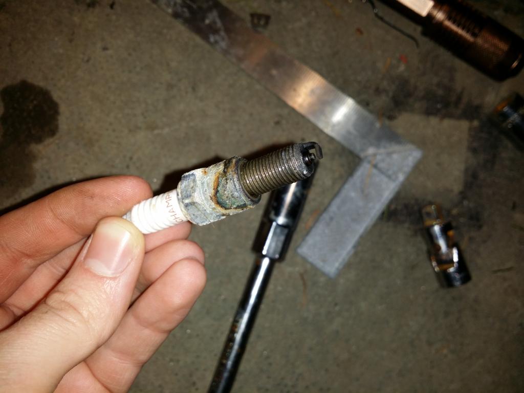

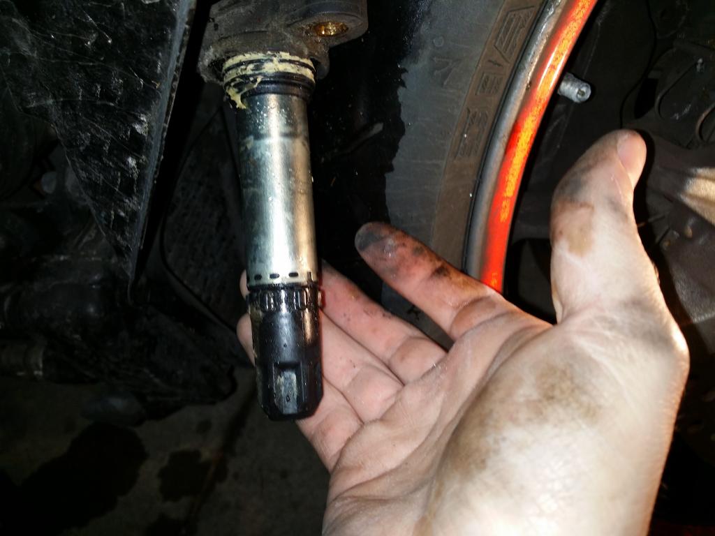

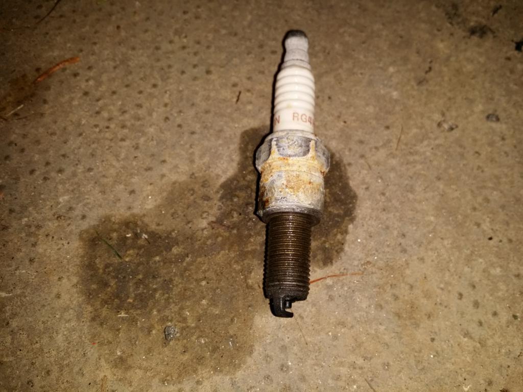

  15. well, i remvoed the horixaontal plug, and i have to say.... it looks likes its been fucked for a long long time, and me trying it and pusing it made it worse.
    as soon i took the coil out, it was wet, with white gunky build up at the seals.
    the plug itself.. well il let the picture do the honours.
    lucky for me, i have a spare set of plugs! next thing i will do, is check to see if the coils are good, by seing if there is spark.
    now, correct me if im wrong, but to check for spark all i have to do is, connect the new plug in the coil, and touch an earthing point with the plug i.e engine case bolt and crank it?
  16. and i forgot to mention that the plug whole was extremely wet! it was a mixure of fuel and water.

  18. In your first photo the stick coil has some grease around the top. This is an attempt to provide some sealing against moisture.
    The stick coil can be taken apart, just pull and twist the black bottom part whilst holding the metal part- BUT- make sure you don't loose the small spring inside who's purpose it to make an electrical connection with the threaded tip of the spark plug. Clean everthing up with a clean dry cloth and spray liberally with WD 40 or similar to complete the job.
    Plug gap should be 0.6-0.7mm, and do check that you have the correct rated plugs!
    I found that by wrapping a gash length of copper wire around the threaded part of the plug and wrapping the other end of the copper wire around the stud that retains the stick coil provided me with a good earthing of the plug and then allowed me to operate the starter button without any shock risk. ( you really don't want to get a high voltage shock from the stick coils)
  19. Hard to tell from the photo without measuring,but I would take a guess that the plugs in your photo have a larger gap than the specified 0.6-0.7mm! Looks near to 1mm to me.
    Actually that stick coil doesn't look too bad compared with a few rusty ones I have seen, good clean and I recon you will back in business.
    Now you have done the horizontal plug, you might as well do the vertical cylinder's plug as well to complete the job. All you have to do is to remove the seat and tank, which takes me about 10 minutes, and then you have access to the plug, which you will find easier to remove as you are not grovelling around on your hands and knees!
