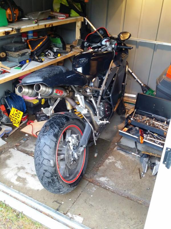

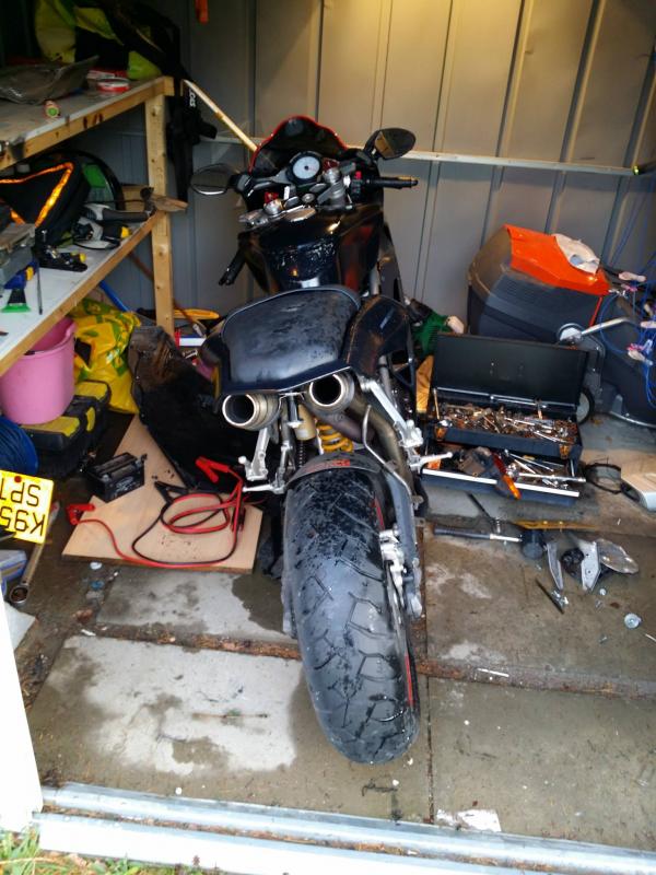

    anyone please link me to an aftermarket rear light and indicators that i can use with my current G.P.R cans?
  8. That's a face only a mother could love...
  9. I think the twin cans looks pretty cool.
    The single can on the 999 et al wasn't the most aesthetic thing Ducati have ever made. The silvery ones are frankly, a bit hideous.
  10. Agree with you about the weedy looking standard exhaust. But it just seems hard to get those twin pipes to line up correctly.
    Mind you, I have CDO. It's like OCD but with the letters in the right order...
  11. thansk guys for all your help! i decided to use the old plugs... because for some reason the electrode length on the new ones are a tad shorter, and my deep socket couldnt tighten them all the way... but i took a blow torch on the old ones and wire brushed them all up, put them in, and fired it up, it started first time! :O.... you should have seen the smile on my face! haha the noise!..... i had to turn the bike off after 2 seconds because neighbours would not be happy... tomorrow morning... im gonna have some real fun!
    on the side note, my cans seem to allign a lot better than the one on here...
