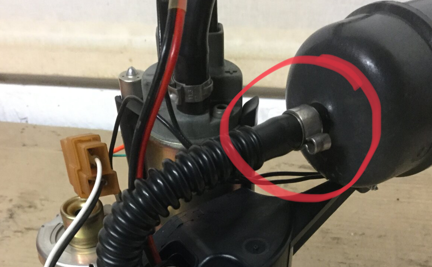

    yes you have to remove the black plastic part. carefully use a flat screwdriver to remove the clips ... take your time, you want to reuse them. After having removed the upper black cover you have access to the part, which is secured by a snap ring, that also has to be removed. Done that you can push the part out.

  3. Also...how can I get the fuel filter clips off without a special tool?
  4. I used a junior hacksaw
  5. Cut them off and replace.. they are call oetiker clips
  6. To reinstall I used some pincers to compress the ears.
  7. I found them Oetiker 123 single ear clips.
  8. Got the clips and shroud off. Bit of a fiddly job.

  14. Stein Dinse fuel pump wiring and additional earth wire attached..Pump reassembled...new fuel filter and Oeteker clamps...new pump O ring...chuck it in the tank...splash of fuel...fires up..mended!
