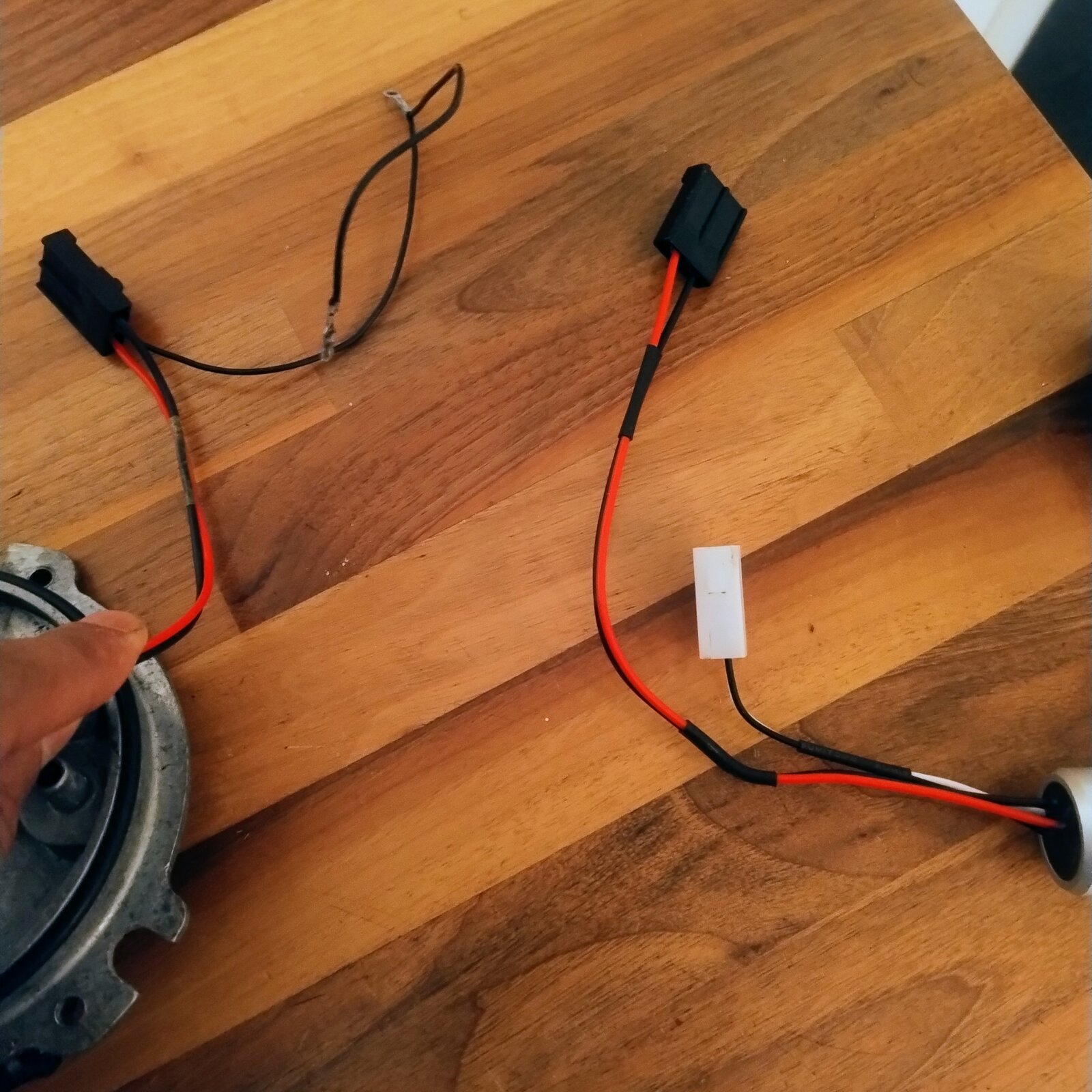

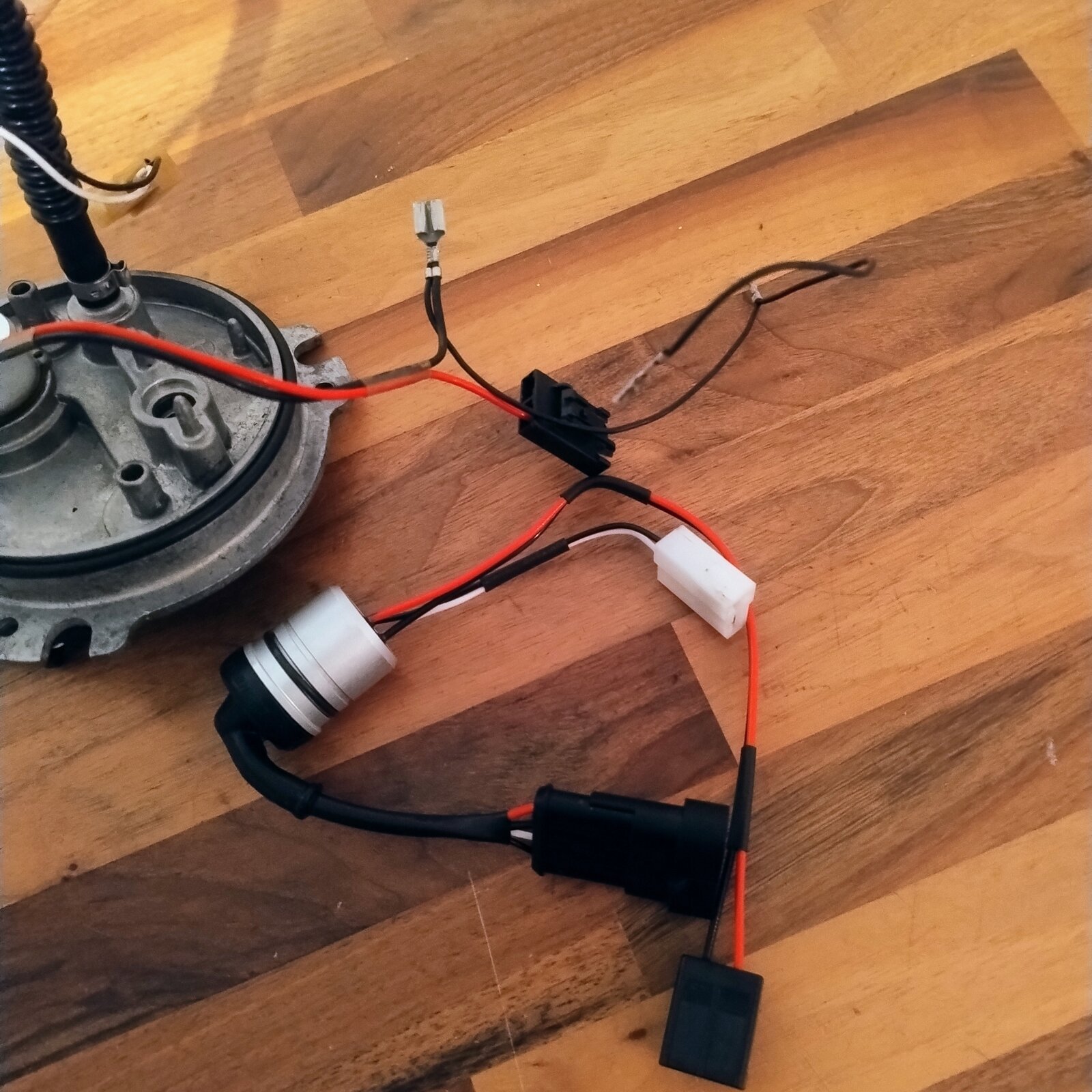

  10. ok so why does the original wire thingy have an additional wire that looks like an earth and attaches to the fuel filter mounting yet the repair kit (same part no as has been bought by others on this thread) does not have it?
  11. This was noticed when I got the new loom-ette.
    I modified the new one to match the old one (with a kind contribution of a connector from @Sev).
  12. buggerage. i was hoping i could do away with it. i prized away the crimped wire from the black connector but damaged the black connector in doing so.
  13. I think the replacement part is actually for an ST3 if I remember correctly.

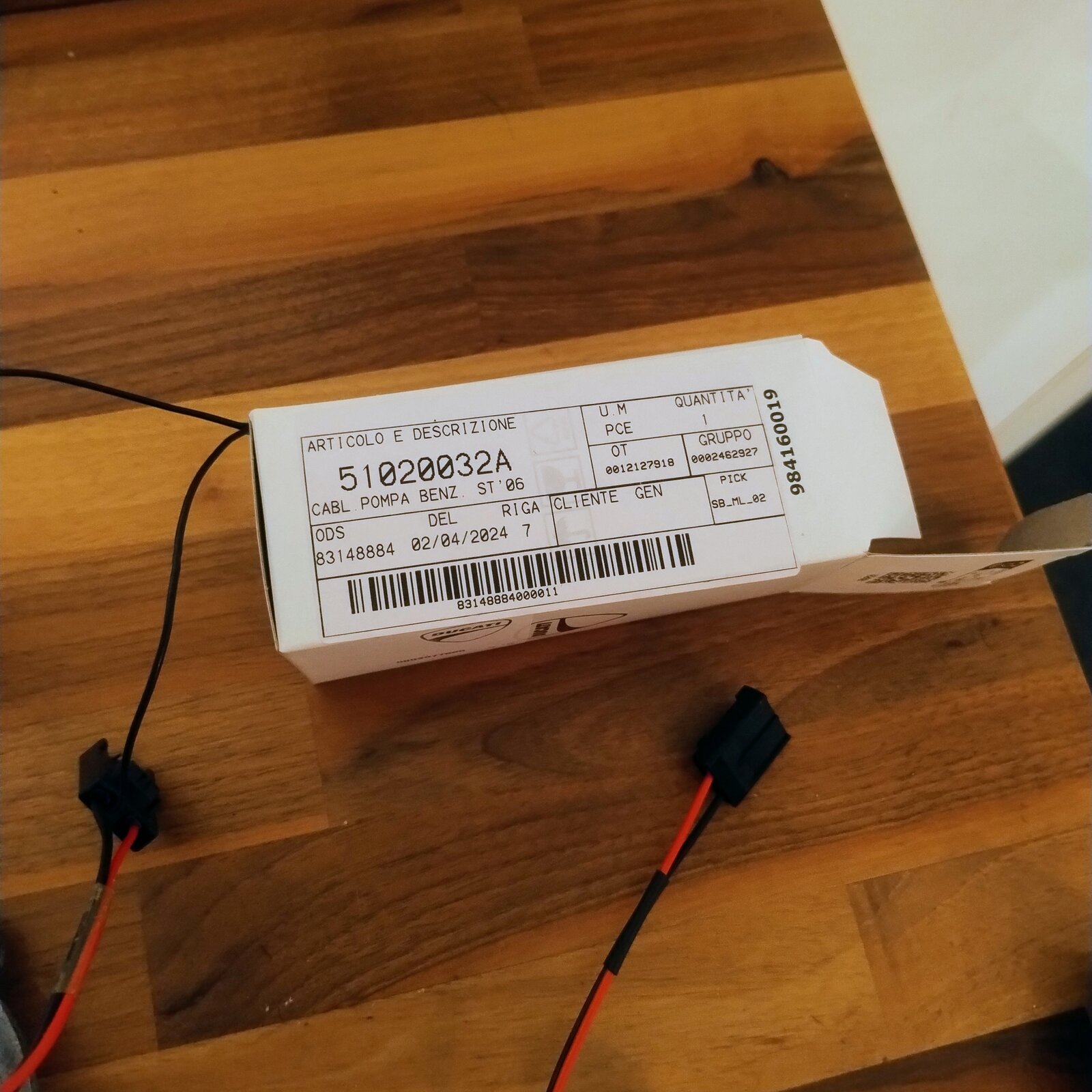

    SteinDinse part:
    Should I get the 51020032A or the 51020032A-Z ?
    Not much difference in price but It’s not clear to me what the difference is.
    https://www.stein-dinse.com/en/item-1-1429407.html
    And (sorry), the extra wire (earth), did you just ask a mate to make that up for you back then Ricky? There is perhaps someone who could do it for me, but might have to give it a go.

  19. i have 51020032A and im sure thats what the others got based on the previous thread on this. note that there is a earth wire that needs to be added as long as formed part of your original assembly. if so, i now have received the terminals so will get mine made up soon and show the end result
