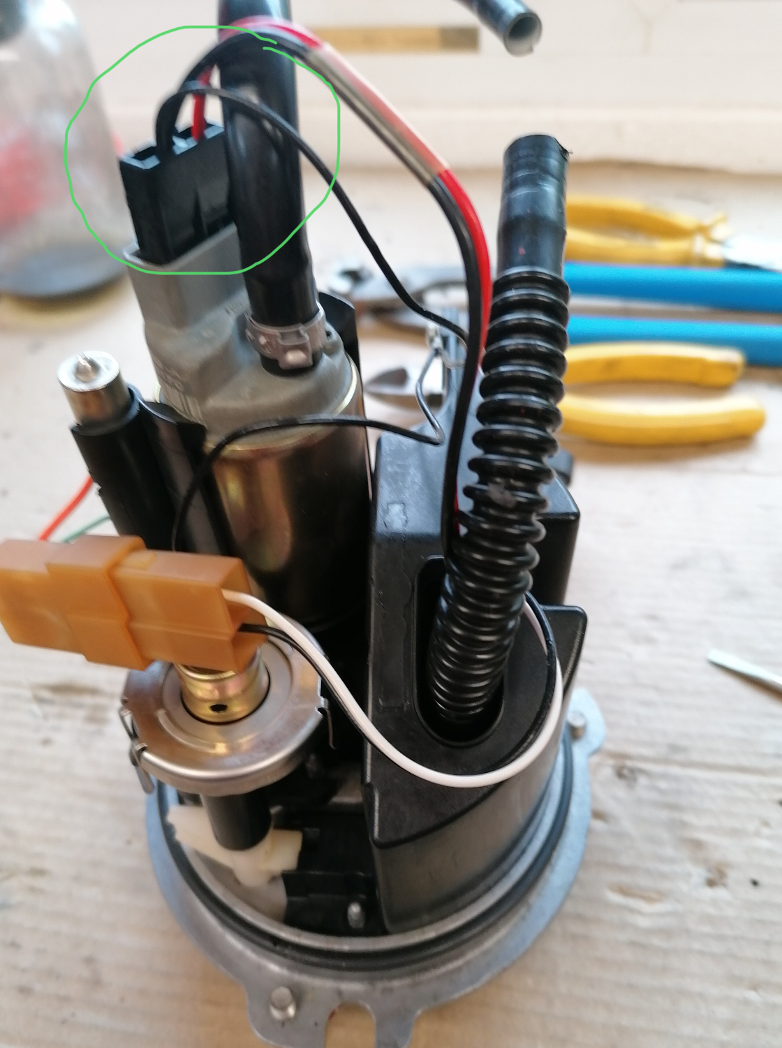

    First is the standard pump removed showing the “extra” black wire:
    Next shows where I cut and removed the black connector.

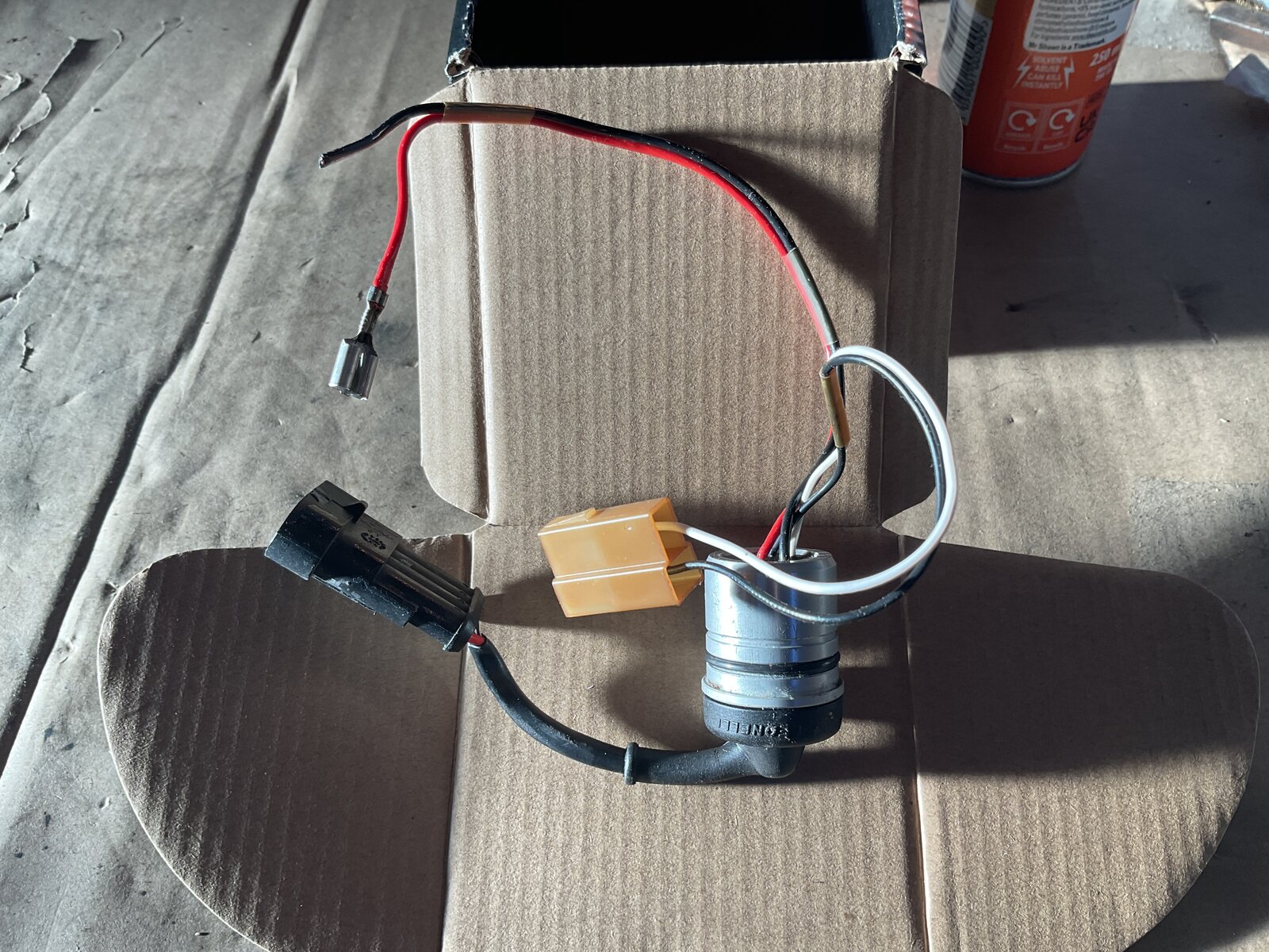

    When I installed the replacement wiring, I removed the spade connector and crimped the new black wiring to the old black earth lead into the same connector to replicate how it was originally. This shows the cut loom of the original.

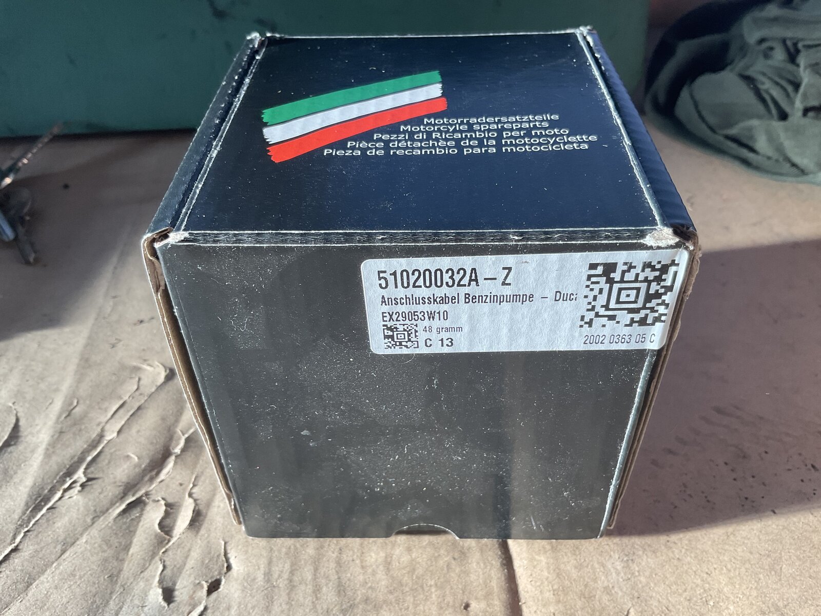

    Here is the P/No I ordered:
  5. Buggerage. I have the non Z part no which i ordered from Ducati for 91 quids. Better work
