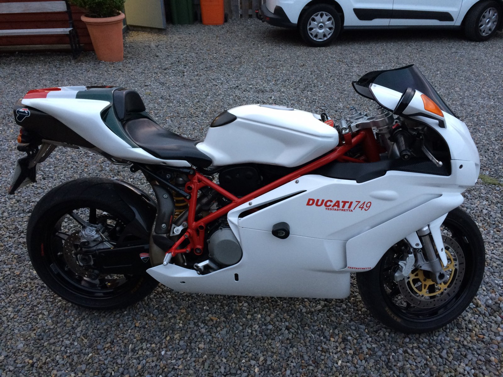

  4. I rang a Ducati specialist in Dublin today mototecnik they r brill for advice. Ordered a new ignition relay it my or my not be that but worth ruling out. Even better when they said €20+postage but don't worry about paying we will see you again (genuine upgraded Ducati one as well) He even told me a way to access it without having to deconstruct the whole bike.
    Will have a go at those fuses when I'm in there for sure. Fingers crossed that it works out.
  6. €20.00 plus postage is an enormous sum for a relay. They are usually just a few pounds.
    Also, can't help being a bit sceptical about upgraded Ducati relays. Italian vehicles are not exactly known for their quality electrics, with the standard Ducati starting circuit cables being a case in point...
    Interested to know about the special technique for accessing the relay without having to dismantle heat shields etc.
    If Chris and Derek say that the pump priming precludes the relay being the problem though, best believe them because these guys know their stuff...
    However, no harm in replacing the relay because they are generally a troublesome item, especially in their original location.
