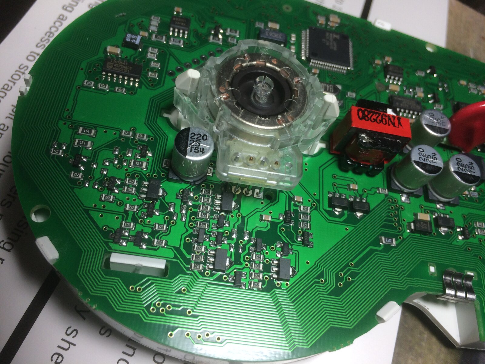

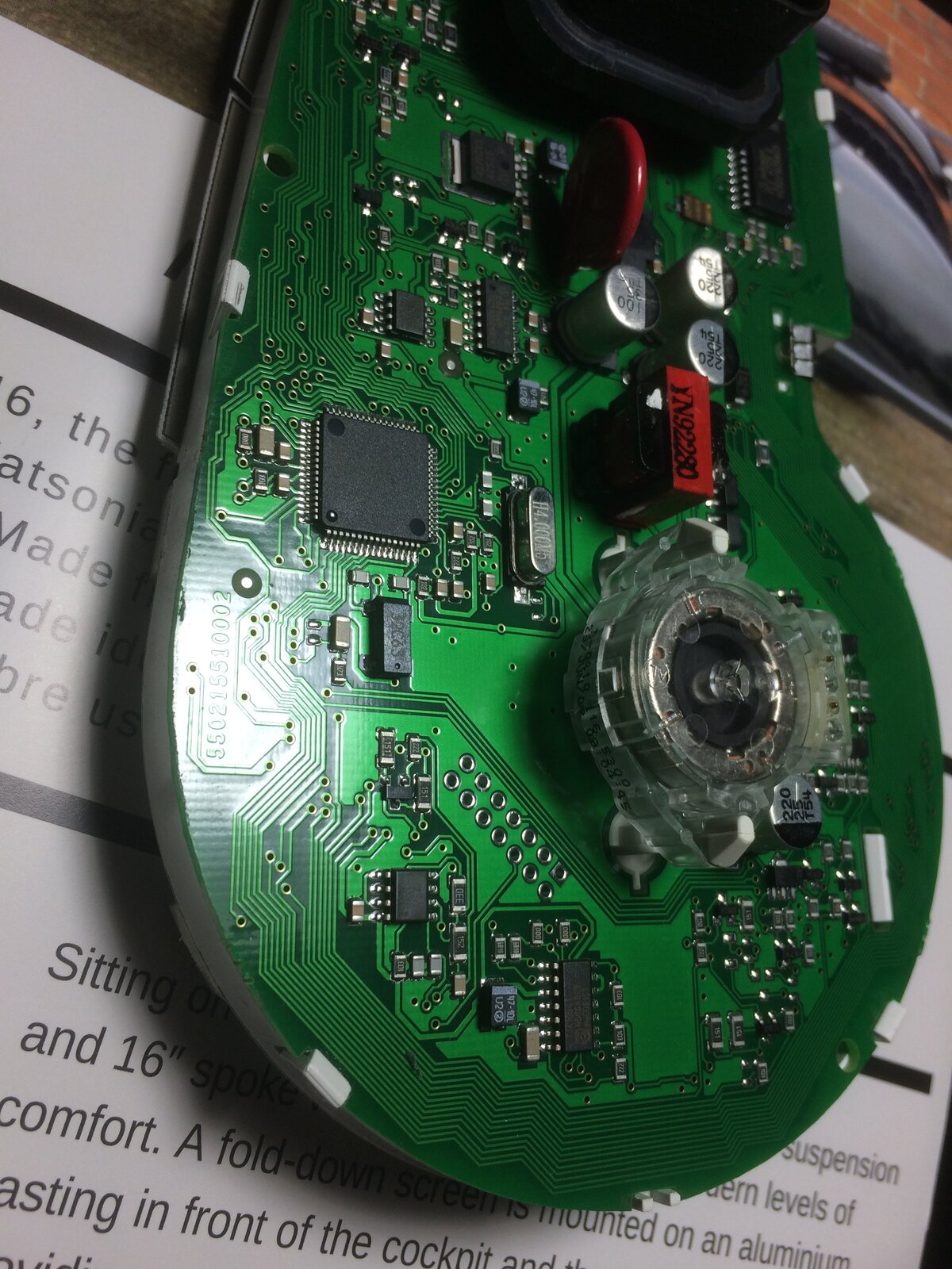

  3. out of interest:-
    A6A68638-C66D-483B-A68B-5CA593933691.jpeg C751C3ED-D6BE-4909-BE97-5BD10B5AE2F2.jpeg 4D56C4B5-9C73-4717-A287-F45E98AC2541.jpeg
    you can see the 4 main pins leading into the unit and the windings, 2 are soldered at the top (as oriented in pic) but the other two show no sign of solder.
    That's the end of my input now really, i've just tried mine again in it's bare state and tried lightly flexing and tapping but no change (already left it on a radiator overnight!). The fact that mine consistently "tries" for around 3 seconds/behaves normally every time on initial start-up makes me think it's a component failure and the tacho unit itself is probably fine. Someone, somewhere very possibly knows exactly what this is by the failure symptoms but I will just get used to no tacho for now.

  4. The soldering is normal. If you look closer you will see the two with solder are connected to the copper winding of the tacho motor by thin copper wire.
    If you have a multimeter then you will find continuity between the two pins with solder. There is also continuity between the two pins without solder.

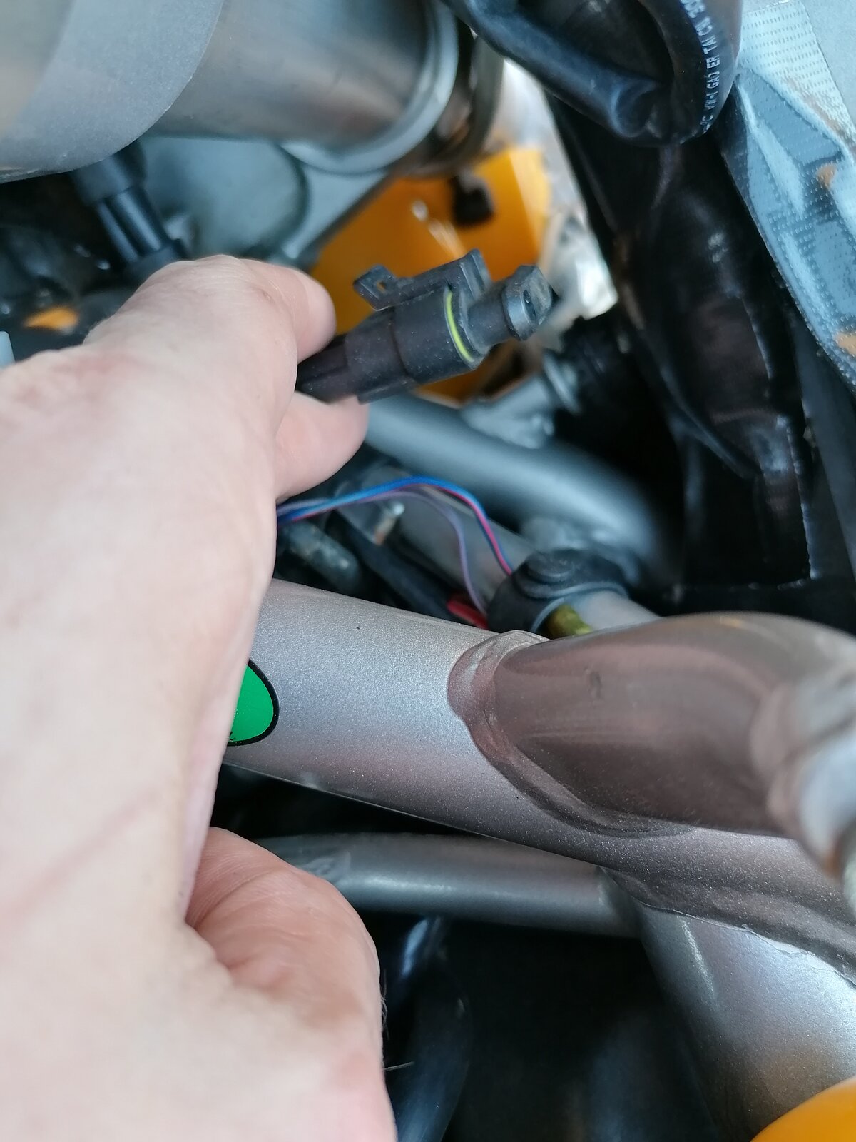

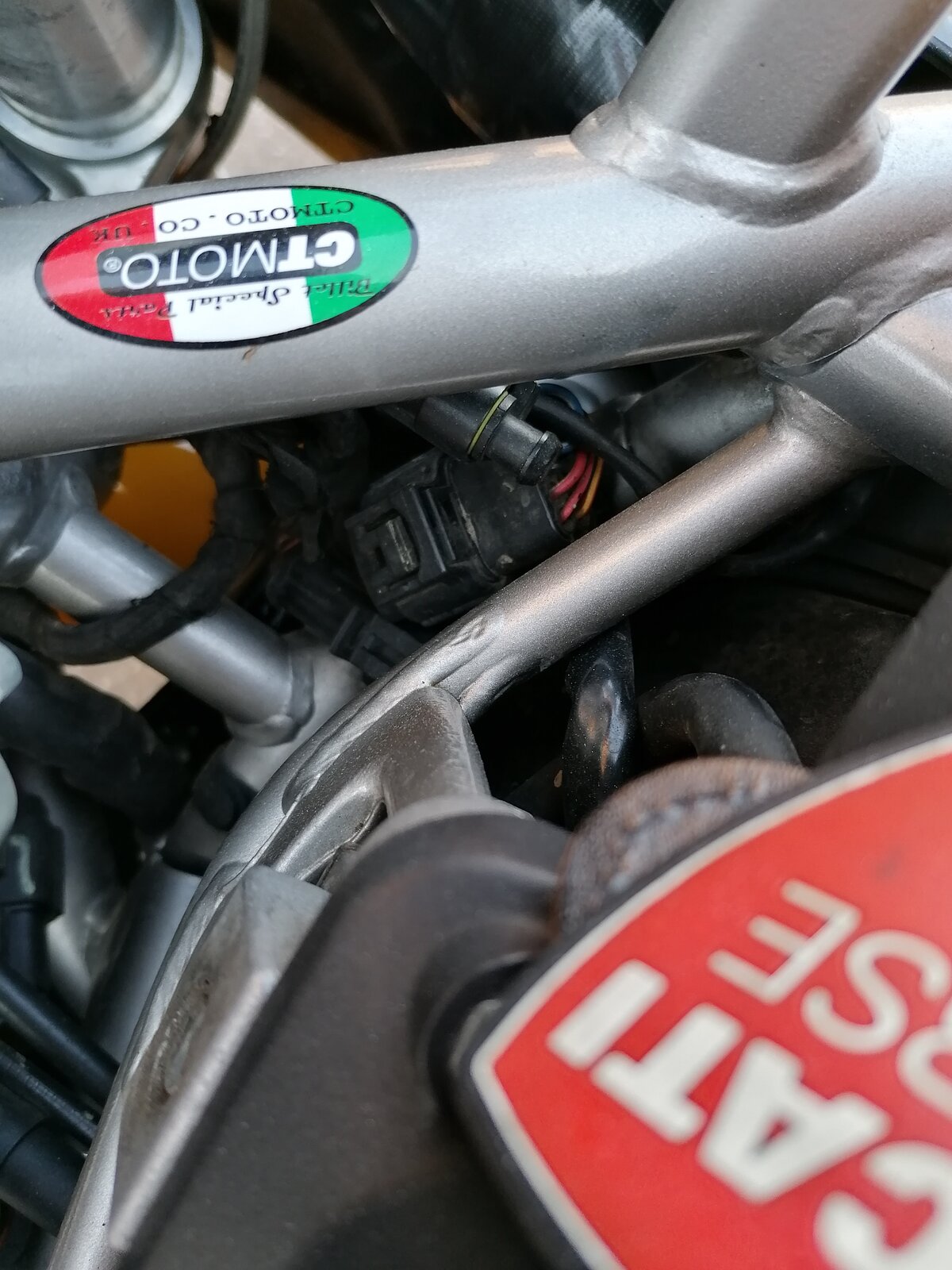

  10. I should add, this little cheeky sucker is flapping in the wind. I assume it should have at least a cap on the end?
  11. 030671B3-361E-4B50-83F2-4E606A2CDEC0.jpeg Number 11 in photo. Described as Finish Line Sensor.
    There should be a plate on the frame for it to slot onto (look on the back of the connector to see how it mounts). Think it is for the GPS accessory that links to the dash/lap timer.
