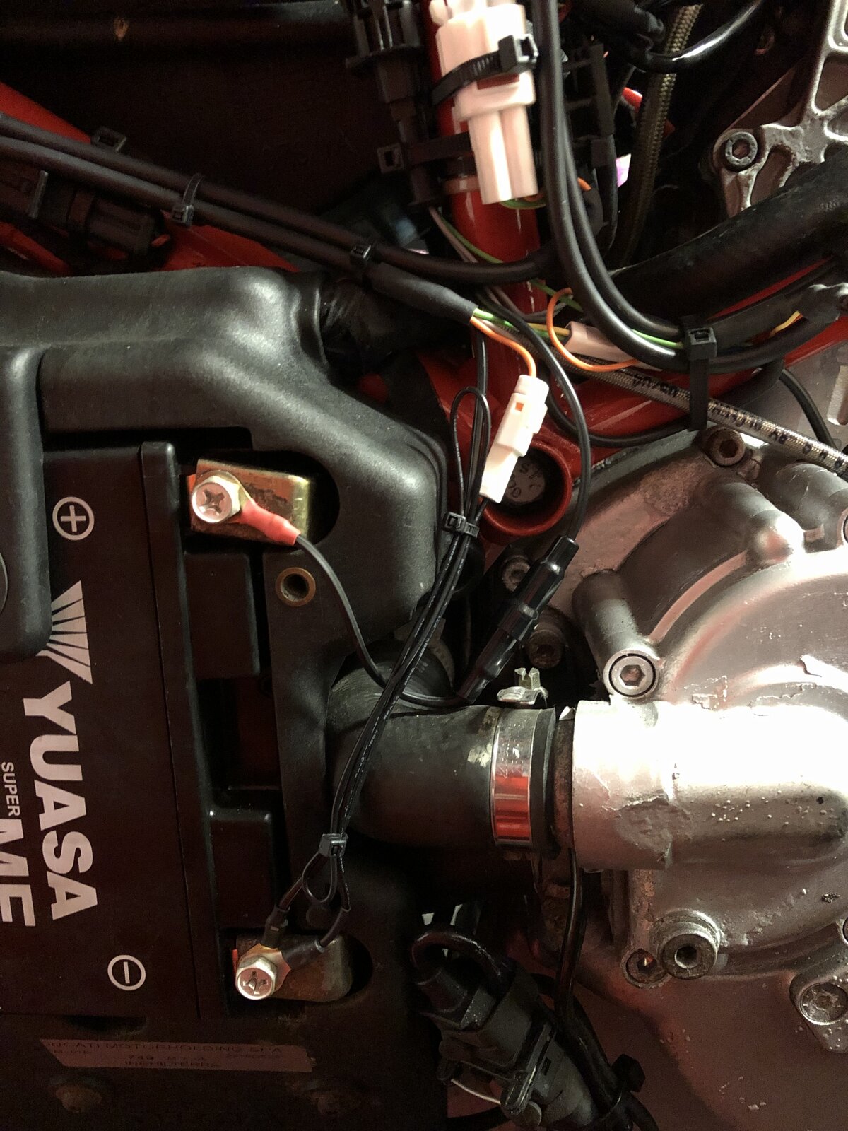

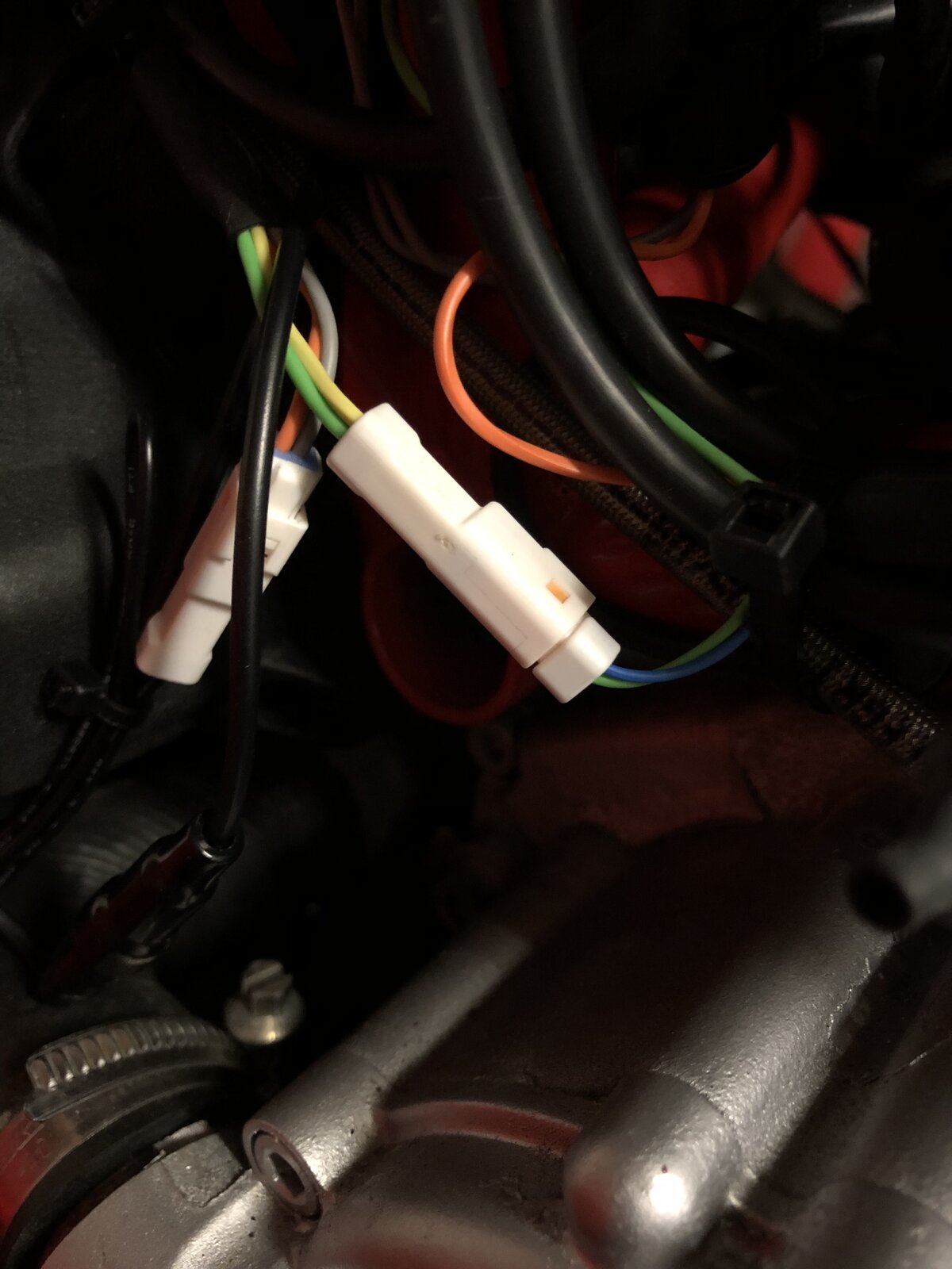

  5. 74E173FD-627D-496C-AA8E-5AEE780D5111.jpeg B3AE3FC6-A099-4712-8D28-1FD0118F2780.jpeg
    Yup, small earth fitted to neg terminal blue and green to yellow and green for push
  6. Yep all looks ok with your connectors, very strange it should be all ok, I just hold my gear lever as if in changing up a gear and whilst holding pressure on the lever just switch on ignition and the led comes on just for the second (led on front of qs ecu) Nothing to do with revs mate
    The 749 system is the EXACT same as my 1098 streetfighter and 1098 sbk etc, I checked so yours should work as mine does
  7. I wonder if my coil wiring matches up with the translogic pins although if it didn't surely it wouldn't run? theres a diagram in the instruction showing the +/- crossed but again it does say "incorrect wire alignment resulting in the engine not starting or running correctly" but mine does start?
  8. when I got my kit and read the instructions I didn't think they were that clear on certain things (like what you just said about incorrect wire alignment) so emailed them and they phoned me back fairly quick and went through things with me, first thing I asked was if the wires need swapping in connecters and he told me NOT on the Ducati
  9. yeah I just checked on the wiring diagram and brn/w is the + to coils and that matches up with the yellow and green on the trans plugs...........im baffled

  19. Just spoken to David at translogic and he assures me it’s wired correctly and I should wait until I get the roses for the linkage because the sensor requires 20kg to trigger and that’s not easy to achieve in your hand but easy with the leverage of the foot pedal
