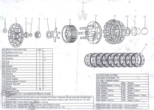

  4. cheers ian. just been and pulled all my spares out and have 2 new concave rings @1.5mm
    my clutch isnt together right so gonna sort in the morn.
    I have steel ring on first and no concave rings.
    and also the bauer washer here too.
    gonna take it off and rebuilt it...will only take 30 mins...
    always a prob when you buy things and dont get the instructions. (just downloaded that previous pic)
    cheers
  5. Phil.
    This explains the order of the clutch plates a bit better. Basically the 1st steel in the pack should be a dished plate, with the dish facing towards you as you are fitting it. The 2nd from last steel (the 1st one after the end steel) should be a dished plate facing in towards the engine.
    The slipper should start with a friction plate (By 1st, I mean the 1st one fitted) and end with a steel (pressure plate side)

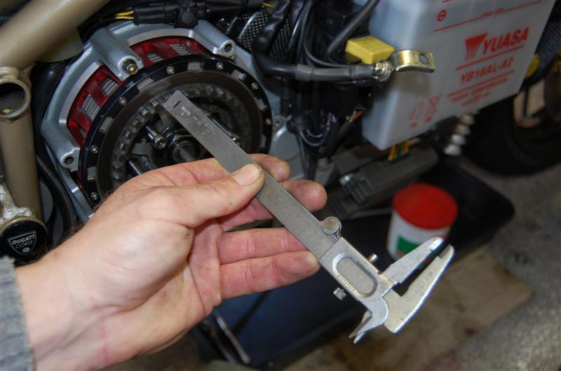

  14. OK so it not about measuring a stack of plates to get say 36.5mm or something.
    Build the clutch pack up in the correct order, when you get to the last plate this should sit 4-5mm below the height of the inner drum ( hold the plates in squarely so you dont misread, use a vernier to measure accurately) if you've fitted spring plates then i would err nearer the 4mm but no lower, the nearer you go to 5mm and beyond is why they screech and grab .....simples.

  19. This is how i set mine 4mm as Andy said, D/P six ball and ramp set up.
    brian.
