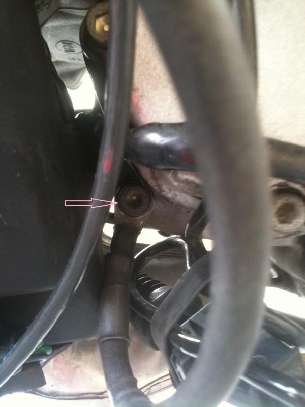

    I have the lhs fairing off and can't find this bolt. Do i need to get the battery compartment off again to see it? Or is it under the rhs?
    Not too hot on mechanics so don't even know what a starter motor looks like :(
  8. Starter motor located at the bottom front of the engine.
    Steve

  10. I thought they were turbos but didn't want to look stupid if they weren't :) Is the motor finished now Steve?
    Thanks for the picture/help, have found the starter now, thanks.
