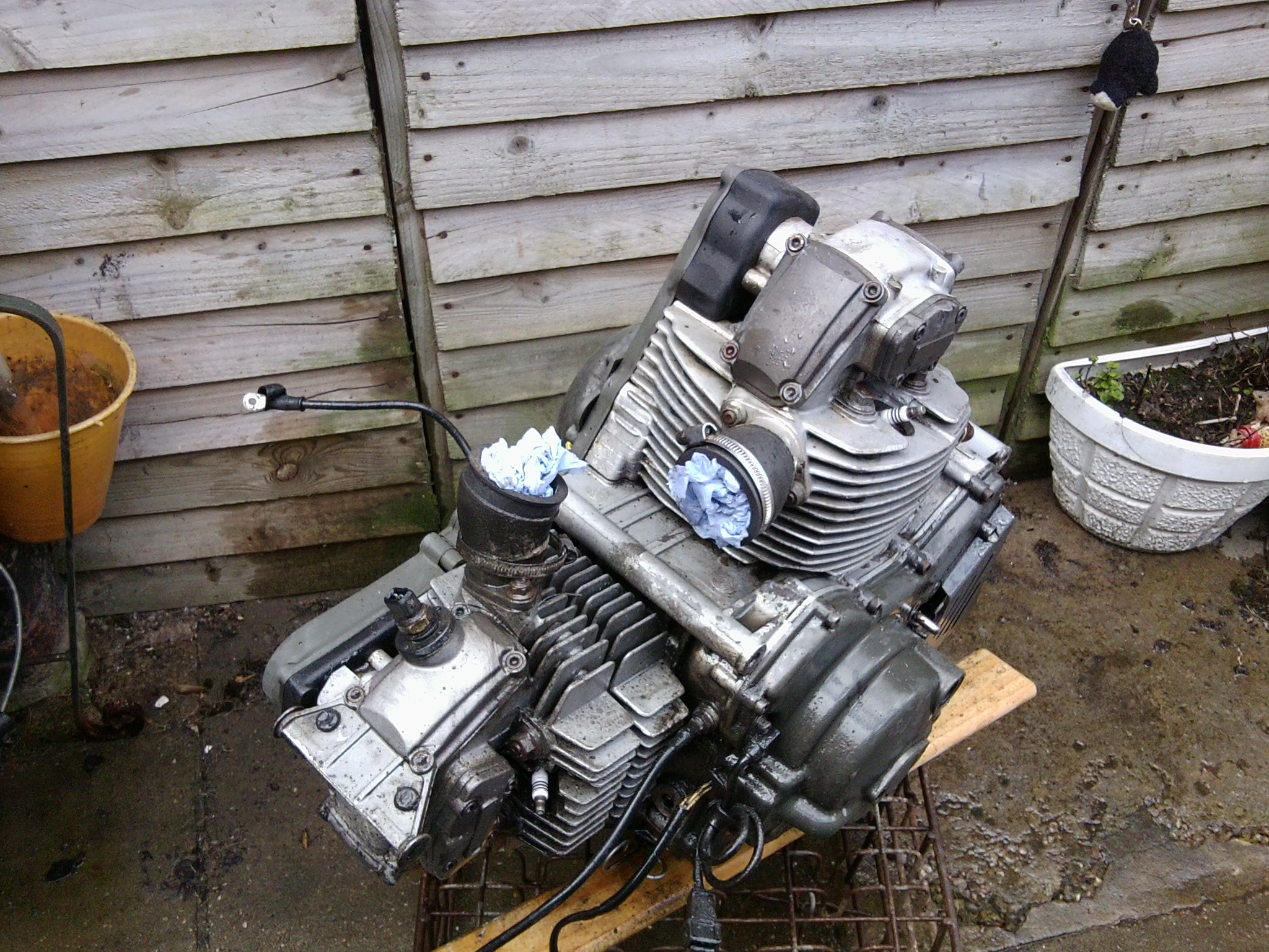

  9. so spent a couple of hours on sunday cleaning up the engine ready to be fitted into the bike
    already checked that bolts and things on the bike will come undone
    got the exhaust off and no broken studs whoo
    already got some new copper coated exhaust nuts
    air box removed and cleaned
    and so far only issue with new engine was oil cooler mounts
    the rubbers had broken away and left the threaded section in the rocker cover
    hah so out came the molegrips lol
    out came first one easy ........second one made of cheese snapped straight away
    of with the cover and in work today drilled and tapped sorted
    just hope the swingarm goes as easy lol :Wacky:

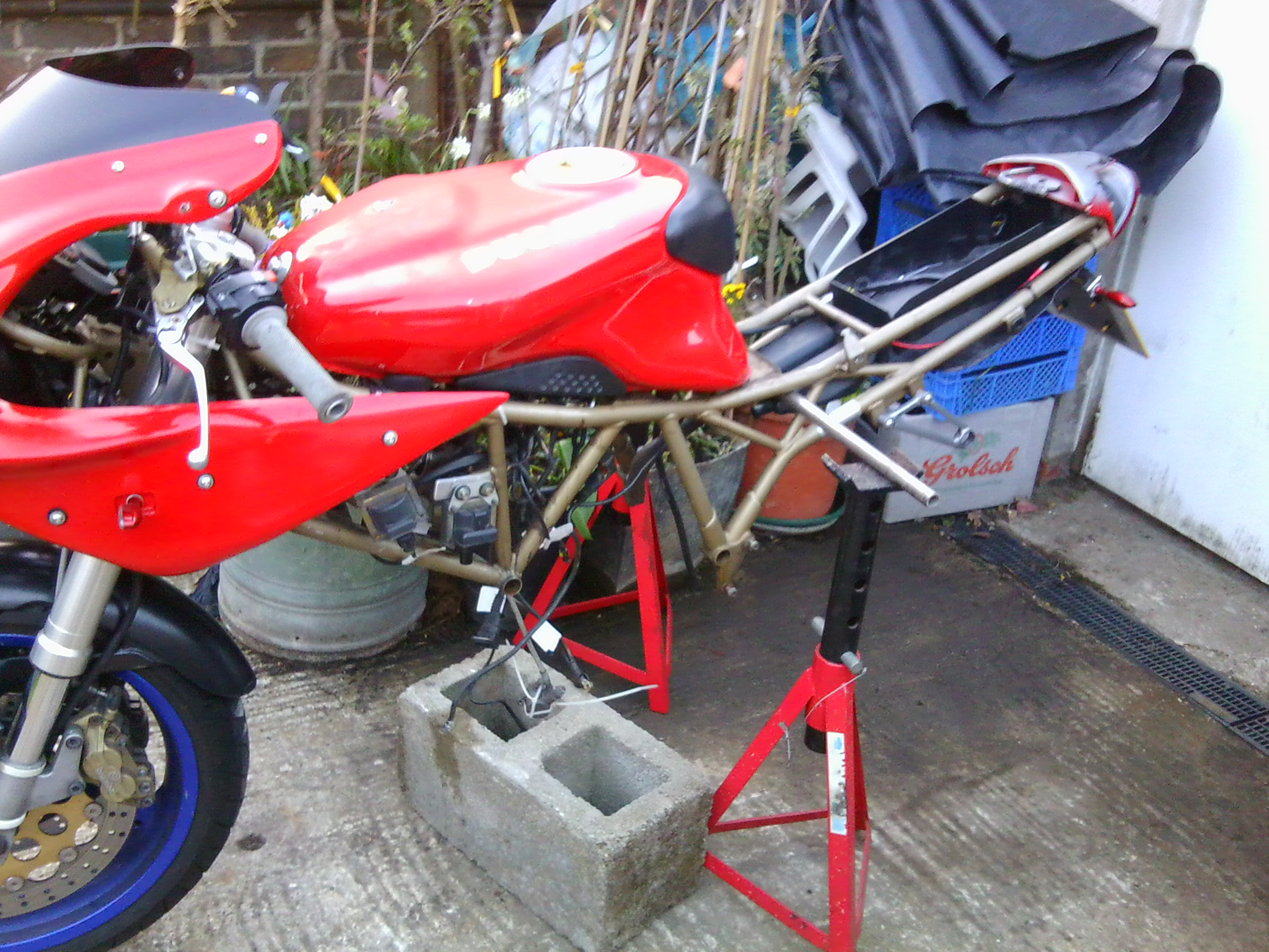

  10. so a busy day nipped up to moto italia to pick up new oil cooler mounts and an oil filter for new engine
    getting quite regular first name terms with terry now lol
    so back home and continued to strip the bike
    did pretty well dismantled and engine out ready for new engine in
    everything came undone fair easy including the swingarm spindle which was well lubricated ;)
  11. Oi!
    Royalties, please..........................for that stand....................
  12. nothing like your stands al honest :Angelic:
    anyway mine are metal not wood and red ..........err see nuthin like officer
    borrowed from work aswell :rolleyes:
  13. My rear one is green and angle iron.................just 'cos you had red paint left over is no excuse
  14. see green nothing like :Smuggrin:

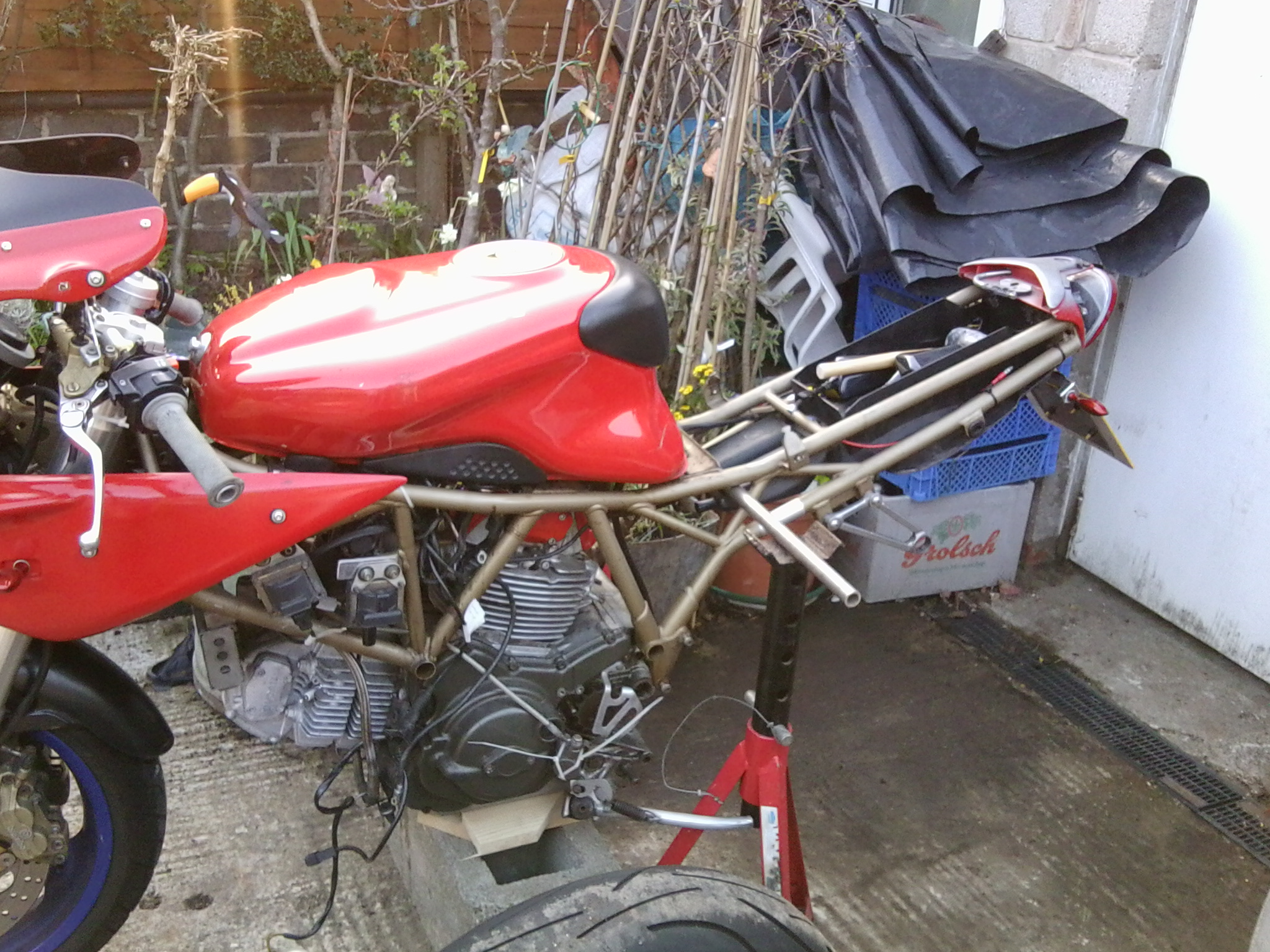

  16. okay guys engine in running gear back on
    no major issues but found an inlet rubber on new engine had a split in it
    oh joy spanner does not fit on cant get a socket on bah
    so out with the angle grinder to thin out the ring end of an old spanner whoo job done
    but then find one nut on the old engine for the inlet is rounded off rats
    hacksaw and chisel job done
    so just need some fuel hose clamps as old fixings look well crap
    just small jobs like airbox and exhaust to put on then oil and filter to do
    took a piccy hope to get it on later :D
