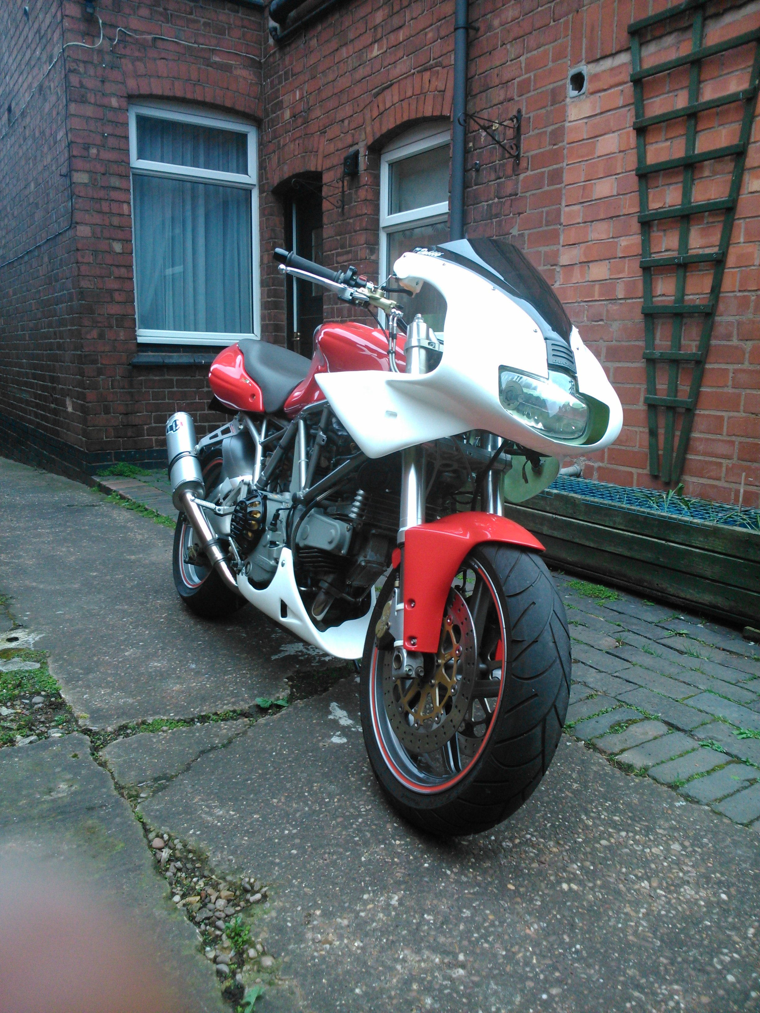

  9. Johnboy Finally got the fairing the same as yours and mounted the bellypan. Struggling with mirrors to fit so bought some old gsxr ones which may do trick, with the risers the levers were hitting the glass on full lock. Just need some tweaks and to move the coils because they hit bottom of fairing. Quite enjoying it. Did u relocate your coils too?
  10. looking good there bud
    belly pan looks sweet still undecided whether to fit one or not
    i had issues with bars hitting fairing slightly because i have raised the bars up a bit
    jiggled fairing a bit and it sits slightly tilted forward ( bugs me slightly lol )
    as for the coils left the coil for rear cylinder in place and use it for the front cylinder
    front coil in original place did foul the fairing so mounted it on a disused fairng mount on the
    behind the other coil
    still would like to move them somewhere else less unsightly
    but not sure where
    you can see in piccy below

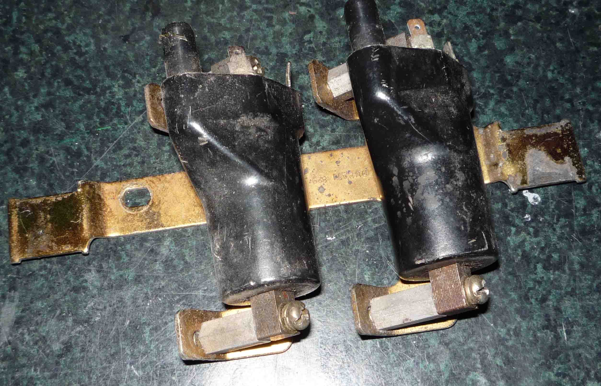

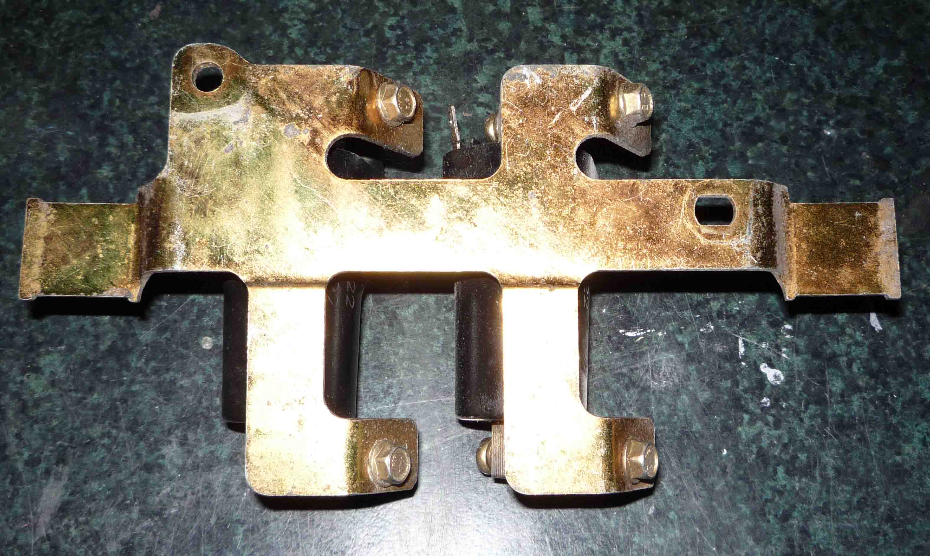

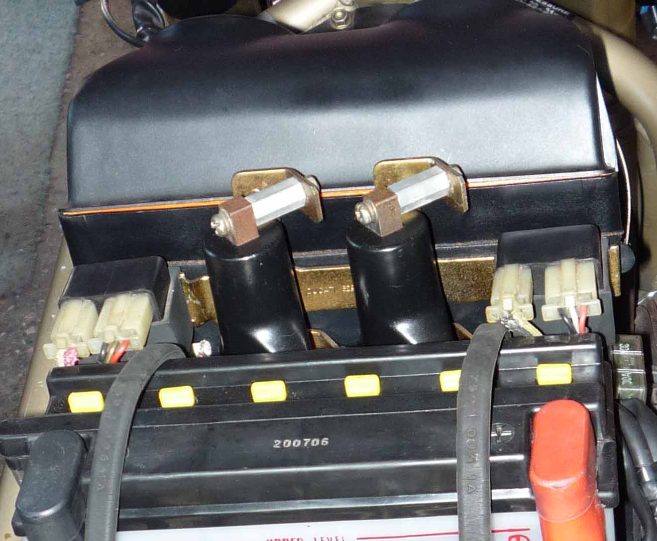

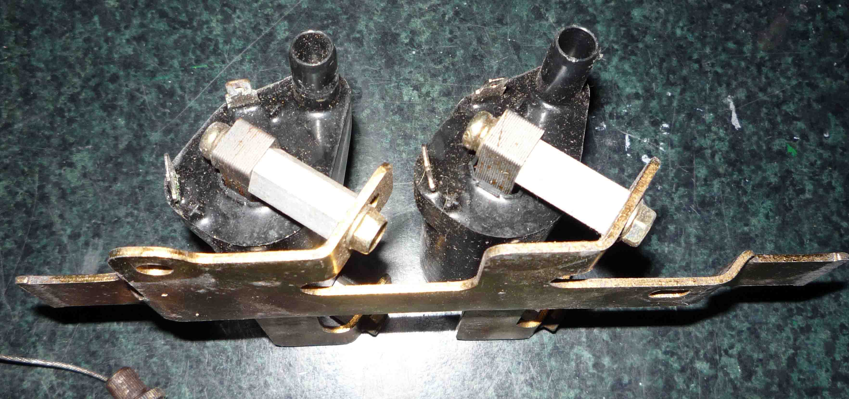

  15. I assume you are aware the coils for the carb models are under the tank between the battery and the airbox?
    I have a spare bracket for mounting the coils and CDI boxes if you are considering trying it.....It bolts to the back of the airbox.
    AL
  16. That's interesting to know Al could you post a pic of the bracket
  17. Here you go............
  18. ahh my ecu is mounted just there !
    not really any spare room under the tank
    unless i go for pod filters and junk the airbox which i dont really want to do
  19. So you have got an ECU stuck in the way???
    Oh well, at least there is something to be said for having a carbed model after all....... ;)
