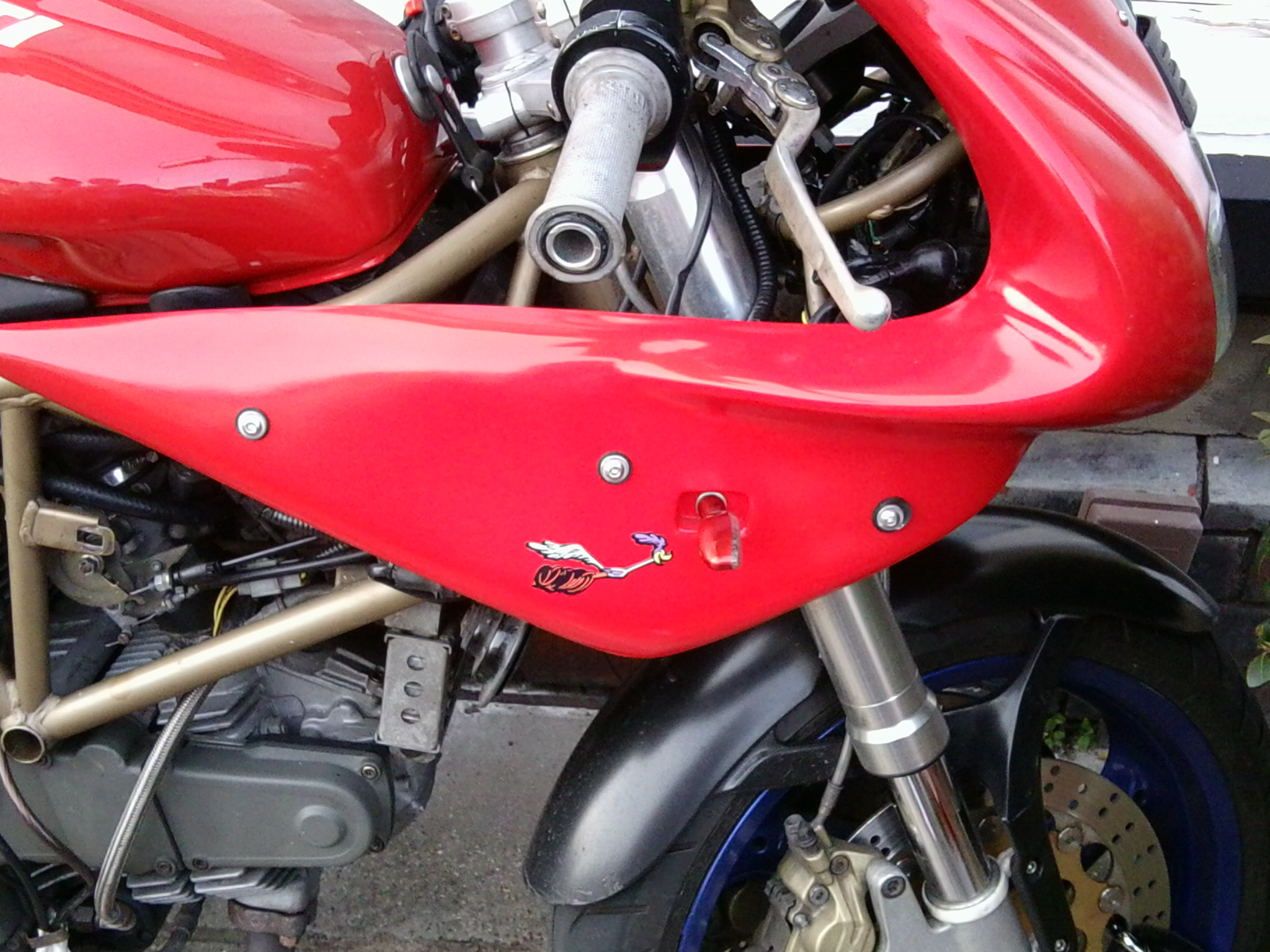

  17. well played around a bit with the bike this afternoon
    tightened up a couple of loose nuts mainly rear indicator one
    seems to have loosened with vibration so a bit of silicone sealer on the threads should cure that
    also changed the front sprocket for new one and is 1 tooth down on standard
    so that is meant to make it more bearable around town !
    took it for a blast and yes quite a difference on round town running
    as for out of town well definitly picks up quicker :Happy:
    oh and while sorting out decided to do a bit of decorating
    thought a couple of stickers wouldnt look amiss
