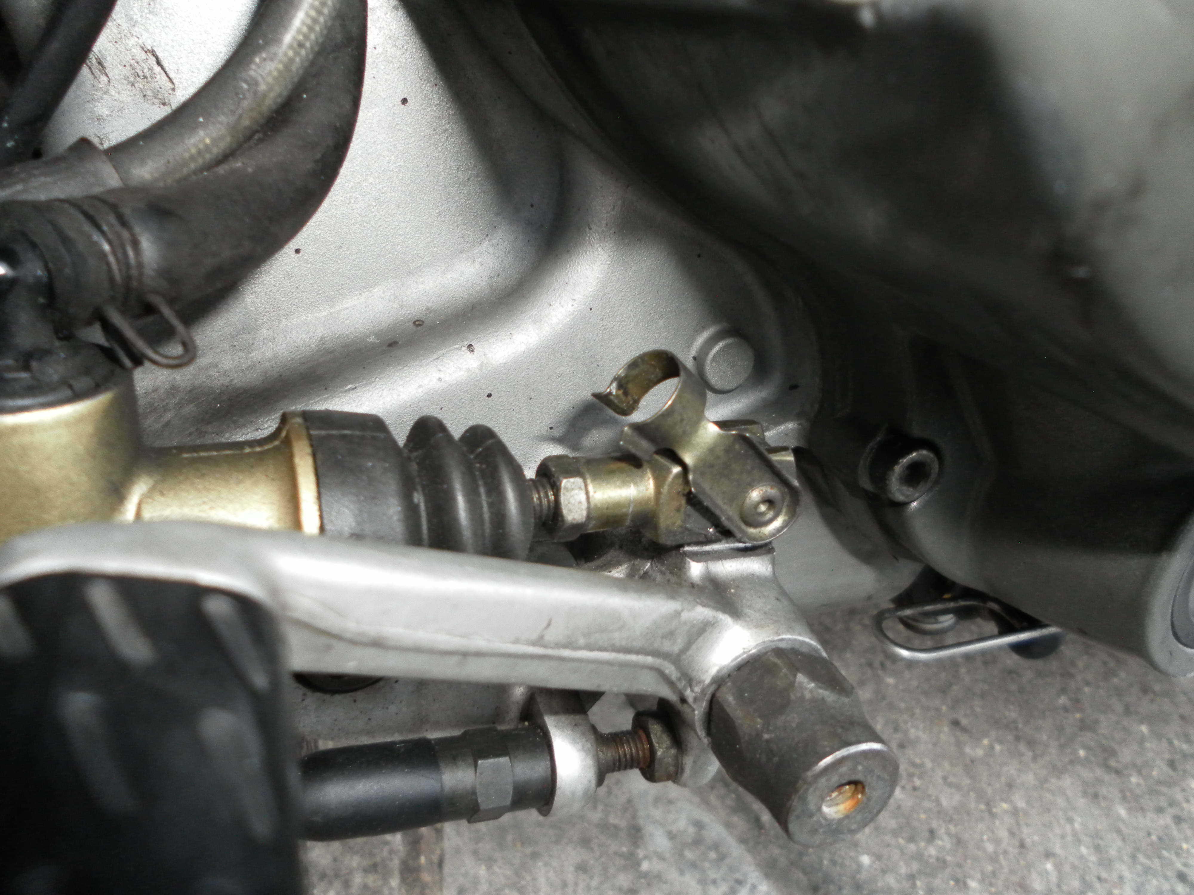

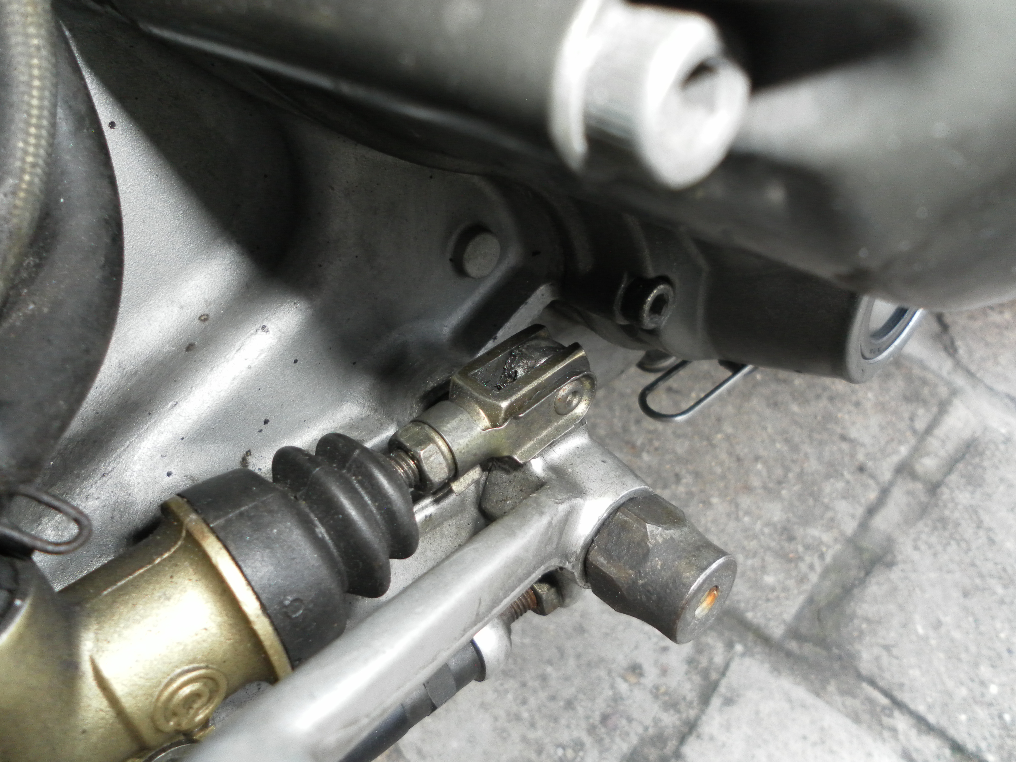

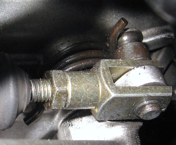

  1. Haven't checked mine exactly, but the hooked end of the spring goes under the brake lever from the outside / right side; and the other end hooks into the underside of the clevis pin for the footrest............The clevis pin has a drilling / hole in the end, and it hooks into that....
    AL
  2. not sure if carby assembly is the same as ie model al !
    top picture is what i should have .......i think
    other two are of what is on the bike

  5. well picked up the part needed for the rear brake pedal spring
    took apart and cleaned and greased parts while there
    job done 5 minutes work whoo now i dont have a flickering brake light lol

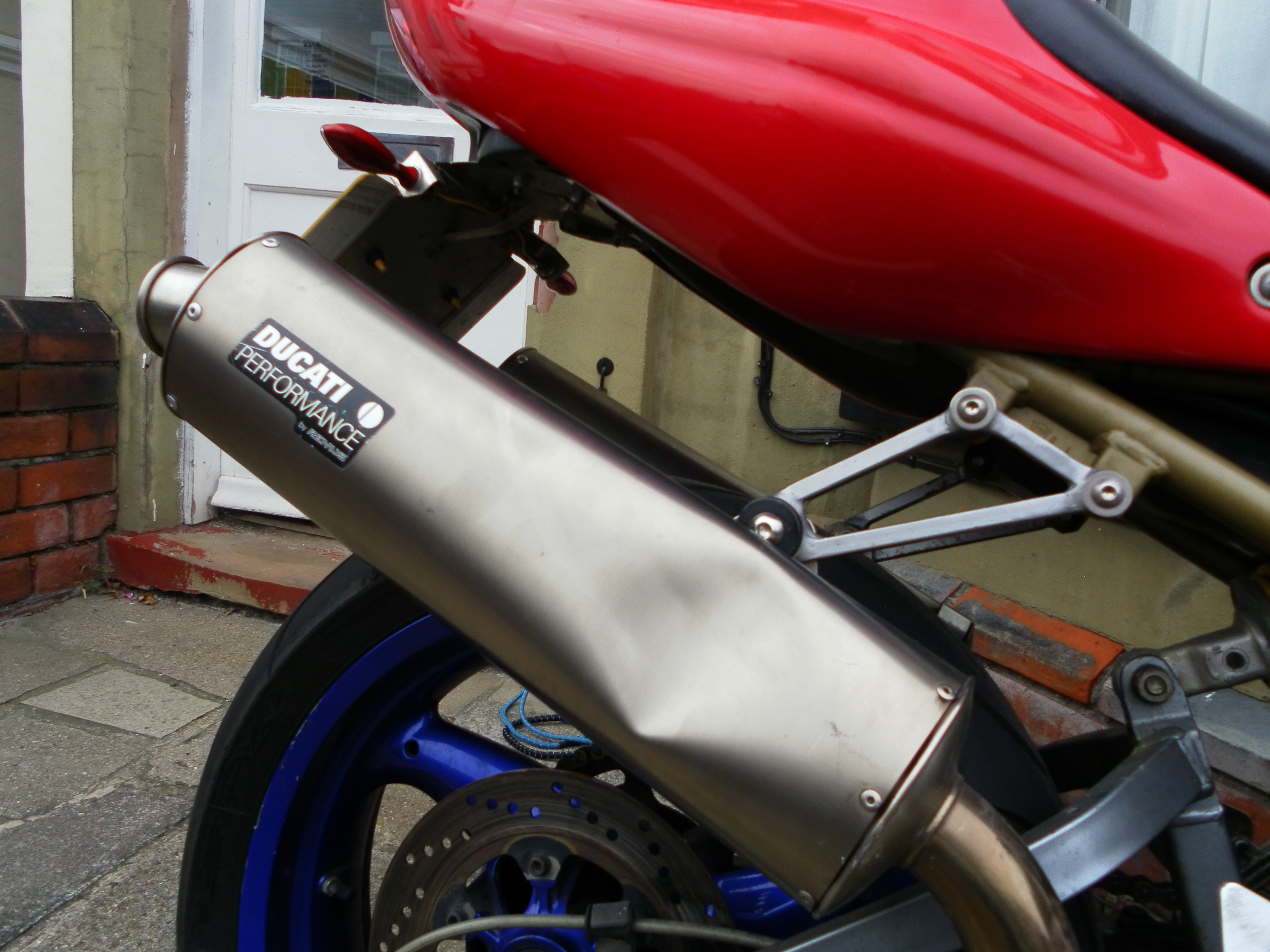

  9. well had a good look tonight
    rear brake lever is bent
    possible right hand handlebar bent
    right hand indicator smashed
    front brake resauvoir bracket bent
    silencers damaged
    and both silencer brackets snapped
    oh and nice cheese grater effect on right hand engine casing
    well a quote on parts from moto italia was around £1300
    but think i can sort this a bit cheaper :Wideyed:
    and only damage to me is a strained achiles tendon and a bruise from my disc lock
    digging into my hip doh

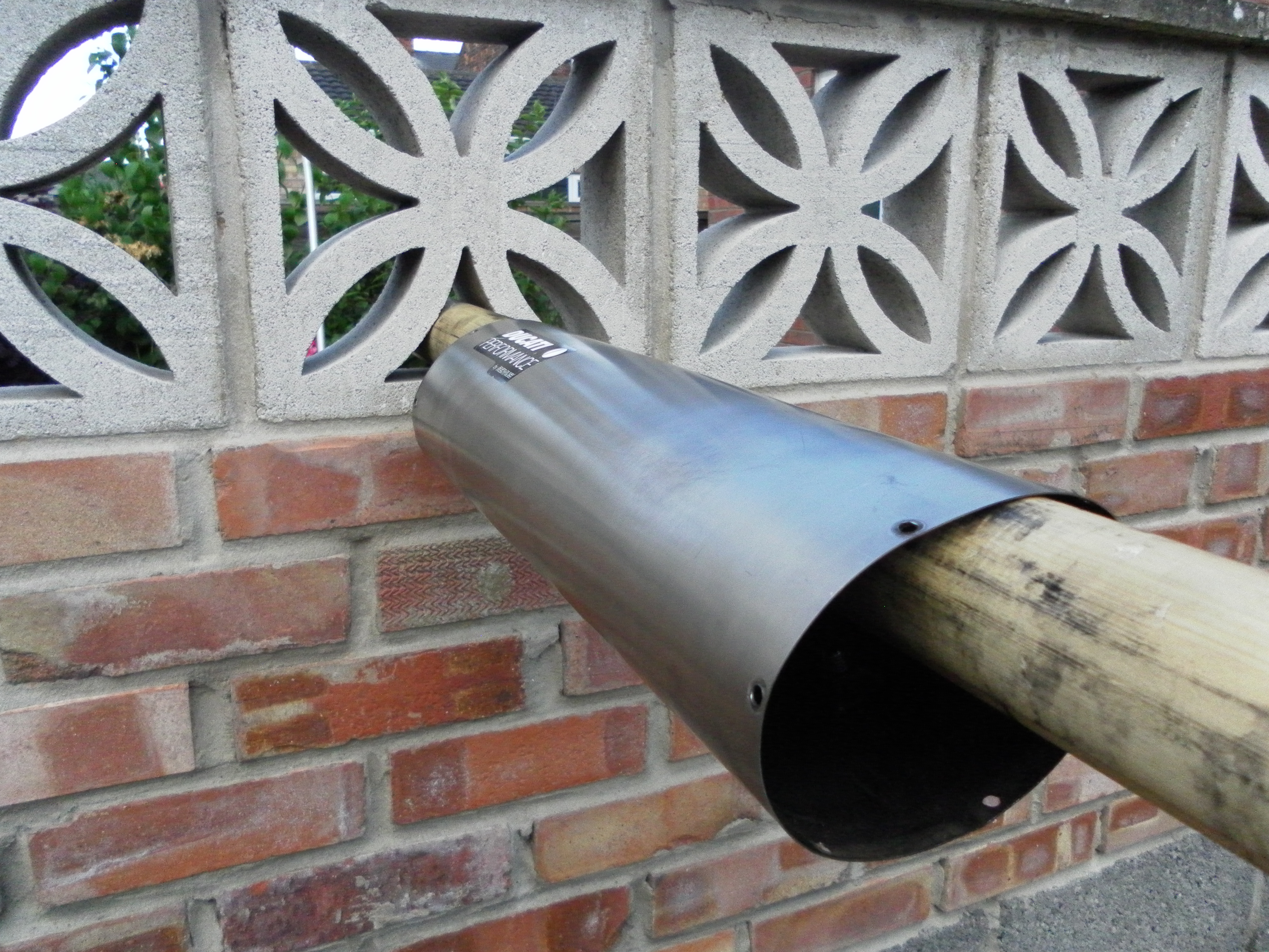

  10. well quick update after a check handlebar is straight ran a file around end good as new
    resavoir bracket sorted with a pair of pliers ( high tech lol)
    might be able to jig and weld exhaust brackets got to take them into work to see when i get them off
    was thinking of re-sleeving the silencers but not come up with a source for titanium sleeves ....yet
    found a place on the net just up the road mainly doing carbon sleeves
    going to see if they do titanium
    in the meantime might see if i can get the dents out

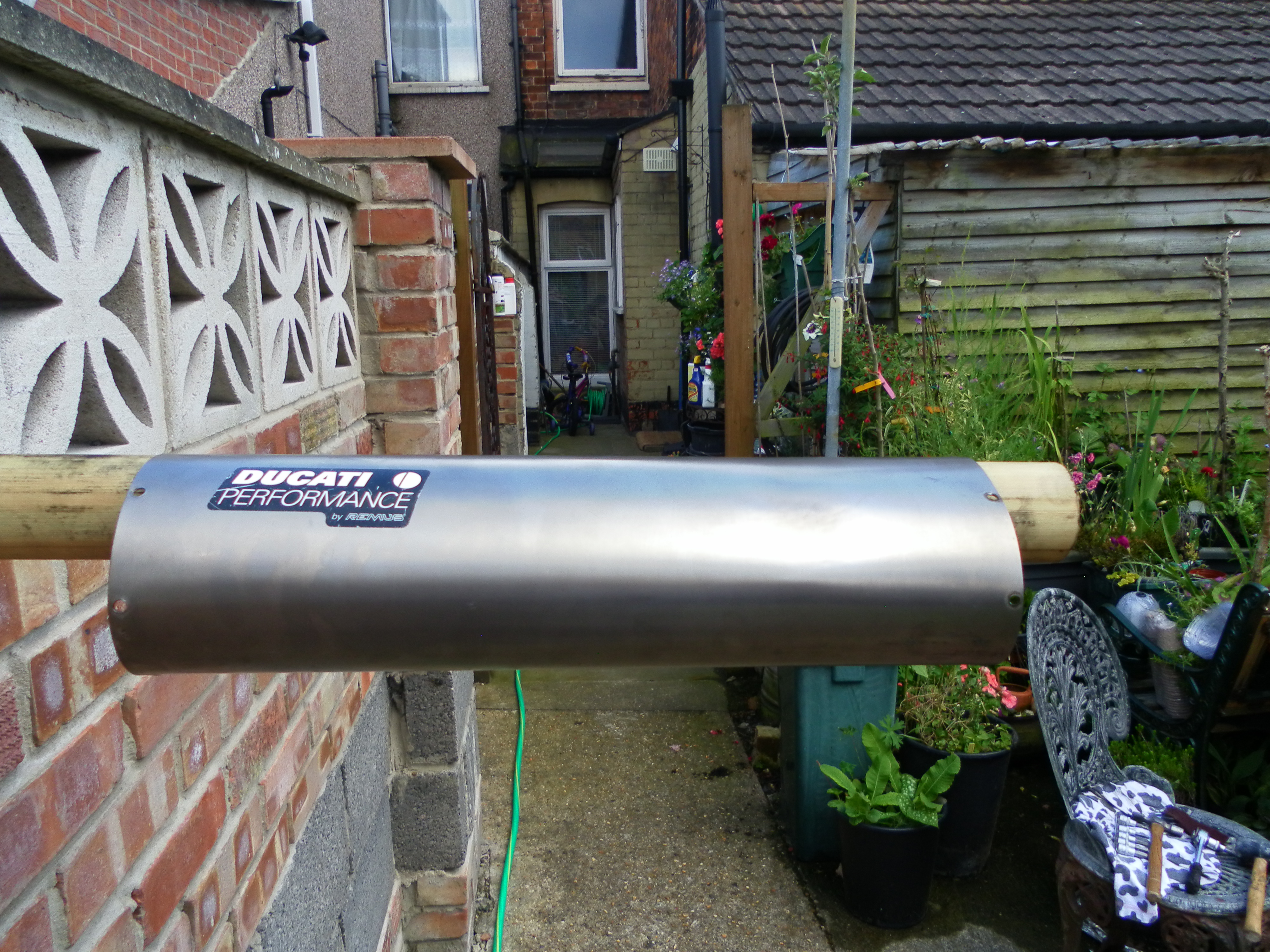

  11. you will struggle top find titanium sleeves,if you find any let me no,how badly damaged is yours??? pic
  12. What diameter are your can sleeves?
    I took my anodised alloy ones off and replaced them with carbon (probably from the same place you are thinking of).......
    If my ally cans are any good to you.......
    How badly is the brake pedal bent? I have straightened two satisfactorily.......

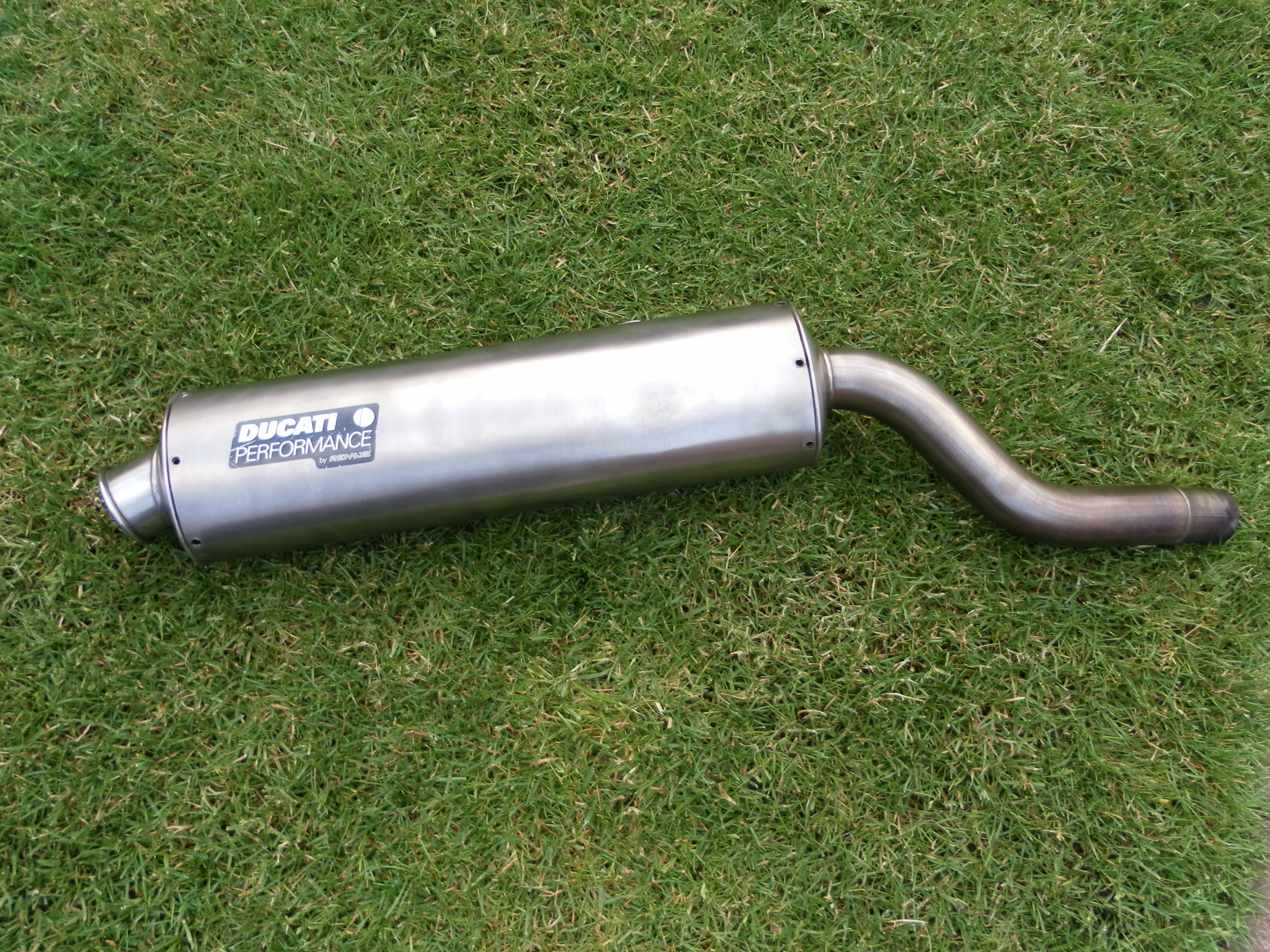

  13. well had one of the rear silencers apart and had a go at removing the dents ........
    thanks for the offer al but i think i might be able to rescue them
    the pedal is not the worst bent in 10-15 mm enough to be a pain lol
    thought about straightning it but never had great results with alloy levers before
    but keep looking at adjustable levers on ebay .........must stay sober.........
    always found the oem lever a bit low any way on with the show lol
    her is the piccys
    knocked out not too bad ...
  14. My can sleeves are round ones but are in decidedly better condition........and they are from a 750 SS IE Laser system...........the sleeves are there if you need them....

    well the exhaust i have had a look at was the right hand side
    the one on the left is more out of line
    photo shows how far out ..........but mainly put it because there is a bin in the background lol SAM_0094.JPG

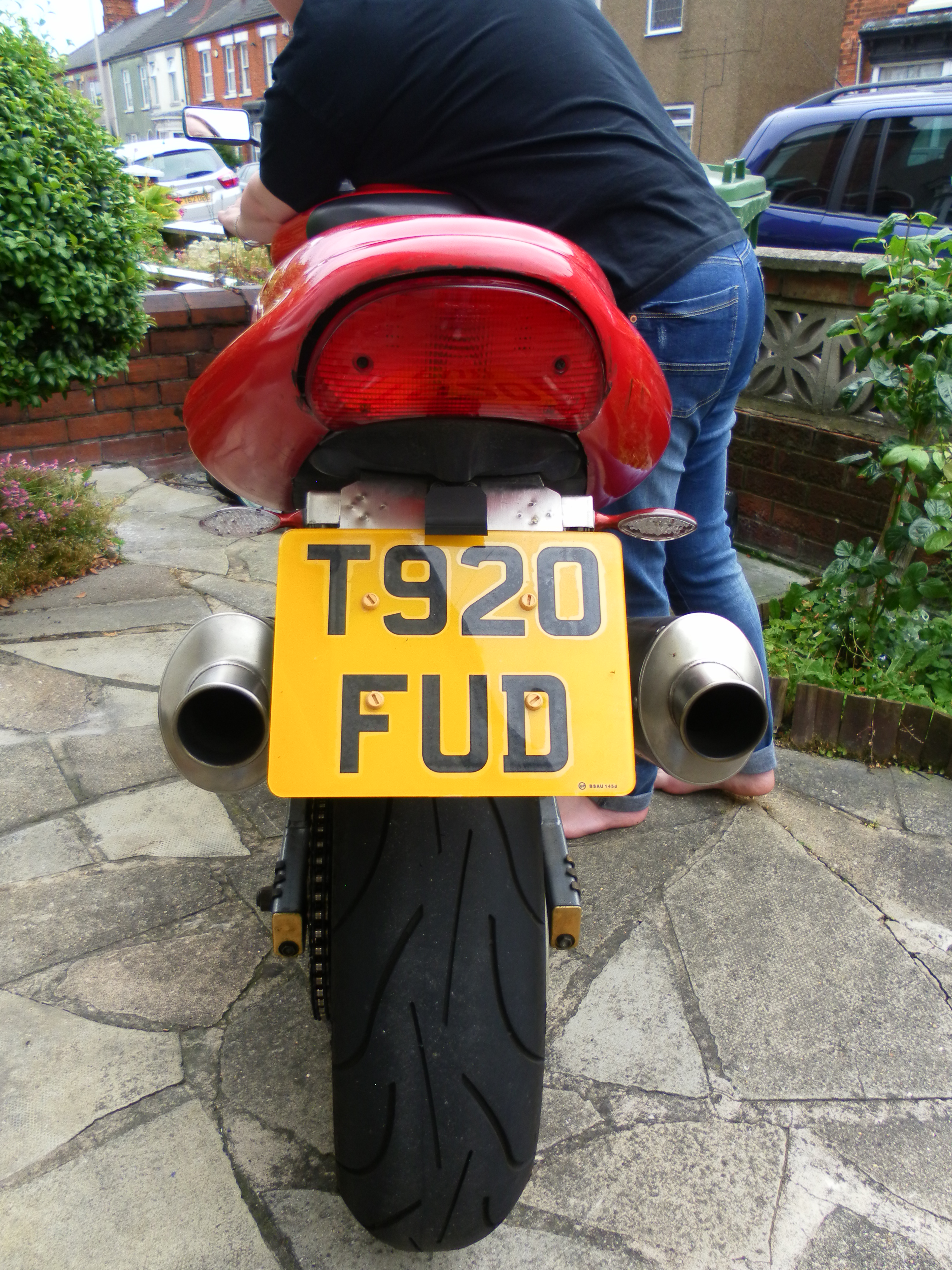

  16. well so far back on track sorted the silencers dents removed hardly noticable unless looking for the marks
    well they will do for now
    new indicators arrived and so did a nice new cnc machined brake lever
    all fitted and sorted
    exhaust hangers fixed and welded just a bit of sanding and painting
    will have to get arse in gear and get some pics up ;)

  18. Good news....
    With regard to your silcencers being out of line, I had a bit of an issue with the same thing, so I slackened off all the joints at the exhaust manifolds and the connections of the headers etc, then shoved a long bar down the inside of one of the offending can and heaved the bugger to where it should be.......I was lucky, I guess, that my cans are straight through so a bar can be stuck right inside to where the inlet is.
  19. the main bit with the exhausts out of line was the brackets were bent and snapped
    although i have never been sure that the collector section is exactley straight
    even when i got the bike lol
    but looks a lot straighter now
  20. I 'adjusted' a bent bracket the same way......
