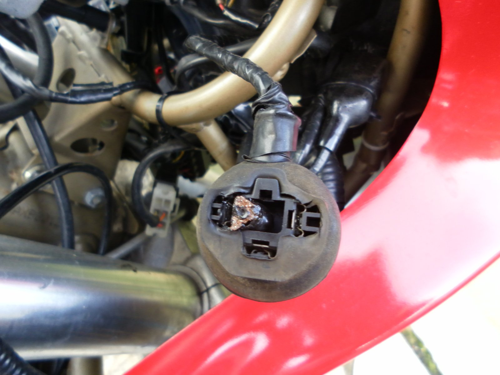

  5. okay got a break in the weather so thought I would check out the dim headlight problem
    first thought was to check voltage at the headlight connector .......only to find this hmm
    so a little bit on the warm side on the earth connector
    anyway checked the voltage with the engine running just over 12 volts
    dropping to 11.9volts when revved
    checked voltage at battery showing 12.5 dropping to 12.1 when revved
    so first thought usual suspect regulator felt a little warm for only running about 2 mins
    checked and cleaned connector back up to well above 13 volts at battery not dropping when revved
    checked at headlight connector showing now showing 12.5 volts dropping to 12.1 when revved
    so whoo more electrikery to sort
    right adding an earth might help but not really an auto electrician so any thoughts
    probably missed something really obvious :Banghead:

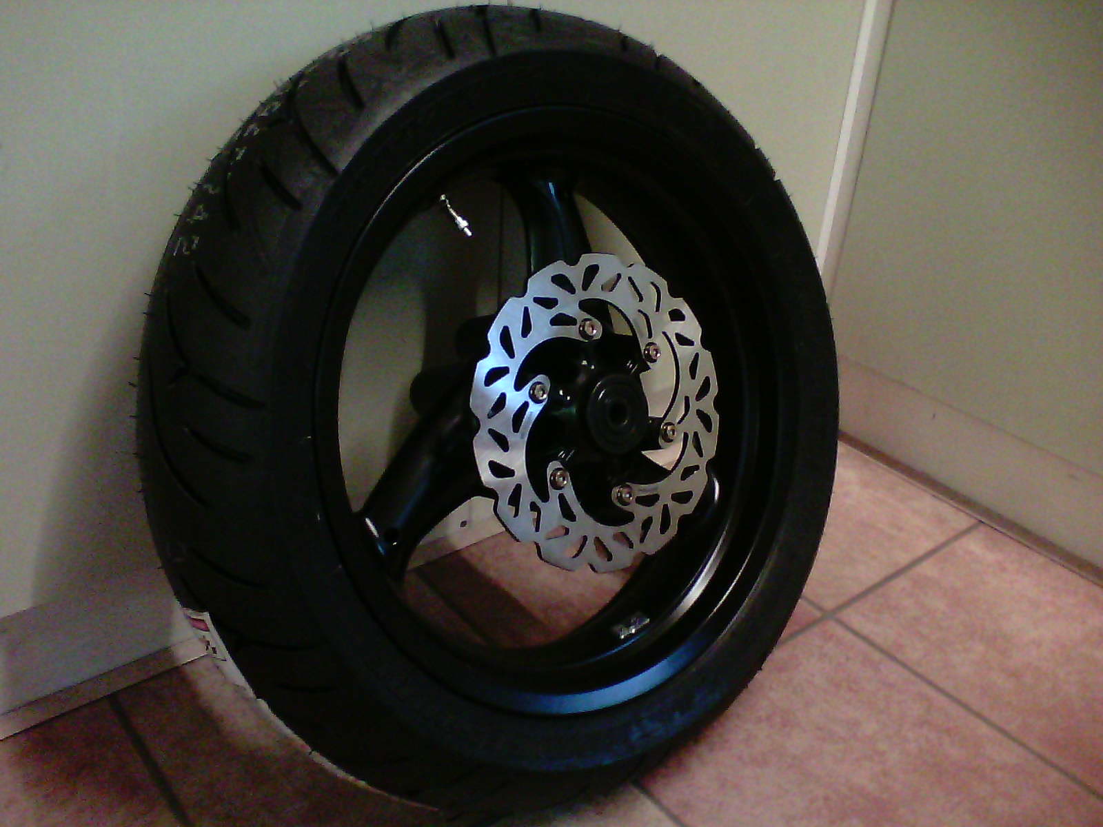

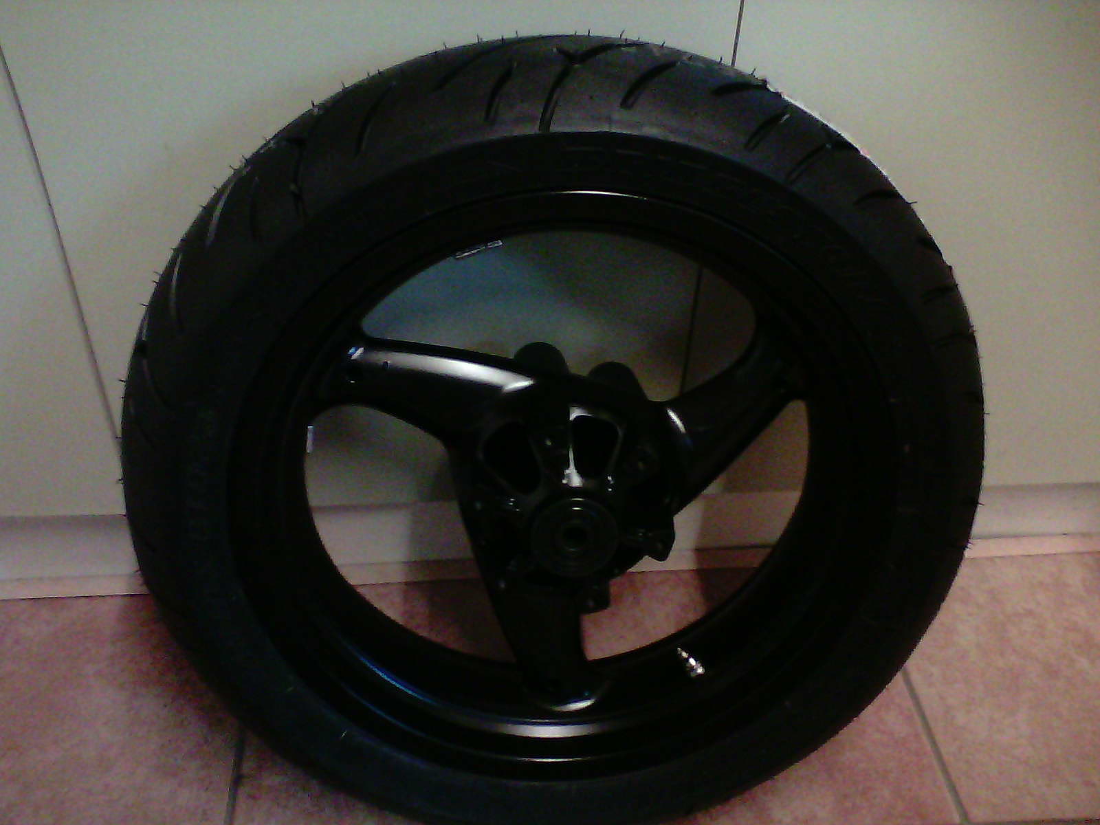

  12. ok so got my finger out and busy this week had the tyre removed so as to paint the wheel
    managed to get a tyre fitted today so on with fitting the new disc
    replaced the disc bolts with new ones as the old ones were ....well...butchered
    when I took the old disc off I was surprised how easy the bolts came out
    ie not really tight so a dab of threadlock on the new ones for peace of mind
    just got to wait for it stop raining now to put the wheel back on the bike bah :(

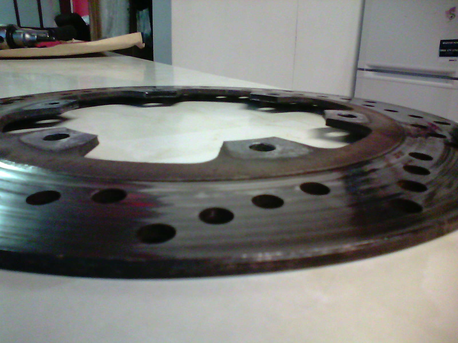

  13. oh and here is a pic of the old disc
    slightly warped me thinks :confused:

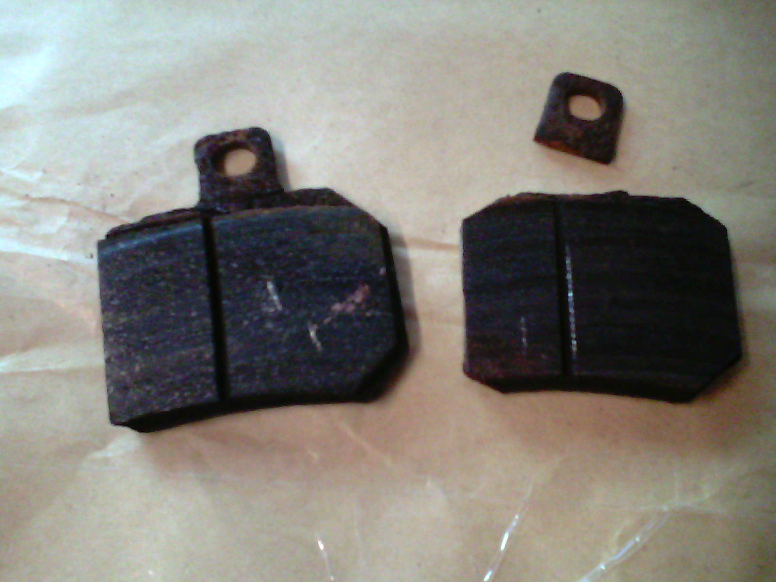

  16. whoo finaly got a break to fit the new pads and fit the wheel back on the bike
    why do people do this .........
    took the old pads out and look like someone has cut down an incorrect pad to fit plonkers
    and as I removed one of the pads realised something else was wrong
    the locating tab that the pin goes through to hold pads in had snapped off arghh
    anyhoo cleaned up checked pistons were free etc and now its all back together
    just need to take it for a spin lol

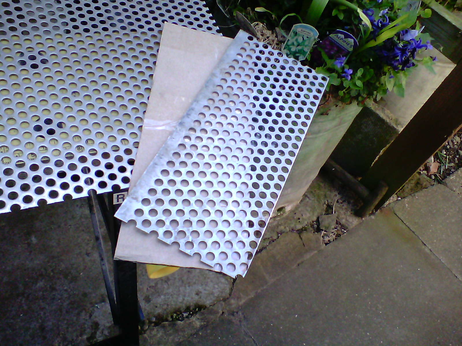

    well got round to having a go at making an oil cooler guard
    for the ss
    acquired a sheet of perforated stainless as you can see I got a bit more than I needed thanks to my local non ferrous scrap merchant near work
    my mate at work has been trying to get this off me for a grill for his car hah tough lol
    so took some measurements and finally got started
    got the main piece cut and have started on some stainless
    10 mm angle for round the edges just have to sort mounting brackets have a couple of ideas but see what it turns out like it might end up in the bin yet hah
