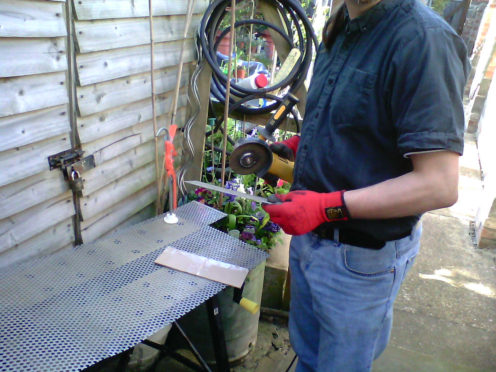

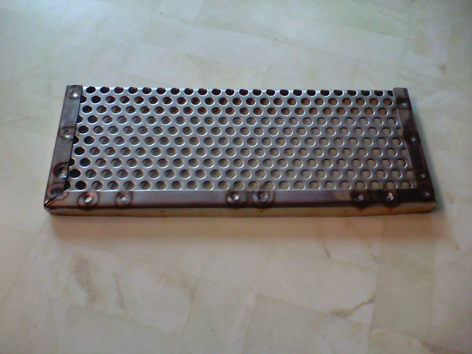

  4. well as promised progress on the squirrel I mean oil cooler guard
    main cover fabricated just got to get some brackets made
    got some cleaning to do so far after spot welding together
  5. Liking this..... Just what I need. What colour you finishing it in?
  6. not really thought of colour as its all stainless
    did you need some stainless mesh
    as I still have a bit left lol

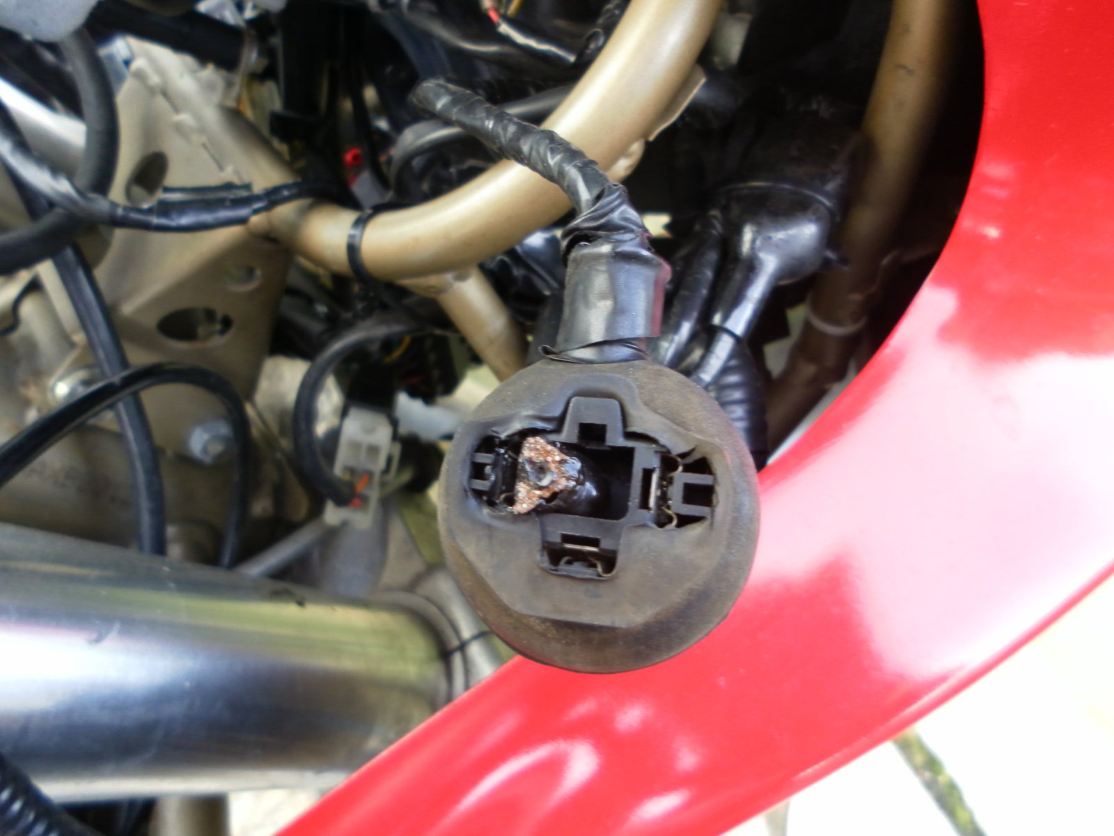

  12. well nice weather and not a lot to do so made myself busy
    having a look at the dim headlight situation
    checking voltage it seems I am about 1 volt down at the headlight compared to the battery
    also thought had better change the headlight socket as it seems to of got a little warm
    so while I was in there I decided to wire a relay in for direct feed to the headlight also a new headlight bulb for good measure
    all went well until checked operation of headlight
    no high beam ....??
    turns out the new bulb was dodgy good job I had a pack of two
    so everything seems to work and it looks a bit brighter
    jus need to take it in the dark and see

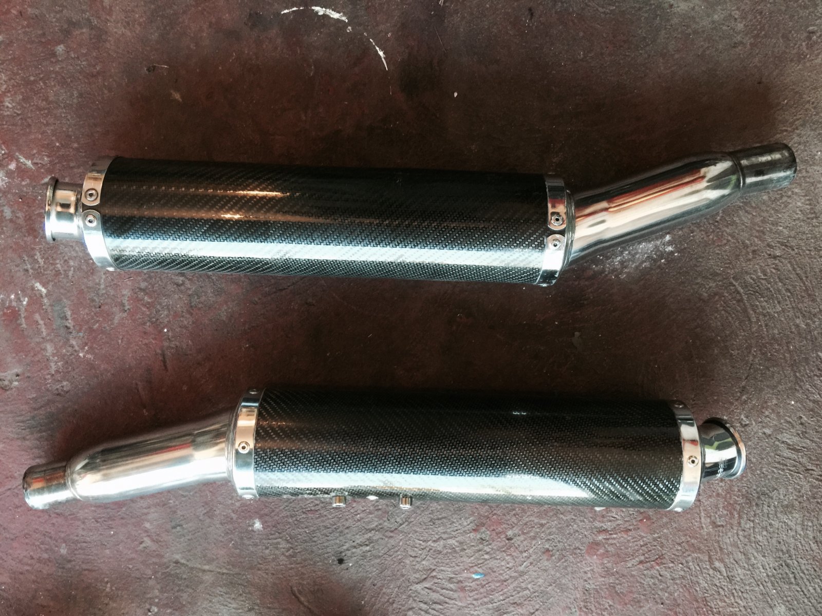

    well a bit of thinking and a chat with fire 3500 aka ian
    I now have a set of low level silencers for the bike
    looks like the plan to reinstate the pillion on the bike
    is going ahead just need some more parts and a bit of inclination whoo ;)
