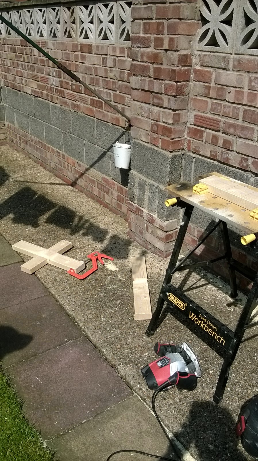

  13. well lovely weather today outside so decided to get industrious lol
    started off with my side stand
    since I have had the bike the stand has not had a foot on
    so finally got round to getting another for it
    when checked against each other realised how much shorter it was over the original length one
  14. also got busy with a bit of woodwork lol
    still bike related though made a bit of a mess oh well
    had a bit of inspiration from arquebus on previous posts
    so thought sod it and got stuck in
    not a bad afternoons work
    WP_20160505_14_29_18_Pro.jpg WP_20160505_14_29_40_Pro.jpg WP_20160505_18_26_34_Pro.jpg

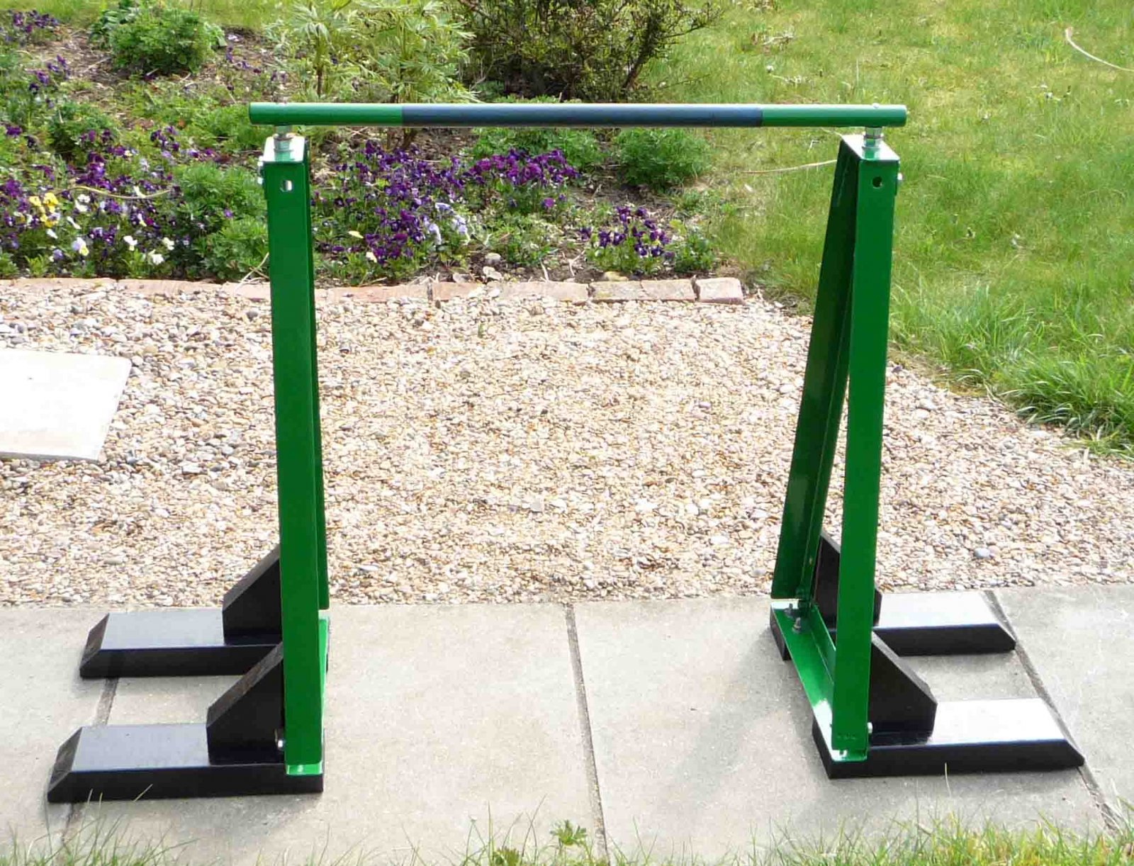

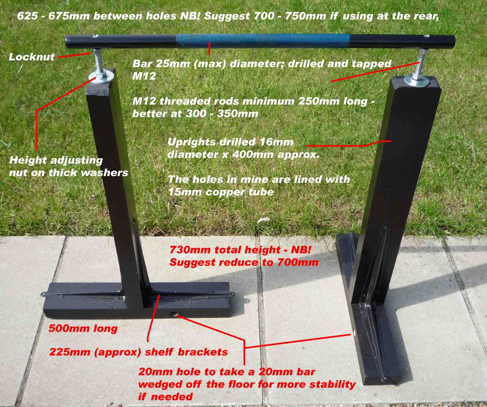

  15. Could have used a thicker bar............Mine is 25mm diameter from a weight lifting bar, with a plastic sleeve so it doesn't scratch the frame........
    Here's my front and rear stands.......
  16. 21mm thick wall stainless tube al its what I had lying around
    used it before to support the bike just had other stands
    not sure I could get much thicker bar through the frame ?..
  17. I see why it is bending if it is a tube.....Mine is solid.
    How do you jack yours up to get the front wheel off the ground?
    I'm guessing you drive the front wheel onto a board or something, then get the stand in place; then pull the board out.
    I never use my front stand on it's own.......I always use a rear paddock stand as well.
    My rear stand means I can remove the rear wheel and swingarm without removing anything else apart from the seat and seat fairings.
  18. I have done similar at the rear to work on the back end
    only used the home made stand yesterday to see if it works
    put the bar through the frame slotted into one stand
    lifted the bar at opposite side and got the wife to put
    other stand in place
    but yes pushing front wheel onto something then putting everything in place would work well and less hassle
    but was rushing I had to get daughter from school lol
    I know its not adjustable for height etc but just wanted to be able to get front wheel out
    was intending to use with rear paddock stand as well
    for stability

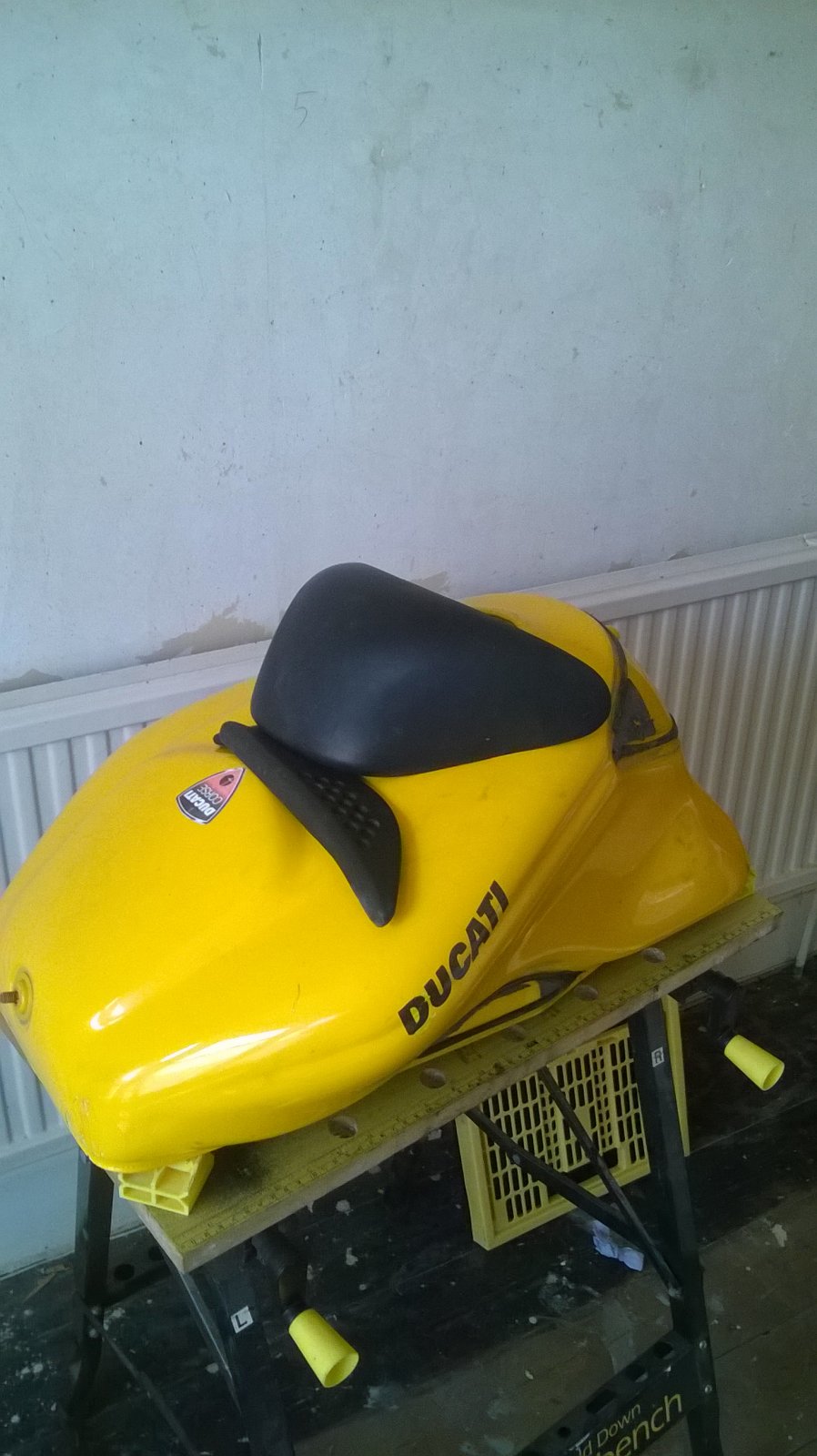

    finally managed to find a half decent fuel tank to replace the misshapen one on the bike that is full of filler it needs a respray and a small dent taken care of
    and I want to pressure test it first just to make sure its ok
    the internals don't seem particularly rusty just a little in the usual places
    also got another filler neck as well thinking of getting another pump for the tank and building it up as a complete item
    so I can keep the one that's on as a spare for maybe track day use .......
    all in tank and filler neck has cost me around £90 so not bad

    luckily managed to get the tank pad off pretty easily whoo
    although parts department at moto italia inform me they are still available ......thought they were obsolete lol
    oh well more work
