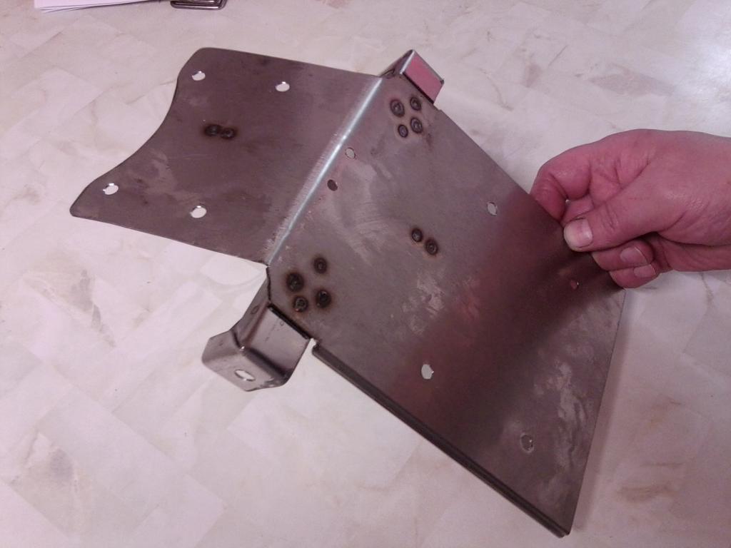

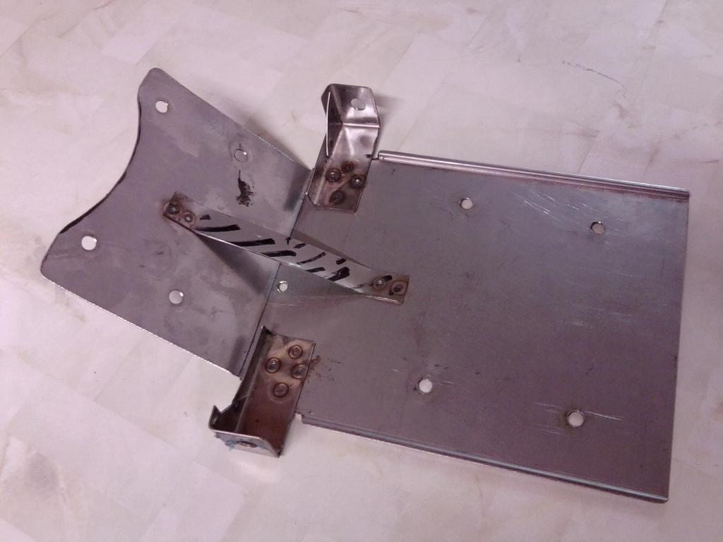

  2. been a busy boy today got my numberplate bracket fabricated just got to clean sharp bits etc then ready to fit
    also incorporated indicator brackets aswell
    will get some pics up when got it fitted aswell should look alright...........
  3. That looks neat. Looks like it weighs a fair bit though?
  4. ahh got me thinking put it on the wifes baking scales 11oz
    yeah i tend to over engineer things but it wont bloody well break lol:upyeah:

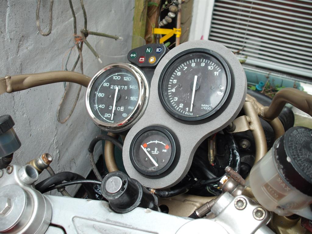

  5. well a bit of sun and parcel in the post ( cheers imola ) got me moving today
    removed top fairing and clocks to replace clock surround
    found rubber mounts were not great ie 1 broke and and a zip tie holding things down whoo and the others fairly perished
    started cleaning replacement surround as foam was quite grubby and apparently the adhesive doesnt like warm water and daz lol
    so cleaned and reglued
    well clocks reasembled and ready to go back on
    checked wiring and well some peoples idea of wiring lol
    gave up for today as i cant feel my fingers now
    well few bits ordered just got to wait now :smile:

  15. right goy my finger out and did a bit more
    more importantly took some pics
    so got the rebuilt clock assembly back on cant realy tell from pic but cleaned foam surround and intact clock surround

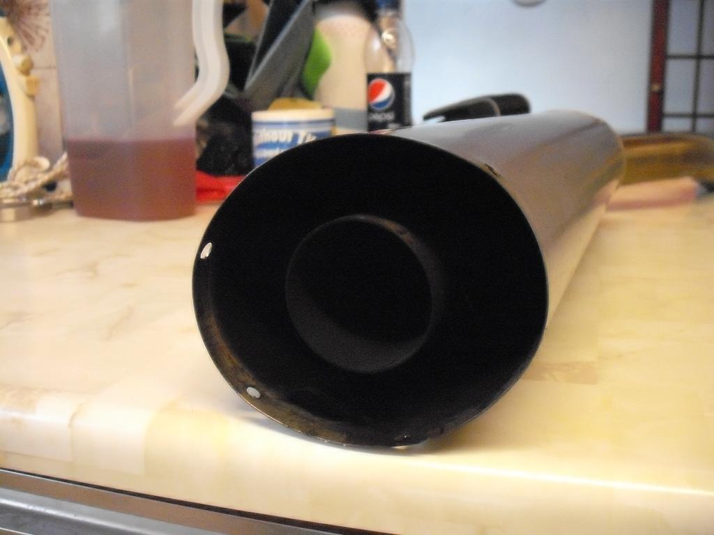

    next up today was to look at the lovely burble from the exhaust hah
    well no baffling at all so really out to put some in (old couple next door and well quite like them so)

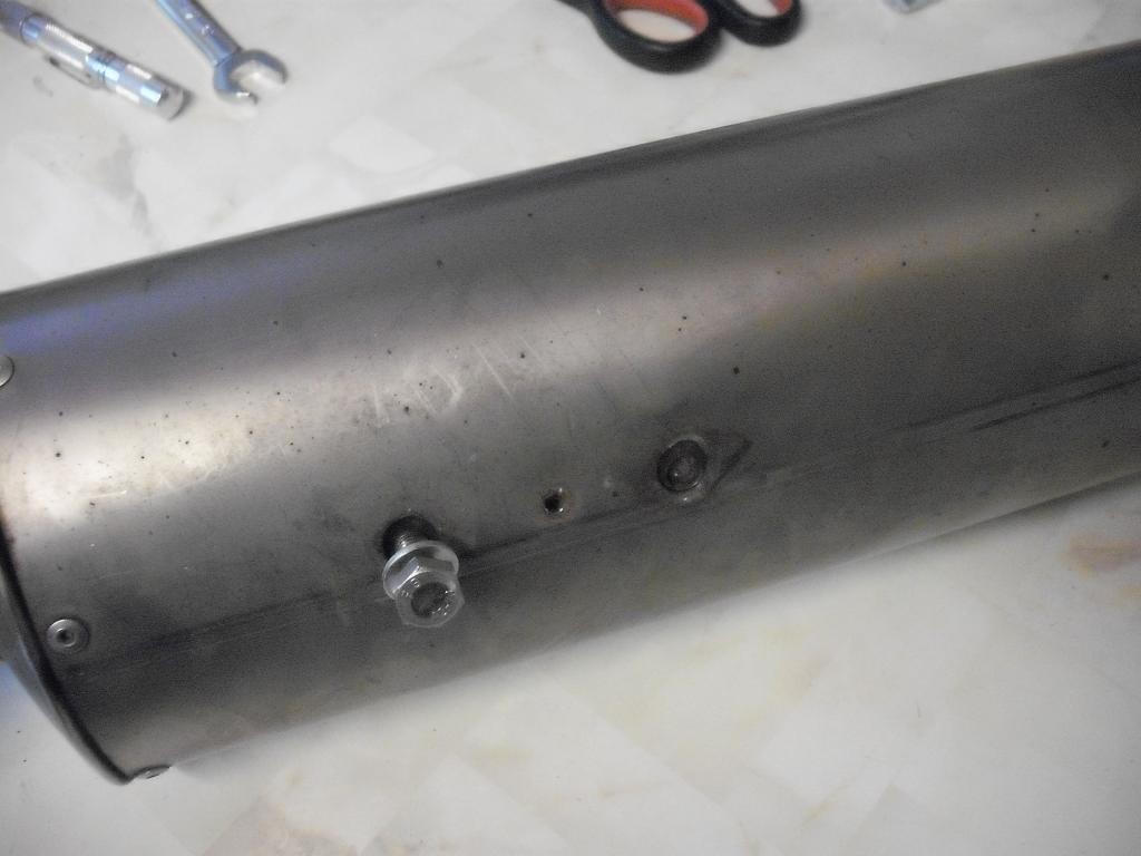

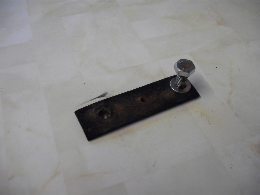

    then found that mounting bracket bolt threads on 1 hole are shot so another job
    easy weld a nut on the internal plate

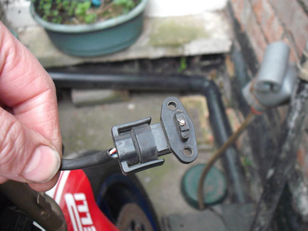

    whilst sorting wiring behind fairing found this little sensor with 2 wires just dangling
    so first where does it belong as guessing should be bolted somewhere
    and second what is it looked on wiring diagram in owners manual and the only thing i can find is air temp sensor
    well answers on a postcard to wtf am i doing . com
    now i am going to get my tea lol :upyeah:

  16. Sidestand engine cutout switch wiring?
  17. not sure what sidestand awitch looks like at the mo
    but looks like a sensor rather than switch plus wiring is about 6 inches long and located behind headlight so not sure
    will check side stand switch
    cheers
  18. Not sidestand safety switch wires then. maybe for diagnostic gizmo to plug into.

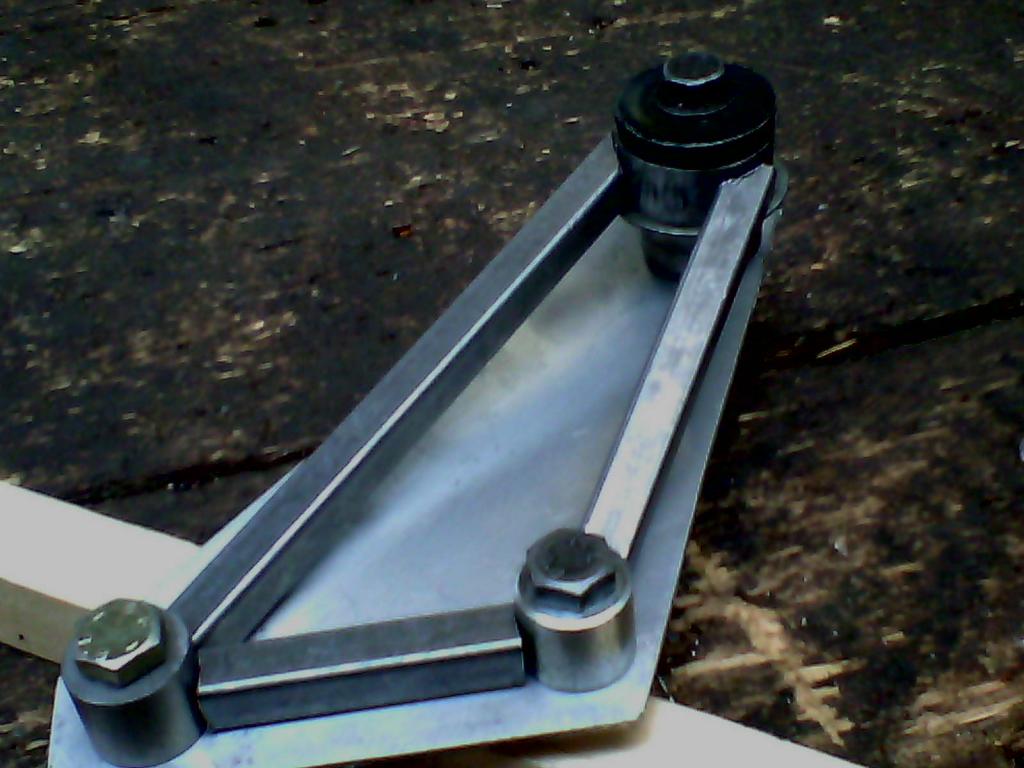

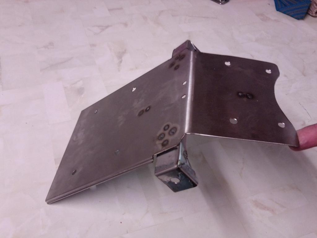

  19. ok guys been on bit of a go slow on the bike recently

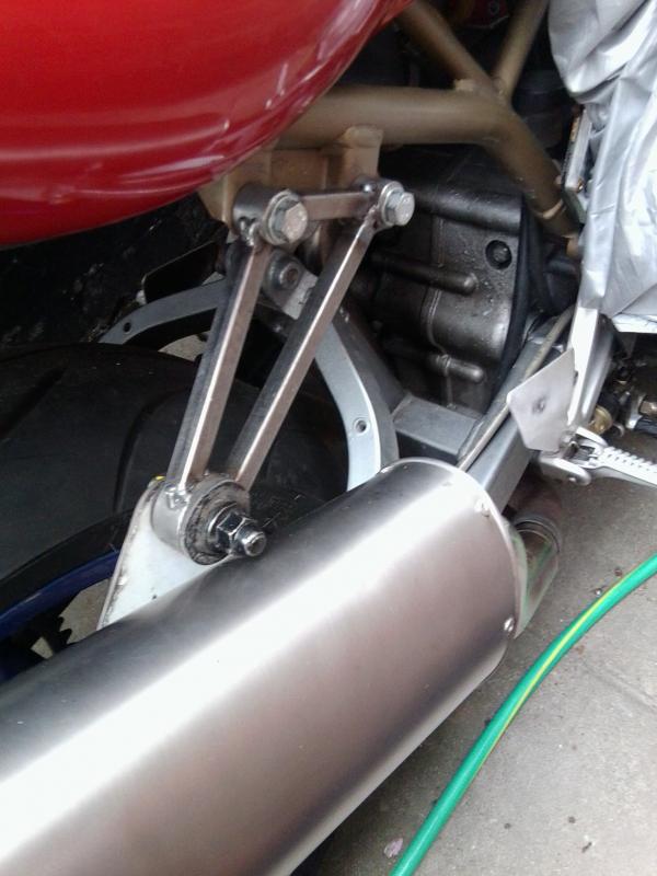

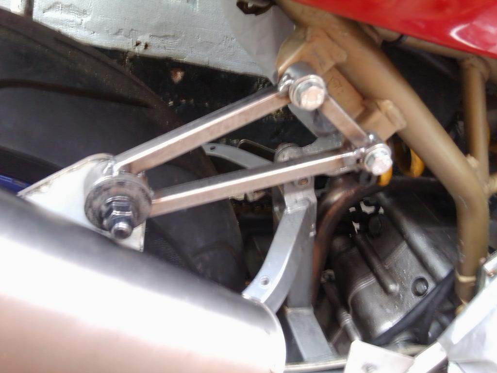

    so finally figured out what route to take to get rid of the sh*tty ally plates someone has fitted specially as they didnt fit properly and exhausts were not level
    well a bit of jiggery pokery and using the ally plates as partial template
    made a prototype for one side to see if fit is ok
    well seems to fit ok so far so just need to fully weld and finish and make another fir the otherside
    and the wife keeps reminding me i was not meant to buy a project lol
    well thats progress so far at the minute
    next is rear shock to be sorted for mot so dilema secondhand replacement or rebuild..........
