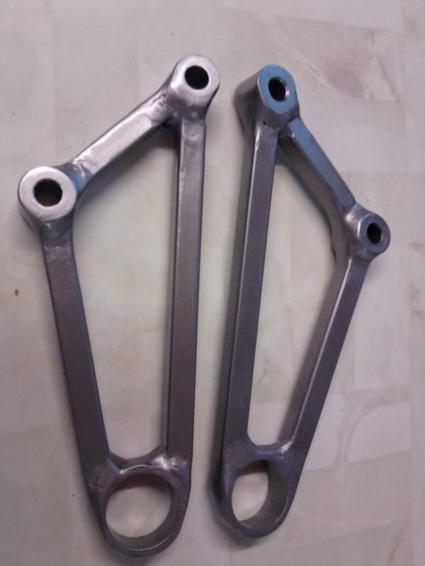

    well also fully welded exhaust hanger brackets and started to clean welds
    christ i might be in danger of getting this finished lol............

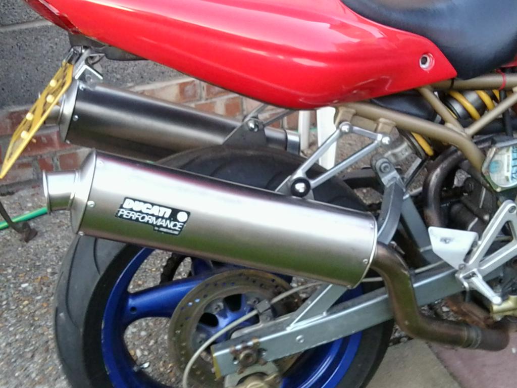

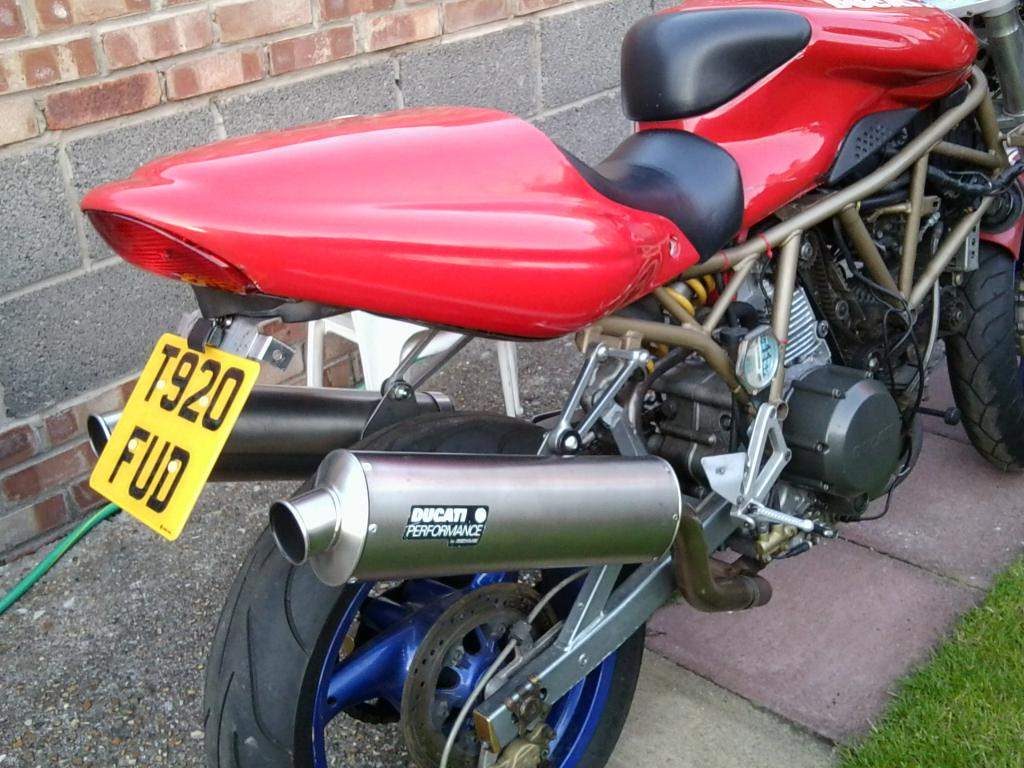

  4. so onwards and upwards today fitted my exhaust hangers now they are finished
    dont know if these will be the final jobs or i will change them at some point
    but at least the exhaust are more stable than before and at least level
    well thats one part done for now
    so thoughts on job so far seems a bit quiet on here recently...........

  9. nice work and tidier than factory set up
  10. +1 to that :upyeah:

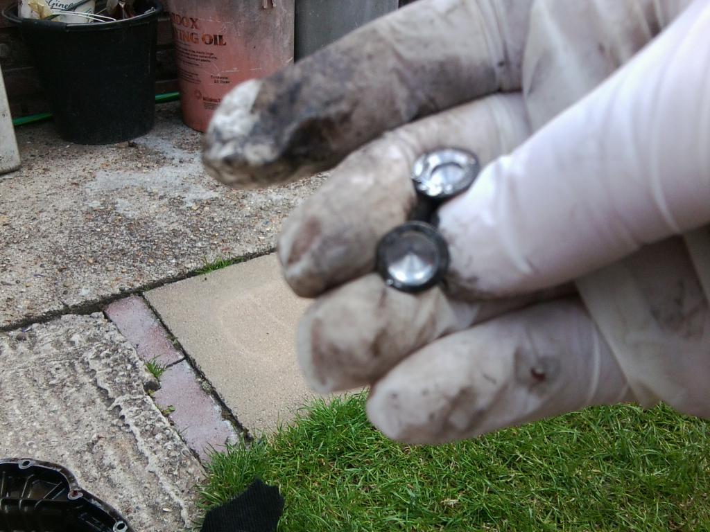

    dont you just love people who put rounded allen key head bolts back on a bike engine

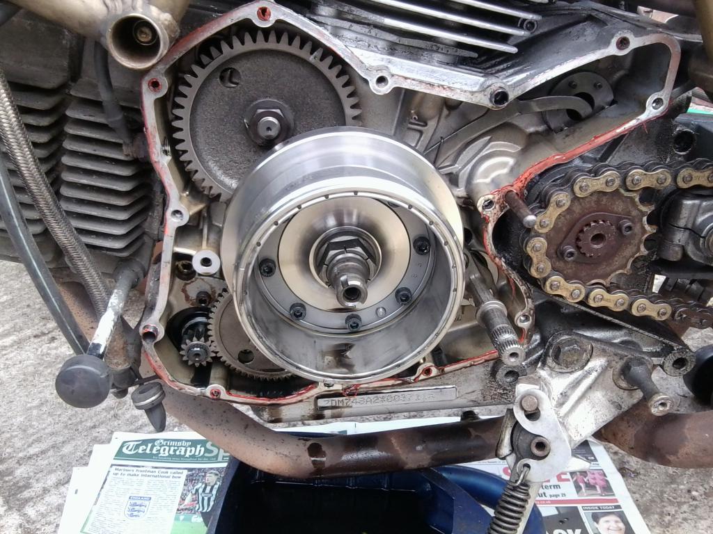

    so removed genorator side casing to sort some damaged threads mainly the ones that hold the clutch slave cylinder on
    and to get to the one next to the pushrod that holds casing on as that is damaged as well
    well found to my surprise casing wouldnt come of hmm
    cover plate with 2 screws on casing for end of crank had rounded allen key heads ended taking a drill to them
    eventually relieved enough pressure on the screws to turn them out with drill in reverse
    was expecting a retaining bolt or something similar behind plate as casing would not budge to find nothing but a bearing
    just to find casing slid off easy must have a sealed vacume on end of shaft with plate in place as wouldnt bloody move beforehand
    well its off
    so found no gasket and a load of orange silicone (just doesnt go with the colour scheme)
    right so fixed 2 threads with helicoils on casing now just got one on engine to do
    oh and found one oil drip might have been the sump plug as that doesnt have a sealing washer on it
    more drama than a mills and boon lol:upyeah:

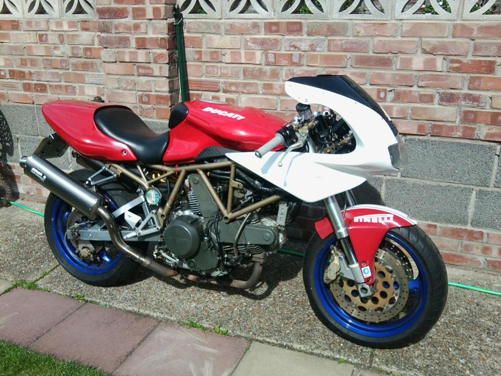

  16. well nice big box arrived today so that will be the new fairing
    will have to get my finger out and get working and get some pics :upyeah:
  17. well got time at the weekend to do some work on bike
    thought i better get ass in gear and sort the new fairing
    well using the old fairing as reference points for where to drill the holes
    so in at the deep end cordless in hand and a few measurements
    still got to get the fairing painted yet
    also fitted new bearings in the rear shock so closer to mot as well as visually better ...........

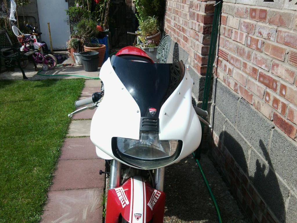

  18. well got busy putting some colour on the fairing
    fully kitted spray booth and respirator.....................sod it in the garden hanging on the washing line lol :upyeah:
    002.jpg and then the lunatics appear
  19. Like your style there Johnboy, looking good :upyeah:
  20. "Rockin' all over the world........."
    Could have at least bought two more rattle cans and done the inside as well.....
