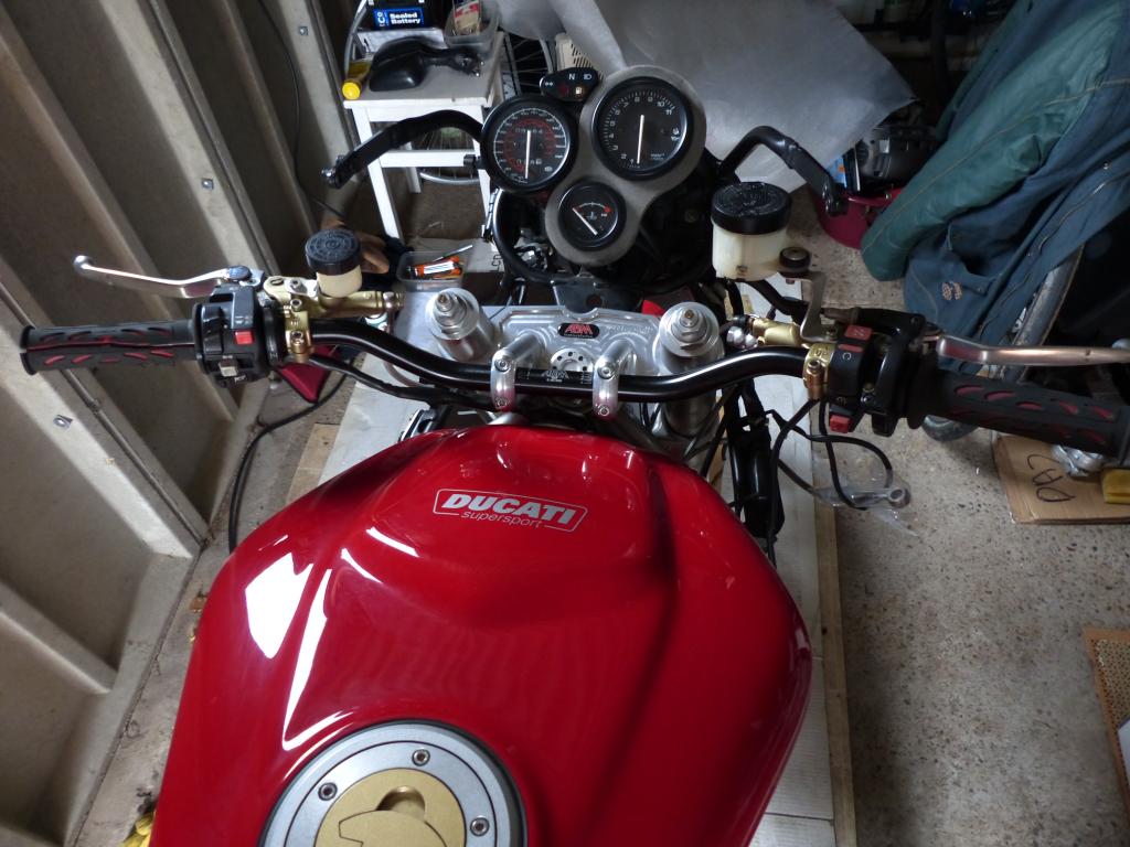

  8. Quick question, the single seat did you buy that from the fairing suppliers? Have a fairing on order as I liked the look of yours. Changing the top yoke on my 900ssie and fitting higher bars having one made by topyokes. Been interesting watching your progress too, yours is looking good... Nice one
  9. cheers bud single seat cover was on the bike when I bought it
    there was a single seat cover the same as on ebay not long back is was I good nick
    well in the pics lol
    it had white number squares on
    it was relisted a couple of times believe seller wanted £200 (cough)
    yep higher bars I must be getting old

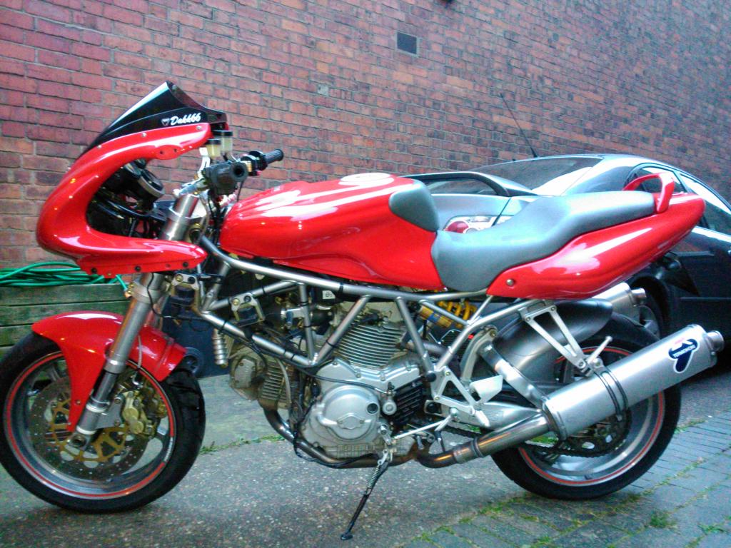

  15. hi dak66 the single seat is just a cover over the original seat and fixes in place of the original rear panels
    it uses 2 screw fixings on the side of the cover
    pic shows rear panel off and the full seat fits underneath
    at the minute mine is bits again as fuel level sensor has been leaking
    so doing fuel filter at same time just got new sensor and filter yesterday now just need to get time and somewhere warm to work on it :upyeah:

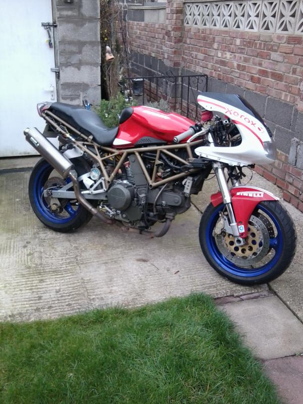

  16. That's great thanks, has your grab rail / lock assembly been removed?
    Good luck with sorting out the leak, hope it all goes to plan. Here's mine so far DSC_0069.jpg P1010690.jpg
  17. yeah seat lock and grabrail have been removed
    yours is looking pretty cool :upyeah:
