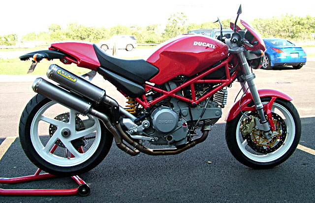

    this is the type of mudguard i have for the bike although its in black at the moment
  5. I put a monster front guard on my naked SSie but I cut about 3" off the front to make it a bit neater. Main reason for using monster guard is for a bit more protection for engine and cooler from road crap.

  7. Any monster up to 2008ish, same as in pic above with Y shaped front stay. Pre radial brake models with the white or black plastic clips.

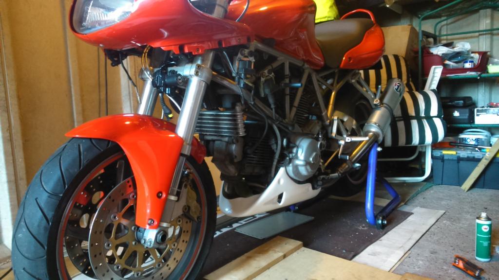

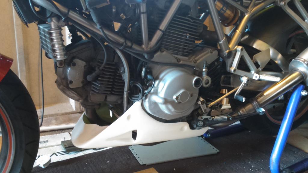

  11. Trial fit of bellypan today, think I may have to trim a little off around the stand to get it exactly right but looks promising DSC_0013.jpg DSC_0014.jpg
  12. not too bad looking bud

  14. No I am ditching that completely as I want to save all the original bodywork and replacing it with the same one that Johnboy has fitted so it should look a lot neater. I just fitted that piece to see if the new bars would clear the fairing without hitting the cylinders.
