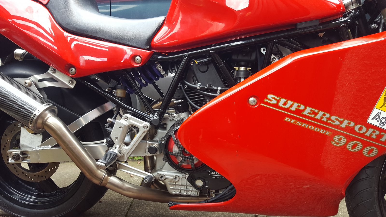

    Its looking very very nice. Hes mine taken today. 20160625_131459.jpg Still gotta couple things to do. Loke neaten up those fuel lines. But that can wait till after MOT on Tuesday.
  3. Your bike looks pristine!

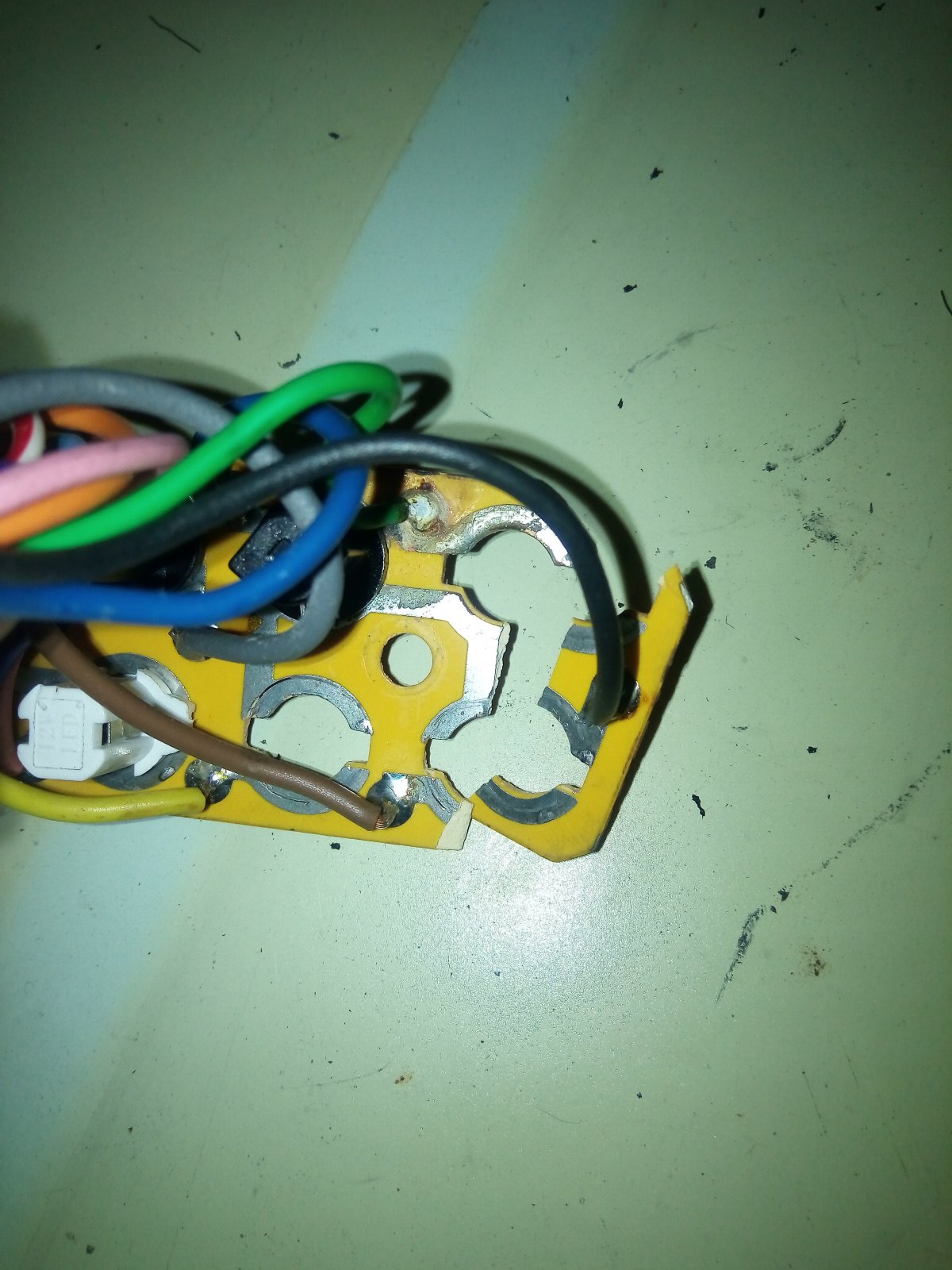

    I appreciate very much your offering on the circuit board and would love to accept it.

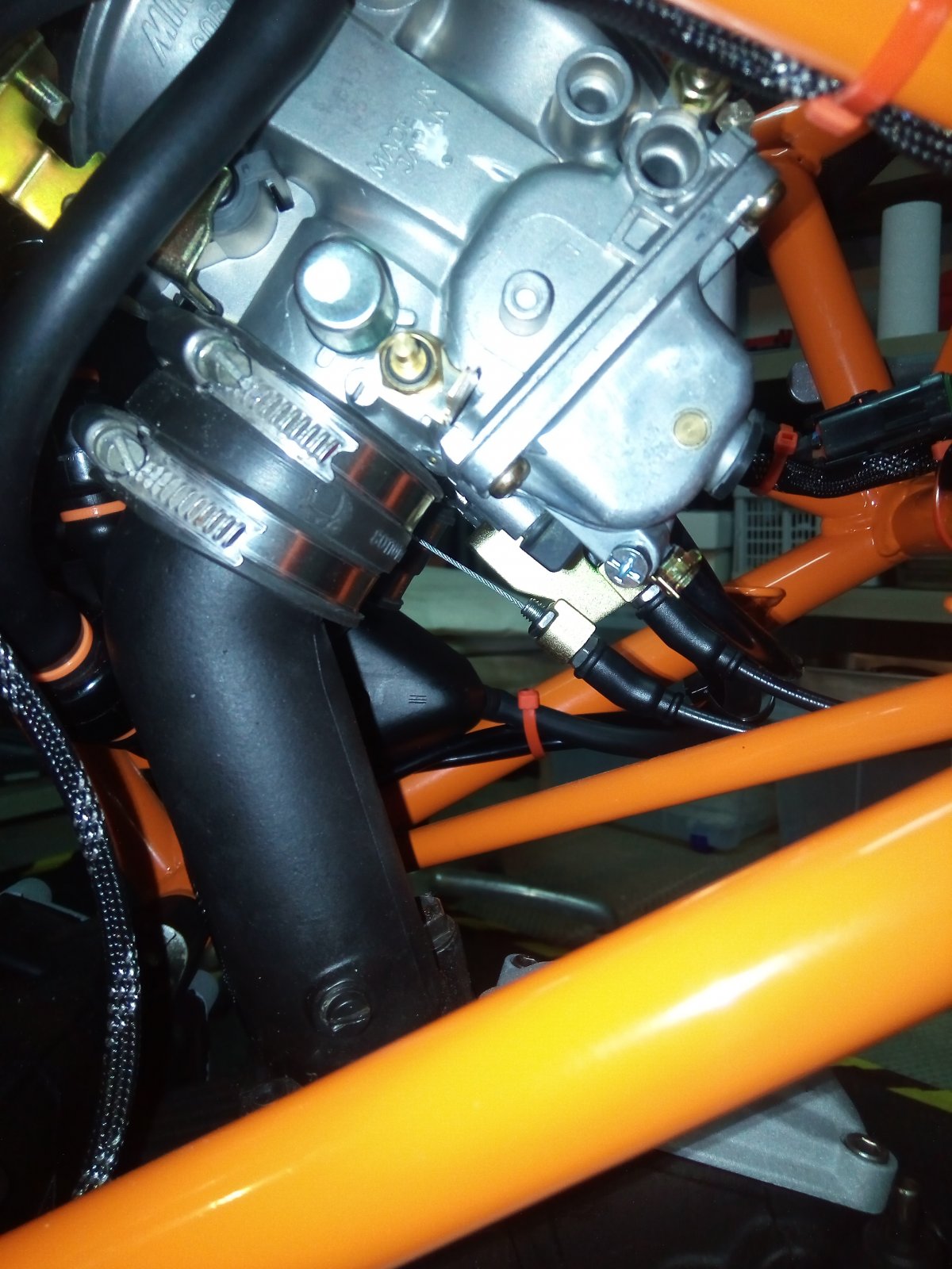

  5. When I recently stripped and reassembled my carbs on an SS, the the butterfly valve was open about that much ... I can't recall them ever closing completely when turning the throttle stop out at reassembly checks. Perhaps someone else could confirm.
    I recall roughly balancing them at that stage by inspection of gap. Perhaps, they are always meant to have some air flow, incorporated into design....
    Yet you say they used to close, and do so when you push the throttle back. Well, if it has a slack chord, then the shut off cable cannot be keeping it open unless there is a kink in it. You could simply detach it at the carb end and observe.

    As far as I recall, carbs butterfly shuts completely. And they still do if I take the throttle grip to the end.
    Is only that they do not come back by menans of the spring. It looks like there is something blocking the shut off cable (possibly in the throttle lever body itself)
    I will dissasembly the whole thing and post some pictures.

  7. If the circuit board is just two pieces, Supaglue will stick it, but you will have to do a small solder repair over where the metal circuits have broken.........But I have a spare as well.
    With the carbs, the butterflies should shut completely with no cables fitted (or with them completely slack)..........Pre-balancing can be done by using say, a paperclip or piece of wire as a feeler gauge to get them somewhere near equal.
    I agree that something must be sticking in the twistgrip...........I had a similar problem and it was only because the rubber 'handle' of the twistgrip had crept too close to the actual plastic cable housing and binding against it.
    Cable lengths may not necessarily be equal but if the adjustments are carried out by doing the shut-off cable first and then the other, you should be able to get them spot on........it is best too have a tiny bit more of slack in the 'pull' one to help the shut-off one work properly.
    Some people actually remove the shut-off cable altogether so they just have the 'pull' one.........Both mine are OK.
    Disconnect the choke cable while you are sorting it..........the choke mechanism is prone to being stiff if it is not assembled correctly.......those rubber/plastic inserts can jam it.
  8. I think if I were going to repair something as thin as a circuit board, once having superglued the two haves together and soldered the broken circuit, I might be inclined to try and reinforce the repair by gluing something similarly stiff but non conductive to the back. A piece of non-printed circuit board perhaps??

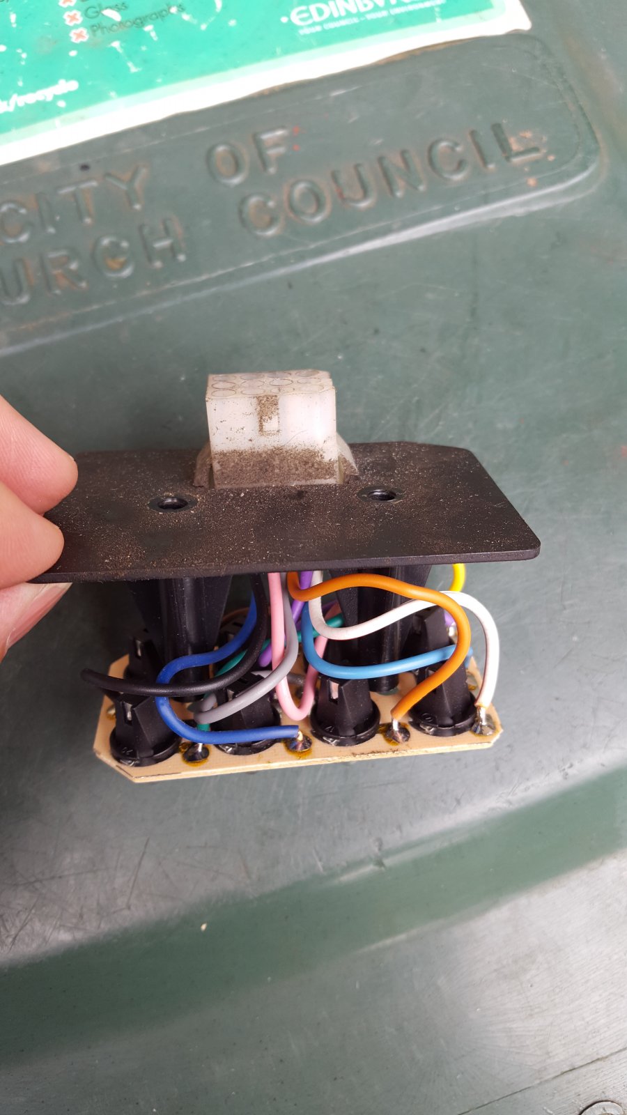

  10. 20160703_173901.jpg Tom, found one
  11. Wow!
    That is just what I need

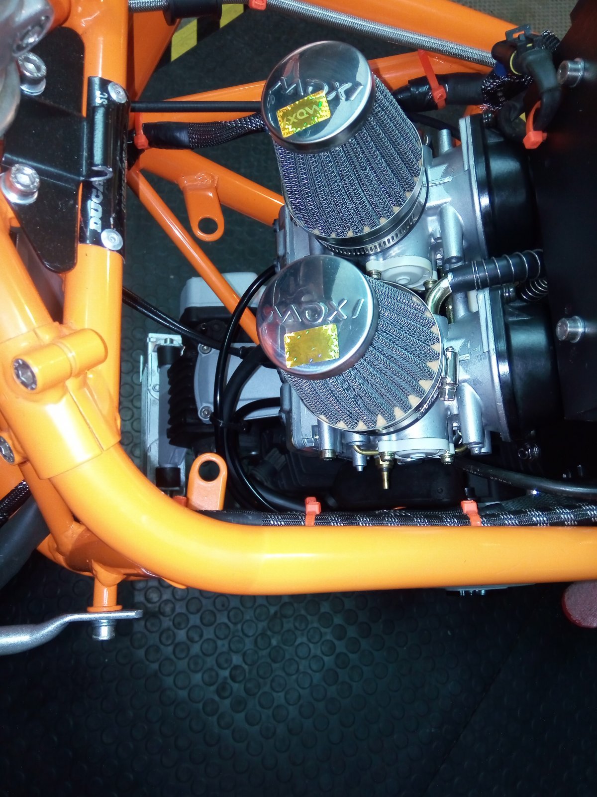

  12. Been doing some tests today on the throttle cable arrangement and definitely looks like there is some "free" movement on the throttle grip that tends to get stuck whet the shut-off cable is bonded
    I will try to install new cables and see if I can fix it. Keep you posted

  15. This was totally the issue!
    Ne cables where thicker than OEM and had a lot of friction internally when twisted towards the throttle grip.
    Easy fix: New thinner cables and guides (same size as OEM) and now it goes like a breeze
    Now everything is tidy :)

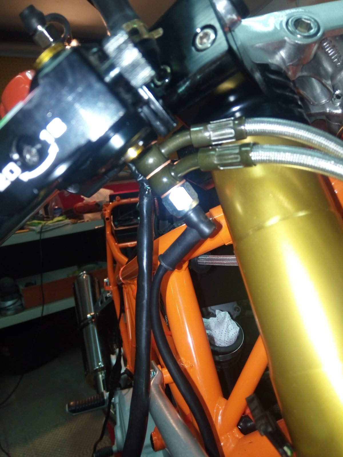

  16. Still some thinking needs to be done, as the new Brembo brake lever has a protruding nipple on the upper face and the double banjo bolt on the lower one that are righ in the middle of the way of the throttle cables eiter if you place it upwards or downwards... :( :(
    Anyhow, some good progress has been made, as all the carburetor and throttle structure is in place and tidy

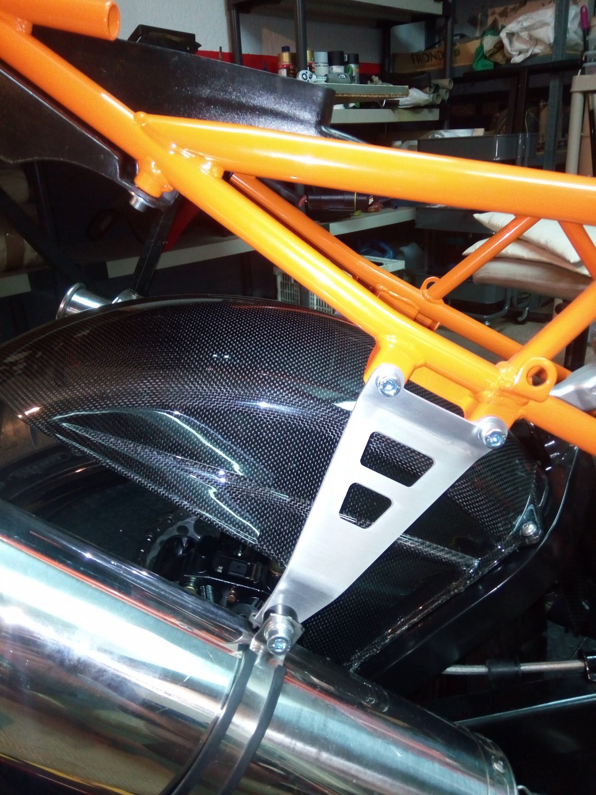

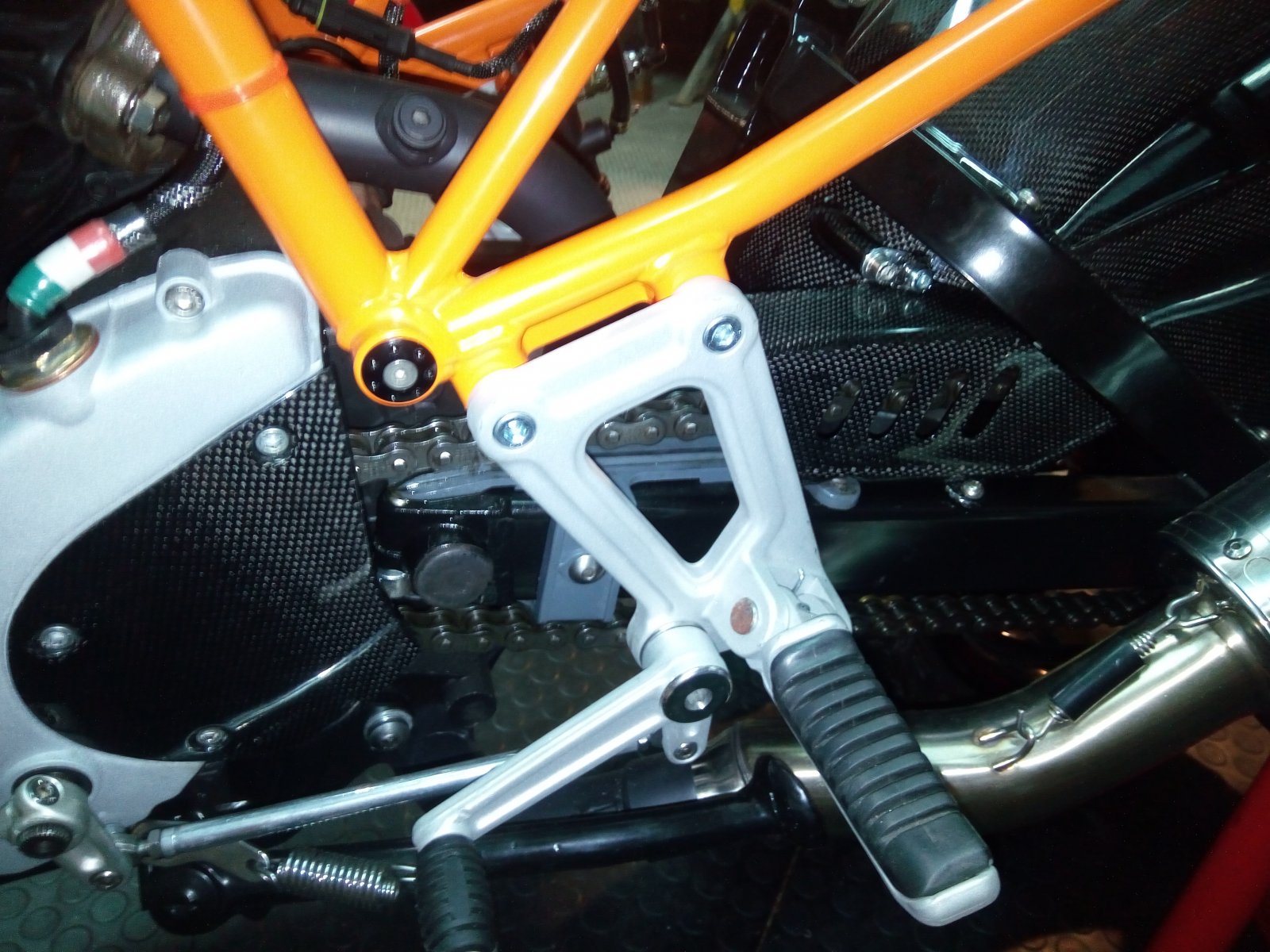

  17. Finally, Some beautiful cosmetics that I'm very happy with.
    A carbon fiber rear fender!
    And also chain IMG_20160812_152958.jpg guard and sprocket cover.
    Perfectly matching my front fender and all courtesy of RSR MOTO Quality motorcycle carbon fibre at competitive prices.
    I may say that Richard Gilbert at RSR moto is a very nice gentelman, helpful and always answering any doubt.
    Plus he also carries very nice prices on the ducati bits.
    That's all for now.
