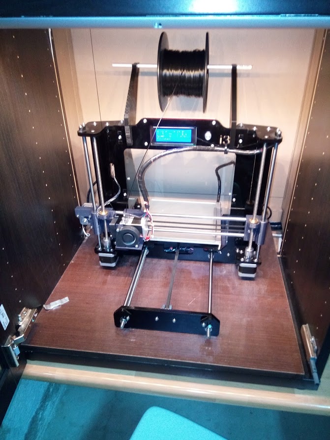

    I just borrowed my son's 3D printer and printed my own wrench
    You won't believe it!!! it works like a charm.

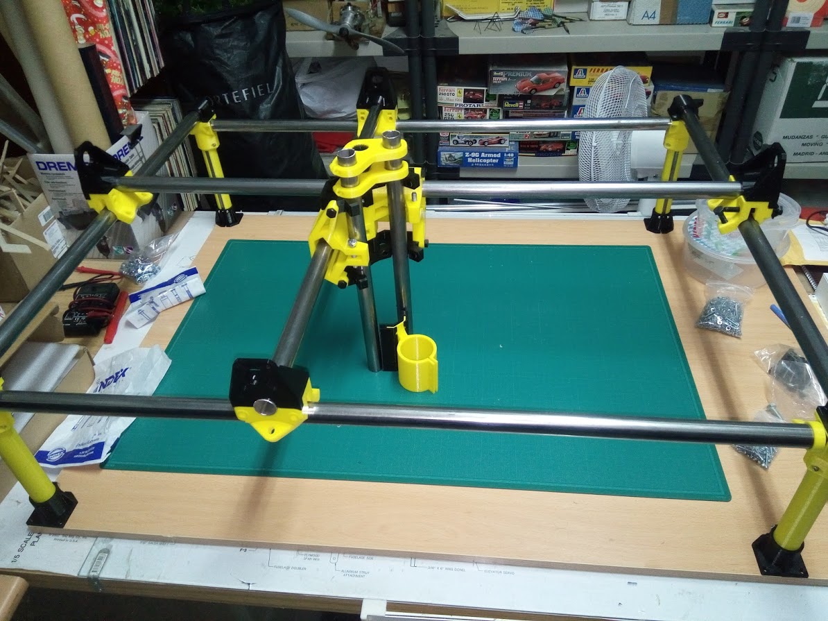

    But I also need to fabricate the brackets and some metal surface to cover with pad and trim. And thinking I could also use the 3D printer for this, but needing some material stronger than PLA plastic.. (you know, one thing leads to another...)
    I decided to fabricate my own CNC cutting mill to do those extra pieces.!!
    So, I'm using the 3d printer to print pieces for the CNC cutter.
    I think it was C3PO in starwars who said "Machines making machines,... this is obscene..." but I'm enjoying every minute of it.
    This is how the CNC cutter looks as of today
    Not yet finished. But when it is done, it will help me to cut 3mm aluminum plate to the exact measure of the seat pad, dashboard bracket, etc...

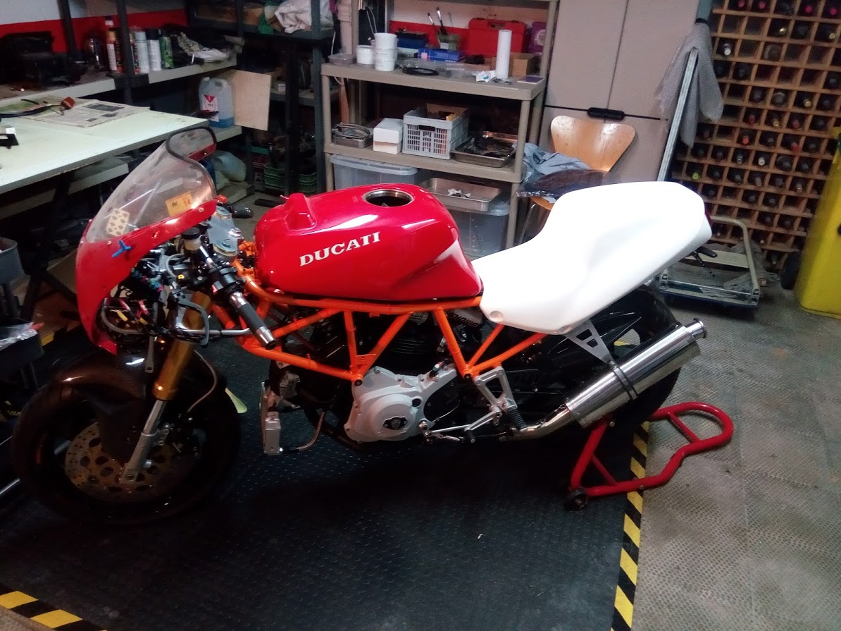

    In the meantime, the bike looks like this.
    Im trying some color tests, looking for the perfect dark metal gray color that properly points out the beautiful orange frame.
