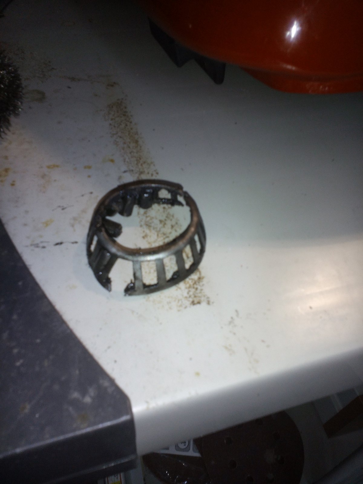

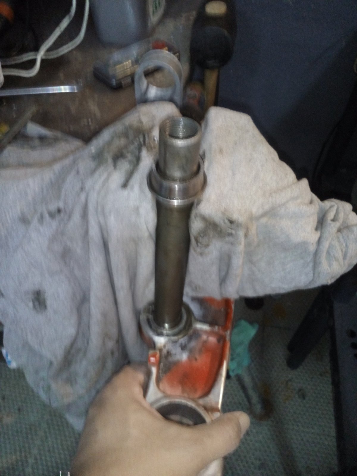

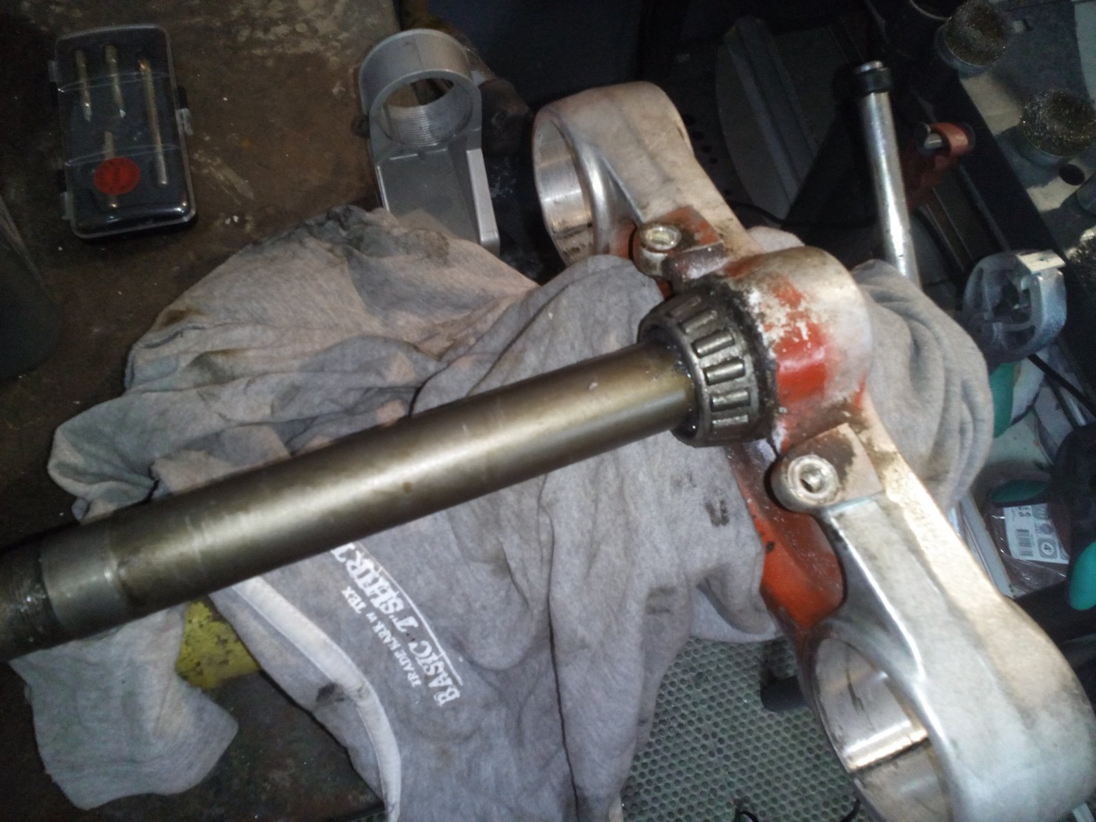

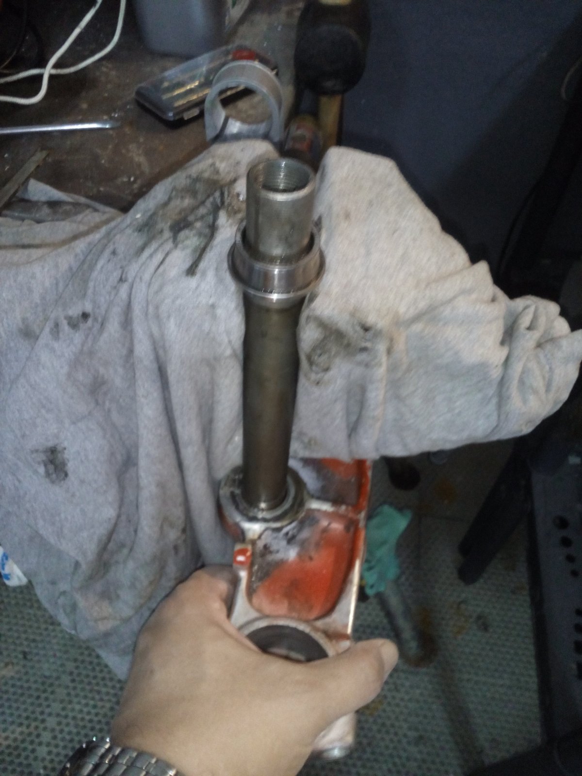

    Talking about bearings.. Can anyone advice on how to remove this one from the bottom triple clamp??

  2. One way of doing it is to hammer a knife-edge into the crack between the bearing inner race and the yoke, at different points around the circle. The knife-edge soon gets ruined, so be ready to grind a new edge on the tool when necessary. Remove the rollers and cage first, obviously.
    If the bearing inner has corroded severely onto the stem, you might have to resort to grinding right through the race - a tedious job!
  3. I have a 150mm length of engineering hacksaw blade (approx 40mm wide and 2mm thick or more) which is ground to a sharp edge across the 40mm width......the round end is kept for hitting.
    ....I used that to start shifting the bearing by a mm or so ( a woodworking chisel might work, but blunt the end a bit) and then used wider blade screwdrivers working at 180 degrees around the bearing until I could clamp it the vice and twist it off...........
    I may have used heat and, I may have removed the roller cage off as well....can't remember.
  4. Adecarcer,
    I used a small dremmel type tool with some of the small cut off blades. I cut through the outer and removed the cage. The cut through the inner shell as far as I could without cutting into the stem or yoke. You have to cut at an angle to get in as far as you can. Cut in as much as you can or dare and possibly in a few places. I then hit it with a chisel. sounds drastic but the material is very brittle and mine flew of in bits so wear goggles. I did this because I did not want to run the risk of denting surface where the bearing sits.
    That's what I did.
    Cheers Gaz
  5. I removed the cage then put the inner sleeve which had corroded onto the shaft in a vice (ready to grind it off) and it cracked,Result !, without having to grind it, it's very brittle so give it a try.

  7. Thanks all for the tips. Still fighting with the bearing. I'll be carefull as I don't want to scratch the yoke shaft.

  8. The vice idea worked great!!
    It didn't crack, but gave me sufficient vertical grip to "gently" hammer the sleve out. It came out like a breeze :)
    First I had to break the cage with pliers.

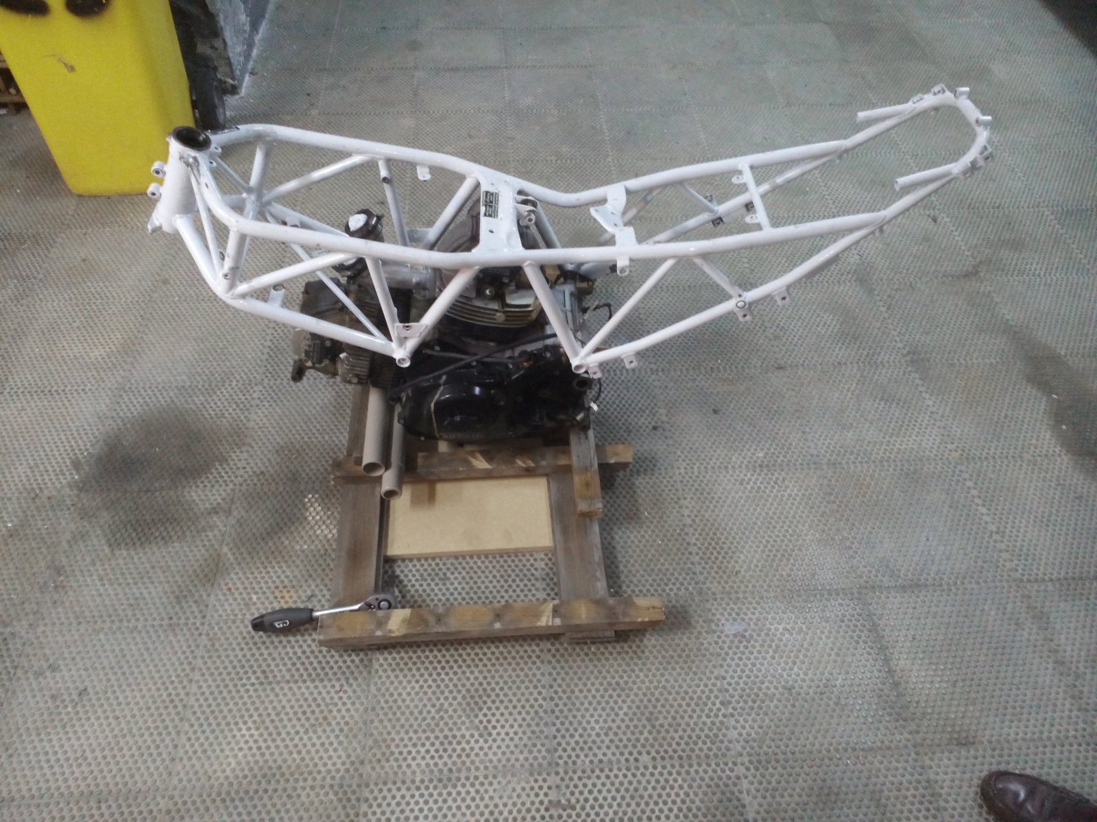

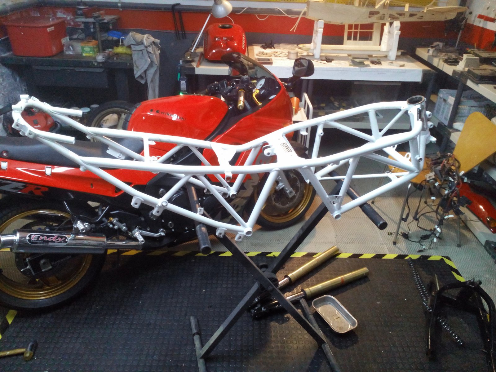

  13. Well, finally removed the engine.
    Now this baby is set apart while I figure how to sandblast (or soda blast) it without having to tear it apart. but that will be after summer.
    No my next step is to send the frame to powdercoat

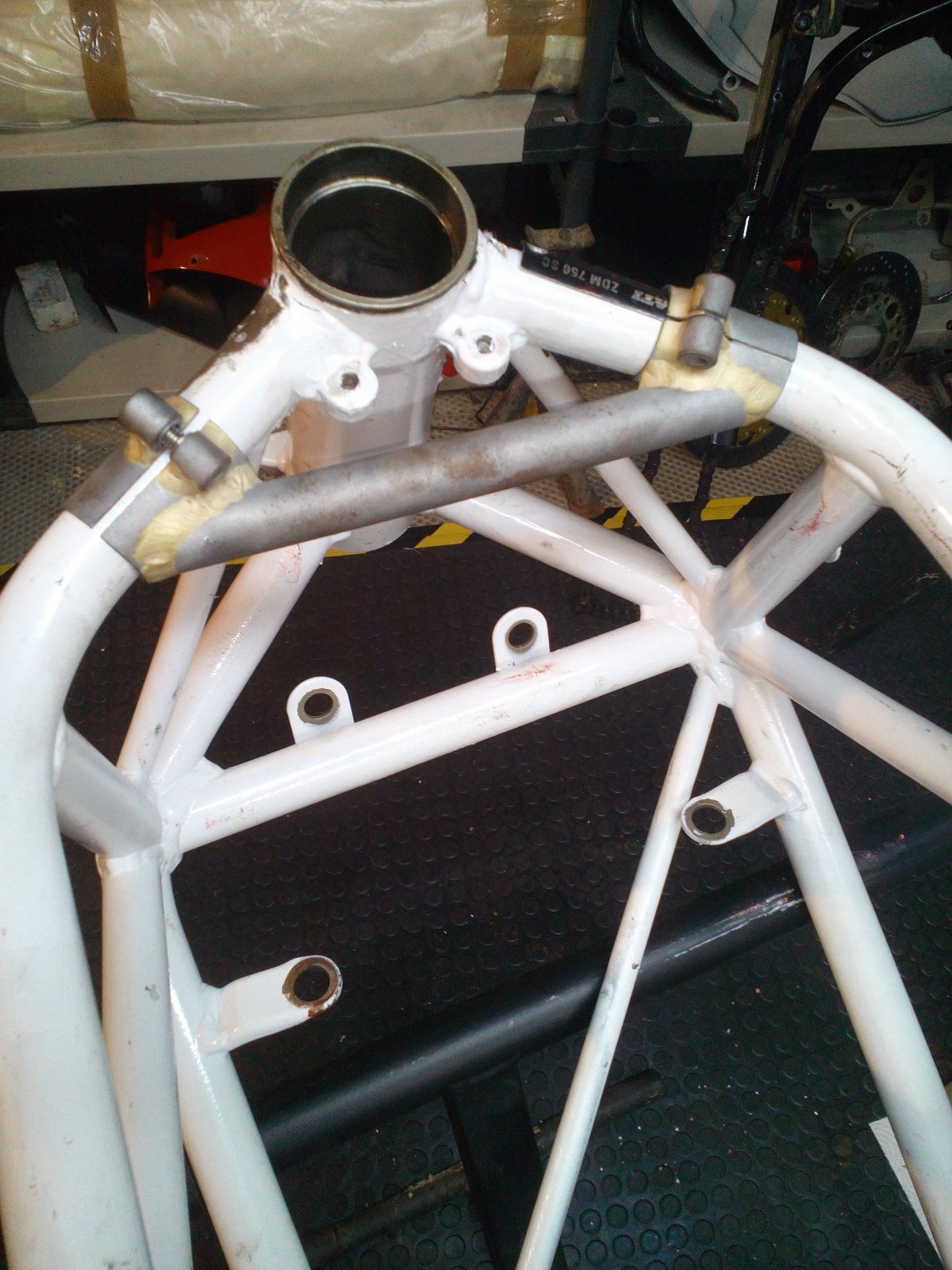

    And REALLY GOOD NEWS!!! :) :)
    Finally Steve Bailey raised his hand and sent me the frame brace. No excuses, no explanations.. just sent the piece.
    So far, so good. A very nice piece of craftmanship, though I would rather have a better communication with the seller.
    It fits perfect and will be also powdercoated (luckily next week) toghether with the frame.

    I need another brace for my other 900SS, I might just get a batch done and then offer an overnight service!
  15. Hi Tom, I tried soda blasting my engine but it was so grubby it had little effect, I used sand, more aggressive but still a good finish, just make sure you block off all the ports, the sand gets everywhere.
    Also the brace in your picture is correctly fitted, you can fit it upside down and it interferes with the fuel tank as I found out, just make sure you always fit it as in your photo.
  16. Thanks for the tip on the brace Iguana. I didn't realize that.

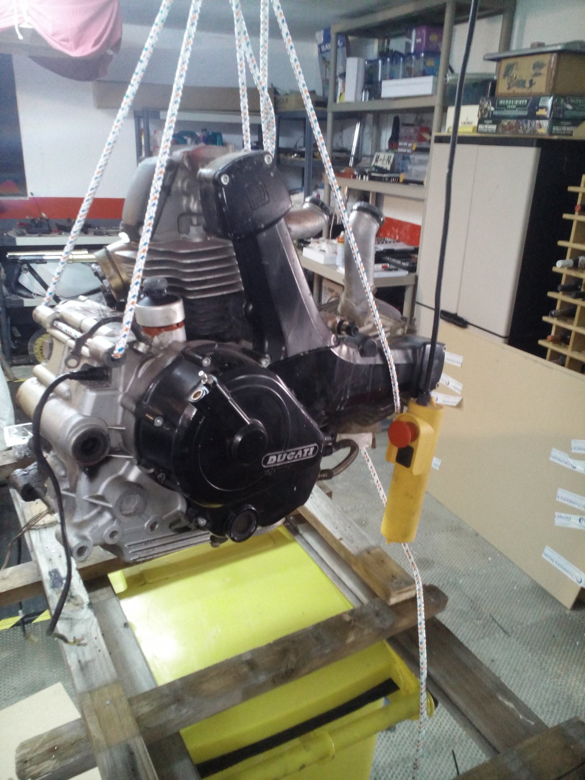

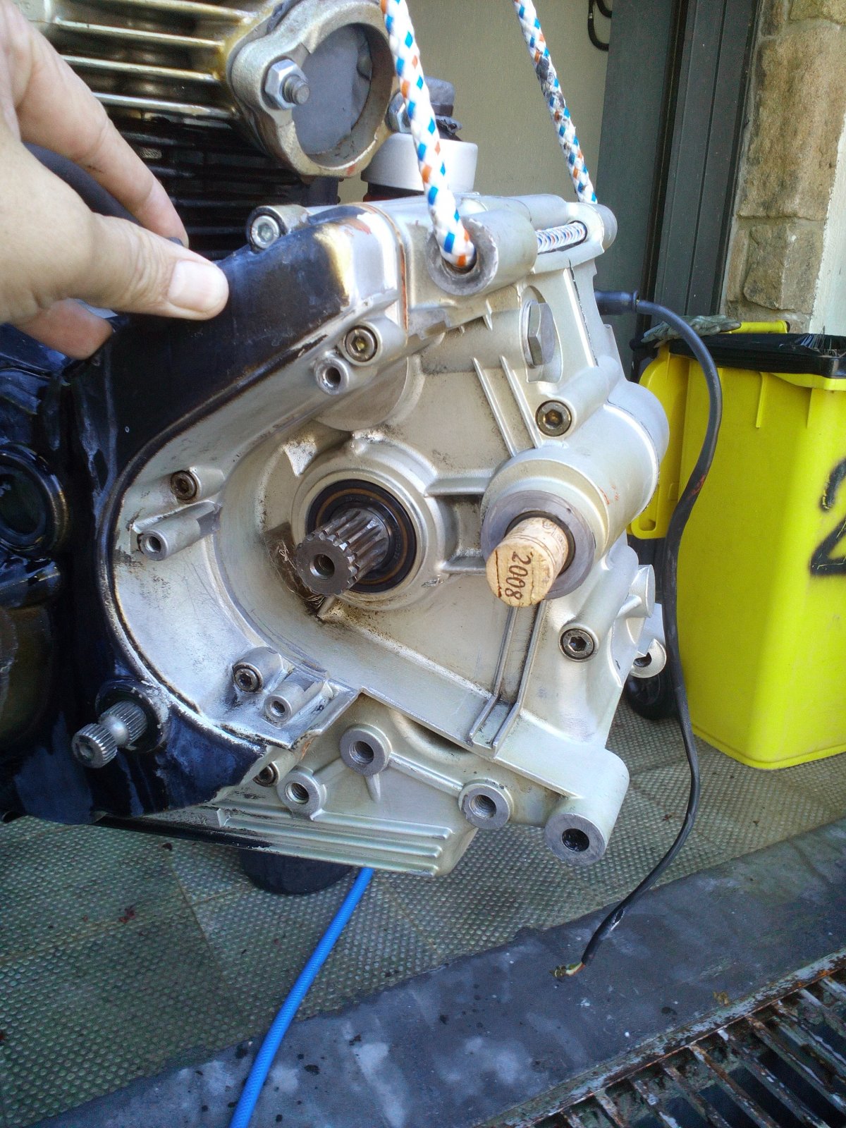

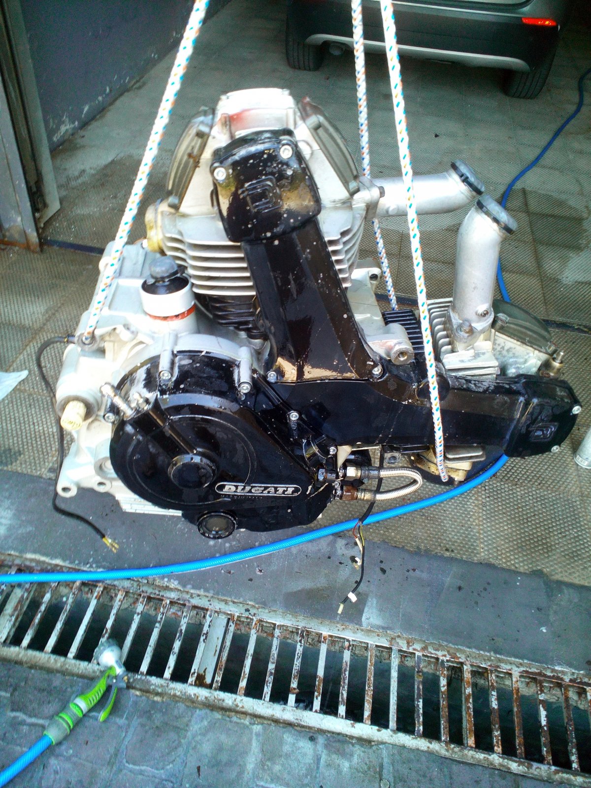

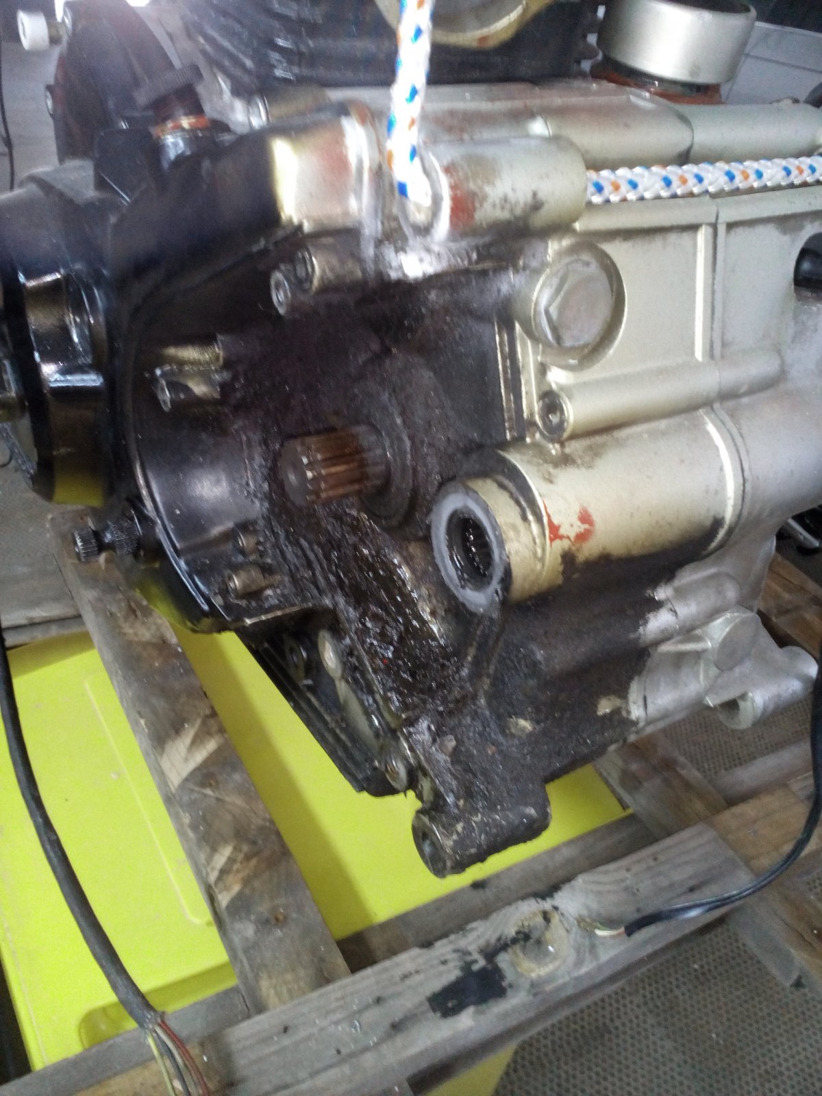

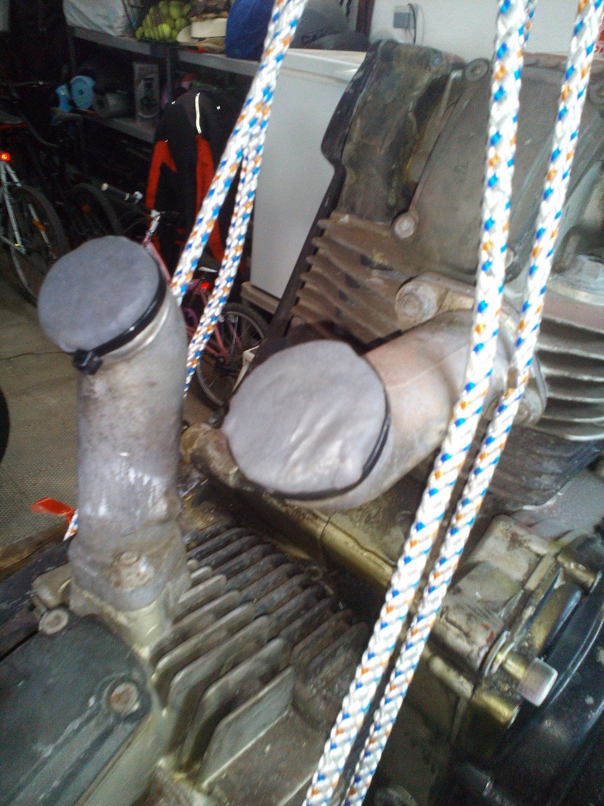

  19. While considering sandblasting (and after Gaz's serious advice,I will consider it very carefully :) ) I felt like I first needed to fully clean the engine to find out what is the real need.
    First I hang the engine to have better acces using a simple winch I have in my garage
    Carefully sealed all holes
    and sadly sighed upfront the load of work to be done
    grease and rust of many years were all over.. :( :(
    Nothing that a couple of hours work and some bottles of KH-7 and other degreasers could not remove....
    this is how it looks now
    definitely.. I needs to be painted. :) :)

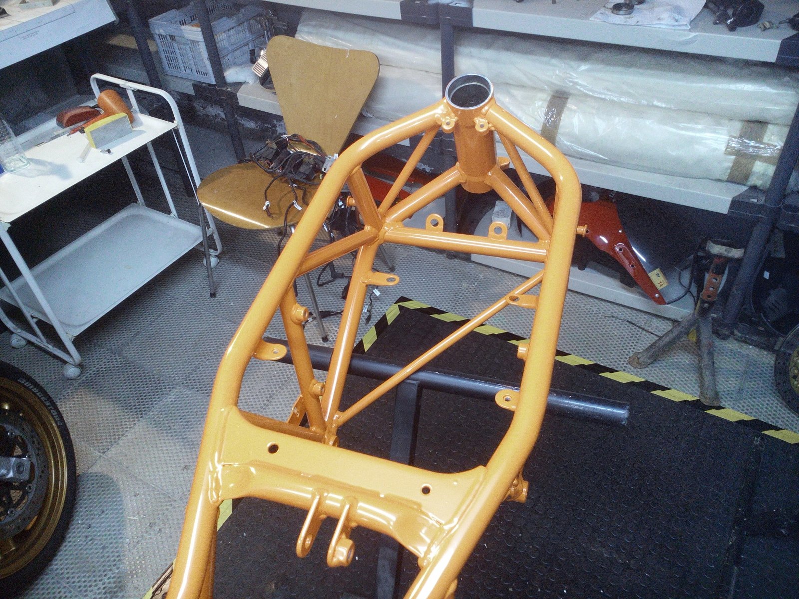

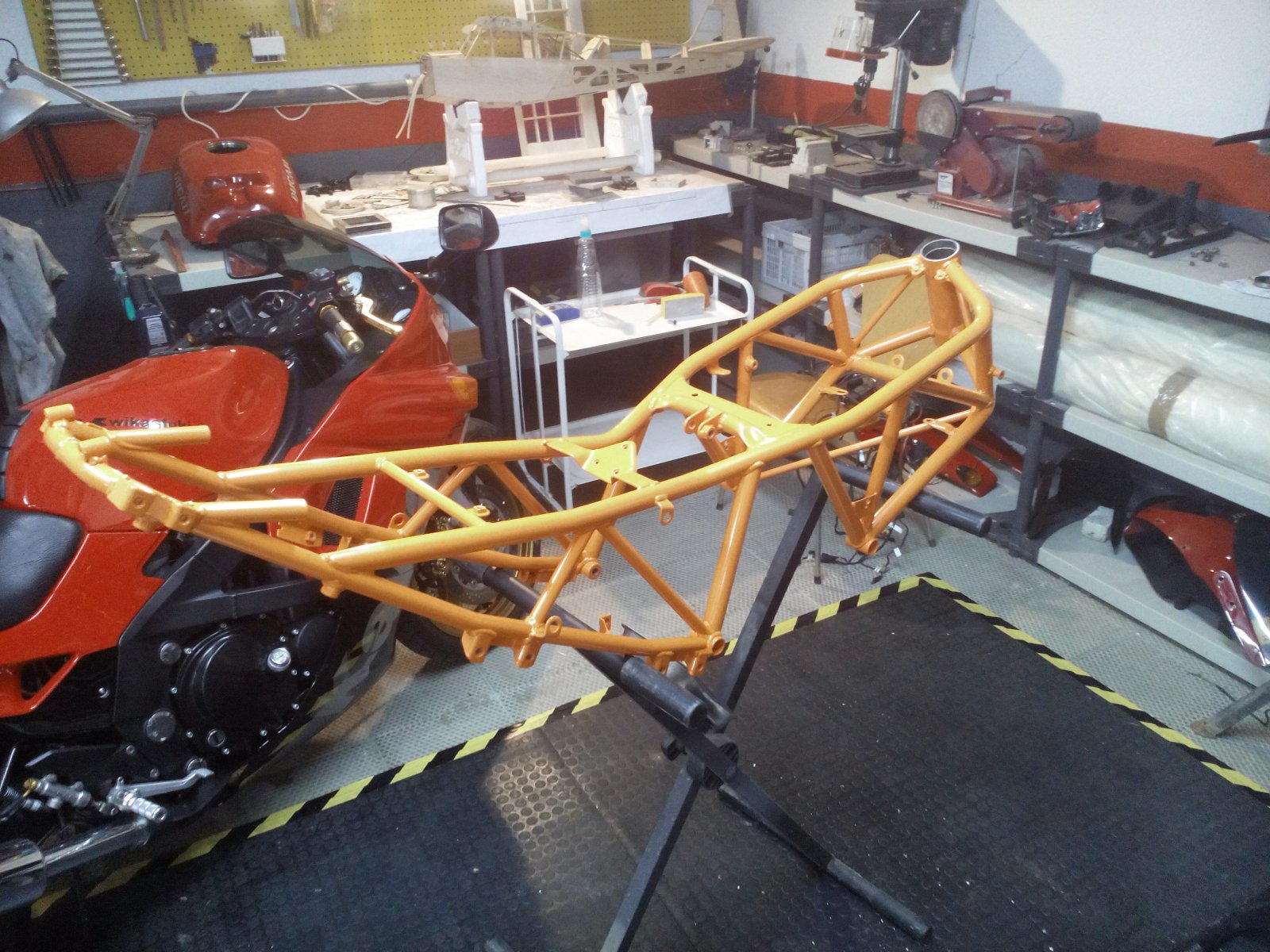

  20. I also received this morning the frame coming from the powdercoating
    I'm sure nobody is going to like it.. but here it is
    Ta Daaaa !!!!!!
    No, seriously guys ;)
    It told you I wanted it orange!!
    picture is very bad quality on the color, as it is a very bright orange
    I'll try to post other pictures under sunlight. It's challenging I know... but, the more I see it....
    Next to the paint shop, swing arm, rearsets, and some other minor parts.
    Best
    Tom
