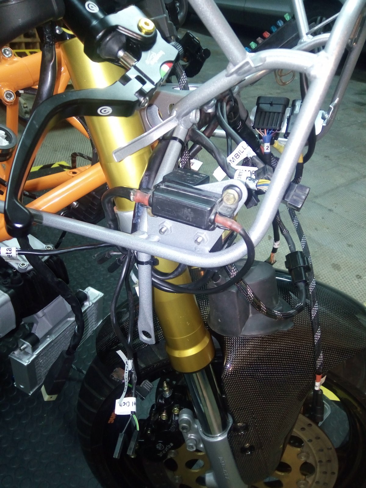

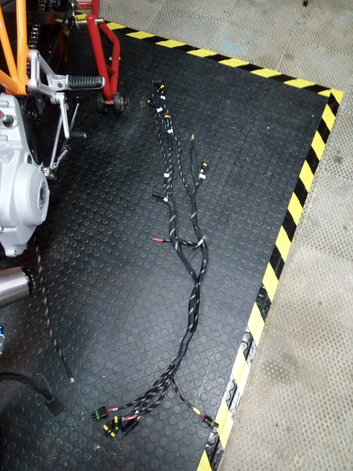

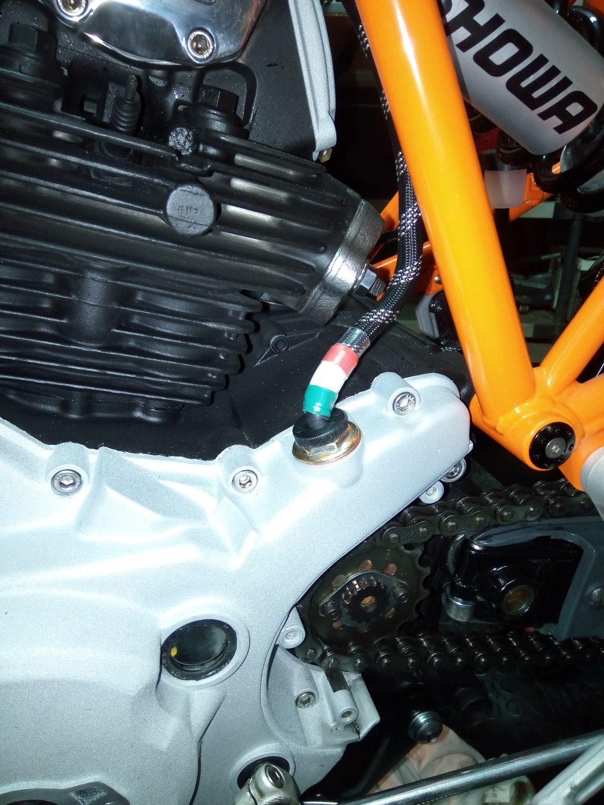

    Braiding the wiring system of the bike has been a nightmare, but judging for all your comments, it has worth all the effort. I did not lke at all the state of the original cabling (painted, dirty, and wrapped beyond repair in some points) so I bought some thermoresistant PVC brided sleeve from a computer store and thats the result.

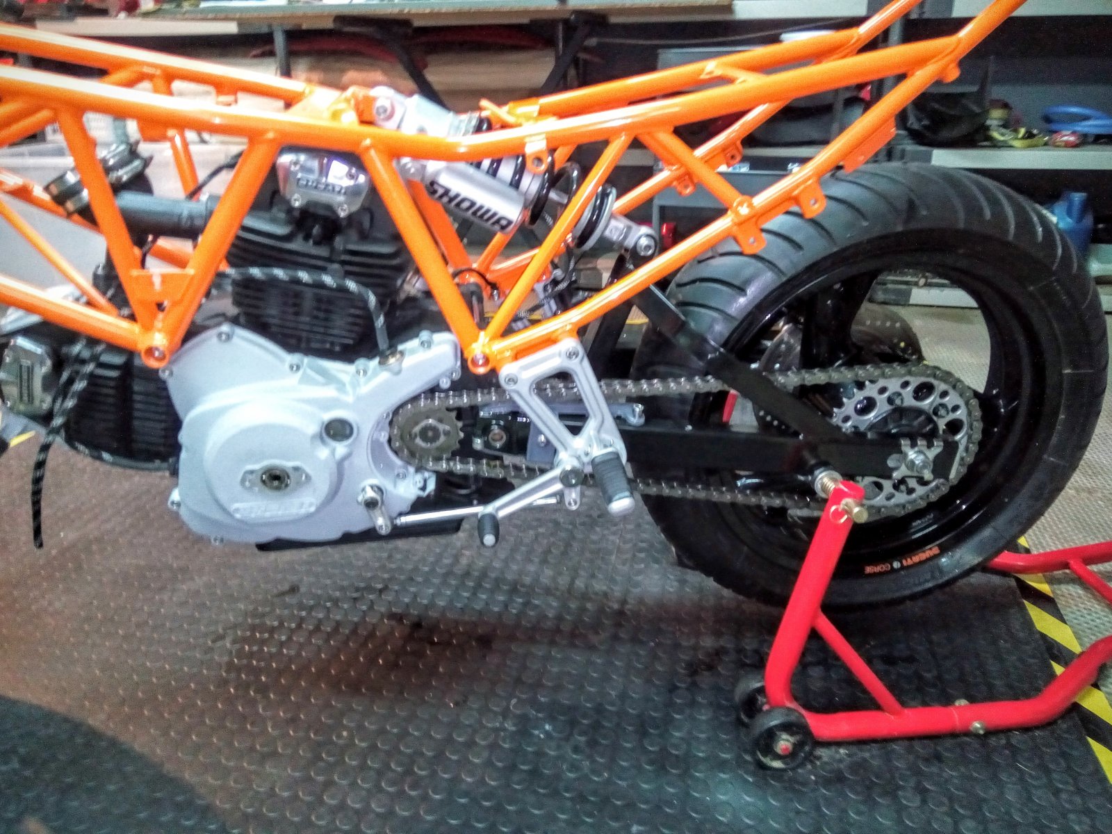

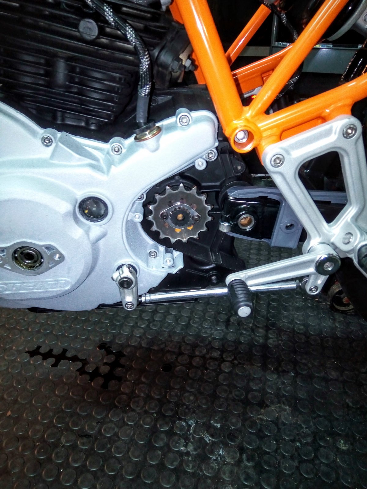

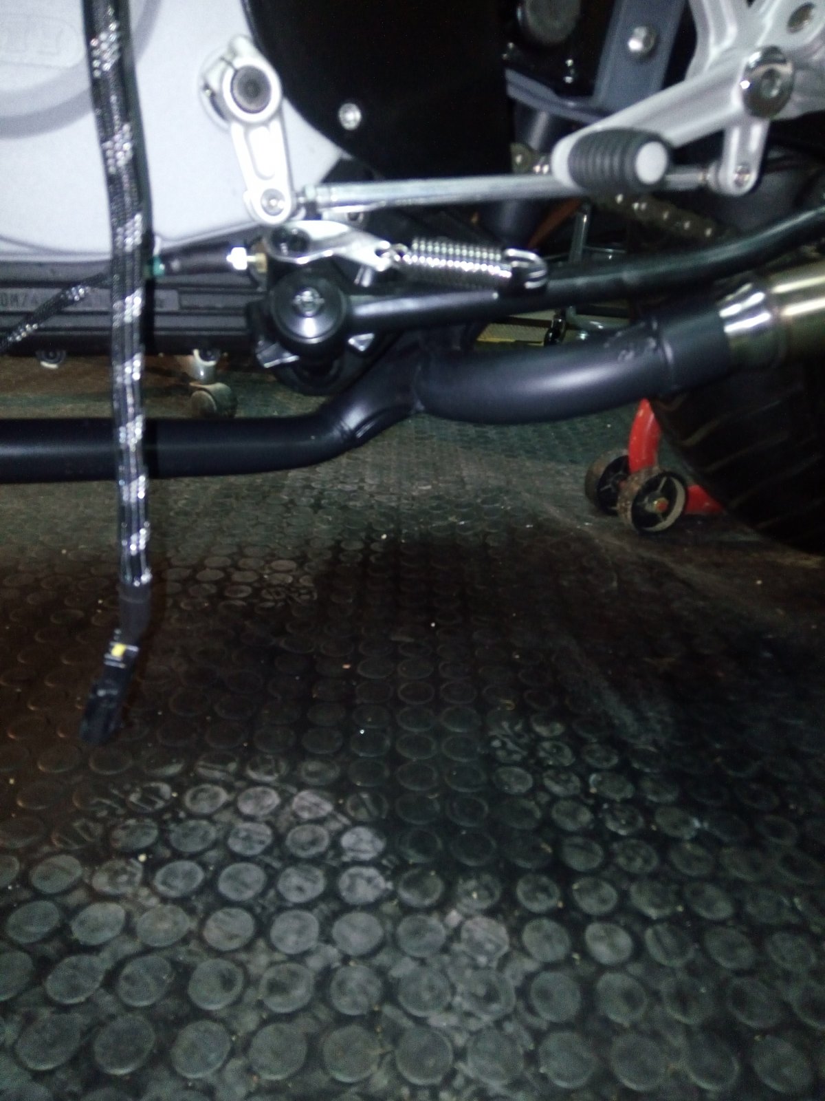

    Rearsets in position. Sprocket and chain back in place, tensioned and firm.

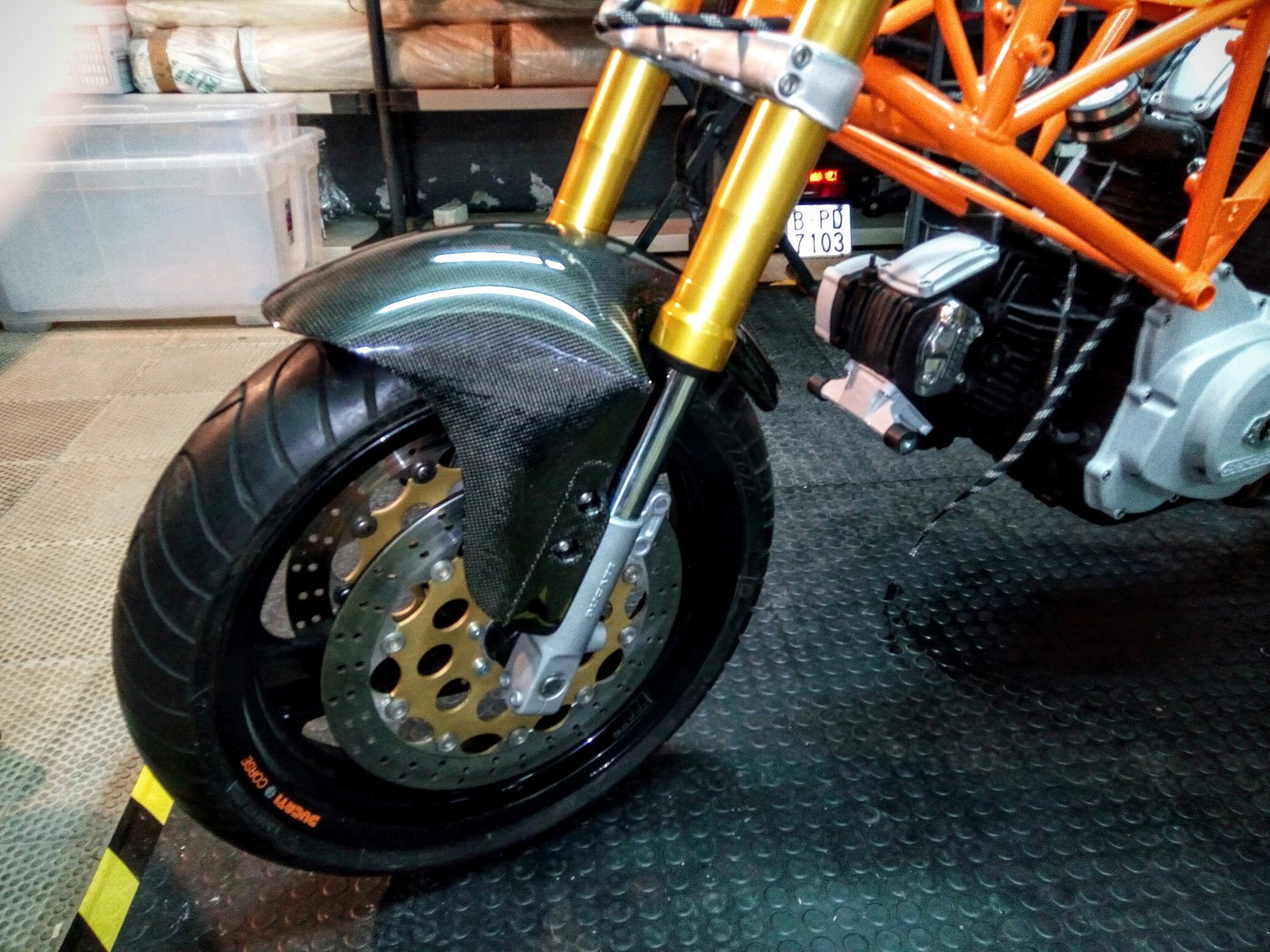

    And the front fender cleaned, and polished!!
    Now she looks like a real bike. (a bit on the badass side, but a bike:blush:)

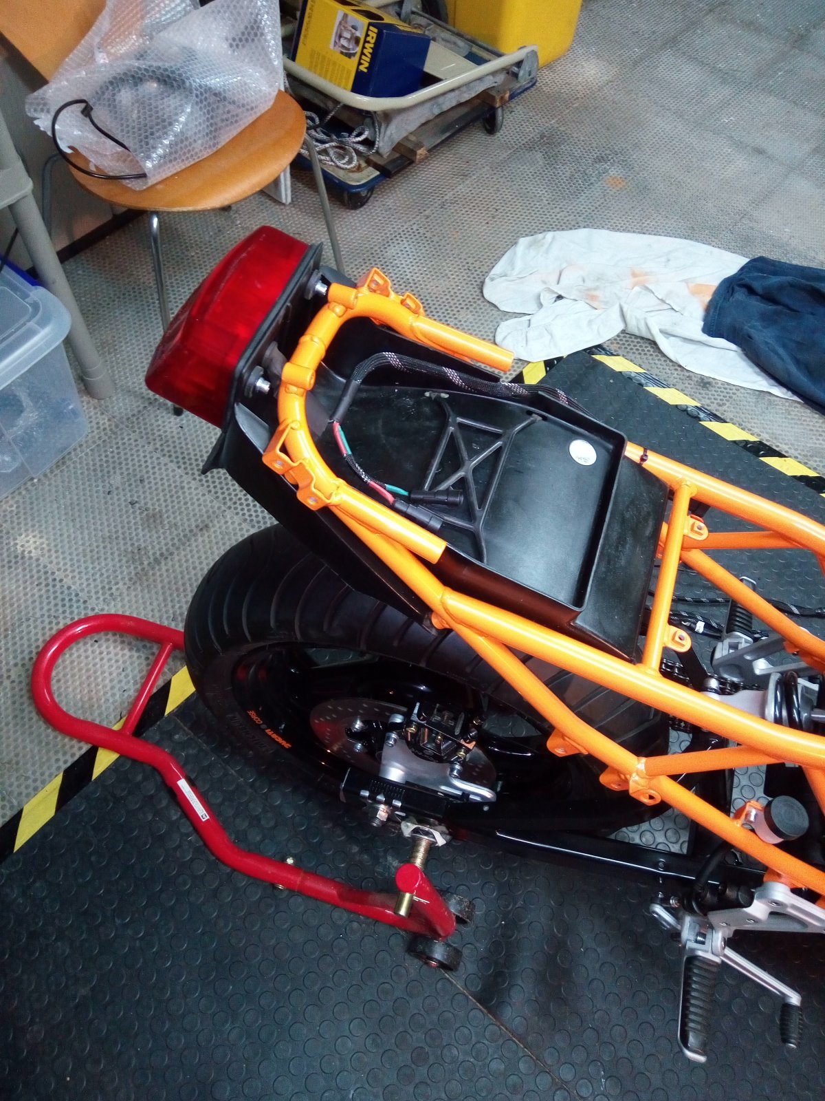

    Rear end back in place with re-polished rear light and recovered plastics

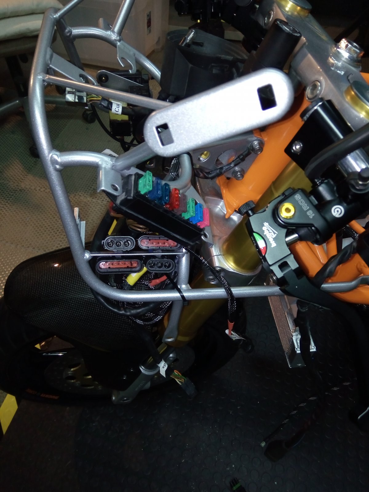

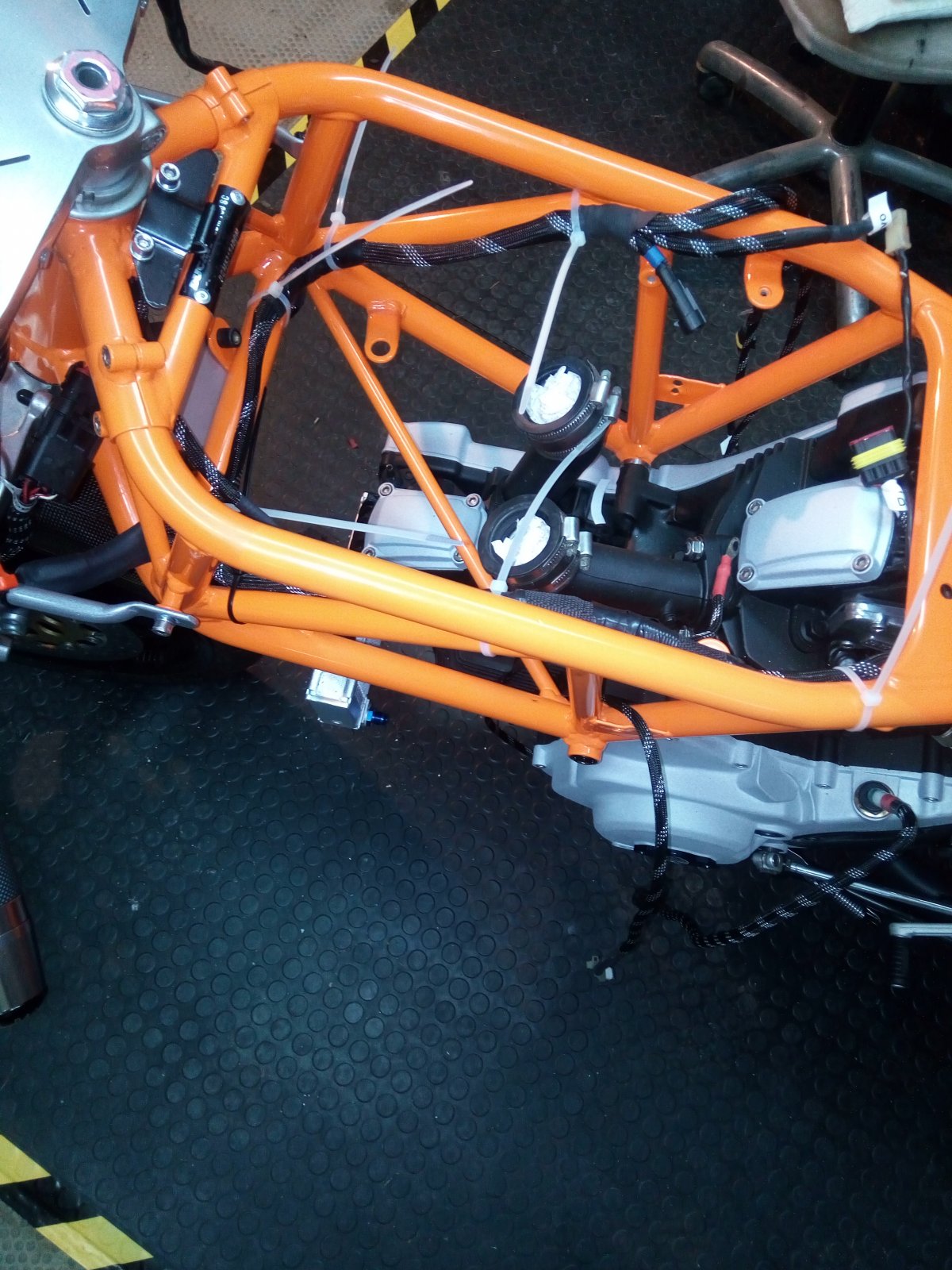

    Also front subframe in position and began rewiring
    Thanks a lot for the posted wiring diagram! it makes things much more easier:hearteyes:

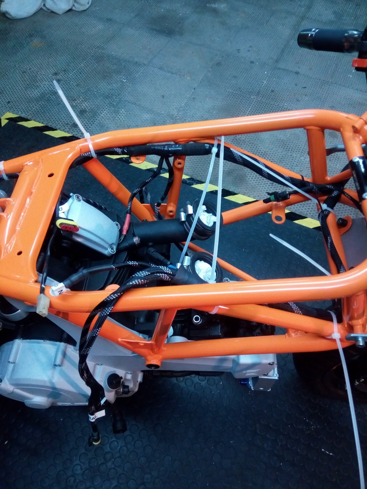

    Wiring is a mess, and there is still all this loom to be put back in place :coldsweat::coldsweat:

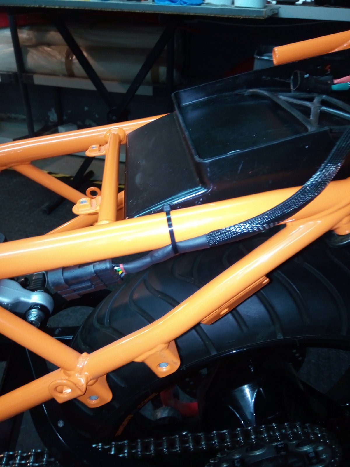

    Should I do it before or after installing the battery box?.
    I,m building a new all alluminium battery box that will save space and allow using pod filters, and I'm wondering if the cables should be installed before it
    Any help on this?
    Also, I do not like the looks of the black zip ties over the orange frame :astonished:
    I will search for Orange Zip ties

  7. Could always leave cable ties off altogether. For me they spoil the look, so with a couple of cable tie 'blocks' attached to the sides of the air box, and using clips from existing bosses, I've got rid of them all - much cleaner.
  8. In my opinion wiring before battery box so you have better access to routing it.

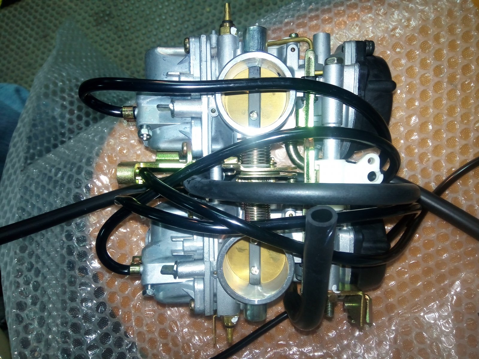

    First. I received a long awaited parcel with a pair of brand new carburetors.
    They correspond to a 750 Monster and are already prejetted to that specification. They will require some fiddling, but, as for now, I can continue the build up and later on fix the "breathing" issues that may pop up.

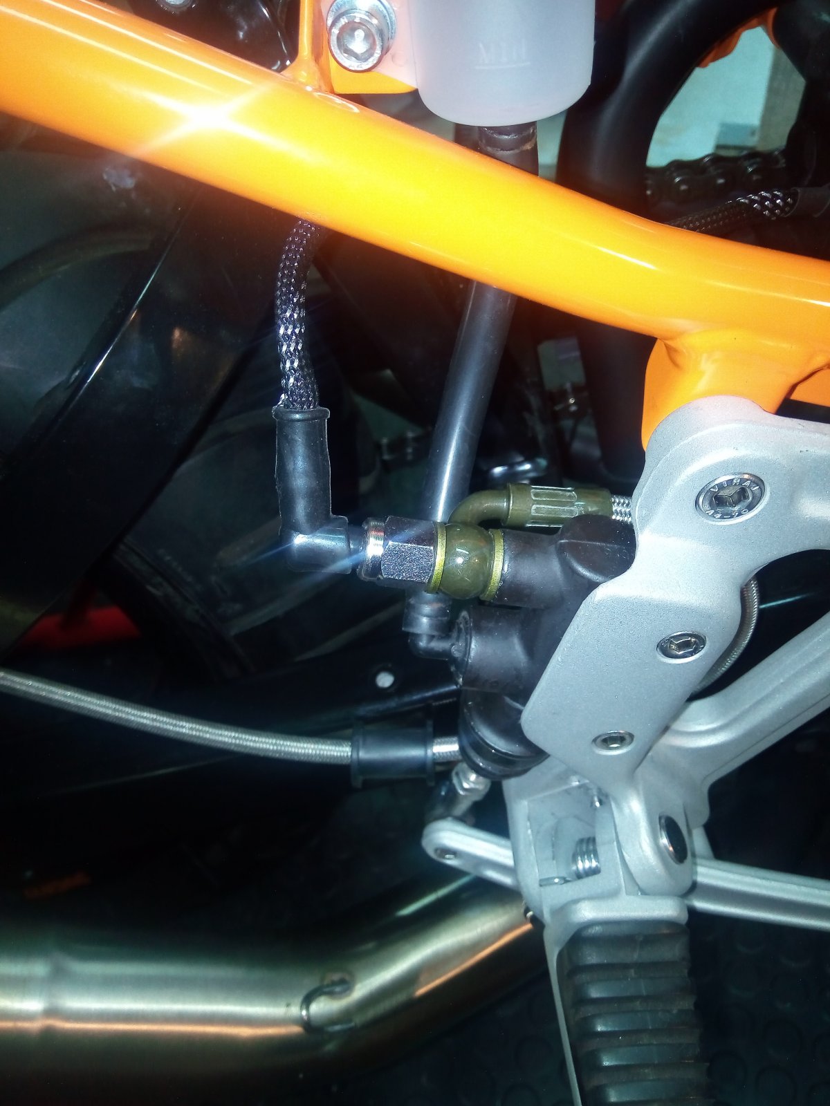

    Also finished the rear brake installation including a new brake light switch connected directly to the banjo bolt.
    I used this system on my previous build and I'm very satisfied with the results (less mechanical adjustment and also less deterioration due to dust, grease and all that stuff)

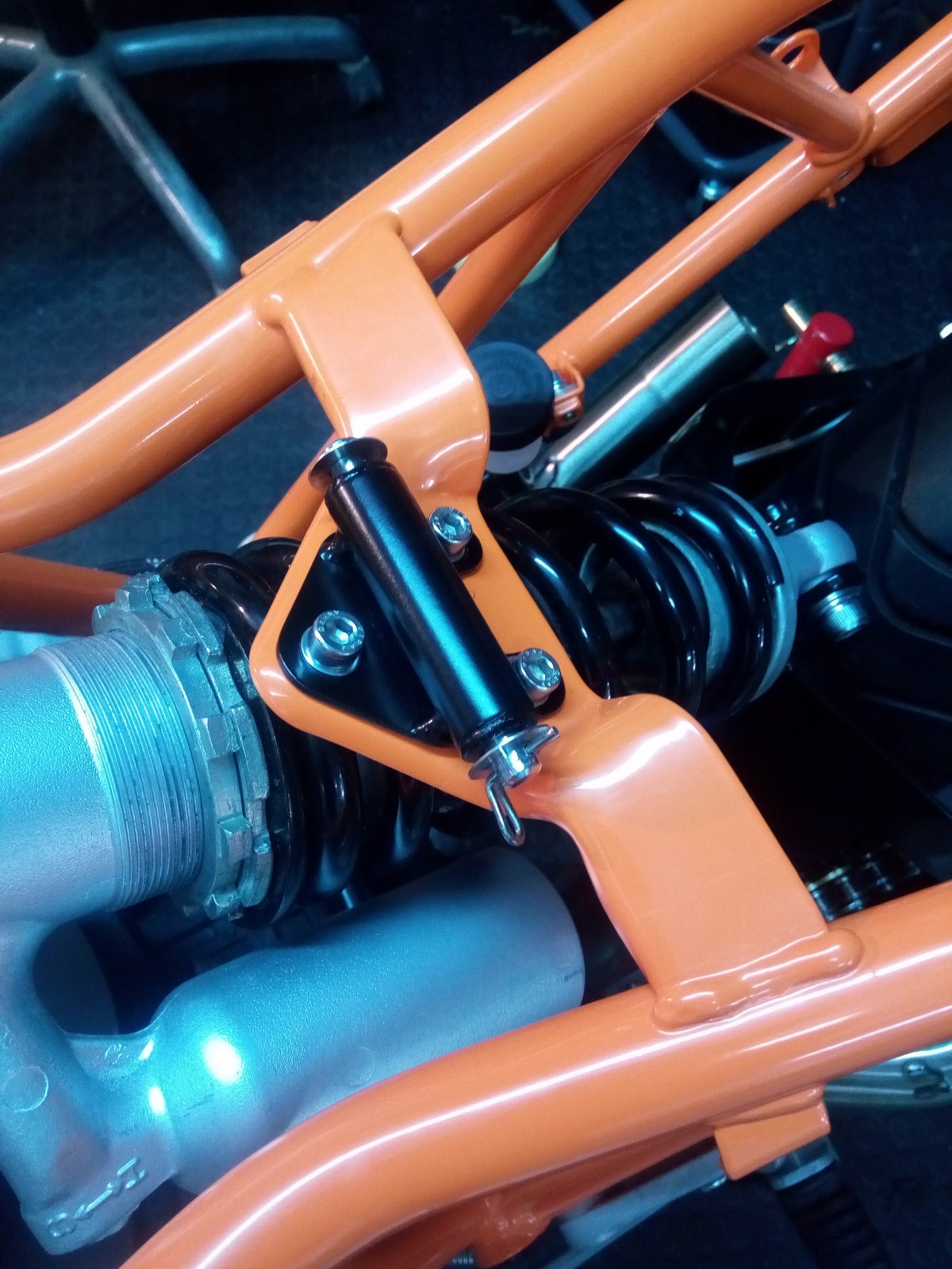

    Also, totally rebuilt and painted the clamp and hinges that secure the tank in position.

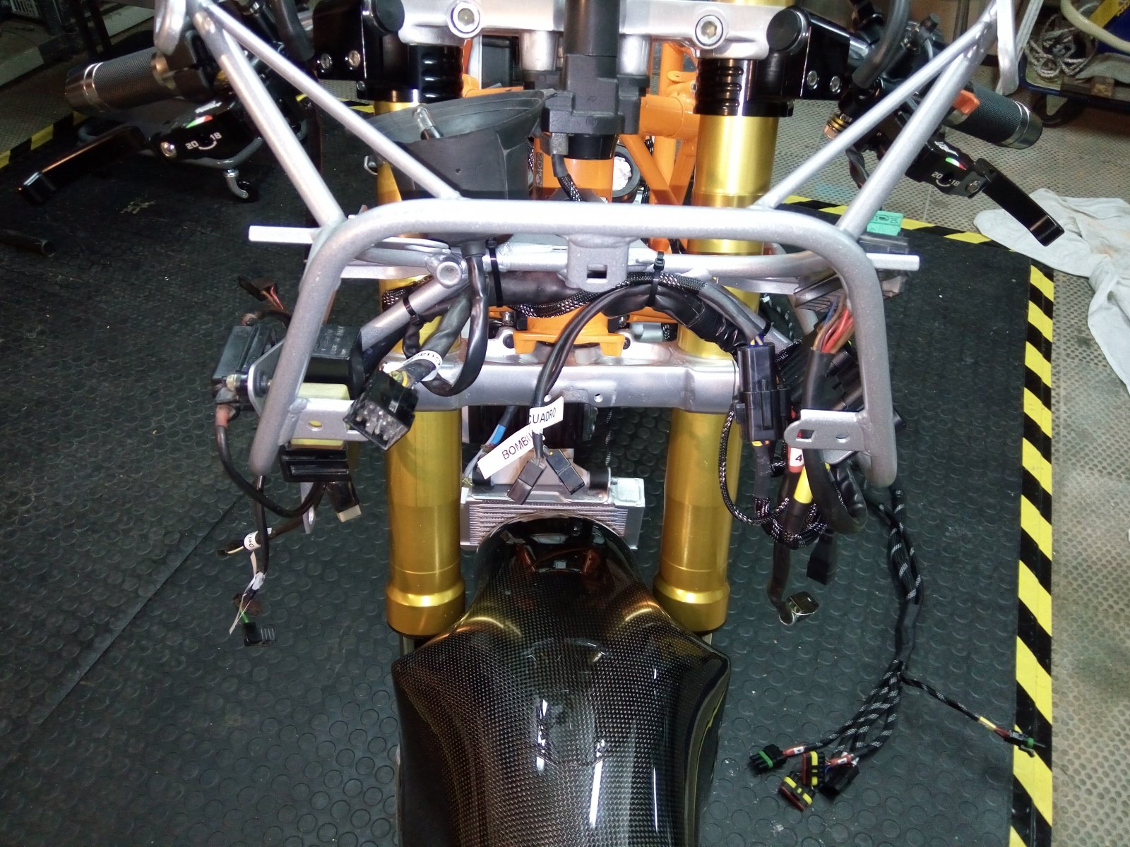

    Finally I started today wiring back the bike.
    I'm initally using some white zippers not very much tightened to try to figure out the proper way to reroute everything. (lots of trial and mistake here)
    Hopefully, next week I will have my new battery box finished from the lasercutter and will have the chance to finish all the wiring.

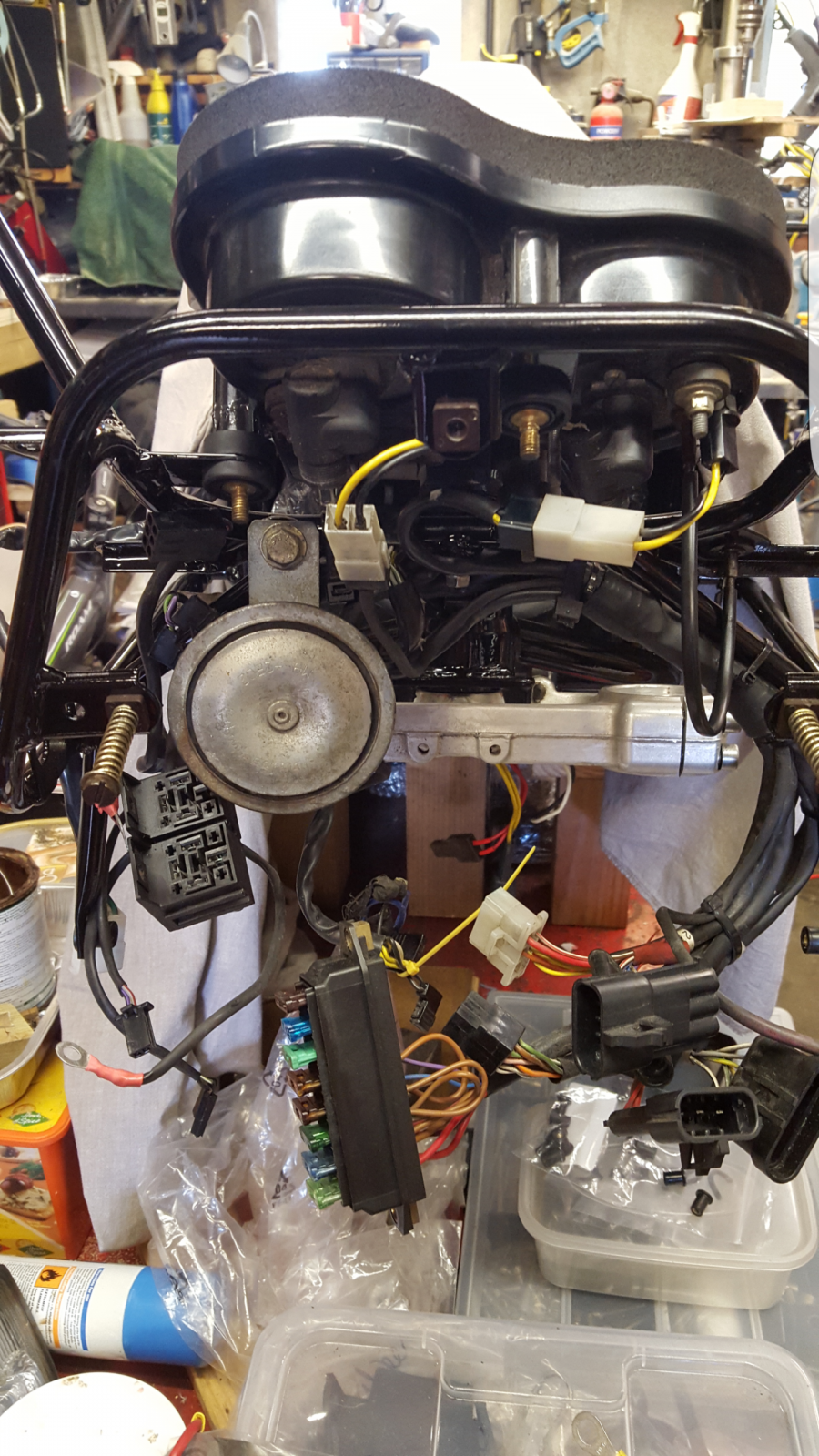

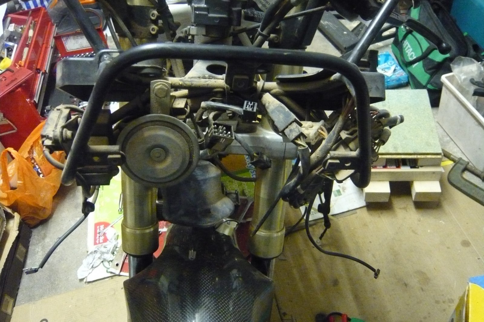

    By the way! Can anybody post a picture or tell me where the horn is attached to? Haynes is imprecise, and so is the manufacturer's service manual.
    thanks in advance.
  17. Here you go....
  18. Wow! that was fast.
    Thank you both for the quick response.
    As for the cable ties.. Funny! this are just the ones I have oredere in e-bay one week ago. :) :)
