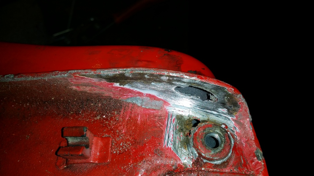

  1. just got the tank cleaned ready for sealing,all looked good and solid (no holes) put the sealer in sloshing it about and I sprung a leak...give it a few prods with a screwdriver and 20131203_165512_zpsfe28882c.jpg
    quick repair,i managed not to damage the paint where it is visible...another job out the way.
  2. Rotted in the exact same place mine had, mine wasn't quite that bad though. Any luck getting the old one back??

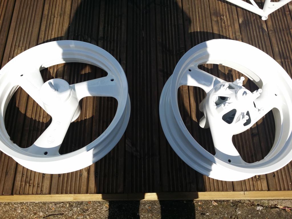

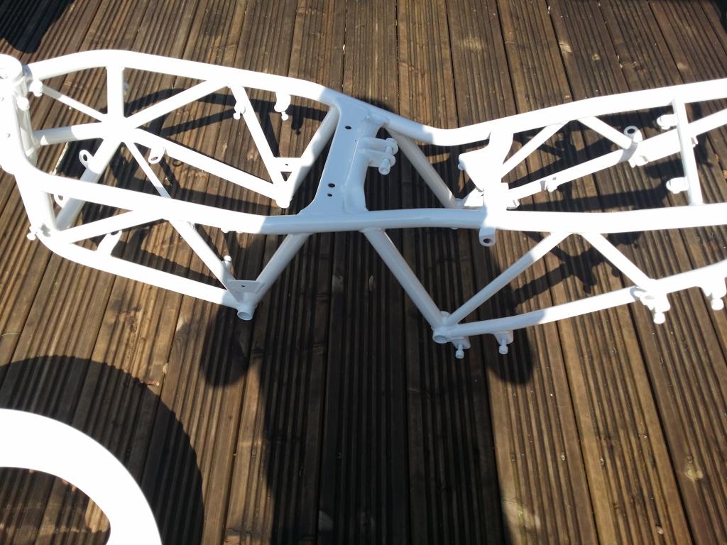

  10. frame back from powder coating today,maybe i can make some progress now the tt2 is near completion. 20140517_152416_zpsrgdzryxc.jpg 20140517_152422_zpsr0m2owvm.jpg
  11. Puts my cream frames and wheels to shame, need your sunglasses!!
