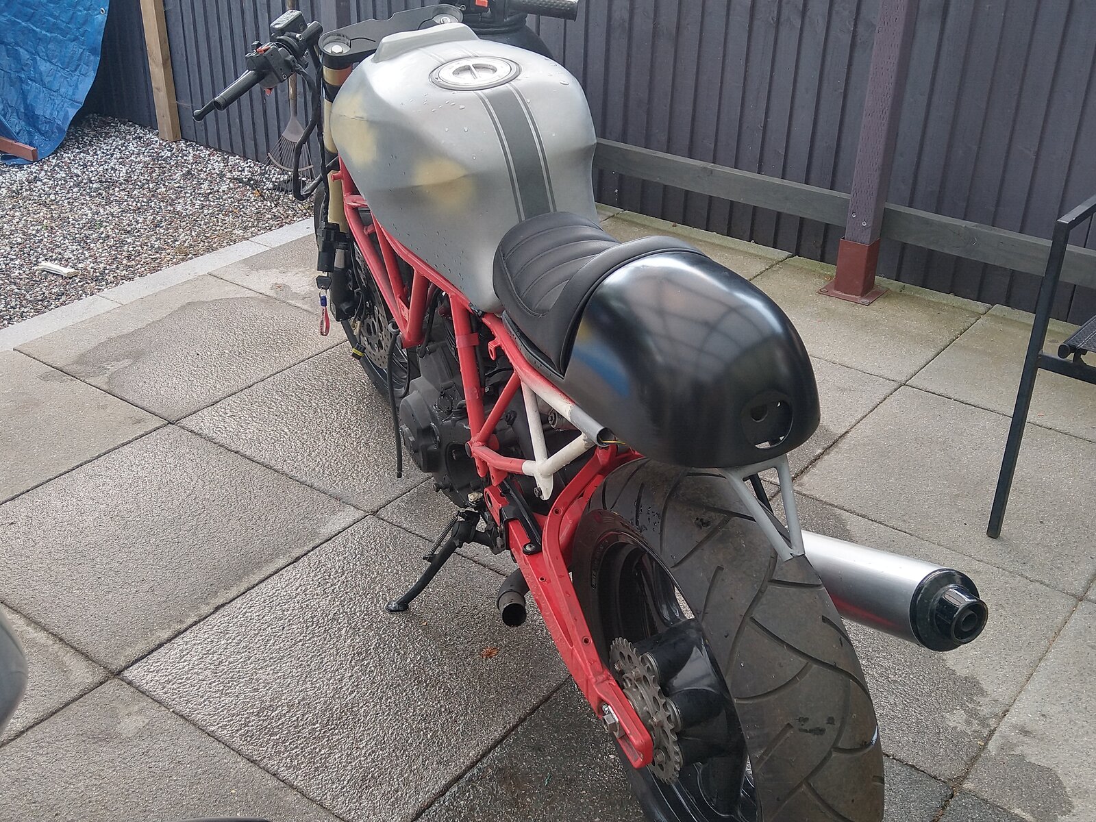

    Here's an update
    Roadtrip, it's still in progress............or rather, it's back in progress

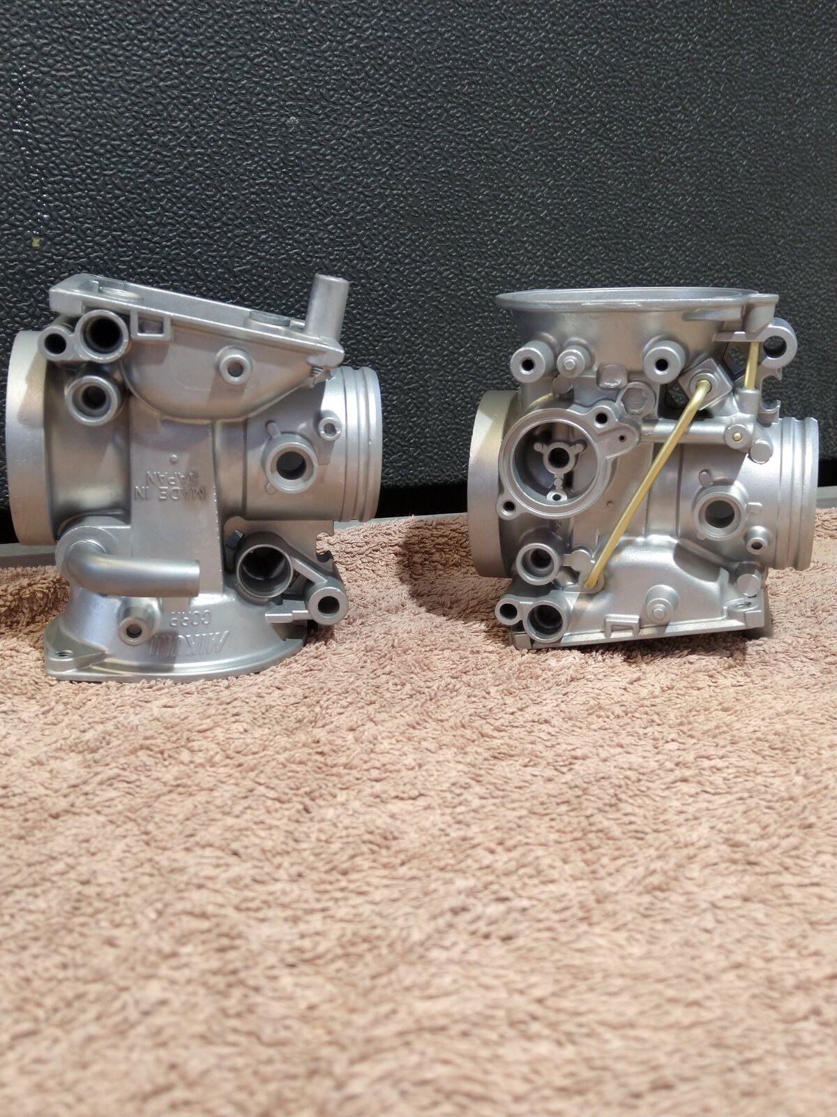

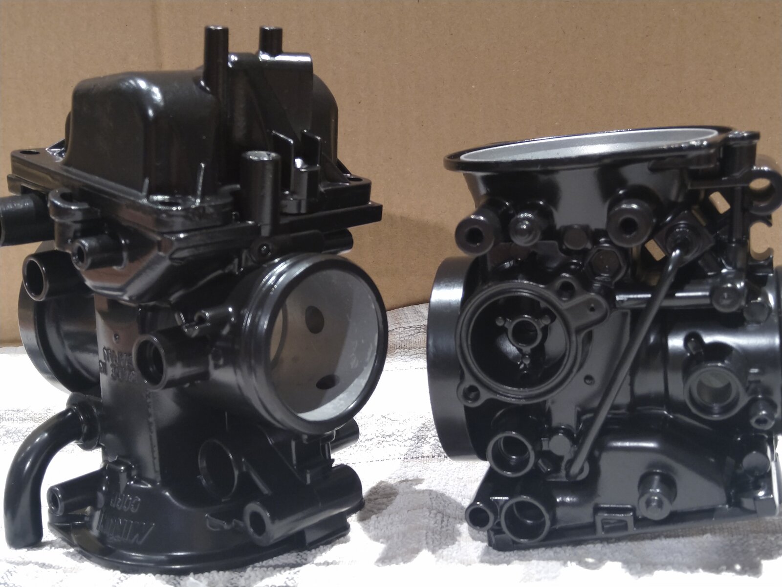

  6. I've started the refurbishment of the carburettor
    Vapour blasted
    And ceramic coated
    Ready for the rebuild

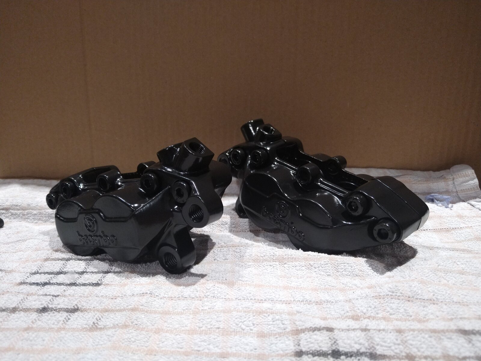

  7. The front brakes have had the same treatment

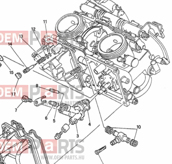

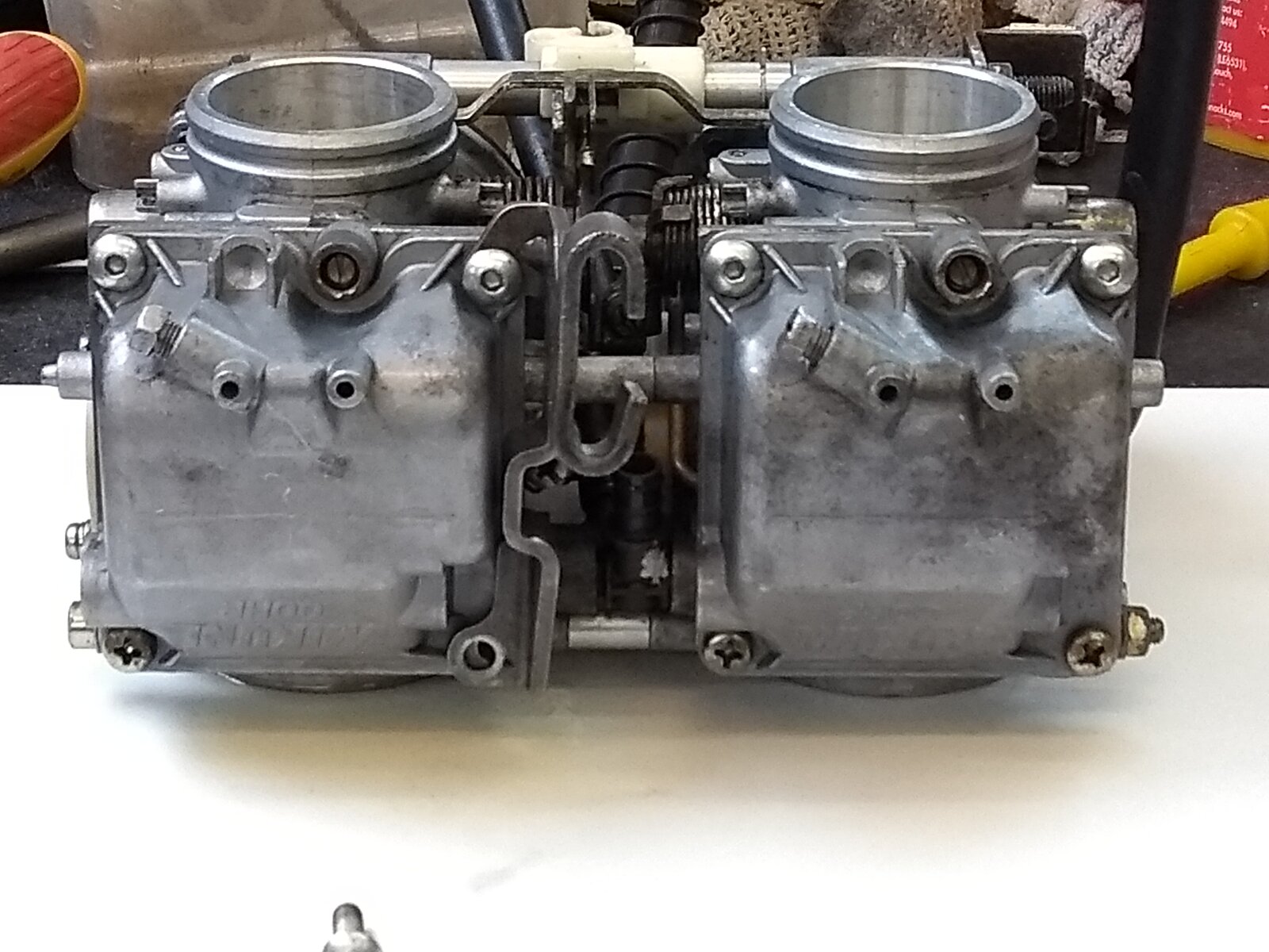

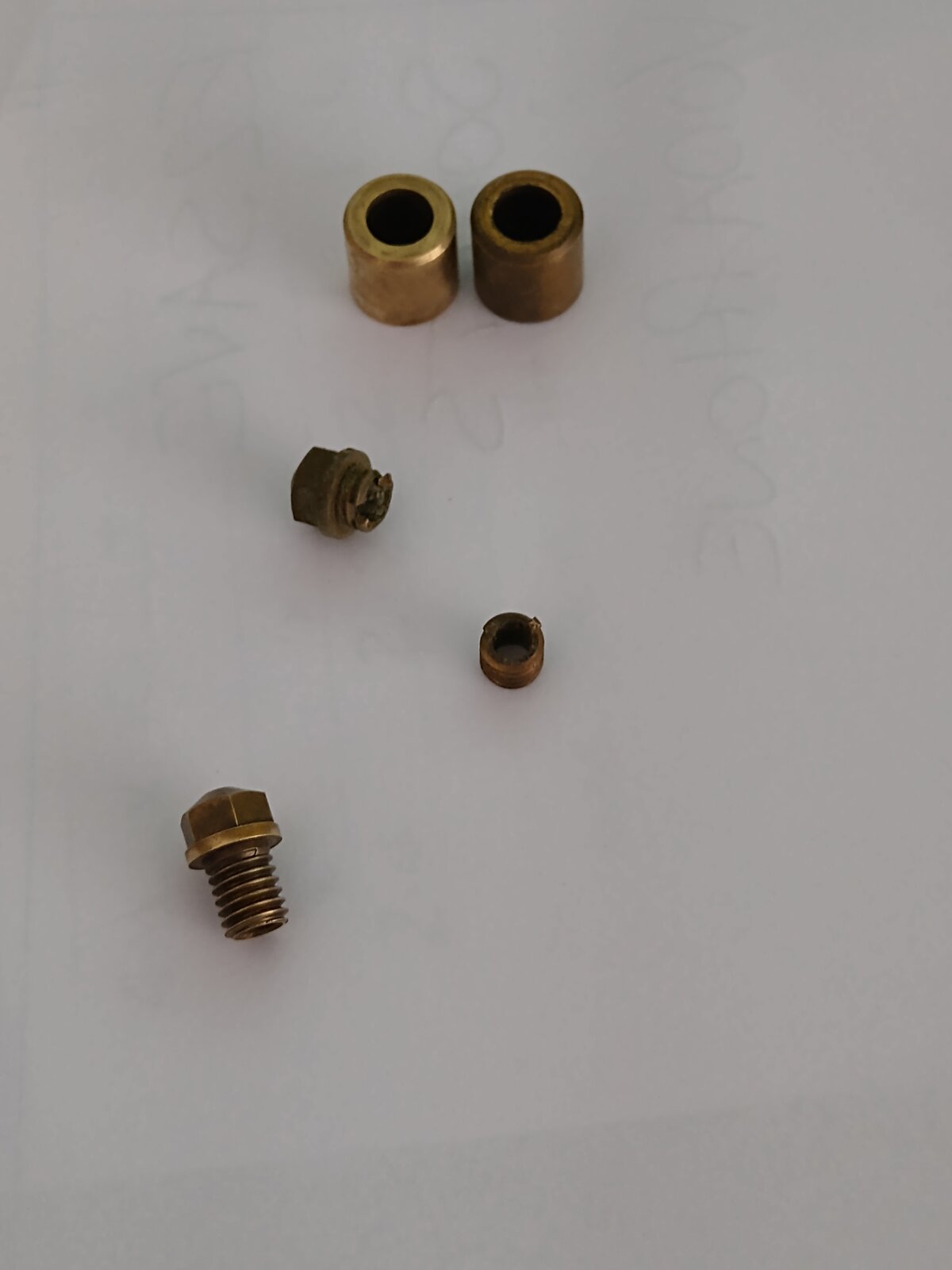

  8. I now need a spare part for the carb
    Number 3, has a small bolt and collar holding it in
    I need the bolt
    It's hollow.....anyone know if it has to be an OEM hollow one or a non-standard replacement?
  9. Good to see its back on track :upyeah: as this could be the longest rebuild on the forum :D
    Ive not had any ceramic coating done before, does it not block up any of the passageways in the carbs?
  10. Hi, Roadtrip, the internals have not been coated.........the guy I use assures me it's fine. I think he mentioned it 1/2,000ths thick, though I may have that wrong.....but it's thin:)

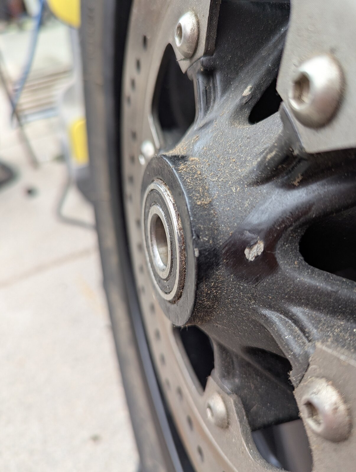

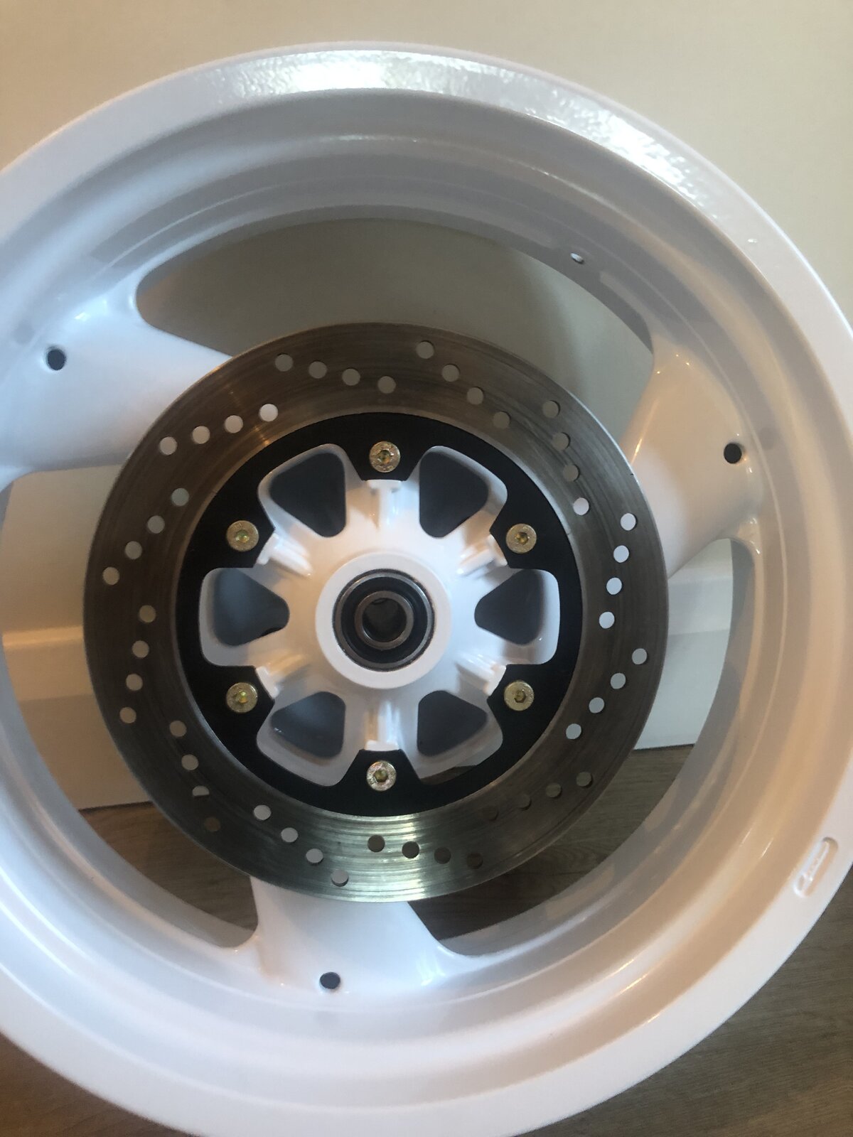

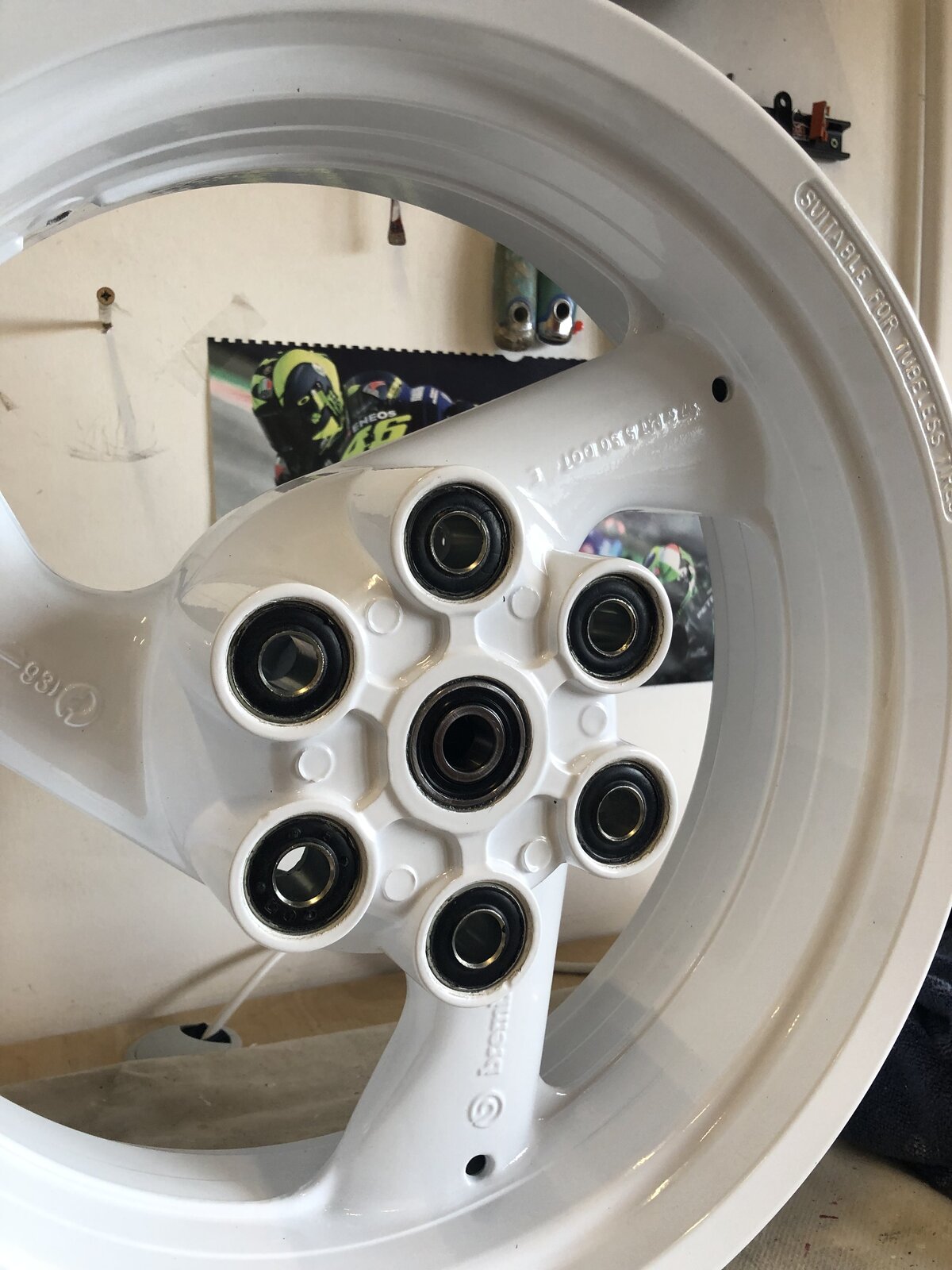

  13. This is the rear wheel, I'm assuming the bearings should not be sticking out and should be flush? I suspect they're the wrong ones
  14. Roadtrip.....of course it will, just not sure which year

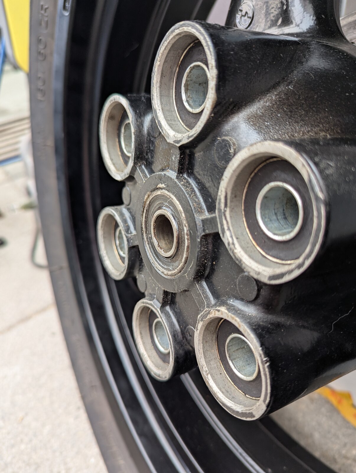

  15. Should be flush same for the Cush drive rubbers,
    Photos of my wheels,

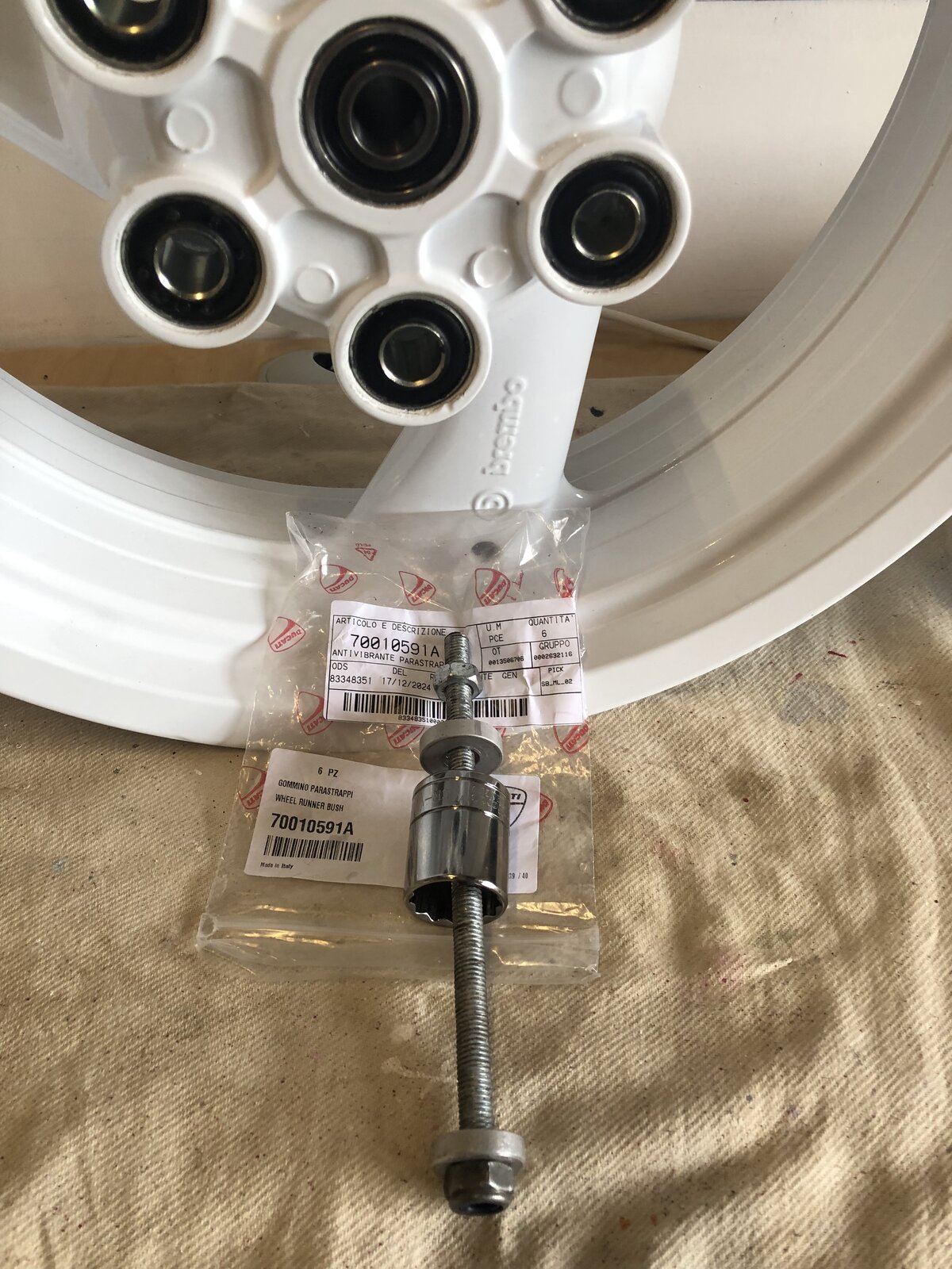

  17. Just noticed, is that a home made puller?
  18. Yes it is, worked a treat.
  19. The bearings are wrong and there are no bearing spacer at either end
    So that's the next thing to get hold of
    Are they just a special sized washer?

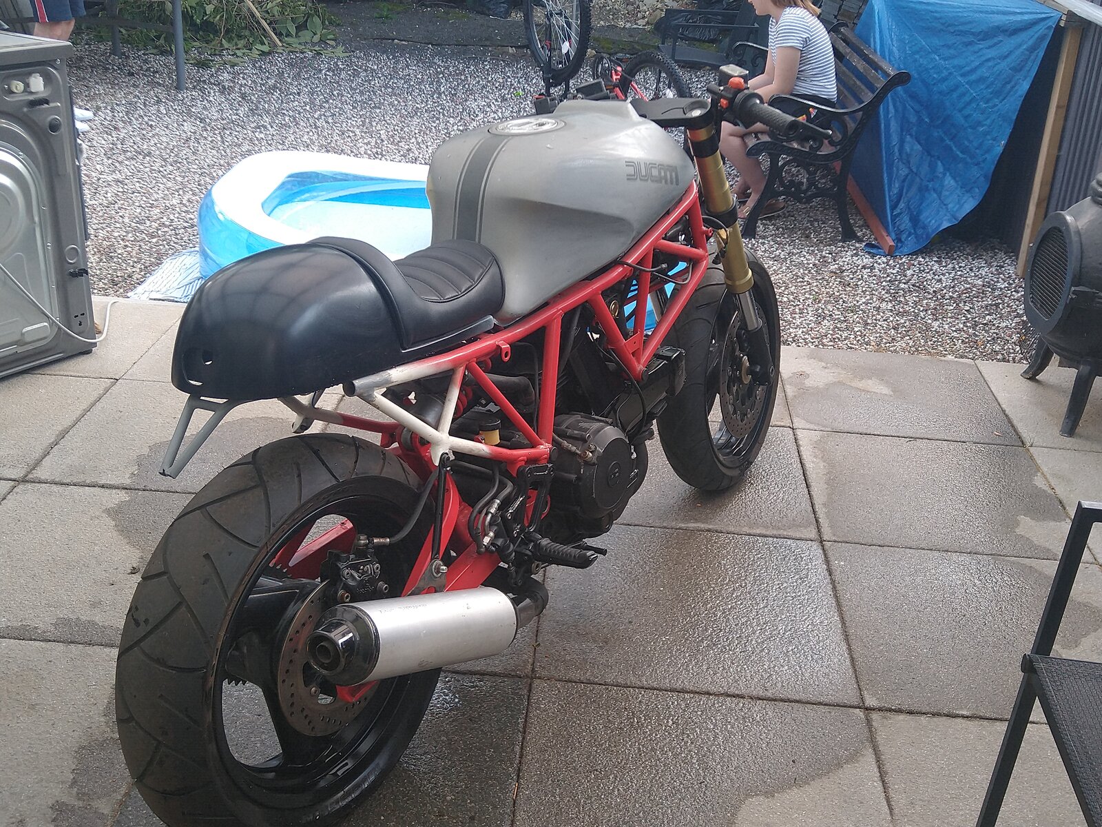

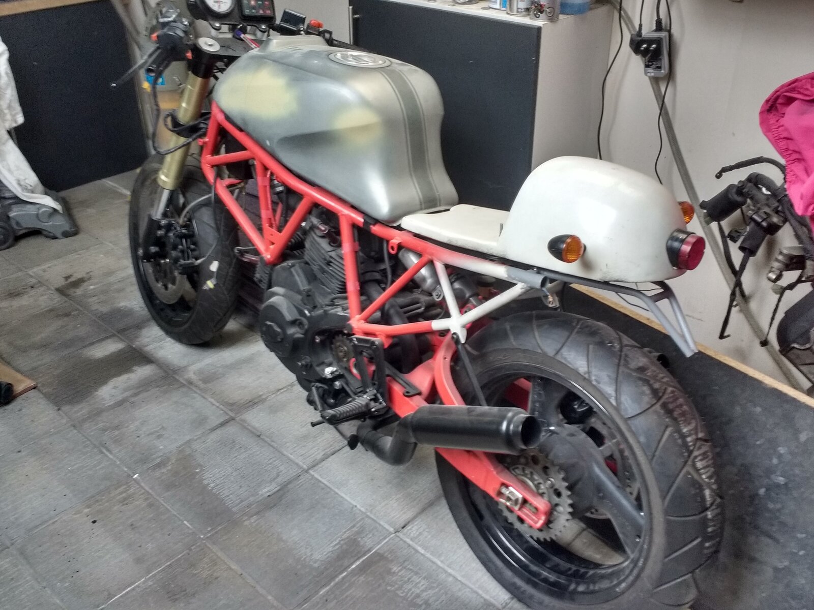

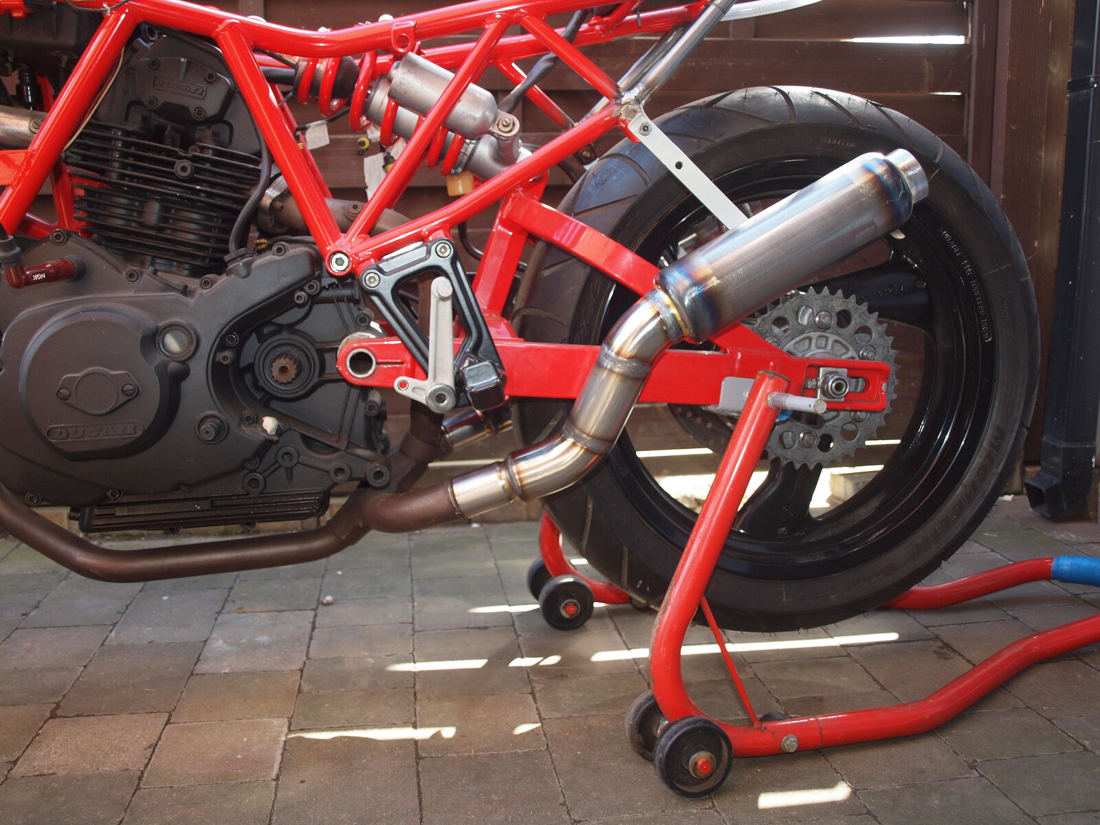

  20. Photos of the bike currently, just about
