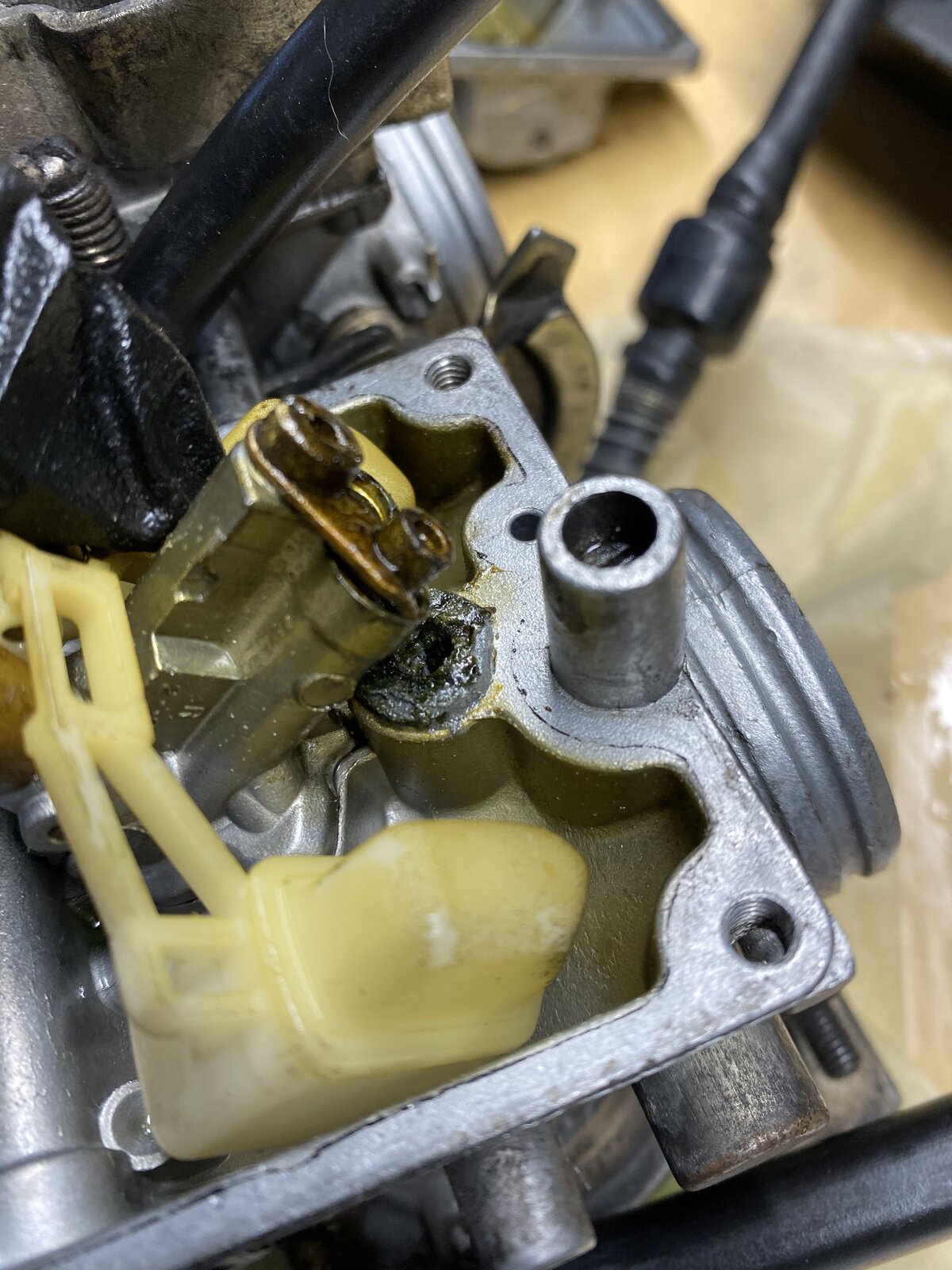

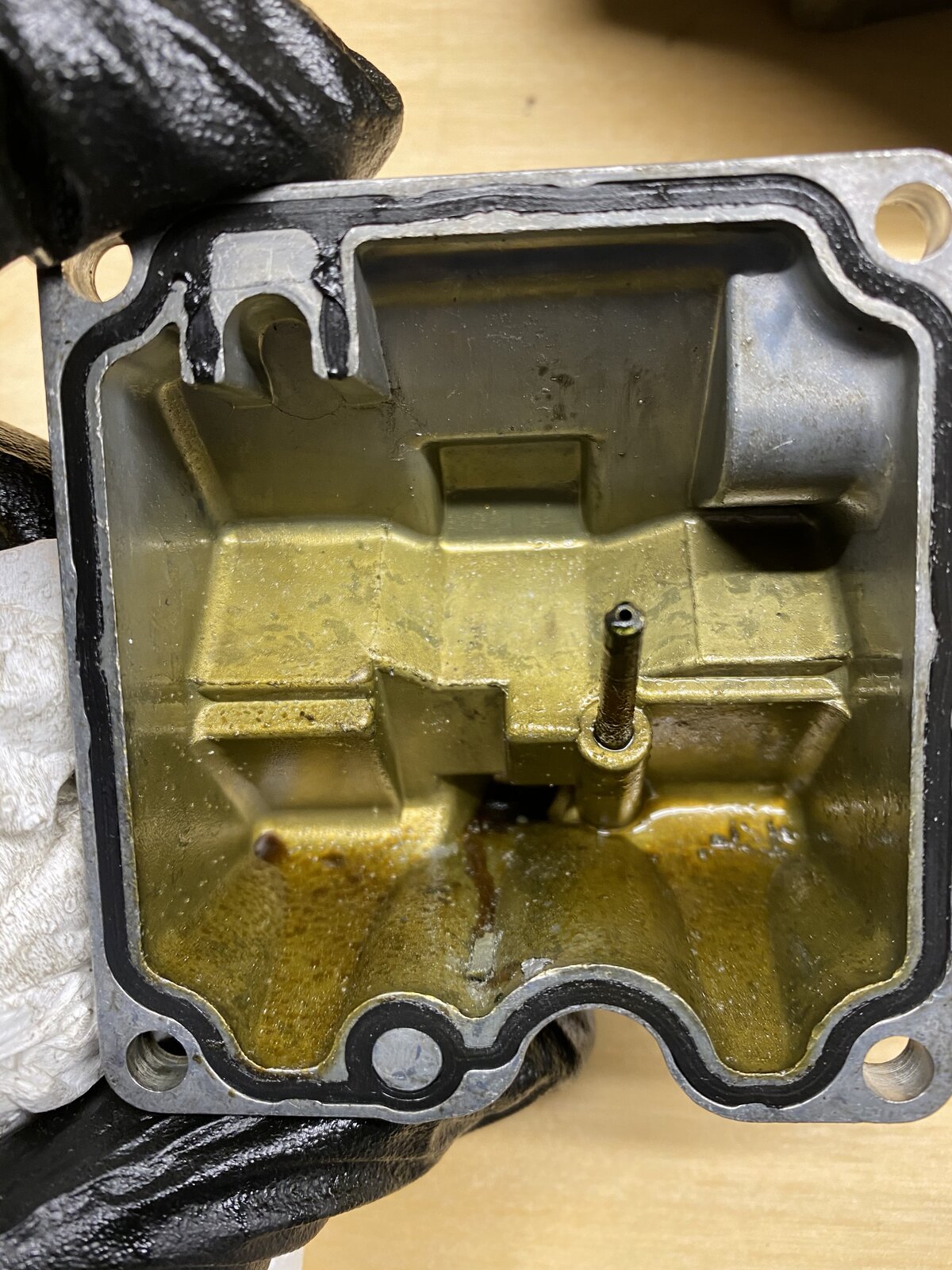

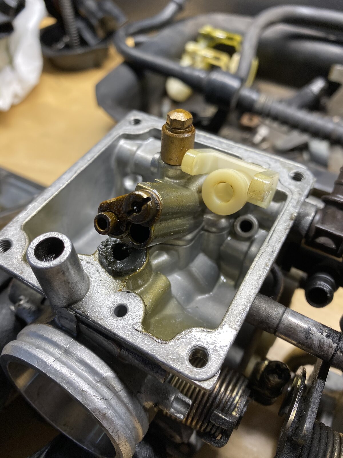

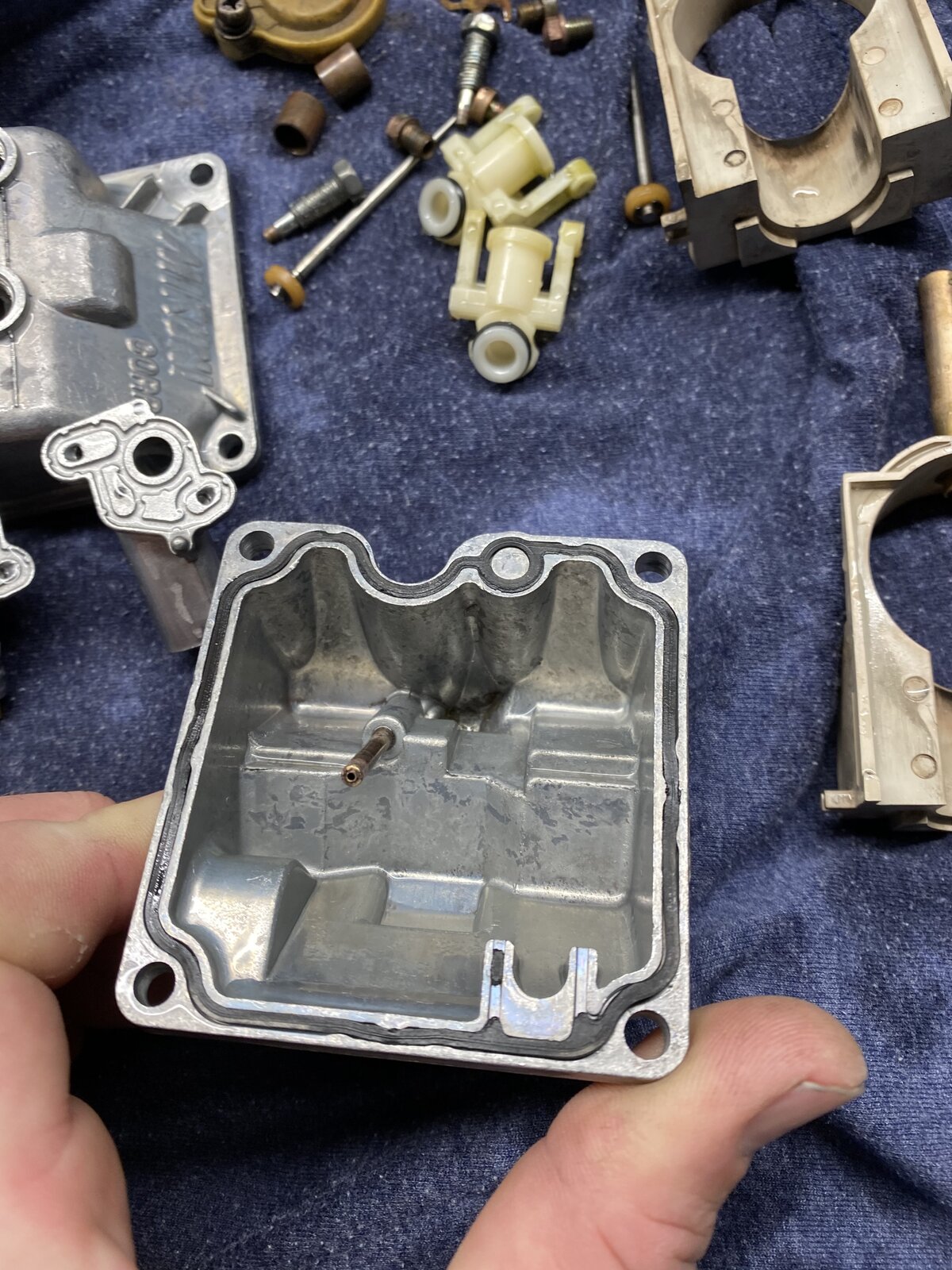

Update alright so I found I had fuel to the carbs. I pulled off one of the float chambers and it looked pretty grim inside, so the carbs came off. I broke them down and put them in my ultrasonic cleaner with some R33 carb cleaner, you can see the difference it made. I dint have spare o rings or gaskets, and I kind of knew that the carbs would probably leak when re built, but as its lock down, and i find myself with now, probably lock down until the 26th of April, it was worth a try to just get the bike started. It went back altogether , and i turned her over , fuel started leaking from gaskets as I guessed it would, but the bike did backfire before I called it and turned the ignition off and the fuel off. Im assuming Im not far from it starting, or rather hoping. New Carb service kits are on their way ! Thanks for everyones help, i will add to this post when i have more news. For now, I will go back to working on my Laverda's

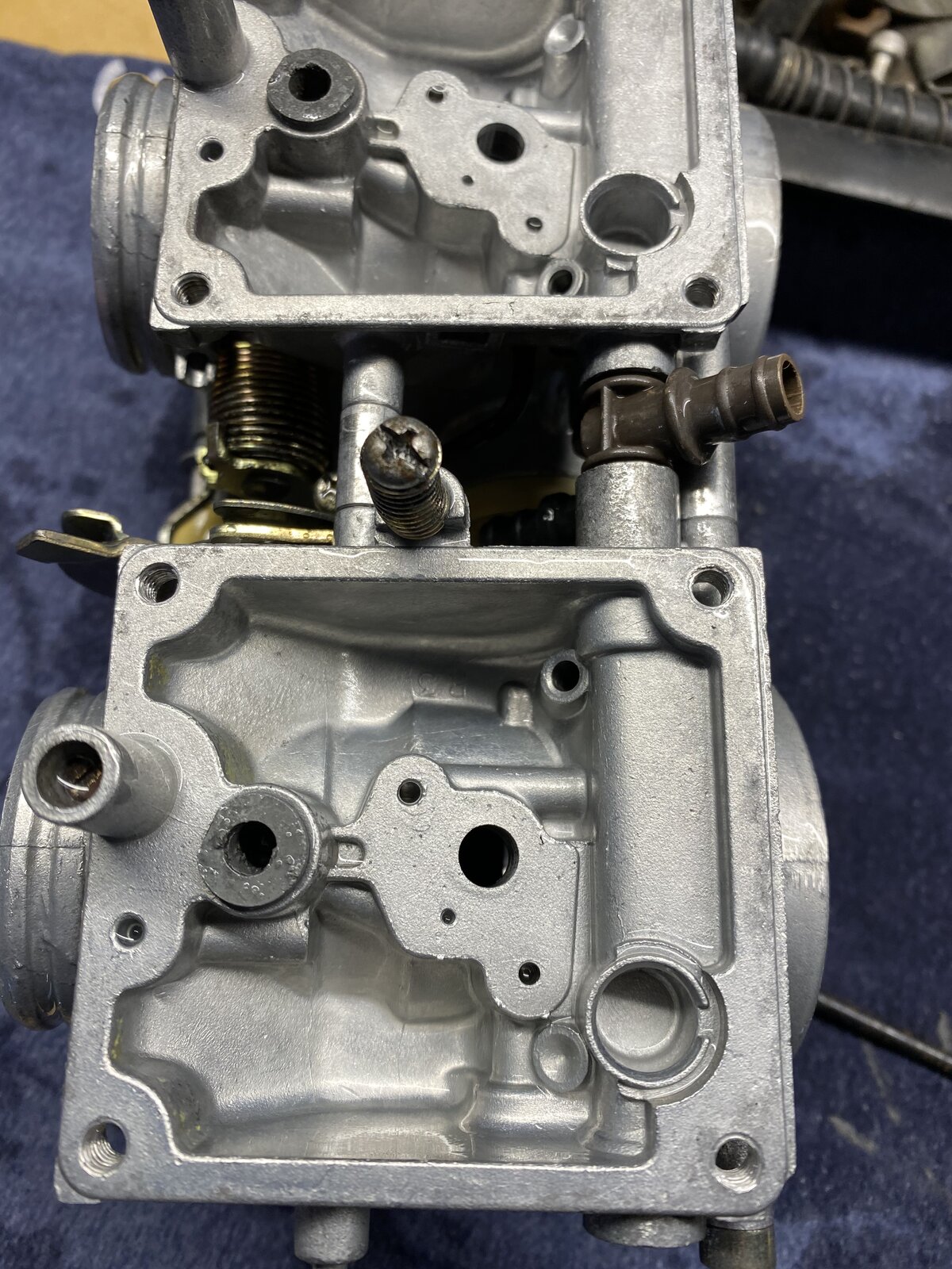

it's unlucky that your bowl gaskets are well and truly flattened, i've re-used those gaskets nearly everytime and have been fine. It sounds as though you would have worked it out from experience but the hollow brass hex fixing that holds down the jet holder assy is only just up to the job so nip down carefully (too late for this time). I shudder to ask, but how are your idle mixture screws? - both come out ok I hope. From what I can see of the screw heads it looks as though they've rarely been touched - can be a good thing/can be a bad thing!.

Hi Chris. Everything is pretty much chooked inside the carbs. I have ordered some rebuild kits where I can replace all the seals, O rings jets etc. hopefully they will be here next week
That guide looks useful Derek but I wonder about the float setting, does the 750ss have BDST 38’s same as the 900 ?, if so the float heights need to be 14mm (assuming the intake and exhaust isn’t highly modified). Update; just looked at the OP’s photographs, floats same as 900, go for 14mm.
Yes, the 750 has the same carbs as the 900 but with slightly different jetting. I agree, 14mm float height. Worked for me.
Sideshow, when you set the float heights measure on the longer oblong float not the small diamond shaped one.
