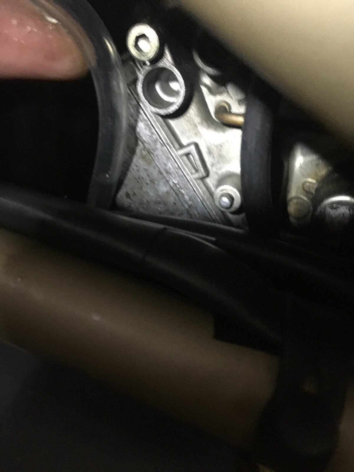

  13. Agree with Chris, I forgot to do the pipe check first time, really annoying!, carbs on the bench then thought shit if I’d just done the pipe check I might not have had the PIA job of taking them off!, if in future you do it make sure that when you’ve got the pipe attached you open the drain screw very slowly otherwise you’ll get air bubbles that throw the reading off, also wiggle the pipe around a bit til the level settles, I’d do this check when you’ve got the carbs back on anyway to confirm the setting you’ve done has worked, here’s a photo of mine, when the level lines up with the middle of the circular feature you know it’s correct.
    (The feature to the right , circular boss with a pin in the middle)
    #76 Mark9, Apr 5, 2020
