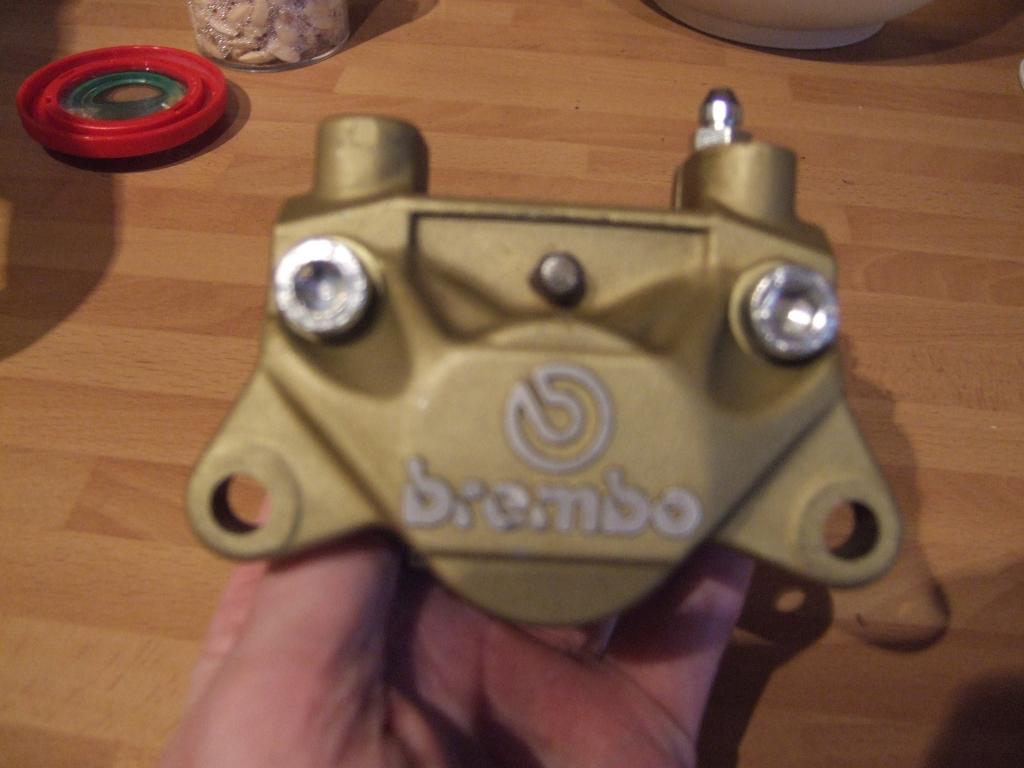

    So I can get on with some smaller jobs. First, the rear caliper which was pretty rough and half seized. I managed to get a seal kit (I know they're hard to come by) and fortunately the pistons themselves cleaned up nicely. Getting the pistons out is always fun, like (wrap caliper half in towels and insert small 12V compressor nozzle into the bleed nipple thread..):
