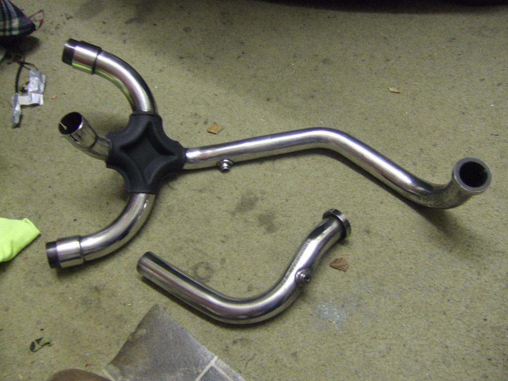

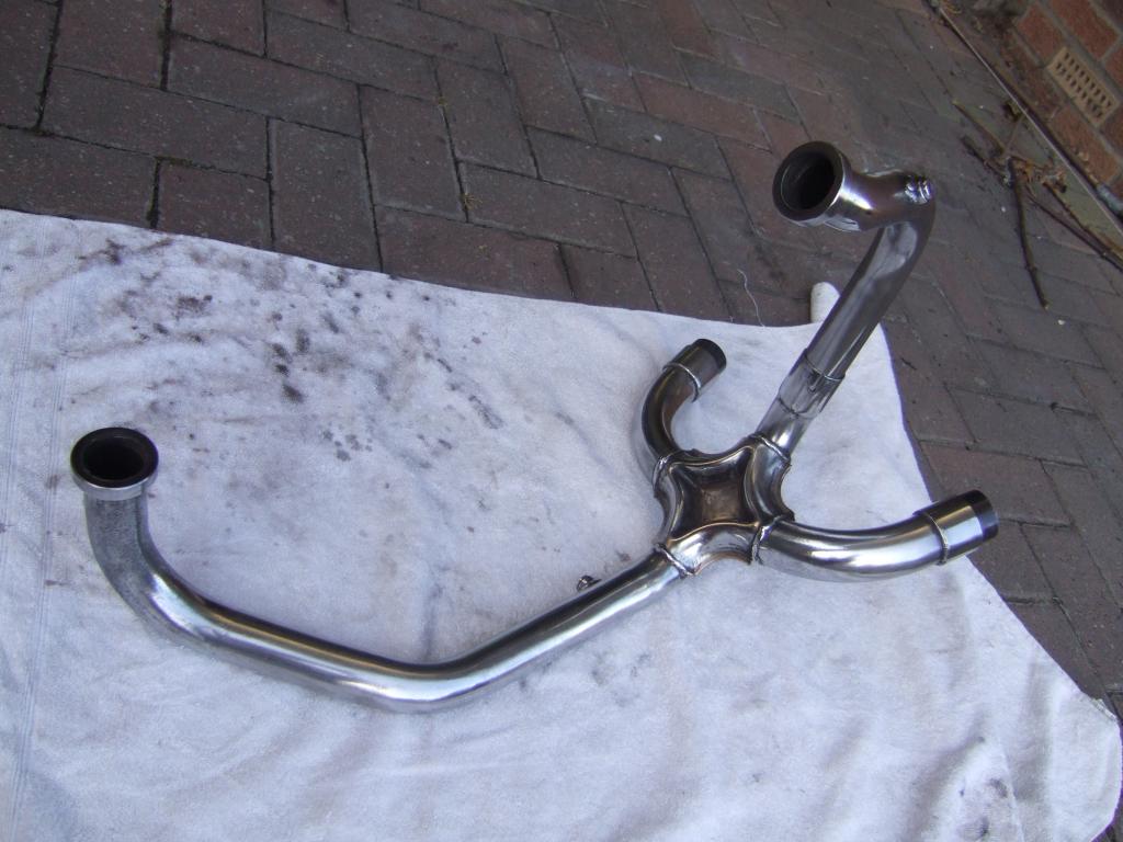

  1. Well, I think I've reached my limit on exhaust polishing for now:[​IMG]
    They're not perfect, and certainly not mirror, but they'll do me and at least they no longer look like they're stored in a pond. :upyeah: I couldn't get the collector polished up particularly well so I gave in and sprayed them with HT paint. I'll see If that lasts.

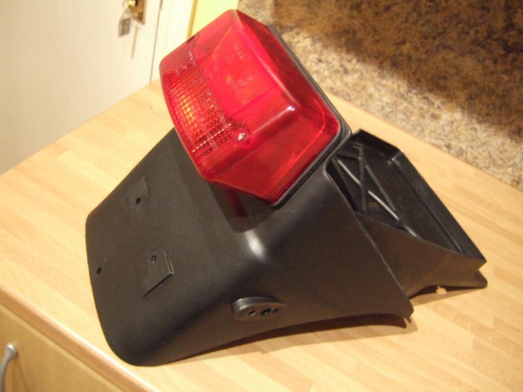

    Meanwhile, I dismantled the rear light and cleaned that out inside. The rear mudguard/undertray has a large crack next to one of the front mounting points. I've glued it up but it looks vulnerable so I'll reinforce it with glass cloth. None to hand at the minute though. Then I'll try and bring the black finish out a bit with boiled linseed oil (worked before, so...).

  4. Good job on the zorsts, but they will be brown within minutes of firing it up.....that's why mine are silver VHT.

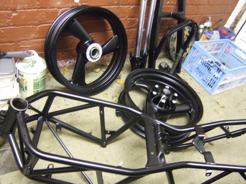

  6. So I got the frame, wheels, and the rest back from the powdercoaters. I'm pleased with the finish but not with the entire job. The p/c is nice and thin, smooth and even. Lovely sheen on the semi-gloss too, no runs or bubbling, and hardly any powder where there shouldn't be.
    But they have blasted just about everything in sight. Some of the bearing seats, the mating surfaces for the discs and inside the fork clamps (in the yokes) have had a very light blasting despite us having the conversation about masking prior to blasting. It really is a light blast, so pretty sure it'll be alright, but disappointing from an experienced coater. Fingers crossed now.

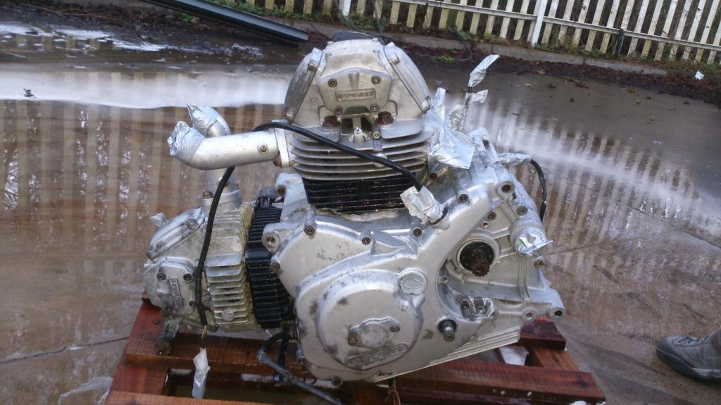

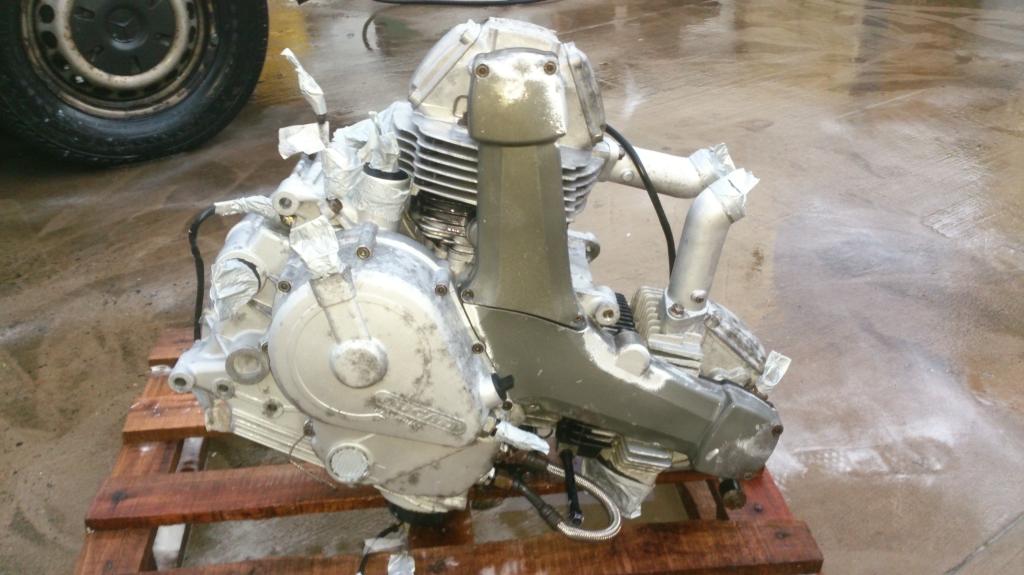

    Meantime I took the engine outside and steam cleaned it
    Immediately looks much better and easier to bring back to a decent finish. It's drying quietly in the corner before I soda blast it.
    A few wee jobs to do for the minute - finish off fixing the cracked rear mudguard, tidy up the front m/c and levers where they're a teeny bit scraped from an off, source all the various bearings and seals I need for the wheels, forks and frame... Feel like some progress has been made now.

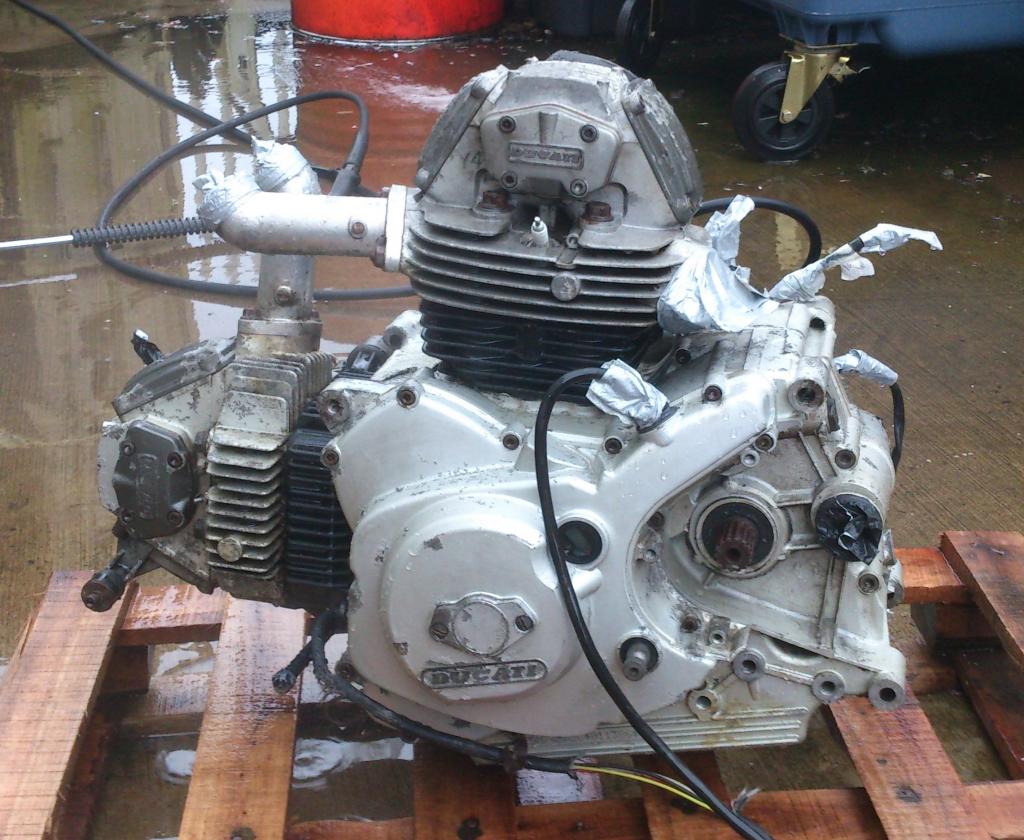

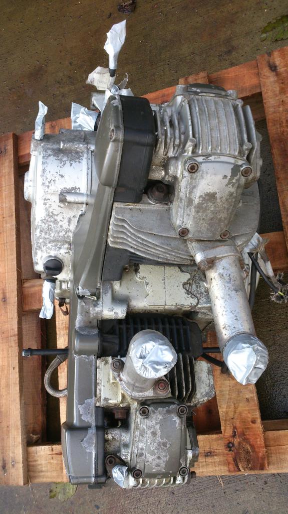

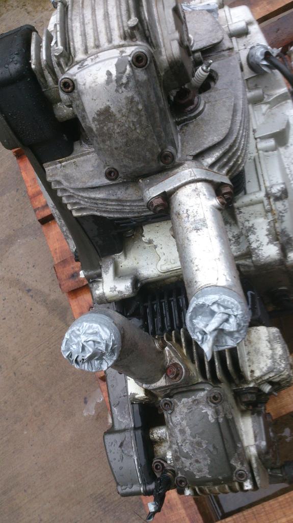

  8. OK, so had a crack at soda blasting the motor yesterday. Fuck a duck, what a mess that makes! Kinda fun though. Overall, I'd say I'm not as impressed as I'd hoped I'd be, but I think it's achieved what I needed. I'll be painting the motor, not leaving a raw metal finish or polishing so I only really need a decent surface for that. It lifted paint off really easily - should do given how thin it is - but didn't do anything for the oxidised areas of the engine. I reckon if there'd been loose surface material - genuine rust or owt - then it'd have worked on that. Where there's no imperfections, it gives a nice finish actually.
    Anyway, before:
    After:
    You can see on the belt covers the effect it had on the paint down to raw metal (not keeping those so didn't waste me soda on 'em). You can't see the difference too well in the pics actually - it's had a bit more of an effect than it appears from them. Flash doesn't help - it was getting dark by then..
    Motor's back to drying out in a corner again... Next to sand down any rough bits left over, etch prime and then paint (will take the covers off to do this as will put new gaskets in).

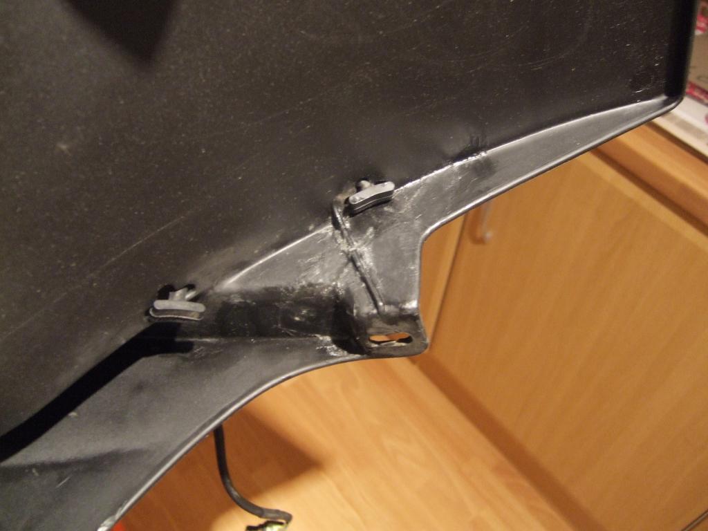

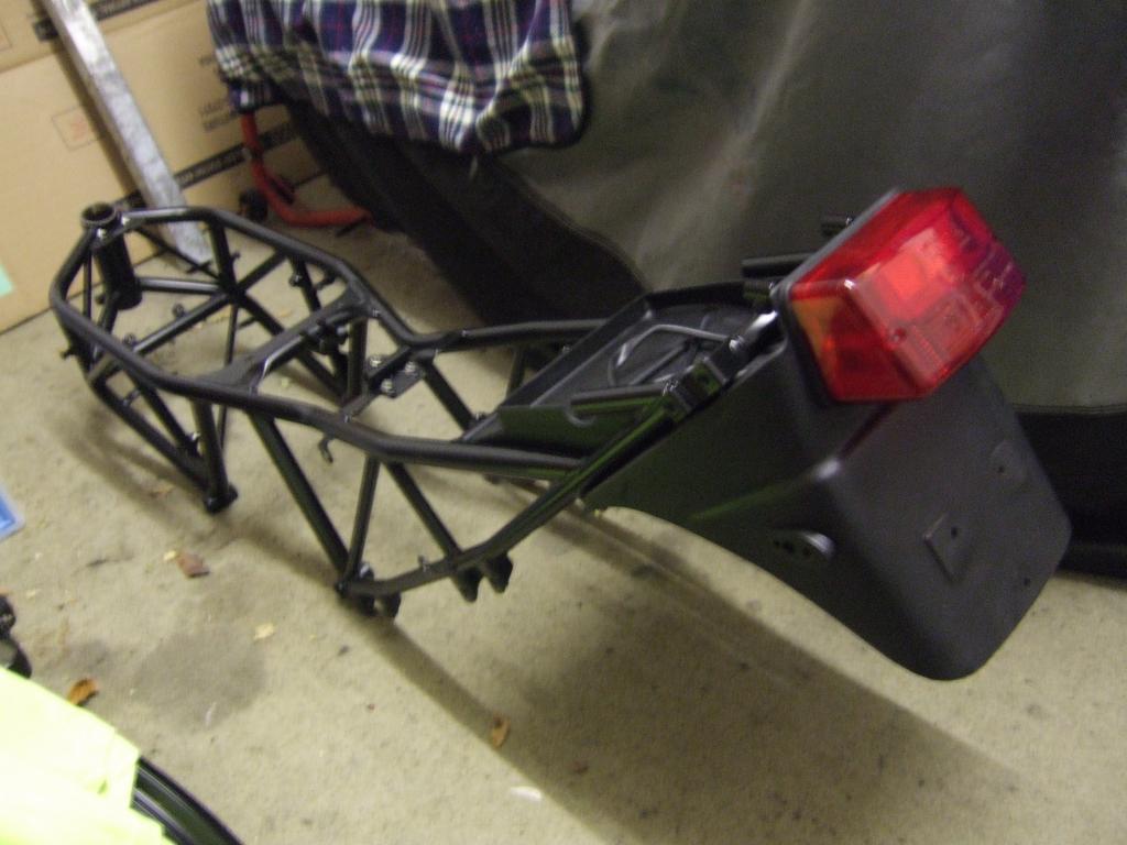

  9. I repaired the rear mudguard/undertray which had a massive crack across the mounting point. Glued it up first, then laid some glass cloth on it, rubbed down and tidied up. Happy with that:
    Sanded a few rough edges down, rubbed the whole thing with linseed oil, leave overnight, wipe off any excess, stick the light unit back on and:

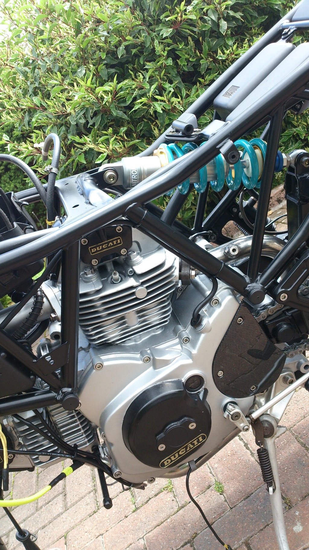

  15. Well, it's been a while... My forum account went west, we had a new baby and the like but progress has occurred:
    Since the pics above, the wiring is now mostly in, exhausts are being made as we speak, the bodywork is painted (not collected it yet) and the last box of odds and sods I needed has arrived (though no doubt there'll be something I forgot...). Having some trouble with brakes (leaking) and clutch (also leaking), but otherwise largely looking alright.
