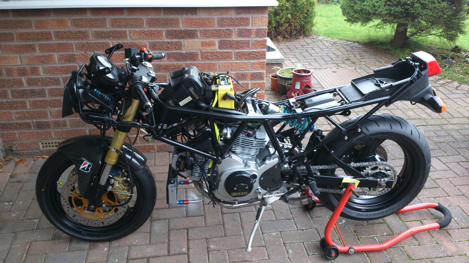

  6. so just a bit more progress to report:

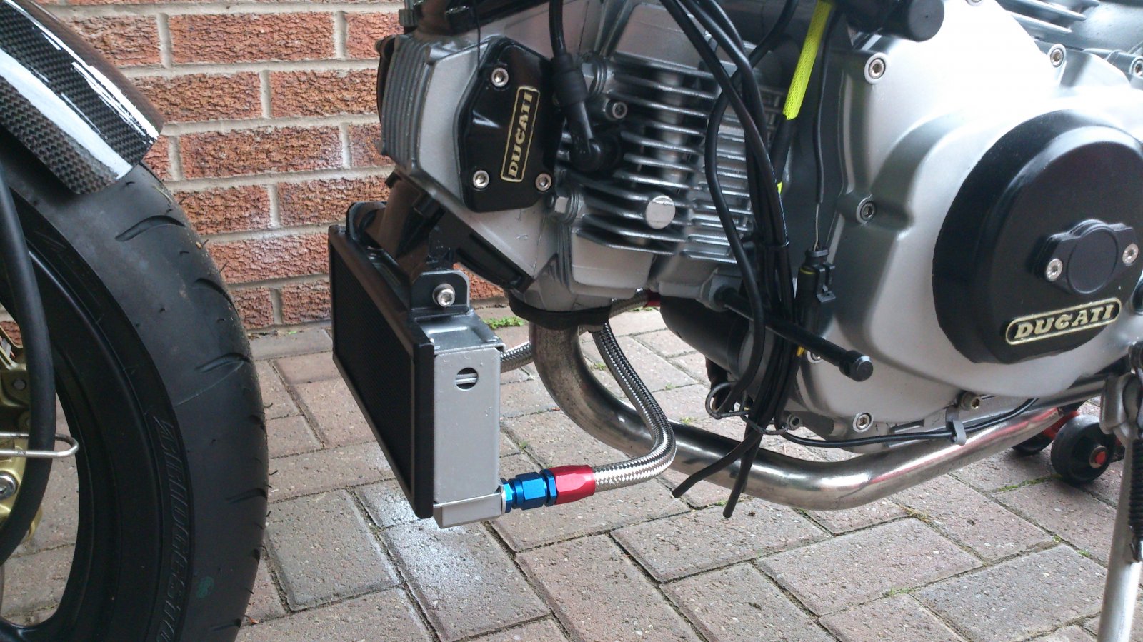

    Oil cooler cleaned up, cover on and plumbed in. Was going to do away with it altogether (it's not like it gets that hot around here...) but Mr Ducati wanted it there so...:
    Wiring in, battery on and...we have electrickery. Lights and so on work as they should - except the rear brake light - bugger (no wheelie bins, but there's a couple of plant pots for you..)!
    And this happened:
    Main issues now are the exhausts drama (see my other thread), sorting my leaky nipples (just ordered genuine ones from Ducati - seems those Brembo parts are classed as service items and can be got through Ducati), fill it with oil and see if it goes.... Then fit the bodywork up and...leave it in the garage til Spring...:Banghead:
    MICK..
  7. Along with engines like the Suzuki Bandit of the same era, the Desmodue is classed as an air/oil cooled engine, so the oil cooler is an integral part of the design, not just an add-on.
    So you were very wise to leave it there, I'd say.

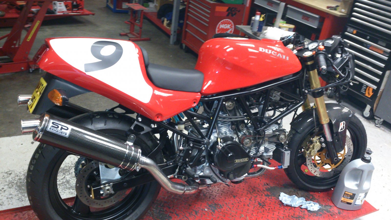

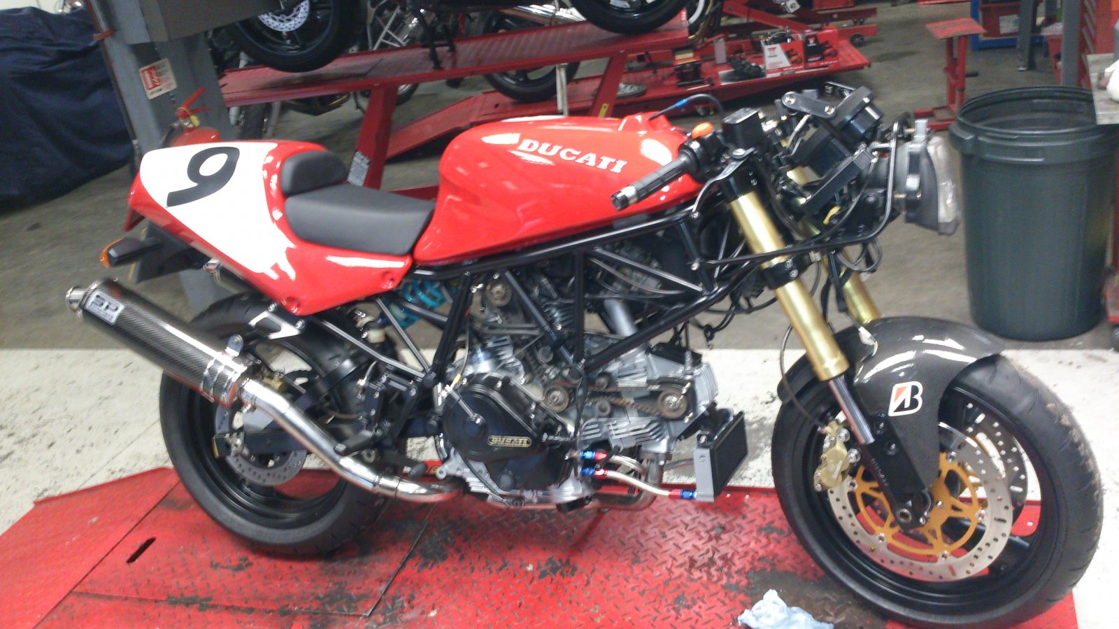

  17. Well, cover me in flour and eggs and bake me for forty minutes.. It works!! It actually works. I didn't break it!!:upyeah:
    Tank on, fuel lines connected, filled it with oil (bit too much but seemed happy enough...), 5l of petrol and....brum brum!! Second prod of the button. Smoked like a Mexican pirate as it burned off the oil, grease, dust and cleaning product, but started and ran for a good while reasonably smoothly.
    About the oil - the book says 5W/40 but the mechanic I borrowed the lift off said that was way too thin and it should be 15W. Any views?
    Still to do - more sorting the blasted exhausts: cutting and adjusting for now, but if it all goes OK, I'll cut them properly next year and weld the cans to the link pipes. See if I can find a solution to the continually weeping brake bleed nipples: it's only a tiny amount now so not desperate, but not ideal obviously. Fit the remaining bodywork and so forth. Probably change the oil and make sure all's good there. Sit back and feel chuffed with myself....:Smug:
    Mick..

  19. m
    Well done!
    So your mechanic friend knows better than the Ducati engineers who designed and built your engine? Clever guy...
    Reminds me of the Triumph mechanics who told me I might as well piss in my engine as put new fangled multigrade 20/40 oil in it. What I needed was good old SAE 30 or 40 oil in it.
    What they didn't understand was that although 20/40 oil was thinner when cold than SAE 40, it was exactly the same viscosity when hot. Amazingly, your mechanic pal seems to suffer from the same misconception 45 years on!
    #79 Old rider, Nov 5, 2015
