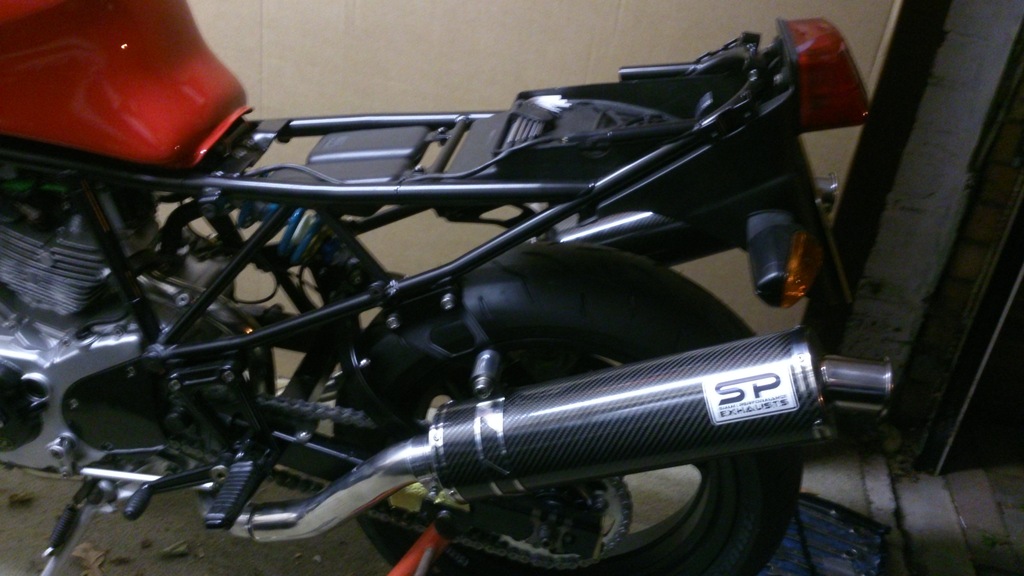

  5. So I've finally got to a workable solution for the blasted exhausts. Needed a good chunk lopping off both ends - in fact as much as was actually feasible before getting into the bend such that the can would no longer fit. Also needed to fab a couple of spacers about 1.5" deep so the cans would line up right.
    Still not quite as I'd like but they look OK and feel sturdy enough (sorry for the photo - it was cold, dark and I had no room in the garage to get the right angle for the pic). Anyway:
    Assuming the bike runs and rides OK come spring, then I'll have the cans welded to the link pipes which will allow me to cut a little more out too. All I can say is I wish I hadn't bothered with these pipes. I know many on here speak highly of Steve's stuff but these may as well have been from a Vauxhall or summat. Never again.

  11. Who did the link pipes?
  12. they're Steve's (BBB Fab). Well, what's left of them are now we made them actually fit.
    Mick..
