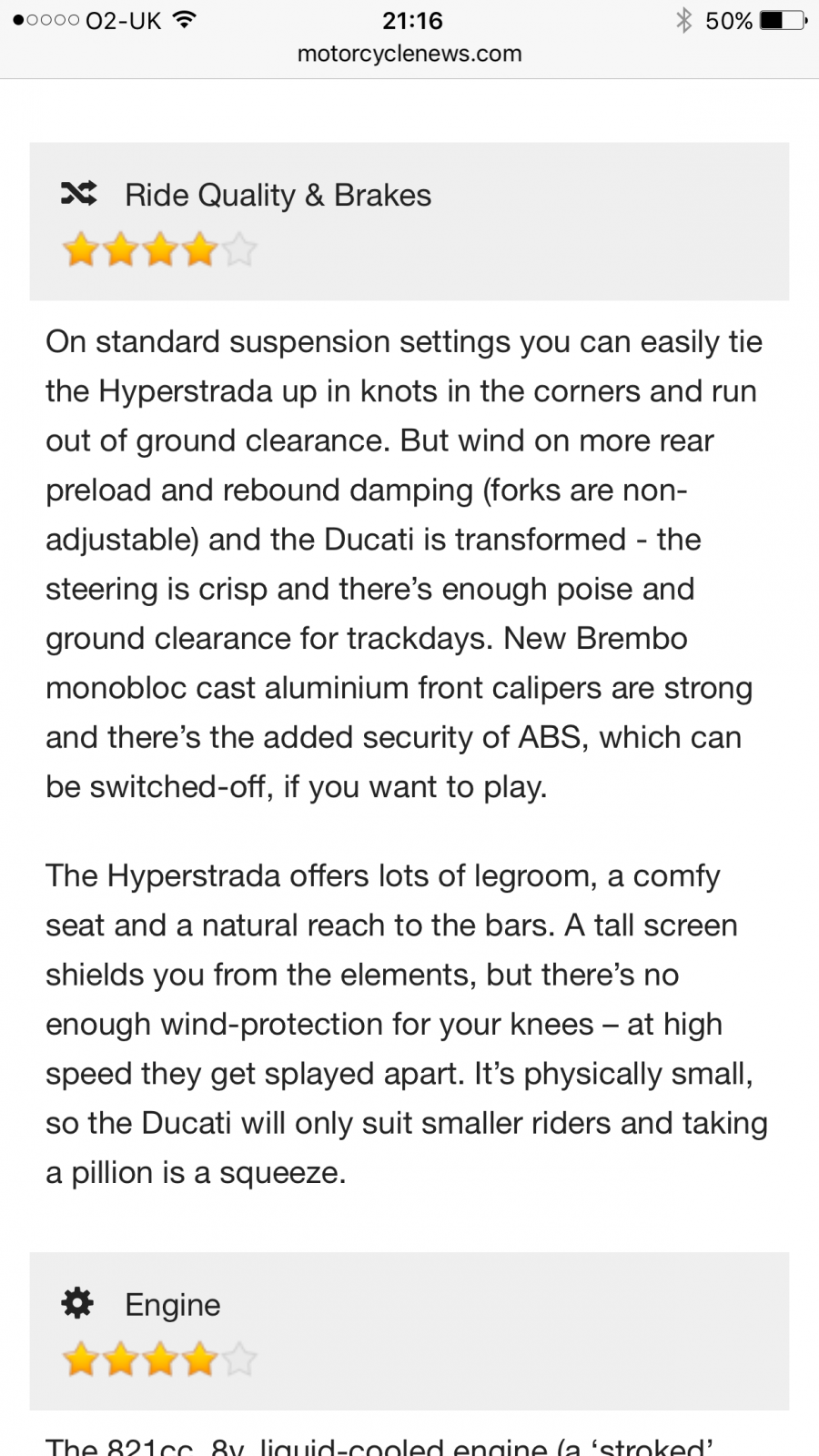

    Took this from MCN review of the hyperstrada. So turning up the preload sorts it out?
  16. Yep I'd start with setting the rear sag, sound slike its just sitting way too low in the stroke and with soft setting being compounded
    May be worth taking it somewhere
  17. I'm 13 stone and 6ft3 and don't have any issues. Raise your preload and rebound and see how it is. Might completely sort it.
    Oh and bin that centre stand.
  18. Mine came from the dealer with the lowest pre-load set!! I wound it all the way in, can't remember how many turns to get full pre-load but its a lot.
  19. I've already turned it up 20 clicks.
