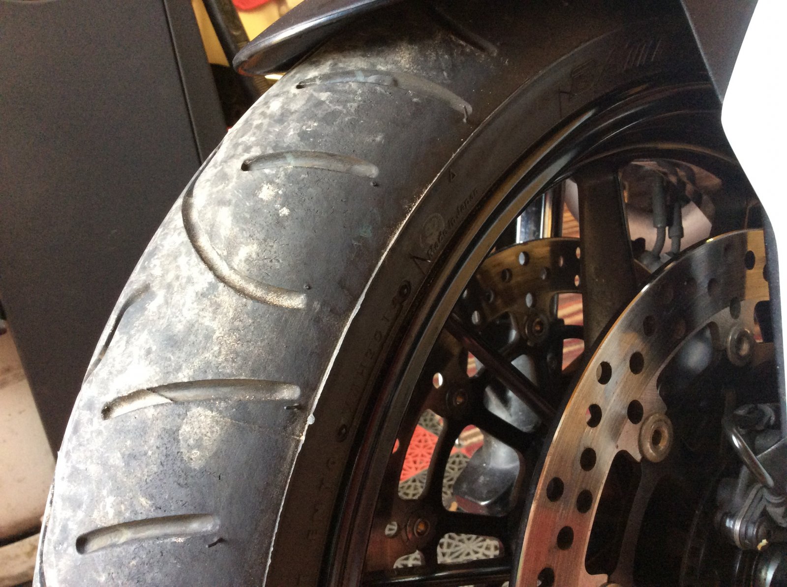

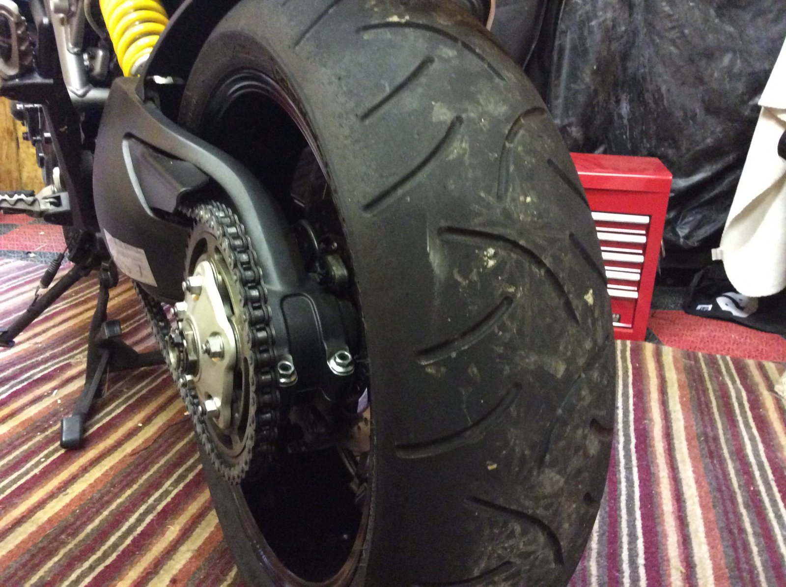

    The tyres are Bridgestone Battlax BT14's and as spoken there are almost unmarket and to me have chicken strips to be ashamed of which is good as it shows the suspension is not right , I'm a fat bugger and when sorted I'll be elbow down with inches , fnar fnar , to spare
