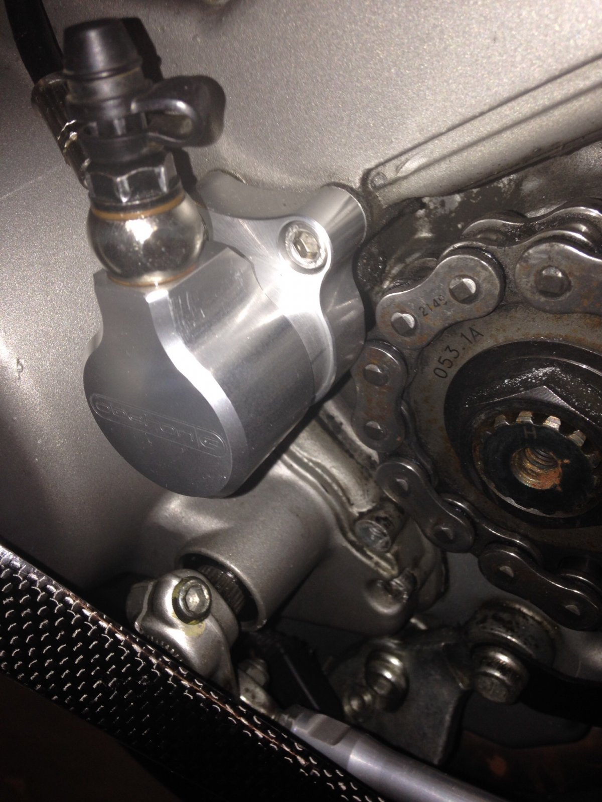

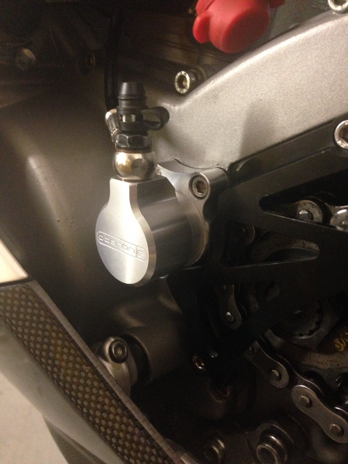

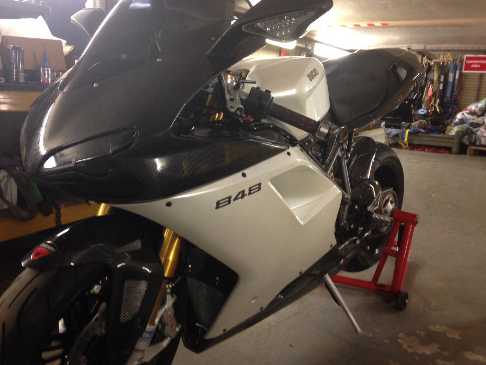

  9. Oberon clutch slave cylinder fitted. Bleeding it took a few minutes but as soon as the master was cracked a couple of times, all went well. The Oberon unit is slightly bigger than the std one, so I had to remove a little material from the aftermarket sprocket cover. All in all, 30 mins work.
    The clutch lever does feel a little lighter and hopefully, engaging neutral won't be a problem.
    Also worth noting that the newer Oberon slave with T section can be used with the older non T clutch push rod but there's no room for the O ring. I just used a bit of gasket sealant.
  10. I SEE RUST....nooooooooooooooooooooooooooooooooooooooooooooo
    disgraceful :Bag:
  11. Nowt drastic! Just a bit of squirted brake fluid! Job's a good un. ;)

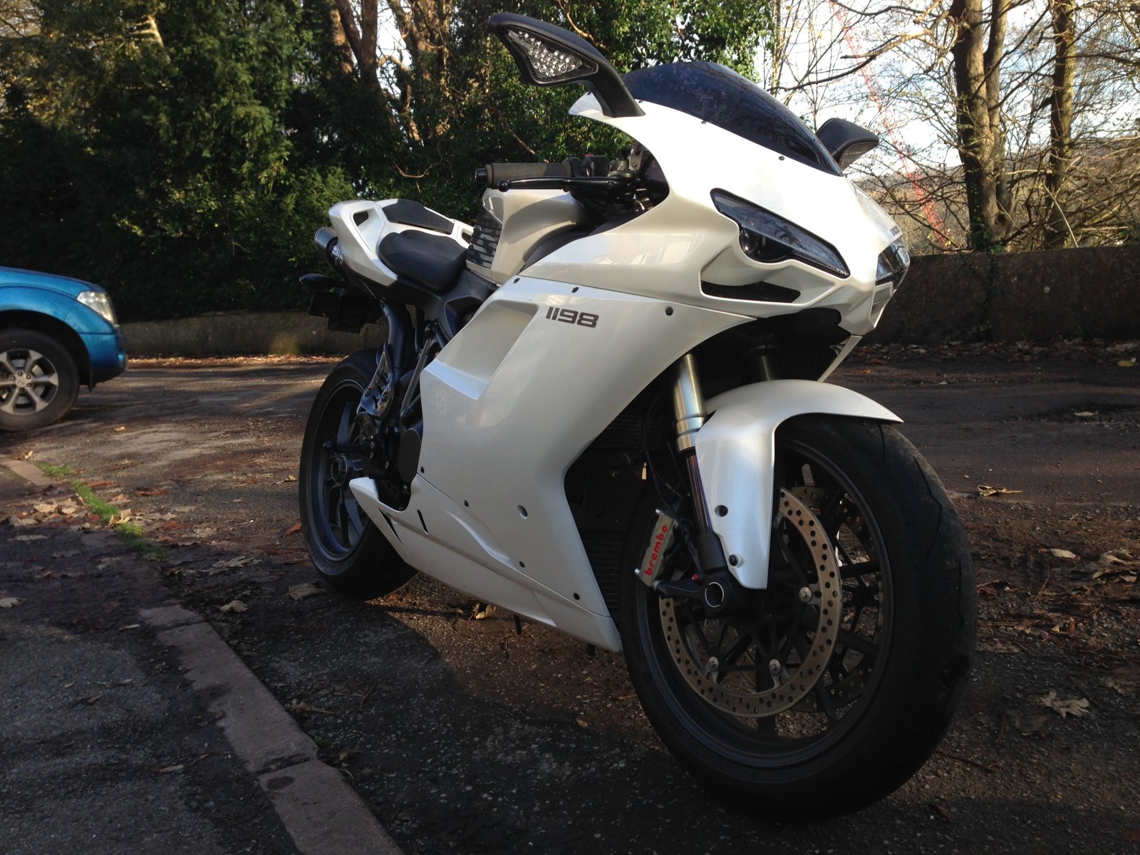

  12. Ive added some Helibar Tracstars to my 1198. They raise the bars by about 1/2" and bring then nearer by 3/4" and are about 1/2" longer. They 'feel' about right now. I also added some grip buddies from Nippy Normans and they work too. Hands didnt get too tingely but they bars felt fat which took some getting used to.
    Ive also added an oberon clutch slave and it too works a treat. Nice product.
  13. Bootsam,
    whats grip buddies, as your grips look the same in both photos.
  14. I think that photo's from a www page. Be interesting to know what you think about them after a long ride out...
    Ian
  15. Thats not my bike. :)
    If winter gives me a nice sunny dry day with no salt risk then a long run will be undertook. I had a shortish run on them.

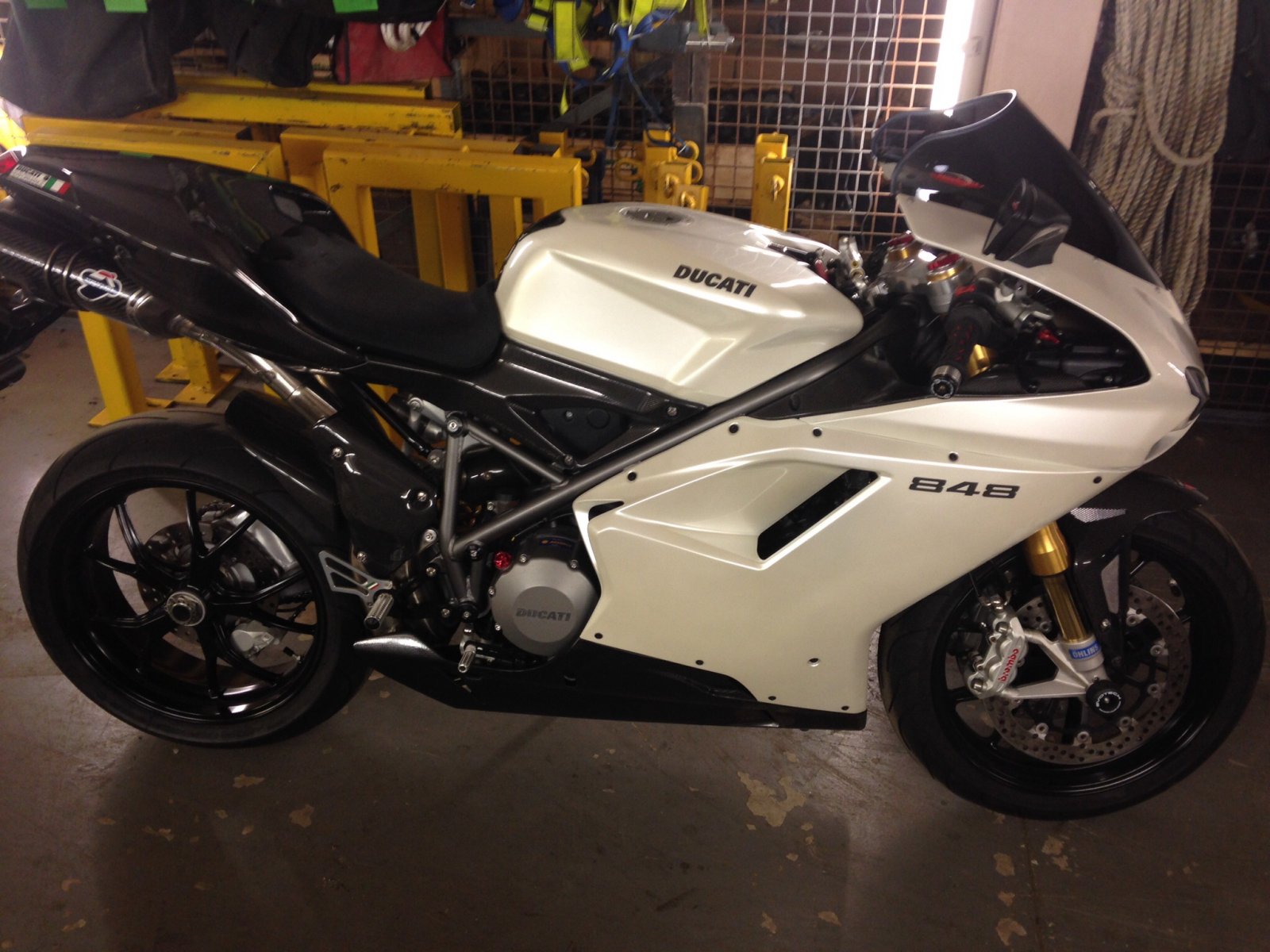

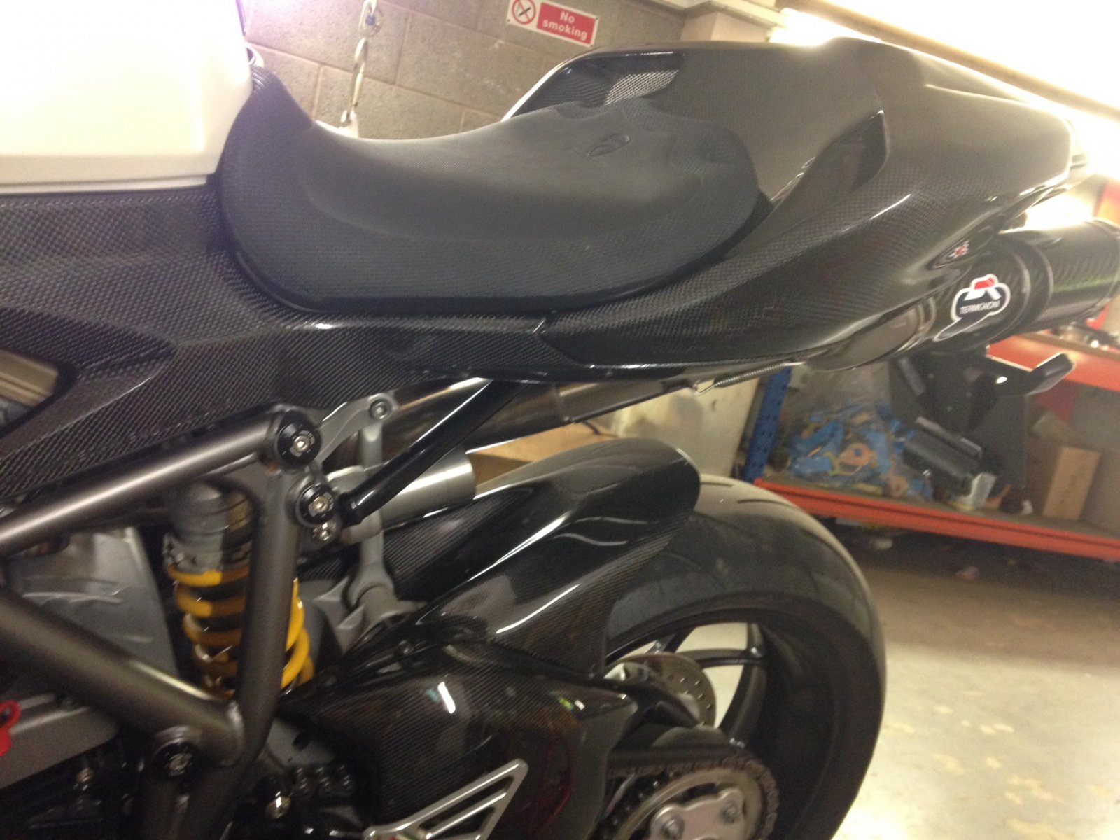

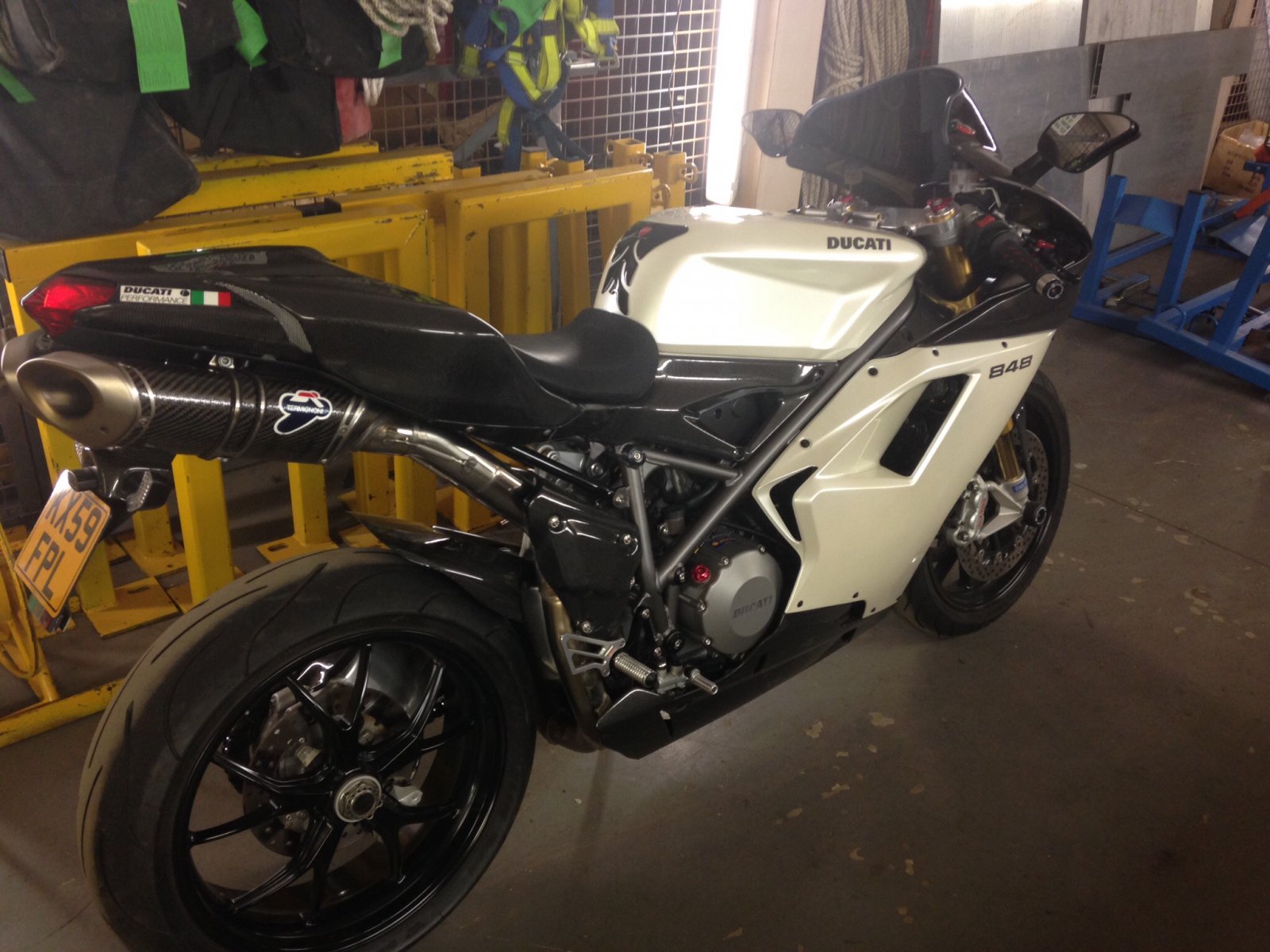

  18. Seat fairing on. Hard to imagine just how much lighter this is compared to the standard one. Could be as little as a 3rd.
  19. Very smart and you have a superpole seat, I've been on the look out for one of them does it take a bit more strain of your wrist's, plus i keep sliding on the standard seat.
