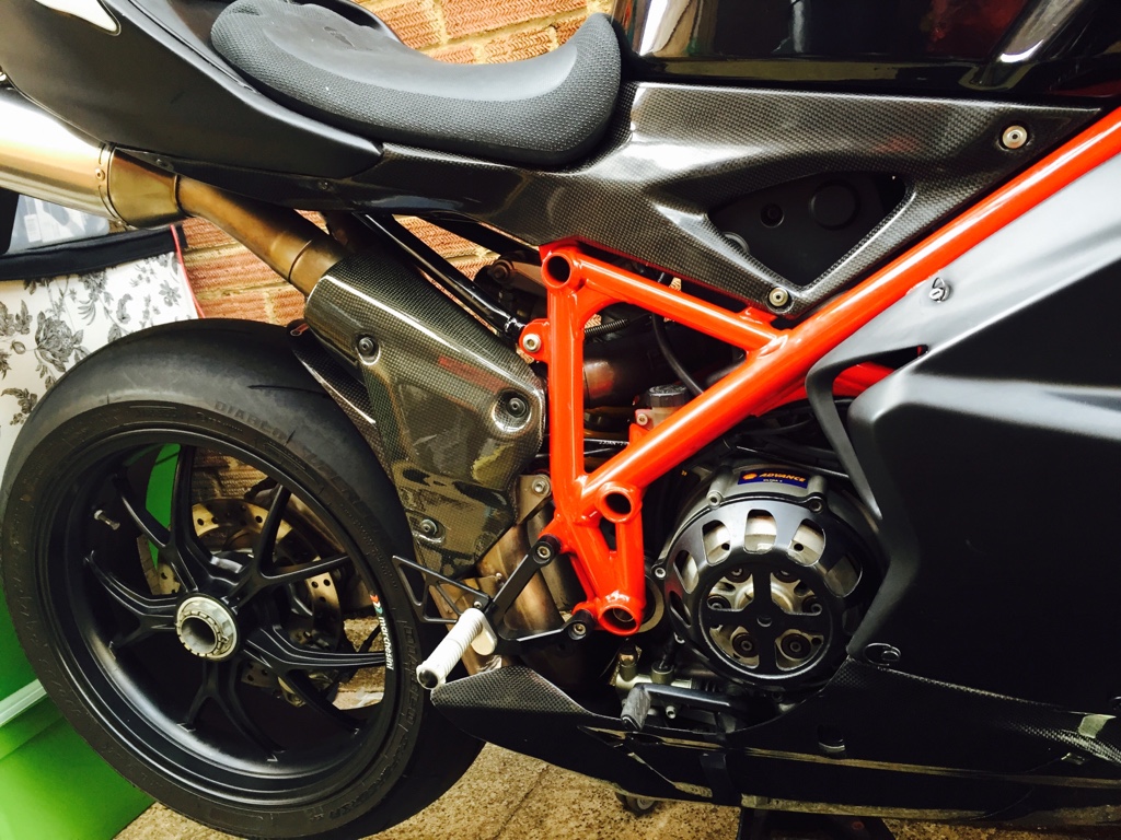

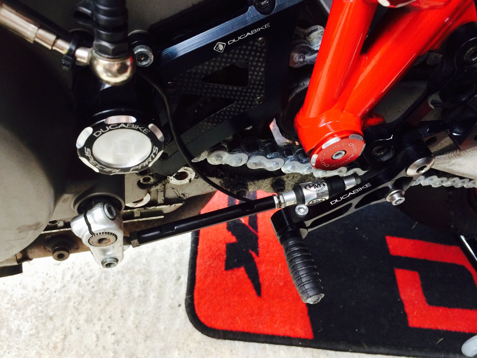

  8. EVR racing slipper clutch and HM quick shifter, both performed great at Jerez last image.jpg image.jpg
  9. Where is your carbon clutch cover from thespion?

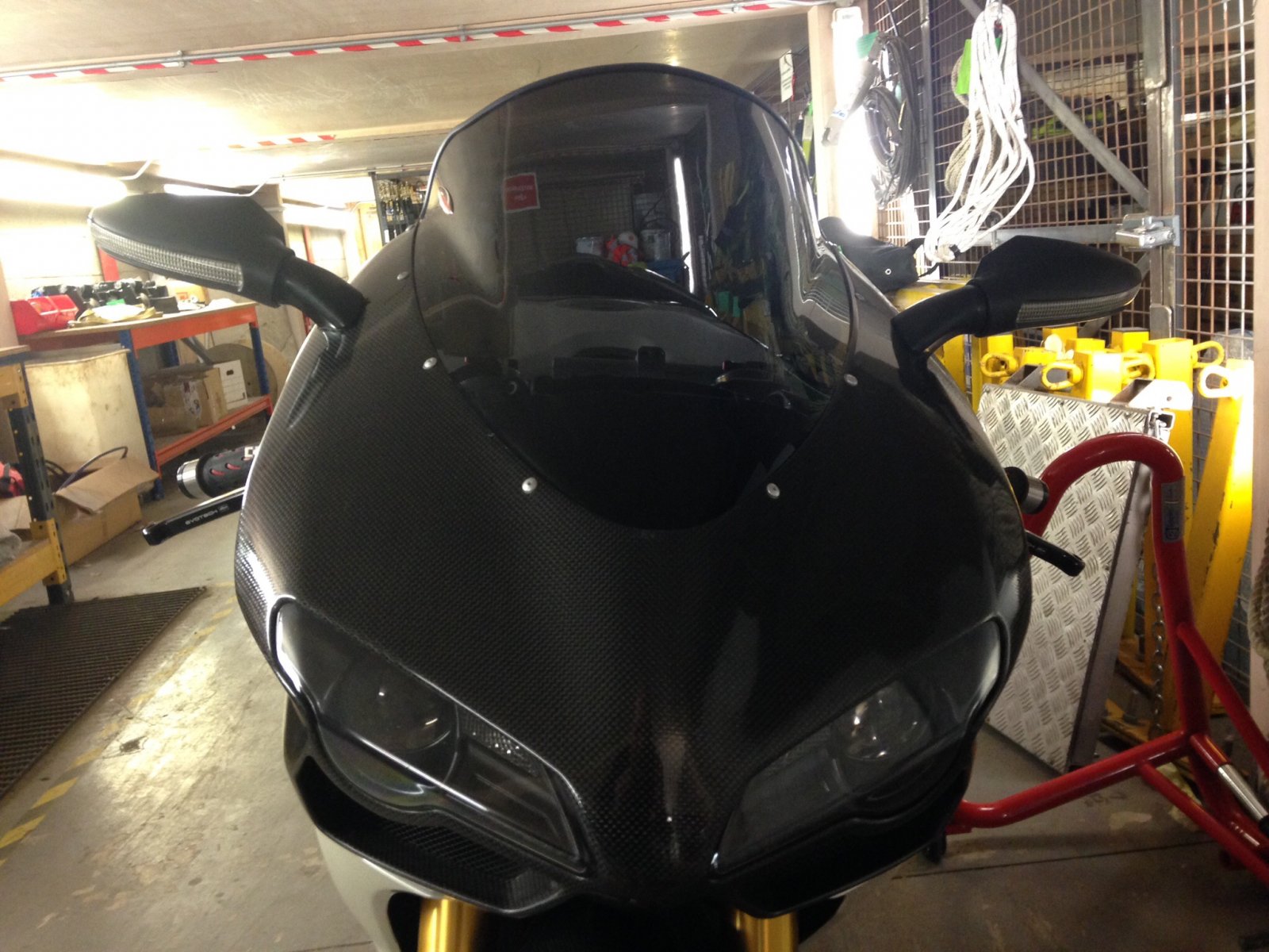

  10. Just had the DP mirrors repaired and fitted them now. I think they look miles better that the standard ones and am looking forward to seeing if they offer better vision on the road.
  11. Are they narrower than the standard ones mate?
  12. Yes they are by quite a bit. On the downside, the indicators are very dim. But I knew that before putting them on.

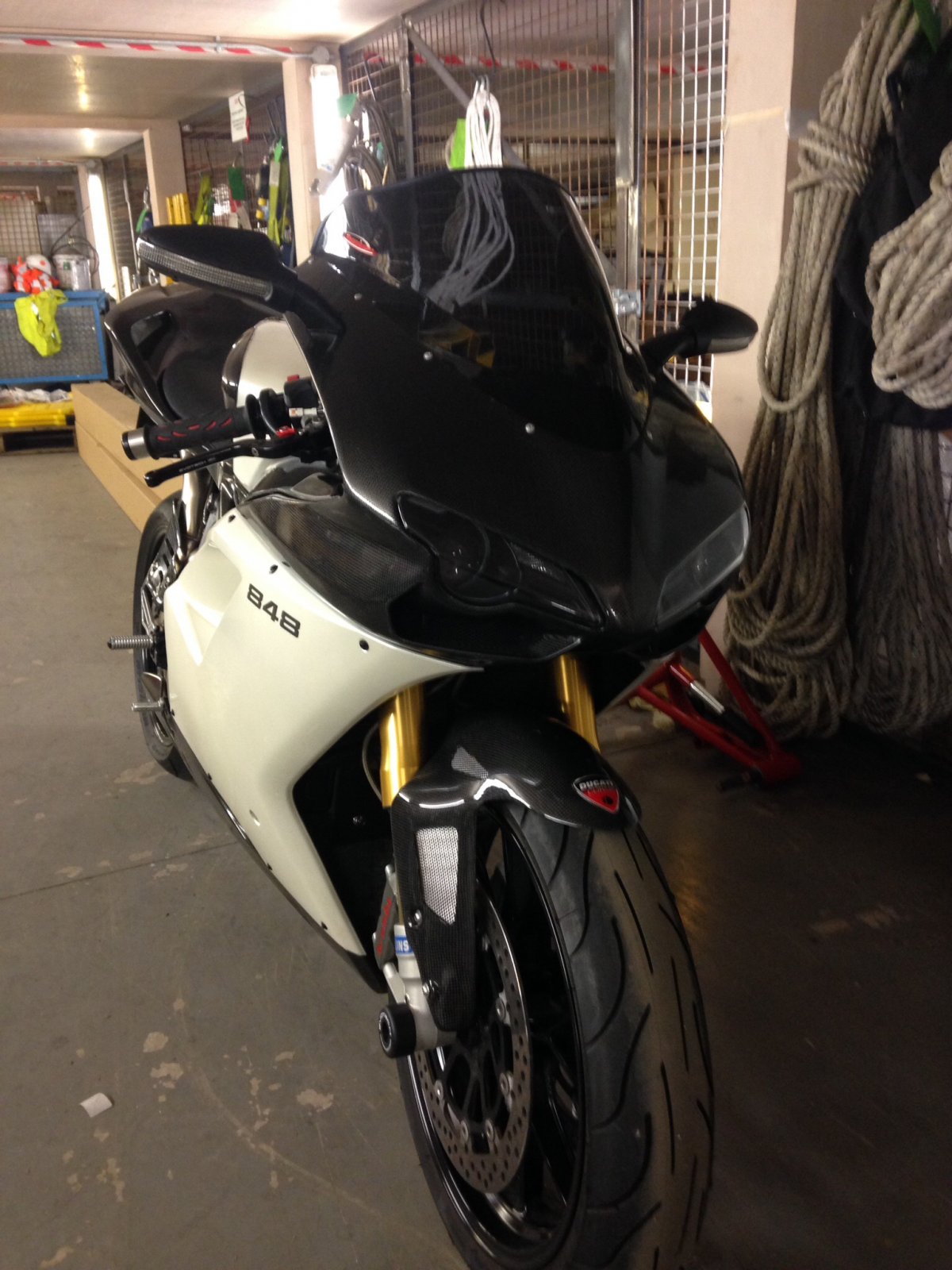

  15. Belt service & oil filters etc, also added more (yes I know) carbon too

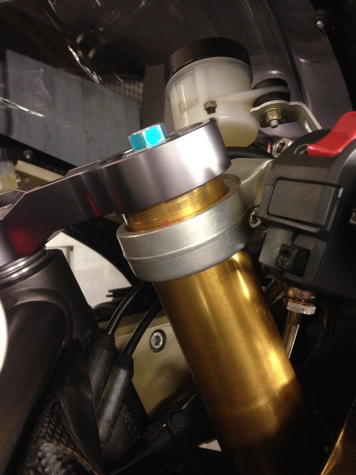

  16. Speedy moto top yoke fitted. Needed to drop the forks about 10 mm to get the fork tops flush with the yoke. Raised the bars about another 10 mm and now have about a 30 degree sweep to alter the position of the clip ons. Going to have a ride about on it to see if I want to fit the helibars for more height and comfort.
    Second photo taken before moving the clip ons. Had to strip all fairings, right down to the air tubes in order to get to the bottom yoke! Happy with it so far.

  17. Two jobs done finishing up this morning
    [​IMG][​IMG]
