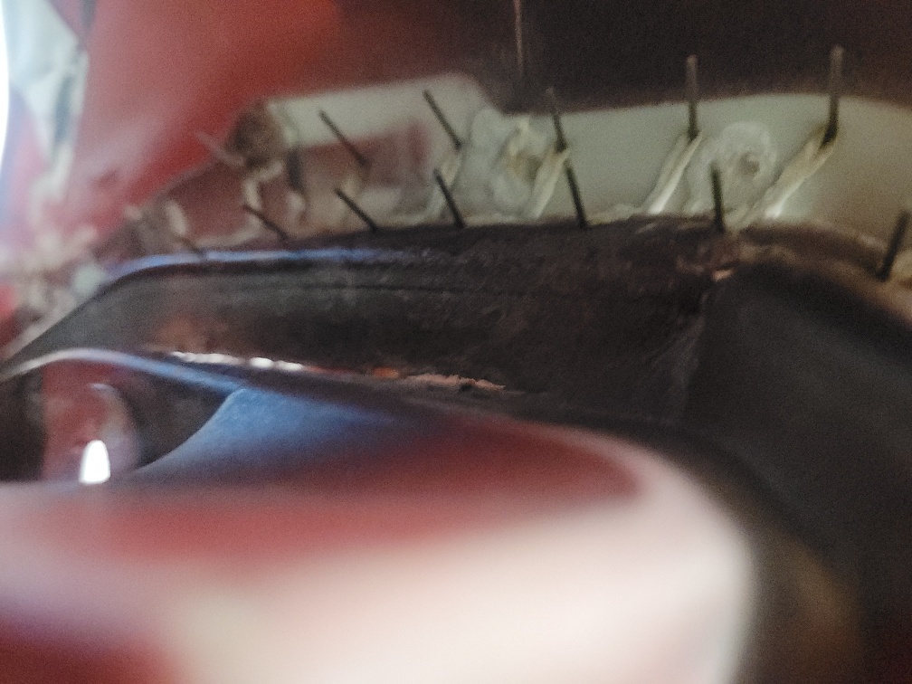

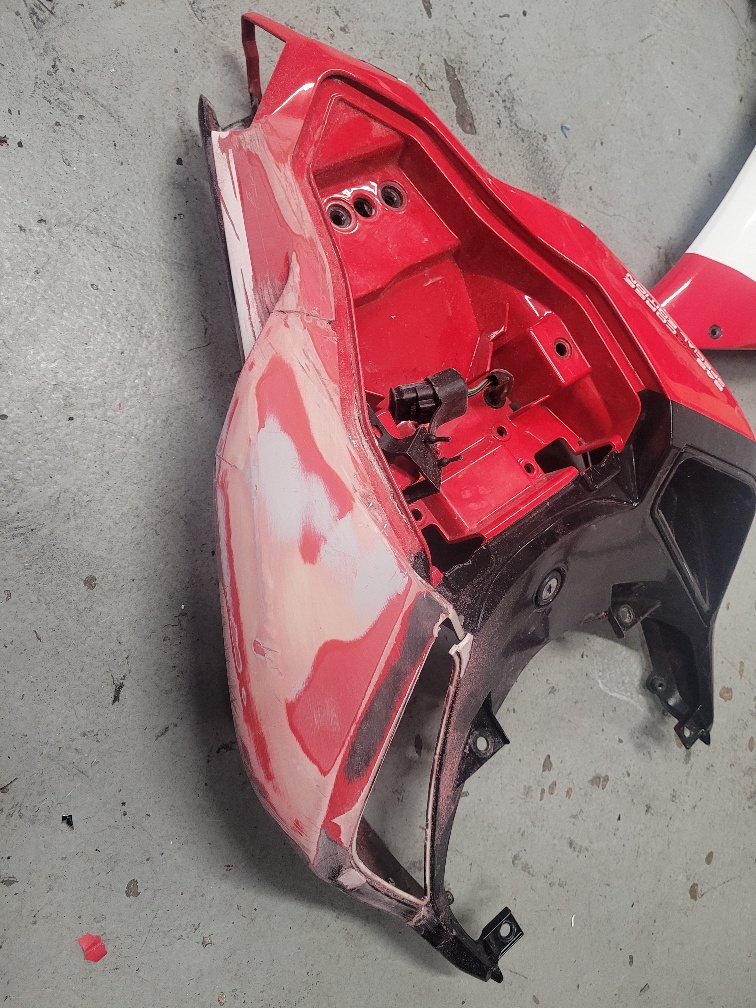

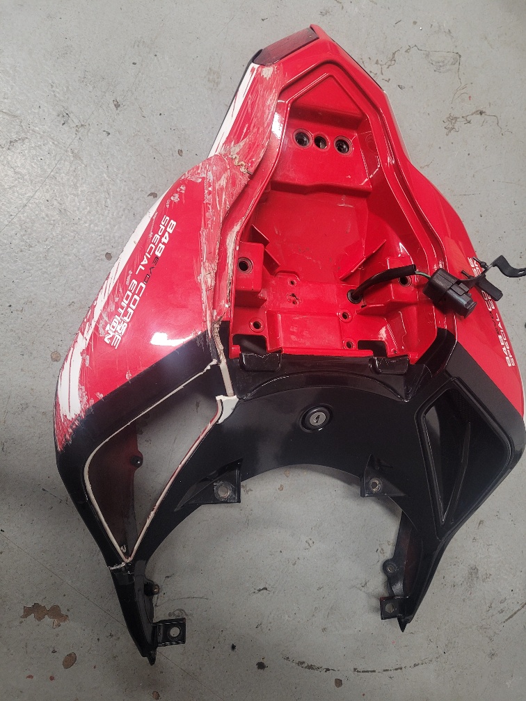

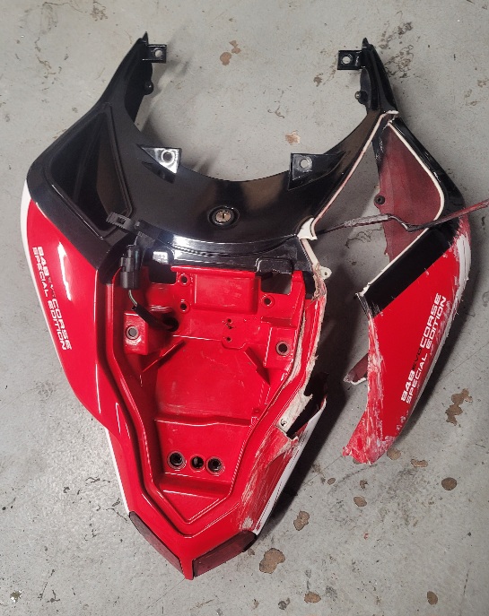

  2. Started with this:
    Moved to this:
    With some of these to stich it together underside:
    Then started sanding and grooving top to plastic weld:
    Also received fr tyre in post, so left in sunshine for morning and fitted at lunchtime. Nice and easy when warm. Done. At least that was one easy job

  3. Excellent pictures I love all that detail.
  4. Those staplers are great and also quite addictive!

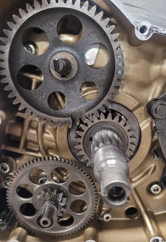

    When i picked up the replacement engine it didn't come with the generator cover as the previous owner had sold it, as well as the flywheel and starter motor. He had kindly placed the flywheel retaining nut, washer and various fixings back in their respective positions. Over the weekend i decided to reassemble this side of the engine with generator etc, so then it would be just the timing belts to refix. I soon realised that torquing up the centre nut to 330nm with the engine on the bench was a no go, as too hard to hold (and to be honest i wanted to see some fwd motion with the assembly) so i made the decision to fit the engine back into the frame. I then got carried away and refitted the swingarm, forks and various smaller ancillaries.
    This evening my neighbour came round to assist in the torquing up of said 330nm nut. Whilst torquing it, it appeared that things were not right and that the timing seemed out. This was weird as front belt wasn't on and as i had been told the rear belt had only recently been fitted, i made the assumption its fitment was correct. I whipped the rear head off. I wanted to be 100% sure, plus wanted to check if any previous contact. No contact. I then thought i'd refit the head off the old engine as i knew they were ok, as they came of the bike which was crashed, but engine was working fine (well, pre-crash before it lost its sump and all its oil). Anyway, everything cleaned up, new OE head gasket fitted, head bolted down (waiting to be torqued up). I chucked the rear belt on, but no pulleys at moment. Then i threw on the front belt and timed it up (that one is easy as loads of advice!). Turned engine over by hand and it turned fine and then stopped/locked up. WTF*!*?
    I checked the TDC mark and then checked TDC using the ole screwdriver down the plug hole method. Nope not tdc. Eh?!*
    Went back to the generator side and stared at it expecting something to jump out at me. I couldn't understand how the TDC mark wasn't at TDC. So i started working backwards and started removing the flywheel and associated gubbins. I noticed that the timing belt driveshaft gear had a dot stamped on the face. FFS, i know what i have done. I looked at the idle gear on the crank and there is a dot on that too...which according to the manual ... and logic, line up, to create TDC. I had assembled 2 teeth out... Now refitted, correctly, and then decided before i make any more mistakes i'd leave it for this evening. Luckily i was turning it over by hand. The engine will be doing a lot more hand cycles during this rebuild
    The culprit dots above. In my very weak defense, the dot on the crank gear is very small, especially for my aging eyes...
    So 1 step forward, 2 steps back. But hopefully this will help someone, (as in anyone else who like me, can't be bothered to reference the manual :worried:) Manual now constantly be referenced on laptop. I am hoping its all plain sailing from now on o_O
