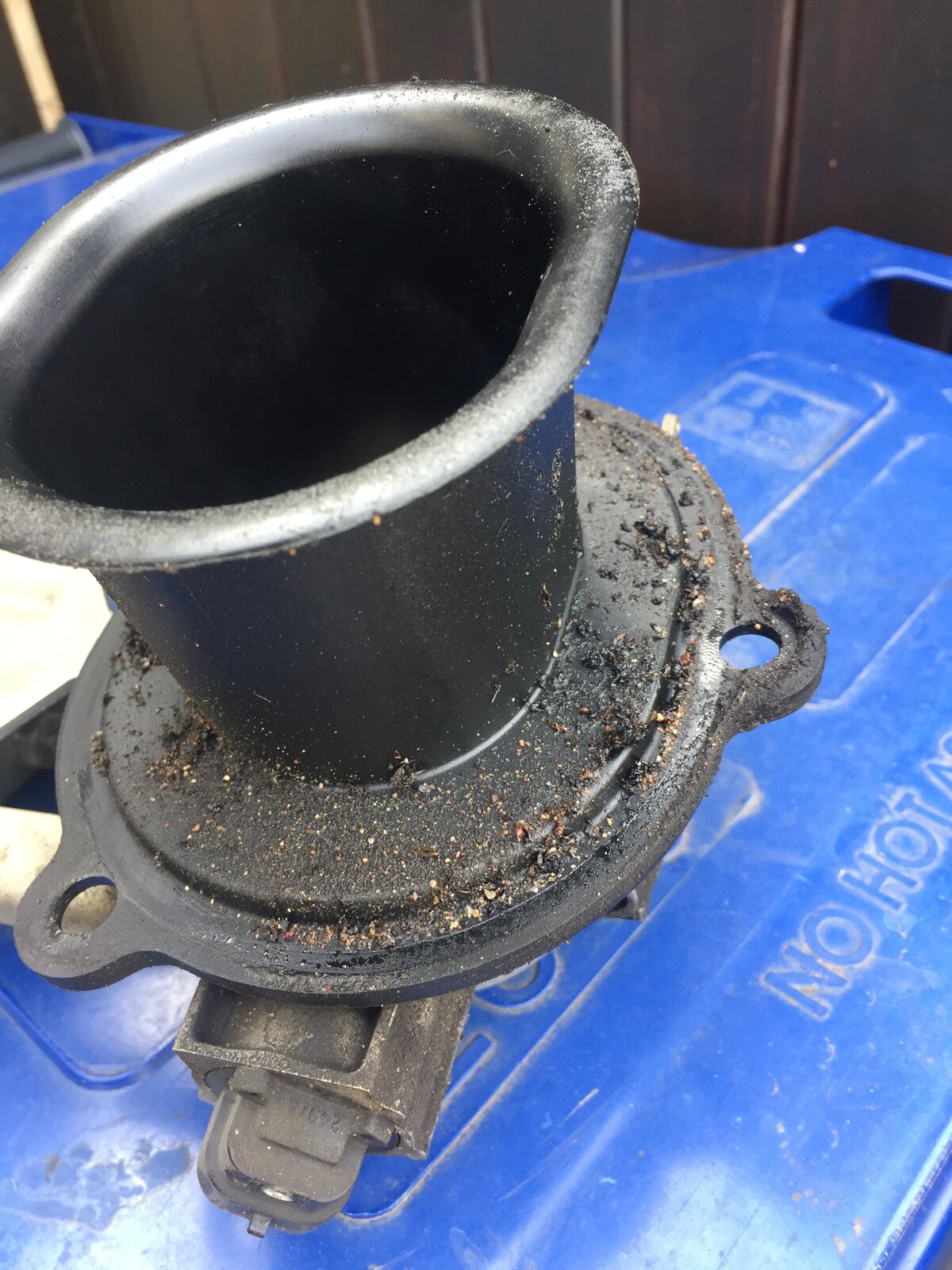

  4. I've yet to my collect her; so I will have a close inspection of the old airbox and provide an update later. I'll also find out if my battery tray/lid had/has a tie wrap and which brand of air filter was fitted? As previously mentioned, I've not had enough time to spend on my bikes; last year was a complete blur! But now I've a new double garage I've a tad more space to scatter bike bits!
    The oil on the coil sticks was the issue - so..... new plugs, belts, fluids and air filter she apparently 'pulls like a train' again and no sign of a mis-fire or dropping one cylinder. Can't wait to ride her home especially if the weather holds - happy days!! :D Thanks to all for the suggestions and tips - and of course AndyB.

  12. Now I'd also be a tad disappointed at not knowing what 'the fault' is - hate chasing my tail. Hope your dealer manages to get it sorted ASAP! Not that you'll want to read this, but collected mine this morning (after sitting in t'other halfs car in full leathers and stuck on the A38 for 1.5 hours which the traffic agency decided to close!!!), however, made it to the garage before it closed and enjoyed the ride home - normality is restored apart from the bank balance o_O But she's worth it... :) Good luck terryphukwit.
  13. Thats awesome news, so glad they found the fault and got it sorted for you. Why was the oil leaking, I assume the valve covers, not screwed down tight or bad seals??
    On the bright side I now know it is not going to cause any more damage as it were so im out on a DOC run today:upyeah:
  14. Enjoy your outing, just keep the revs up! Yeah...I gather the valve covers are not sealed from factory? They are now!!
  15. Maybe @chrisw can help with the remap? Think Antony stopped the mapping a while ago at avanti
  16. The valve cover seals aren’t the greatest. They seal fine when new, but over time they give up across the face of the cylinder head. Nothing comes loose etc. whenever I replace them, even new ones, I seal them down on a thin layer of threebond. It’s very common to find the plugs wet with oil, when it gets bad enough the oil tracks up the coil stick and there’s ya misfire.
