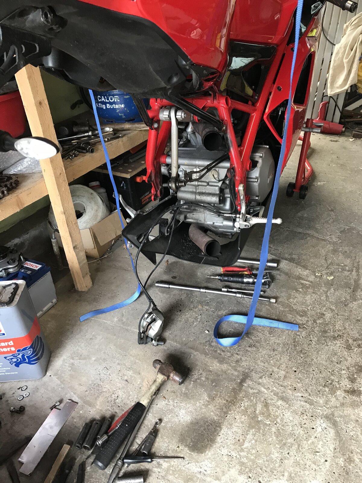

  3. Thanks, rattle gun did not help, I have a friend works at a bus garage, they have big inch drive breaker bars and scaffold poles..

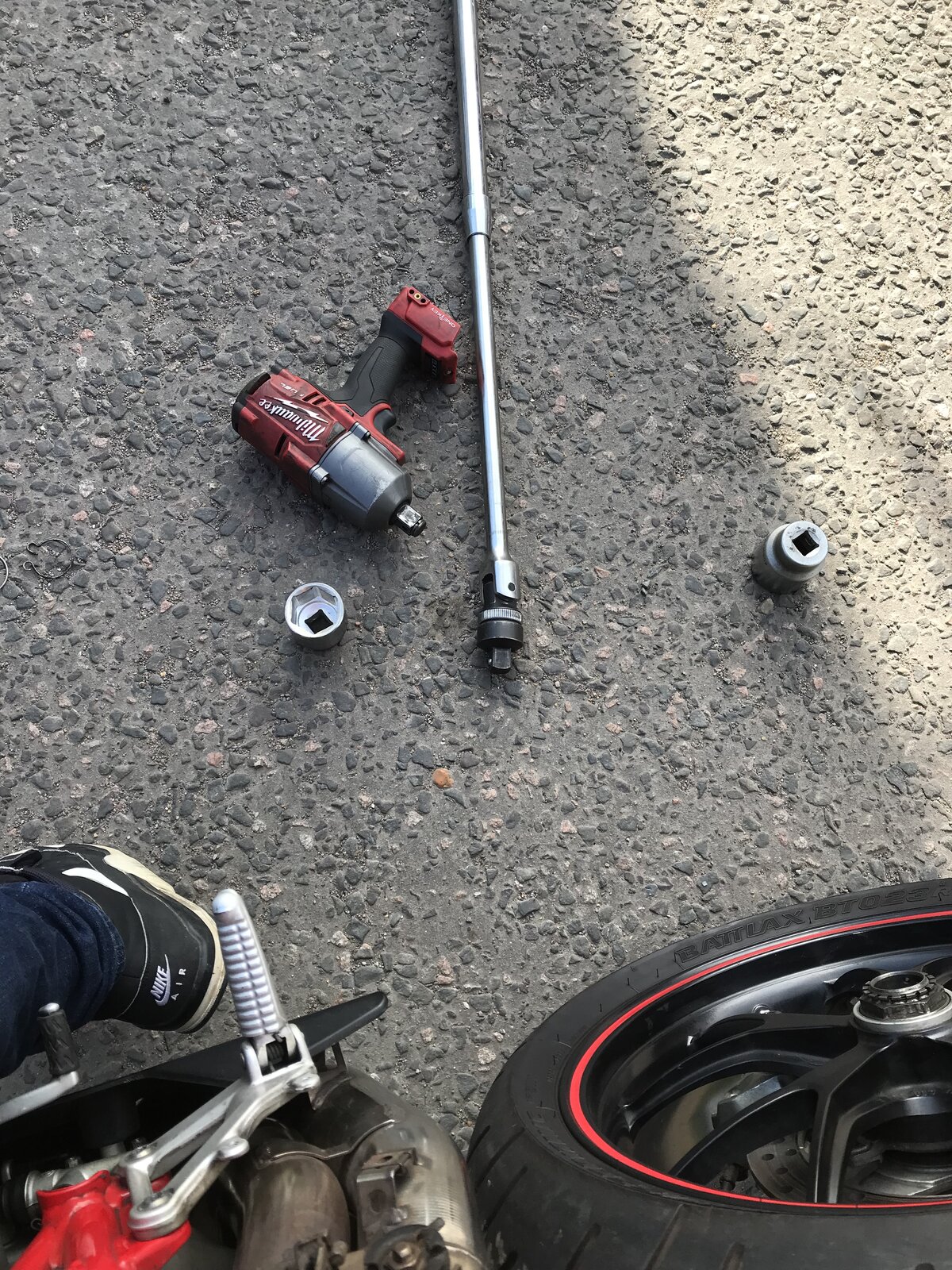

  9. 59554805-74A0-495C-9310-E9B992A9F6E2.jpeg So this helped, a local bus garage came to my rescue.
  10. FE7BFF27-FCF4-450C-9ADC-1CBF0110BB86.jpeg I guess half a desert is fairly standard
  11. D95280AB-8D75-4BC7-96DB-AB5168364332.jpeg And the winner is

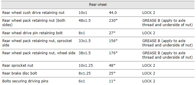

  15. Ive just finished what your doing and had a hard time finding the torque settings for wheel side nut and sprocket side as the workshop manuals state 230Nm both sides which is incorrect, that is for 1098 as they have a bigger axle and same size nut either side. I suspected was the same as my 748 at 176Nm wheel side and 156Nm sprocket, but just to make sure I asked Moto Rapido and yes it is. See attached pic they sent me.

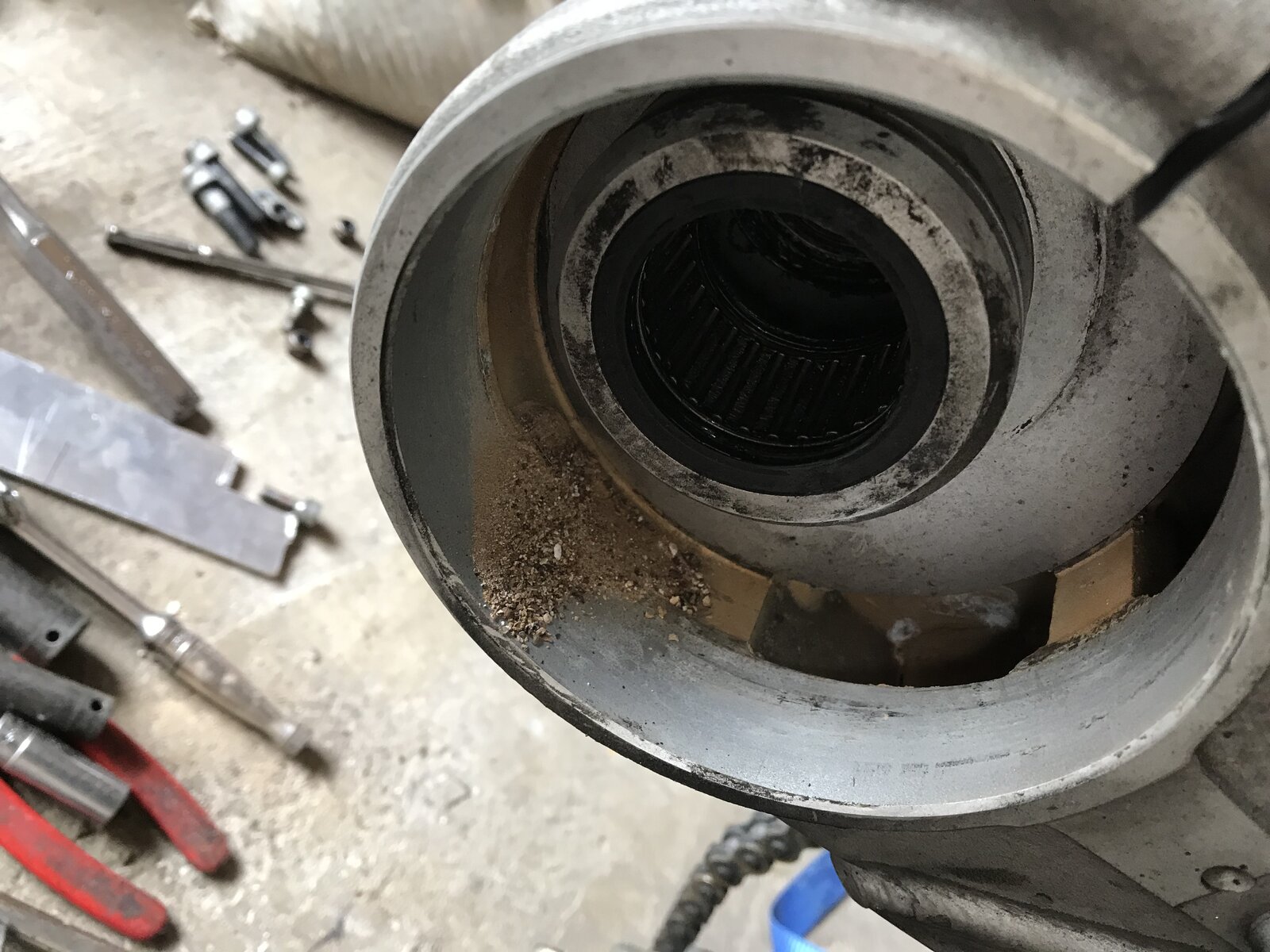

  16. I also found out after replacing hub bearings and putting spindle and wheel in and just nipping up the hub pinch bolts fairly tight, I had play when rocking wheel. It was only after I had torqued the pinch bolts up to 31Nm the play disappeared, so must have compressed the hub and the needle bearing. Also, before you put in spindle repack with this grease, also recommend by Moto Rapido.

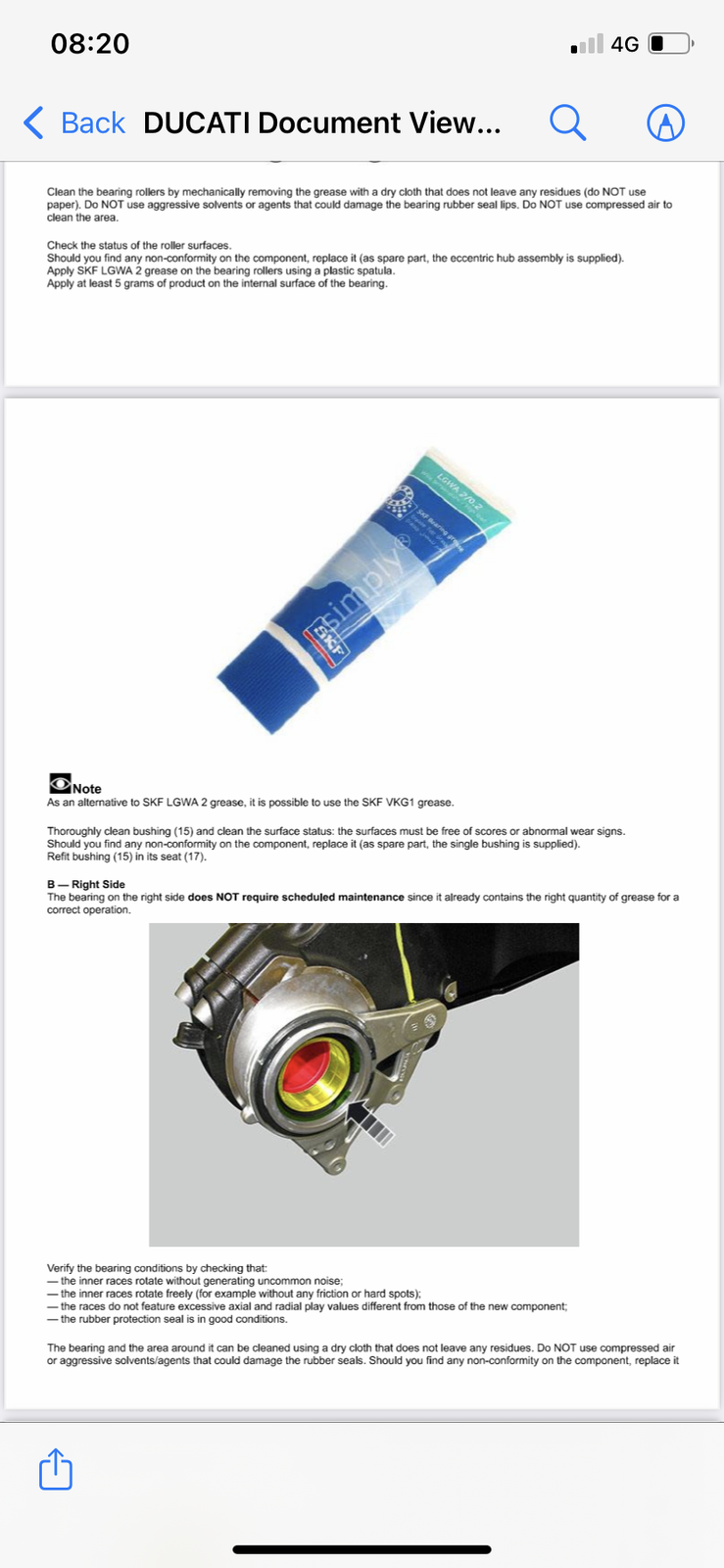

  17. This is the grease for the needle bearing on the r/h side sent from Moto Rapido, not the same bike but same principle/bearing type.
