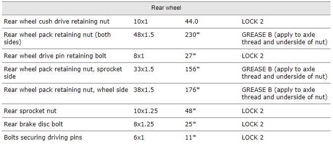

  4. Yup - 176Nm wheel side & 156Nm sprocket side. Modern smaller-axle figures - same as my Hyper939.
