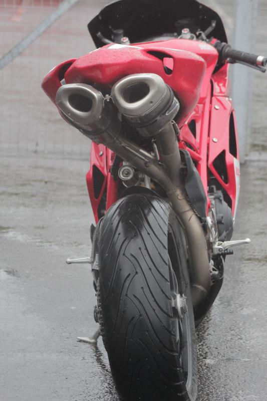

  18. Finished off the bike earlier this year,the only advise i would give is if you have the budget sort out the suspension as the standard set up is not the best,no matter which way you go make sure you get it set up by someone who knows what they are doing.Spec as it stands,Engine ,cams dialed in,termi end cans with ecu and air filter,throttle body's balanced and mixtures adjusted,Renthal rear sprocket carrier,14 tooth front sprocket,gb racing full protection cover kit.Suspension,bike laser lined to check it was straight,front forks rebuilt,rear shock ohlins ttx,ohlins steering damper,rear ride height adjuster,full suspension set up.Body work,crc full fairing kit,front fork sliders,bar end sliders,rizoma rear sets,carbon swing arm cover,hel front lines,sbk front pads.Running Metzeler racetec tyres k1 front,k2 rear.Very happy with the finished bike would like to add a slipper clutch and k tech fork internals,but i am thinking of selling it £5.5k as is or £4.5k without termis and ttx !.Alot of the important work carried out by the guys who know what they are doing with Ducati's so you know its right :upyeah:
