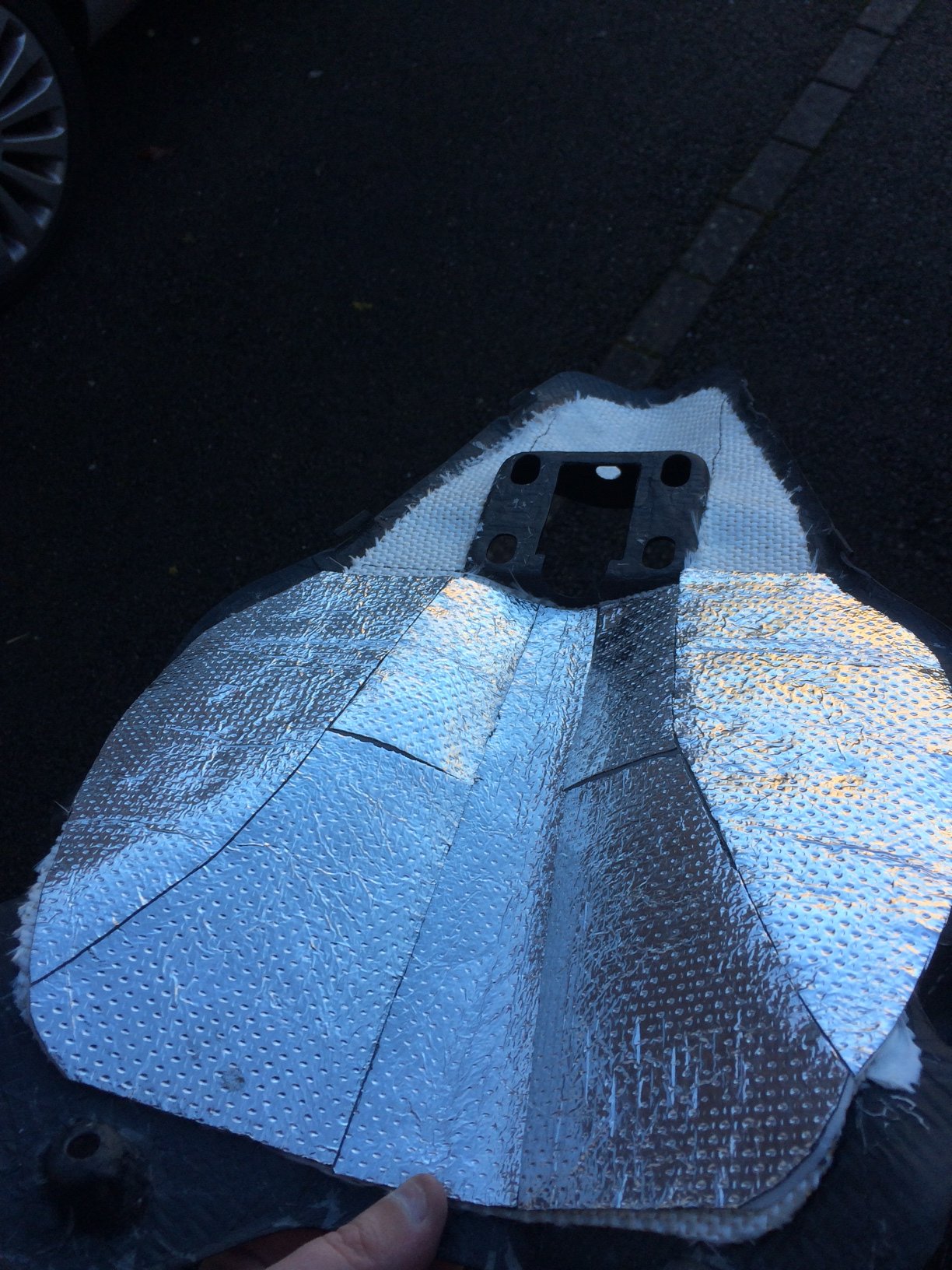

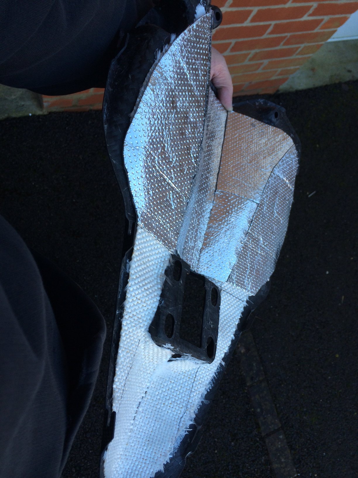

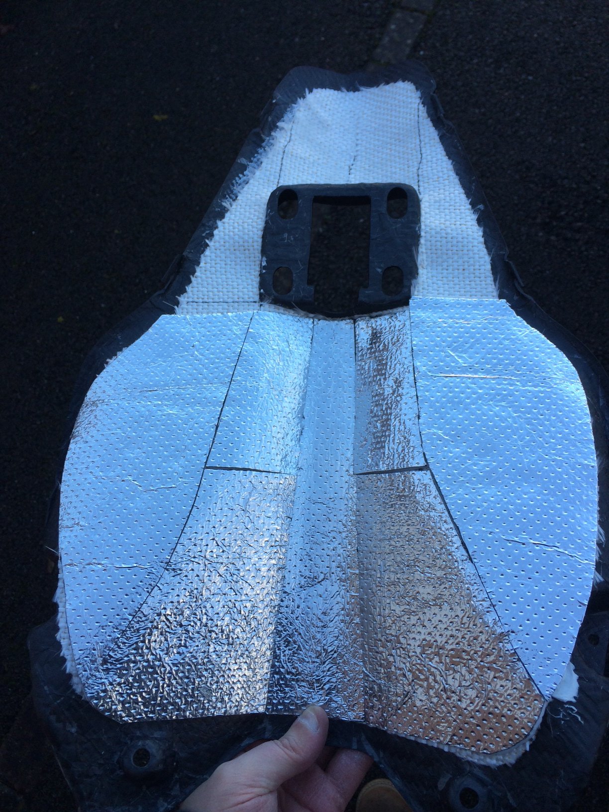

  9. When i replaced the undertray on my 1098R with a carbon fibre item (never again), i fitted the TPO heat-shield kit, which i stuck down with a heat-proof contact adhesive.
    Underseat Heat Insulation
    Then over the top of it i stuck down some thicker self-adhesive heat-shielding material i got off eBay for a few quid from a motorsports shop. I cut-out the general shape of the TPO kit, and then sliced the thicker stuff into smaller pieces so it would take to the shape of the undertray a little better.
    The result?
    No cooked love-spuds........even with the 70mm Akra system toasting away, my joy-department remains thankfully intact and cool as a cucumber, sort of.
    Took a while to do, but boy oh boy was it worth it!
    Pictures enclosed of the work partially done.

  10. Argonaut, that's exactly what i was thinking of...thanks for the photos.
    Glad the 'spuds' are cool as a cucumber too
