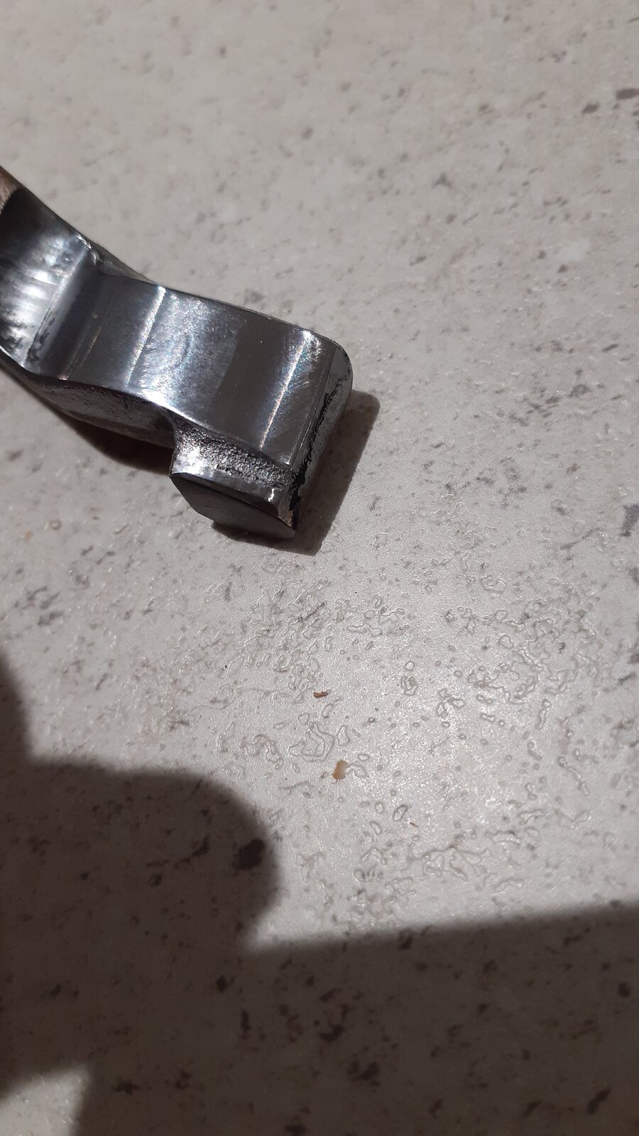

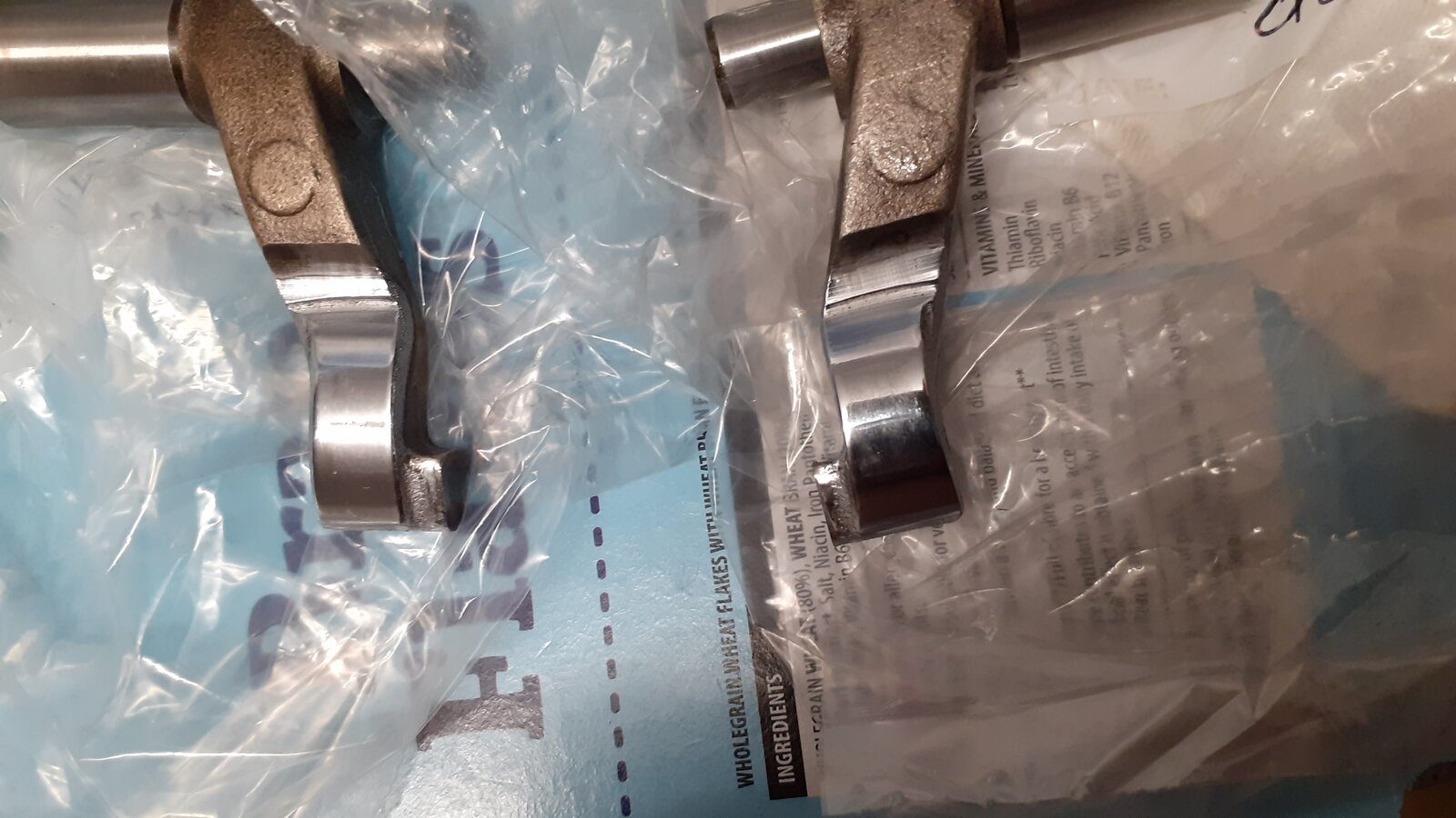

    Pulled the cams on Horz head and the opening rockers to inspect closers.
    There are a few dulled areas but only the one in the last photo on right which I posted before needs replacing, let me know any different. Forgot to photo opener will post tomorrow.
    Cheers Gaz

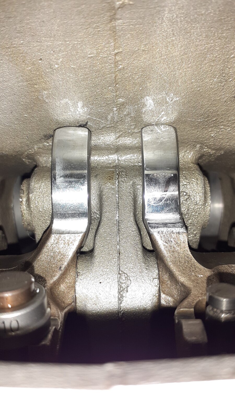

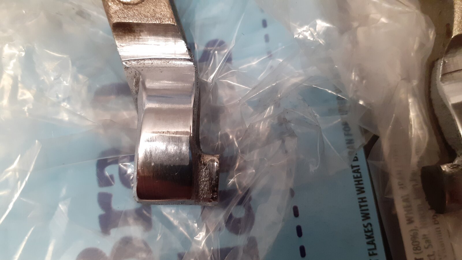

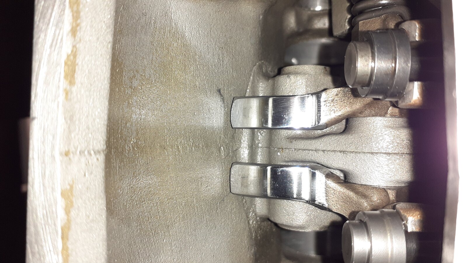

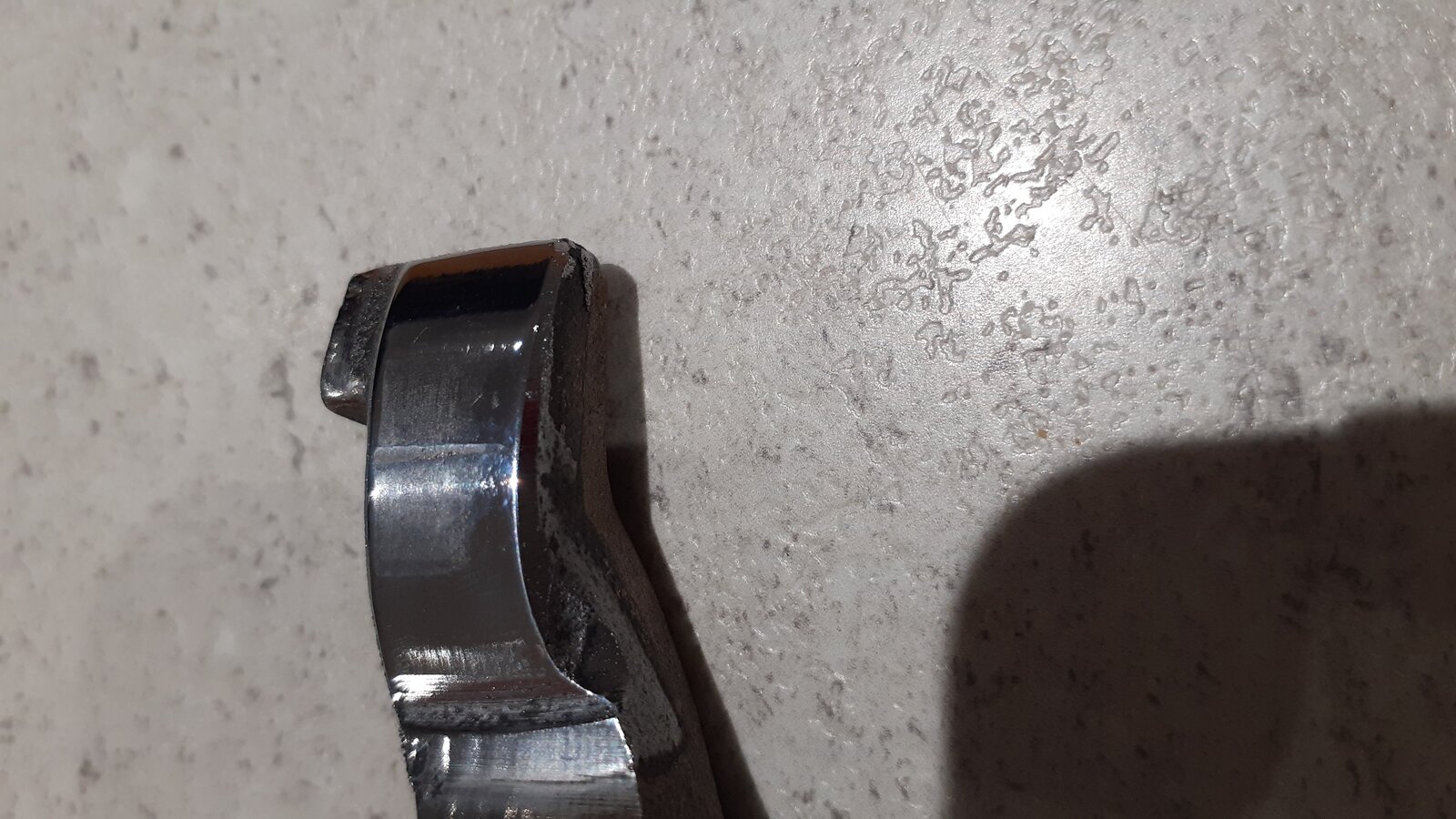

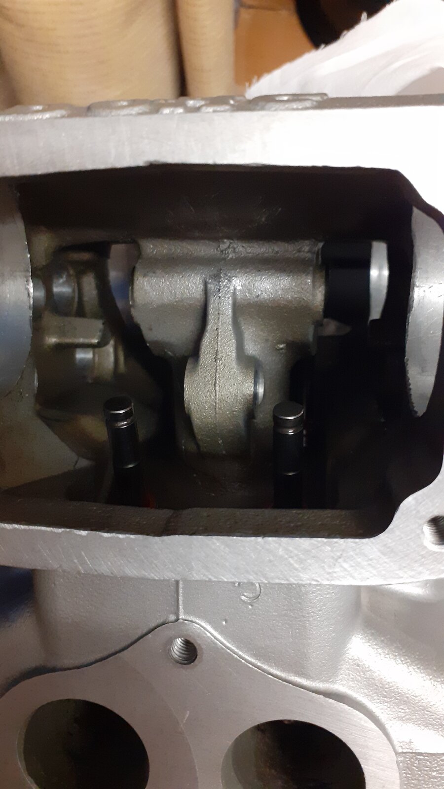

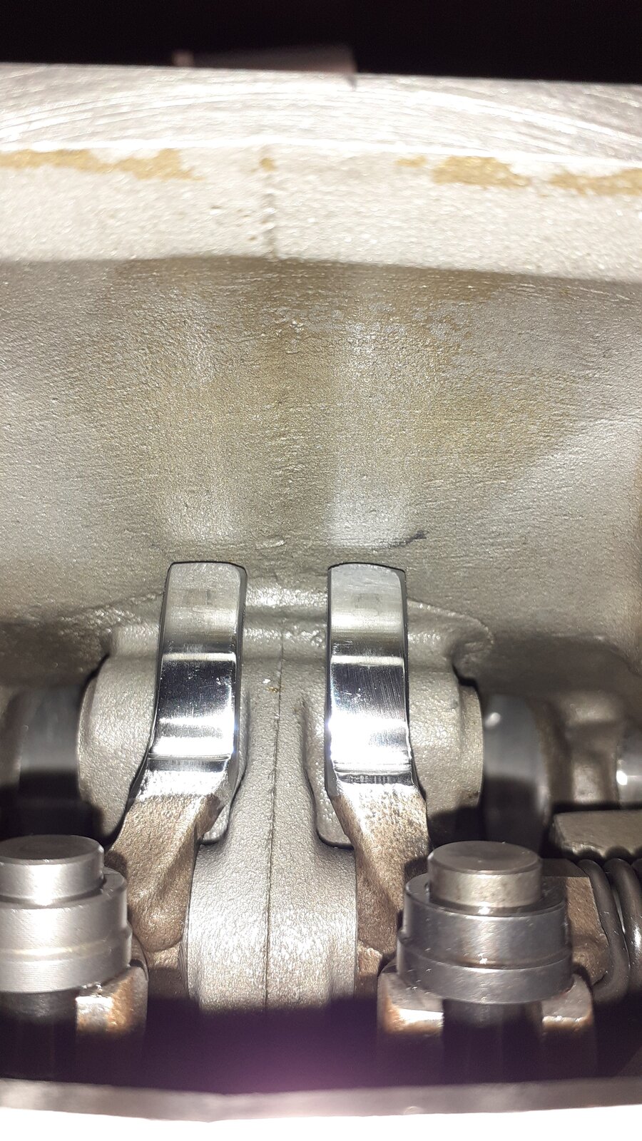

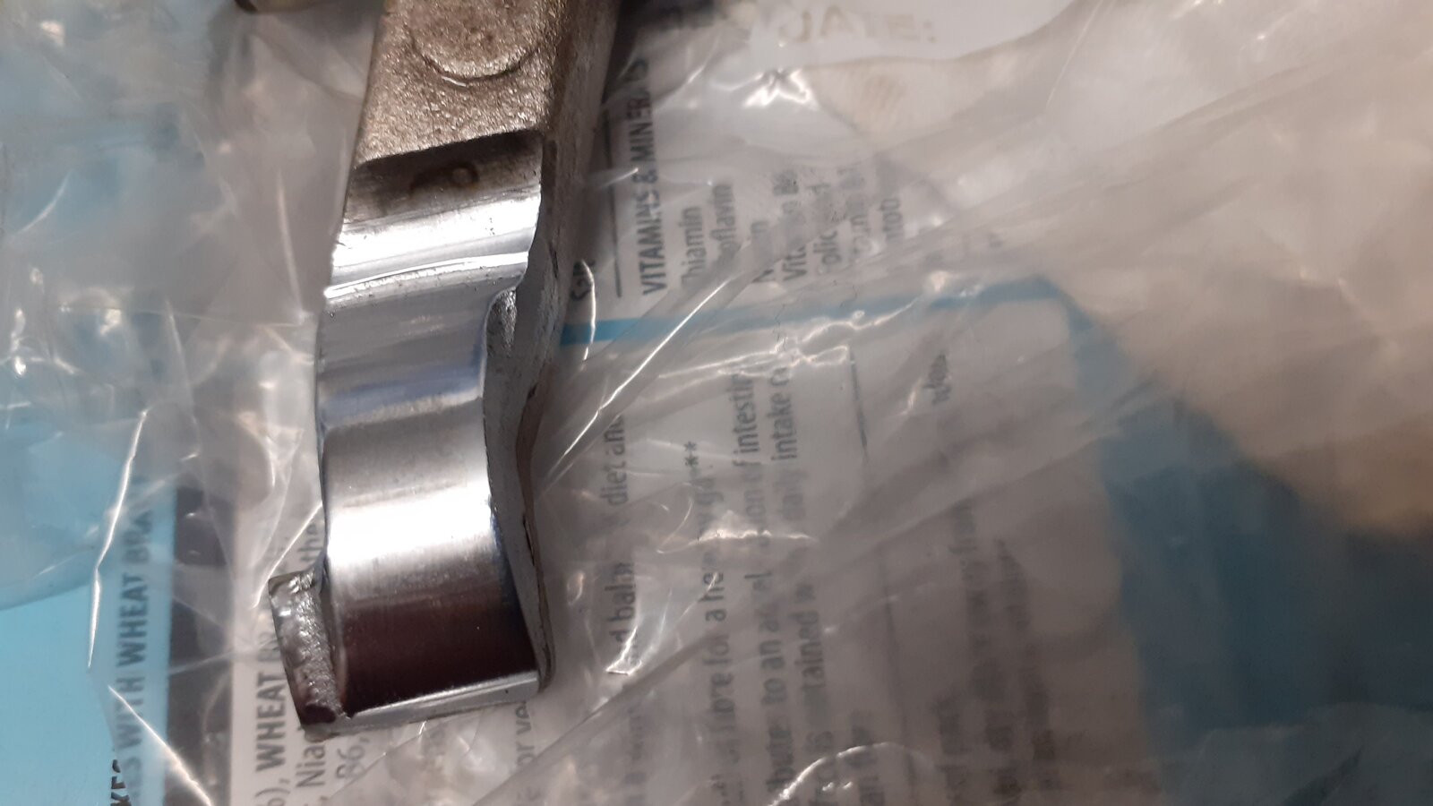

  7. Horz head opening rockers. There is one I am not happy with possibly 2.
    I think first photo ok. Second photo, not happy with one on left, one on right could be OK, 3rd and 4th pics closeups. Would appreciate thoughts.
    Cheers Gaz

  10. I had quite a few knackered ones that I'd collected over time, (none of them from my own motors!) I had sorted out/reclaimed by Newman Cams, it was a LOT CHEAPER when I had this done. They brazed Stellite pads to them then ground the correct radius, they now weigh a small fraction more but should be completely "Bullet Proof".

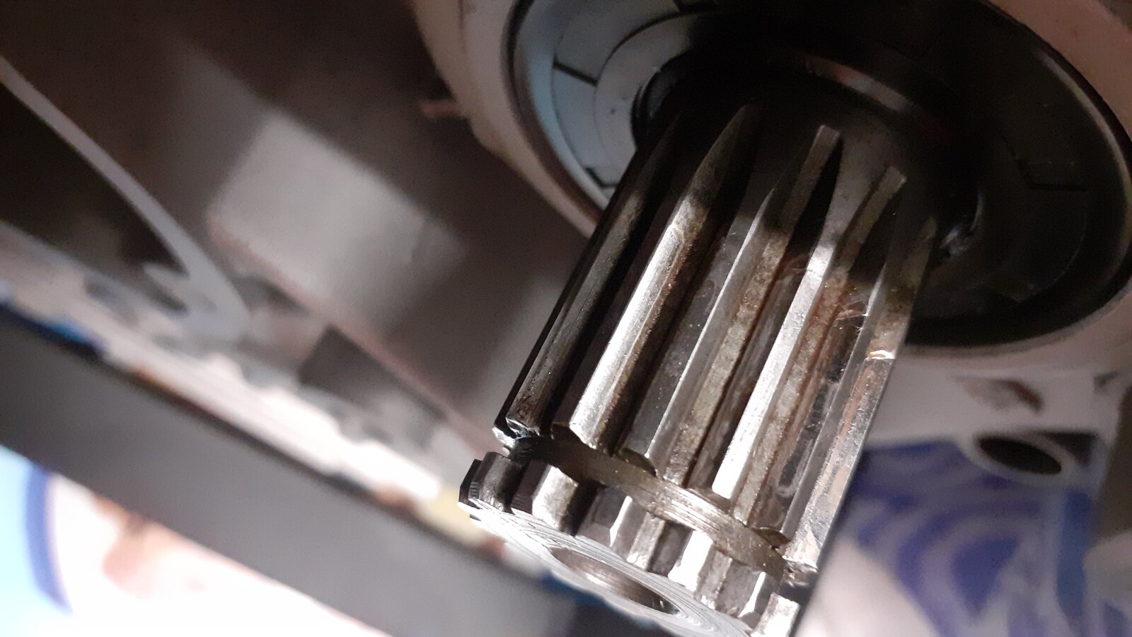

    Jimmy, I think generally it's OK and I am quite happy with it. I think on my part I could have looked at it a bit closer at the bits but most things are not bad for its age. The heads and engine were built in good condition but I am bit disappointed with rocker condition and the splines on the drive shaft. So from something I was given the impression of it just needs bolting together I have some extra expenses and work to do. Don't mind the work not so the expense. But you live and learn and like I said should have looked at more in depth. So at the moment I need some rockers, a final drive shaft the sprocket is too loose on it as there is some indentation in the splines, and fork stanchions need replacing. Apart from a few bits of plastic that could have been better, it's not bad.

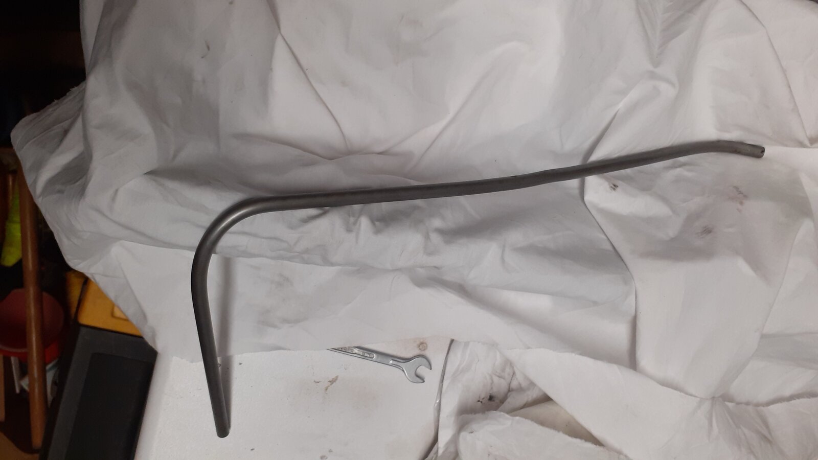

  17. Rubbish day so decided to take all the rockers our of heads and have a better look. A few showed a bit of scuffing but polished up ok.
    Already replaced 1 closer and think this one needs doing. Picked a closer up for £30 but opener seem to be daft money £150, looks like this will have to be rechromed.
    Hardest part is getting spring legs off and back under the repaining post.
    Read various stuff on bent screwdrivers with slots in. I had some thickish tube which worked OK. Might knock something up a bit more stylish.
    There seems to be (which makes sense) springs with straight legs and springs with bent legs. Straight legs put in first and goes up against the side wall of head, and bent springs in second which go to the side of the straight leg. But you probably already knew that.

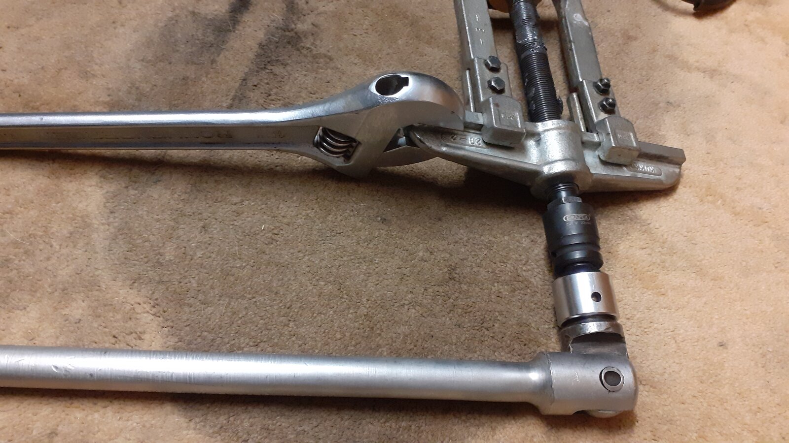

  18. Looking at the output shaft I was not happy with the splines, there are some indentations which I did no see this as the sprocket was on. Also when I turned the sprocket I felt there was too much play.
    So decided to split casings and replace.
    One tool in the Arsenal I did not have was a primary gear puller. Ebay replicas at £150 where a bit much, but managed to find this on ebay.
    https://youtube.com/shorts/HgZ6FuRGA6U?si=vNTtDDF6GvurQJIS
    It worked a treat. The plate was to stop the gear flying into threads, and I found some rubber to act as a cushion.
    It wasn't as violent as the one on the 900ss, maybe because I but a bit of heat into it first and it took less force to get it off.
    Cheers Gaz
