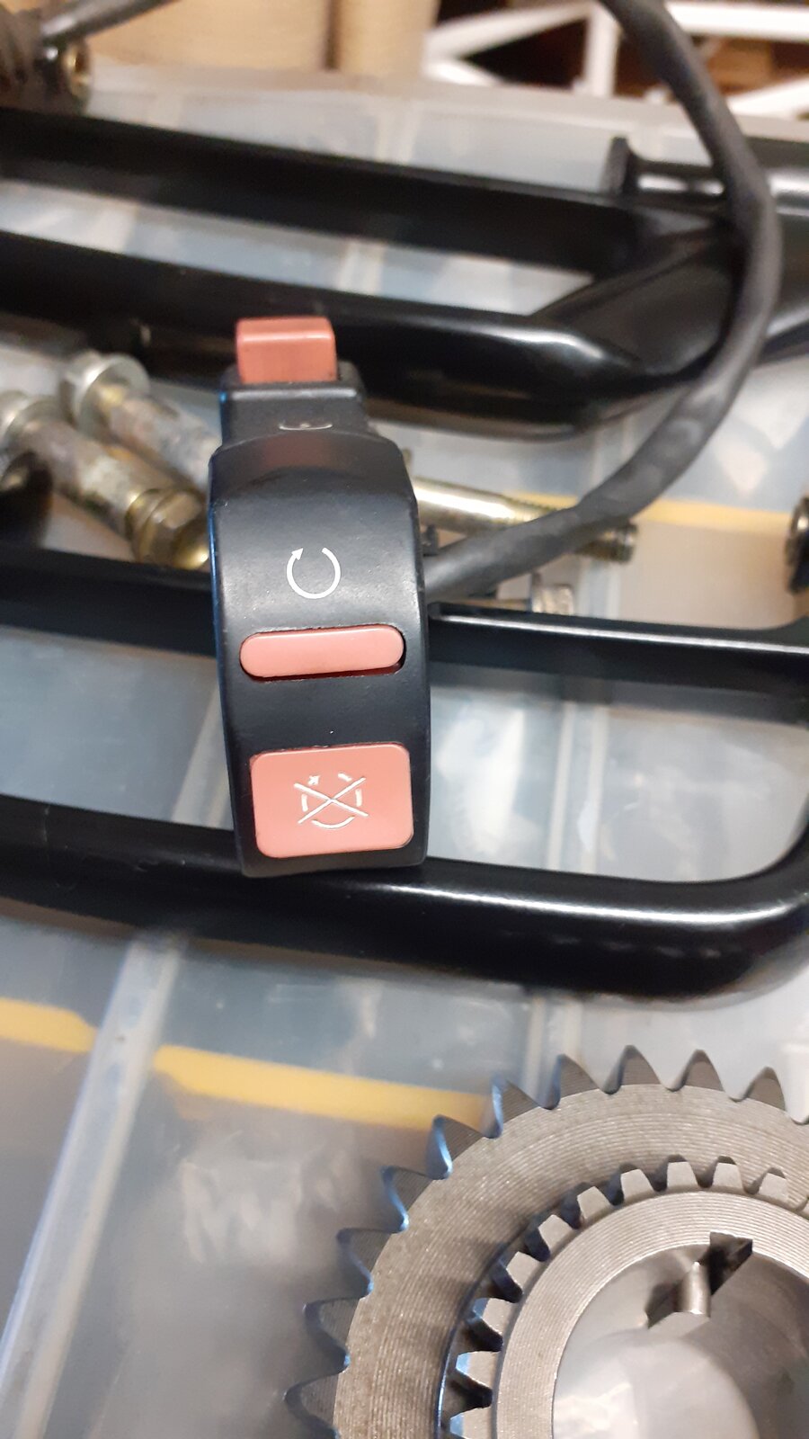

    Found this switch amongst the parts, can anyone tell me what it is, and does it belong on a 851.
    Cheers Gaz
  6. It doesn't belong on an 851. Possibly off a later Ducati. Looks like a start/kill switch. Your 851 will have the same kill switch as your supersport.
  7. Yes thought so thanks for confirming.
    Cheers Gaz
  8. Looks the same as what is on my monster
  9. Thanks M nine, will put it to one side, at least that saves me from trying to fit it somewhere.
    Cheers Gaz
  10. It's also on the ssie models.

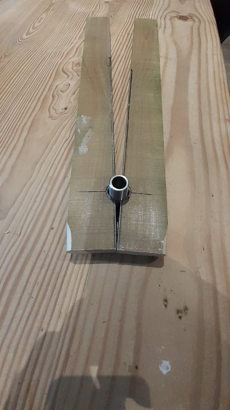

  11. I hvaen't found any problems splitting the cases that have been threebond sealed. I have found iy an absolute b8gger to remove.

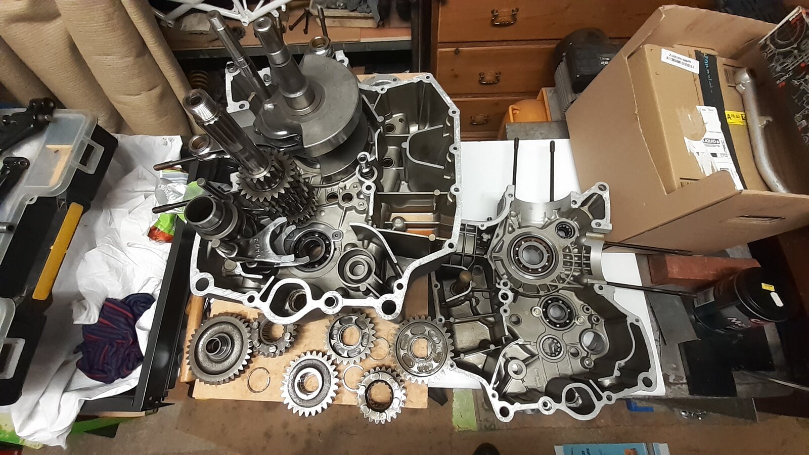

  12. I split them no drama with the help of patented casing splitter. Insert into cylinder bores and squeeze.
    Cheers Gaz

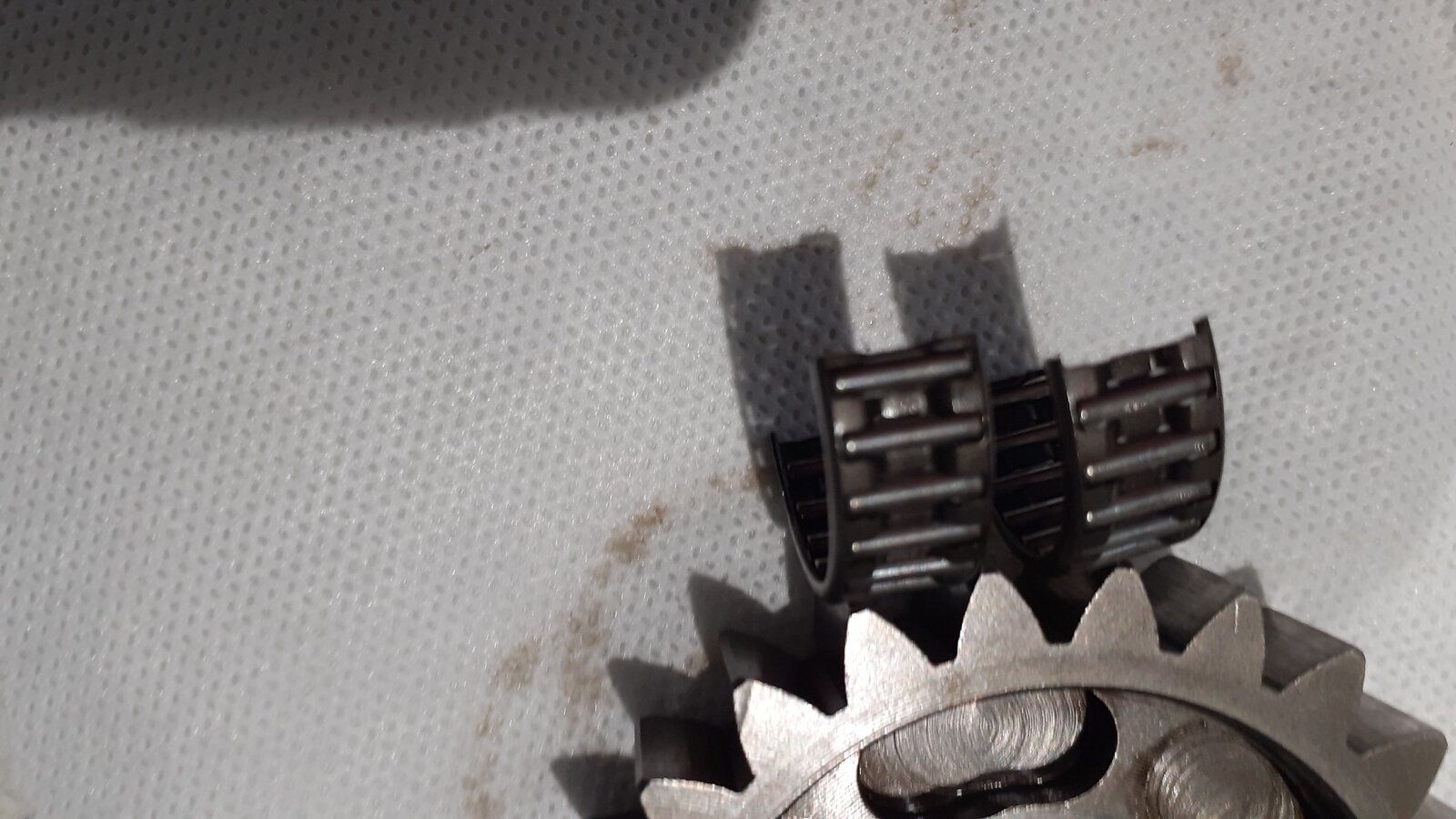

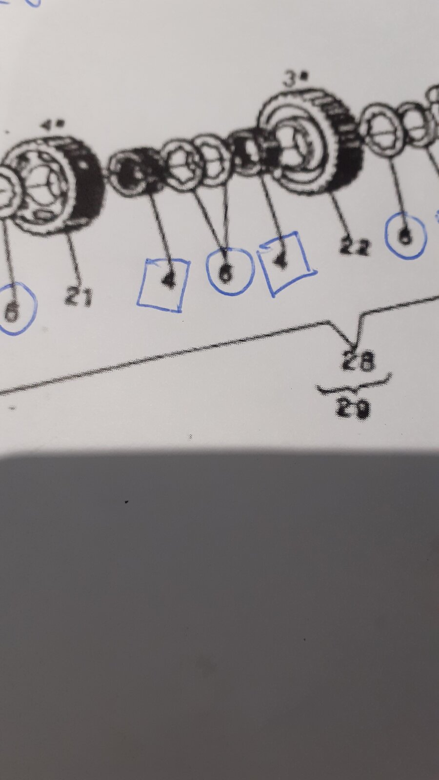

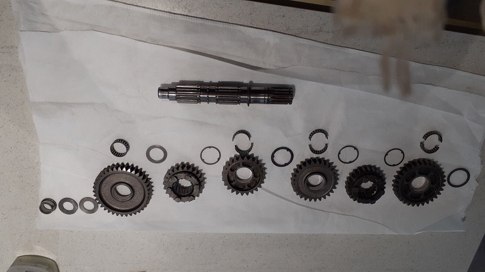

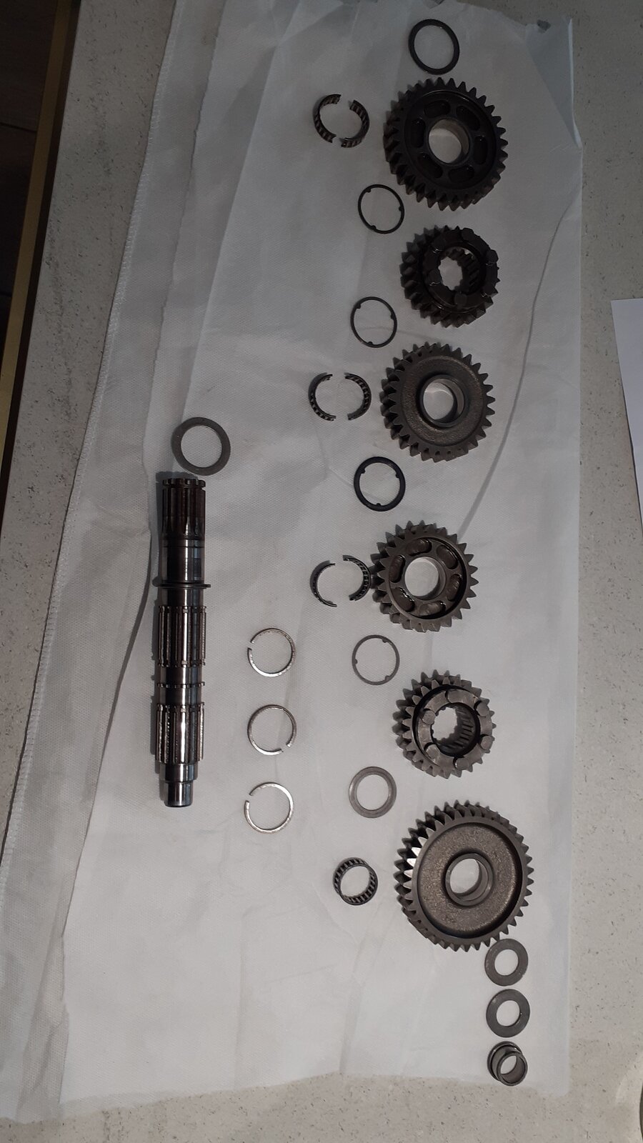

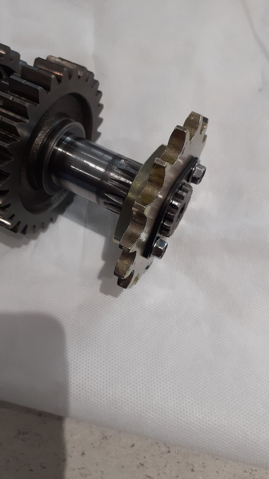

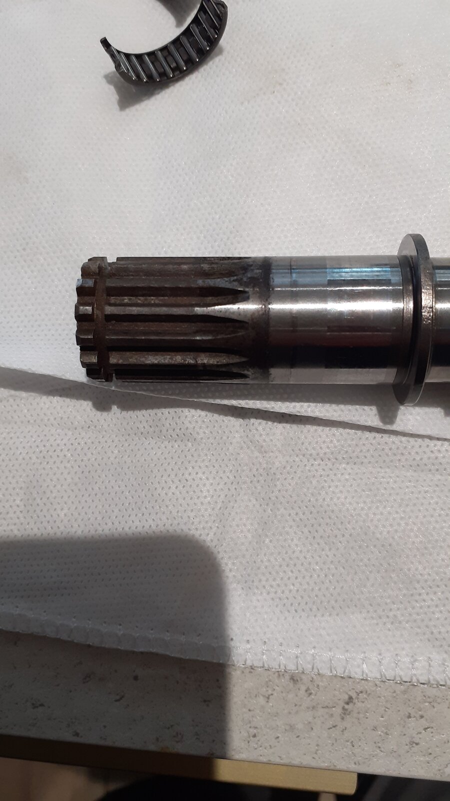

  13. A bit of progress. I was looking for an output / final drive shaft, saw a few with some other internals going for £150 ish, managed to pick same up for £45. It's the same as my 900ss and also discovered same as many 900 monster which this was from.
    It had some slight marks from the spline but I also picked up a new sprocket and it was a much better fit.
    Slight head scratcher, the diagram showed 2 washer item 6 in the middle but there was only 1, and on the new shaft it had a bigger o.d.
    So it when back together with just the bigger washer.

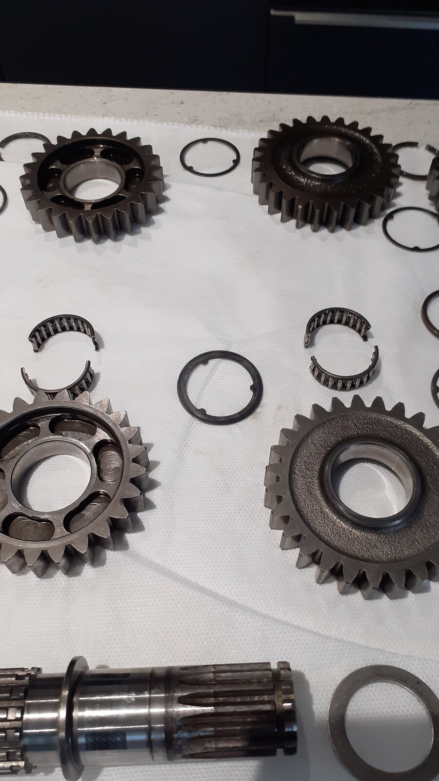

    Oh bearing ends are different, watch out and snap rings are a bit tricky.
    Cheers Gaz

    I wonder if there is a cross reference resource of what is interchangeable?
  15. Interesting - I've never seen split needle-roller bearings before (in ~45yrs of engineering experience). Useful.
  16. If you go on to www.bike-parts-ducati.com and search on the original part number it brings up a cross ref of all the bikes it is used on.

  17. Cleaned up shaft end a bit and new talon sprocket for a £10 er.

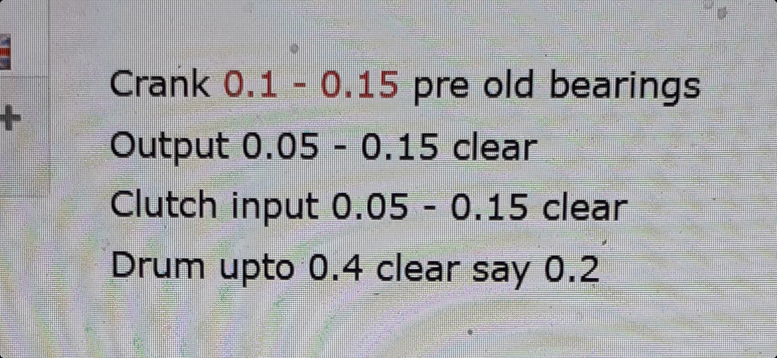

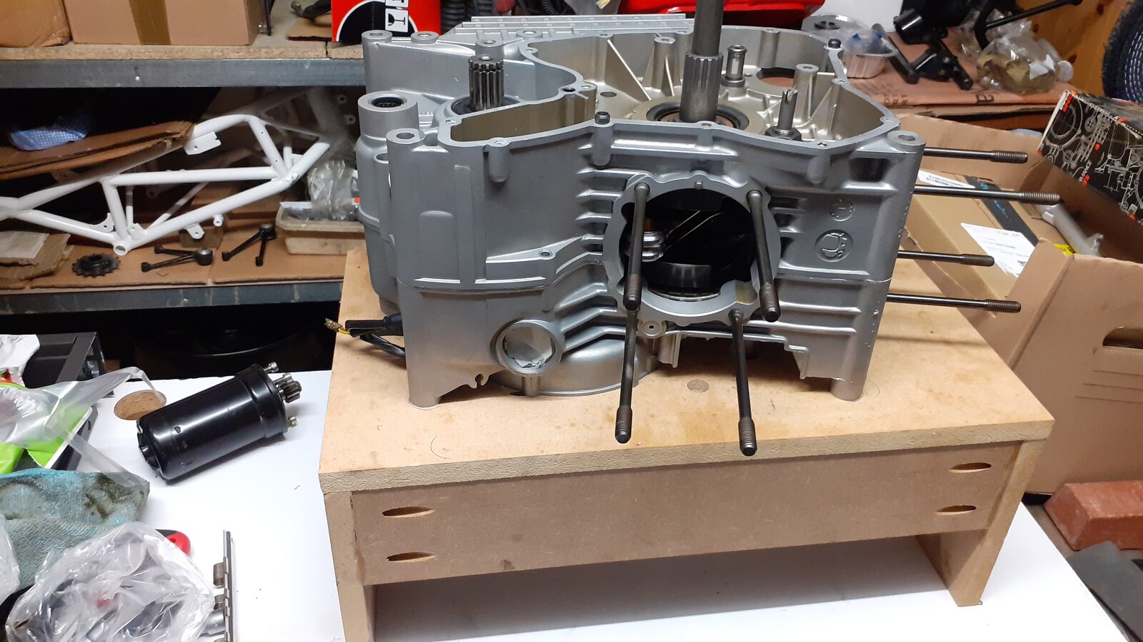

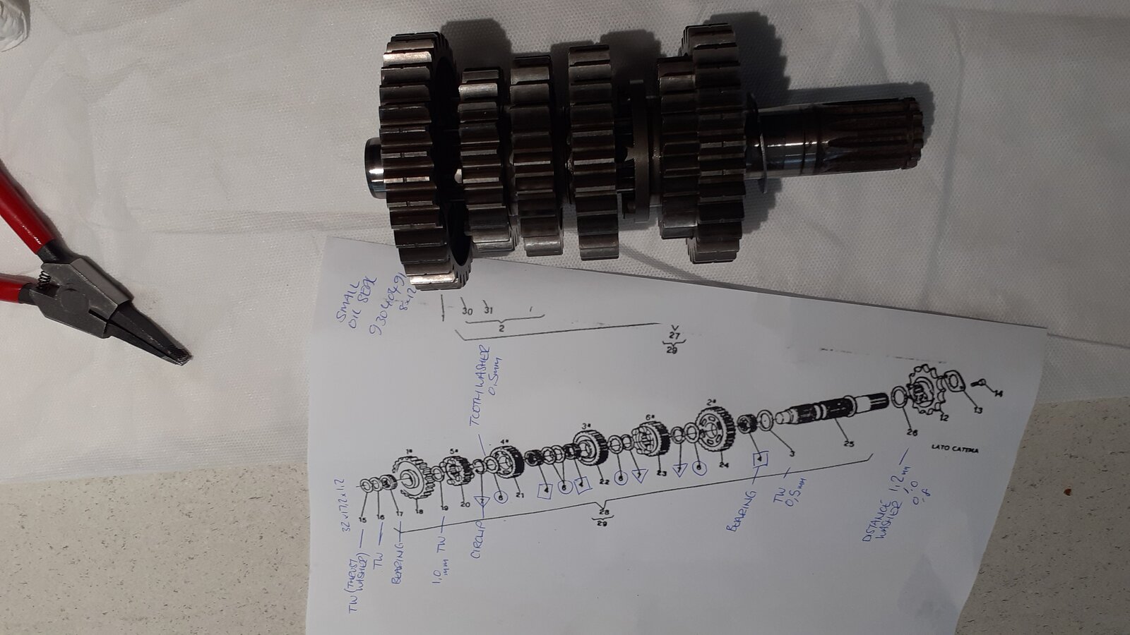

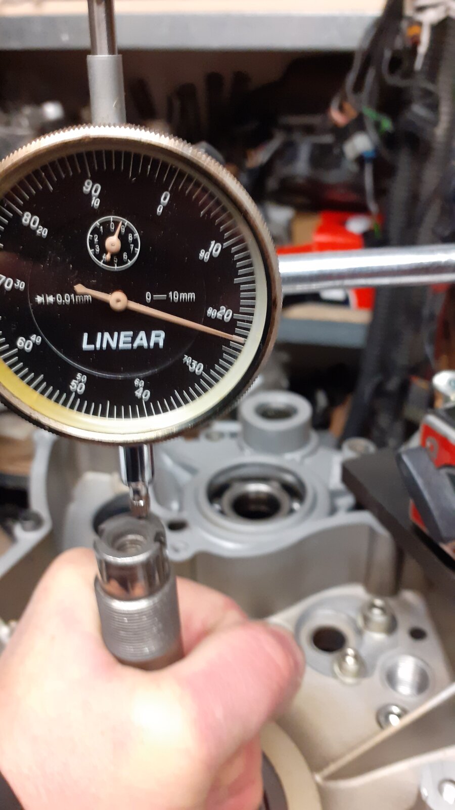

    Took everything out of casing and put in unshimmed crank. There was a 0.5 and a 0.2 on each side, 1.4 total. Bolted casings back up and got 1.25 /1.23 end float. So pre load is about right at 0.15/0.17. It felt a bit tighter than my SS but they were reused bearings.

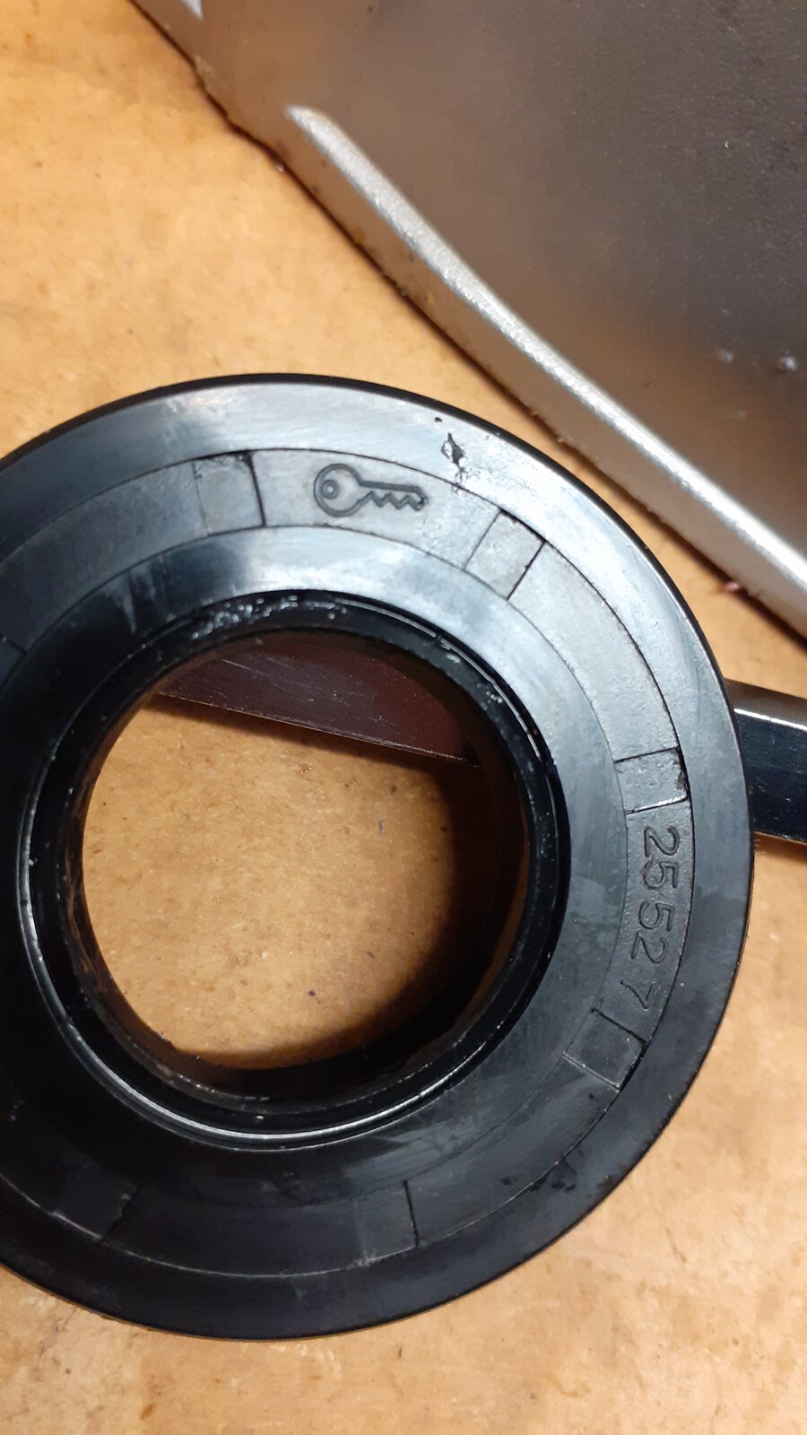

    What is this seal brand like, Key brand or possibly New Key. It was new but thought it looked a bit cheap so pulled it out
    Oh, casings had 3 bond, I think I am going the gasket route as 900ss.
    Cheers Gaz

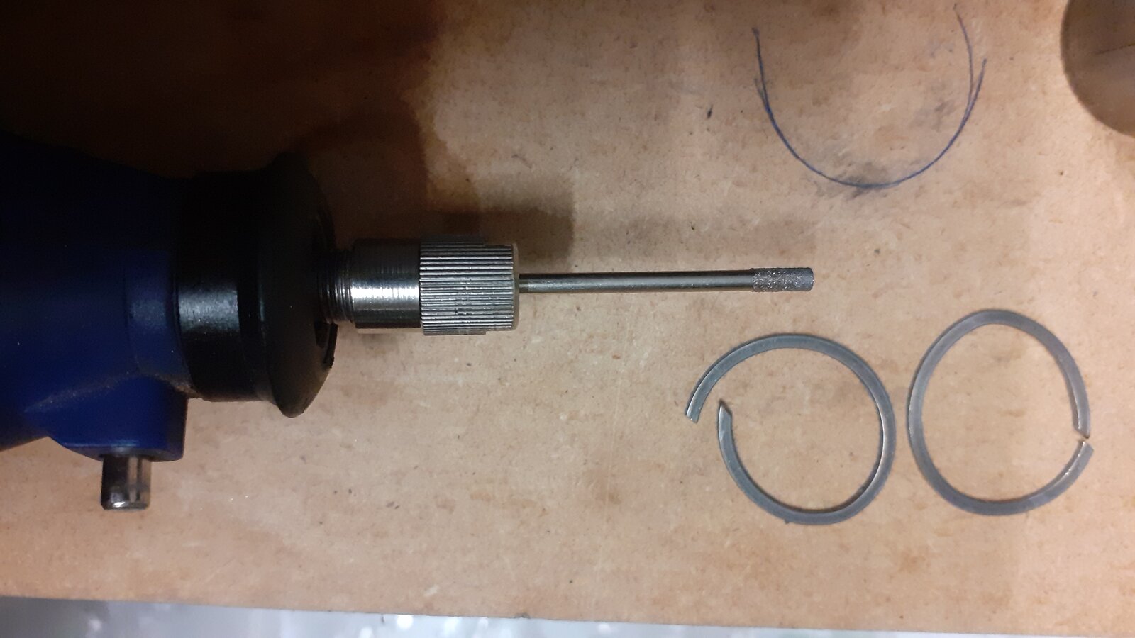

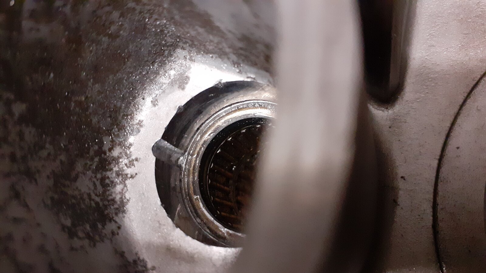

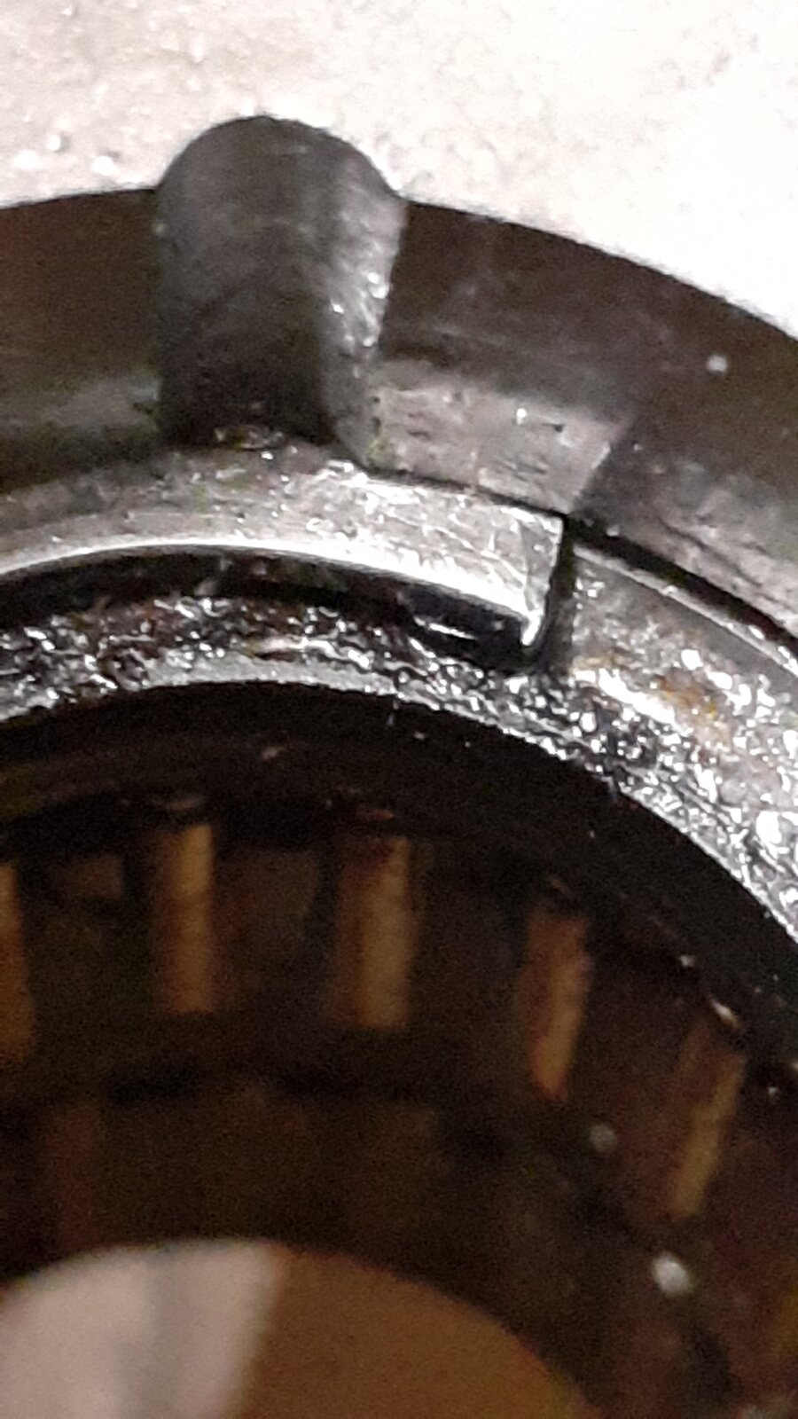

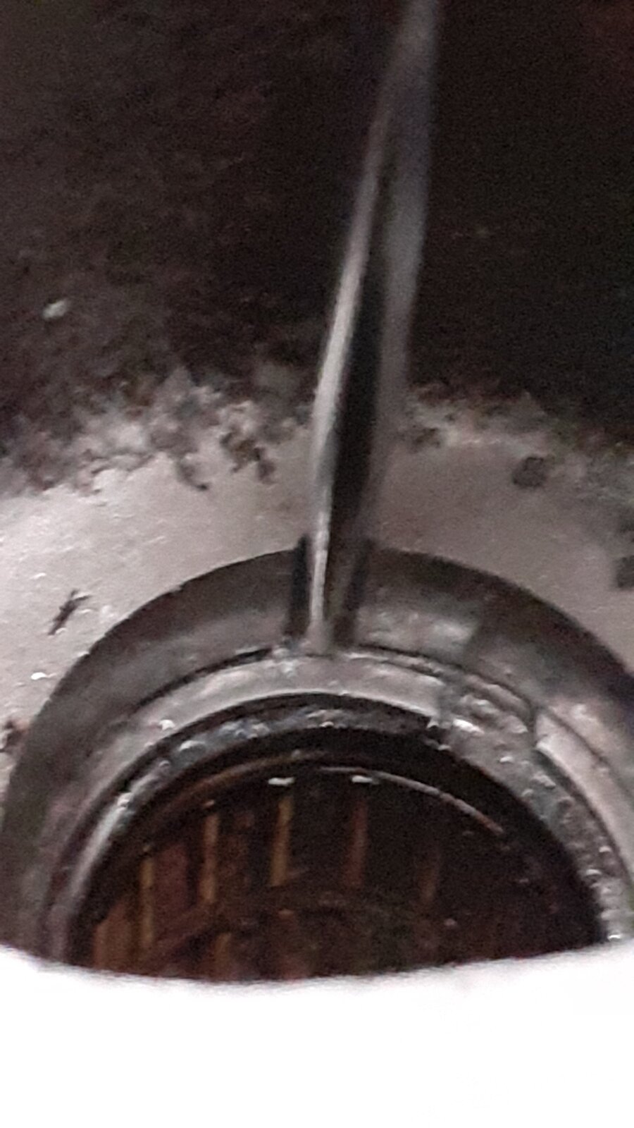

  18. Just some figures for planned preload end float. I used these in the 900ss reno, any comments appreciated.

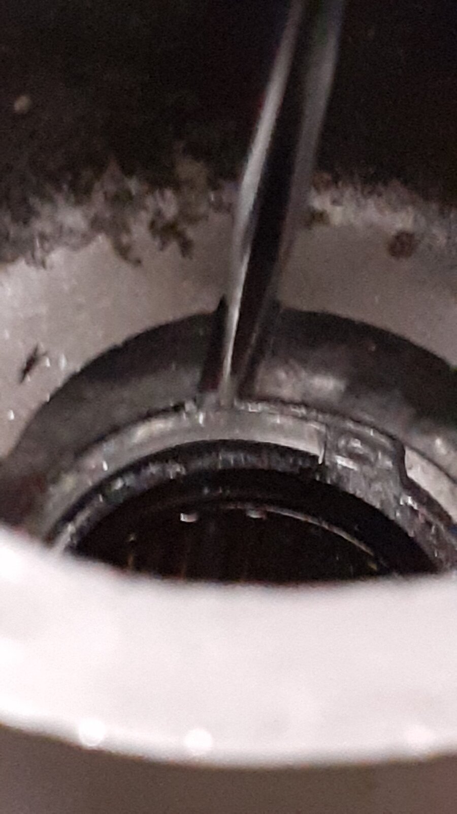

    It's been at the back of my mind for a bit but I haven't been conviced the swing arm bearings and seals have been changed. The grease looked a bit old, and in the internal pocket the casing has not been aqua blasted, which suggests to me the bearings were blanked off for cleaning.
    Anyway, I can't put the casings back together without changing them. l am glad really because it made me think of a different approach.
    By far the worst job on the 900ss reno was getting these bearings out. I made a few picks to try and hook the clip ends out, but it did not really work. I then thought modify the casing, I don't really like doing things like this but thought in this case it was justified. I made a half round slot in the thicker part of the casing to intercept the clip groove. By doing this I was able to get a pick round the back of the clip and bend it in. Then put in a bigger screwdriver and collapsed the clip in moving it around as I went. Try and keep it bent on the same plane so you don't damage the groove rather than bending it up.
    Mechanically I can't see it affecting the performance of the clip, and it makes changing the bearings a lot easier.
    Thinking about it after I remember seeing something like this on the piston gudgeon pin clip, it must have been subconsciously lurking.
    Cheers Gaz.
