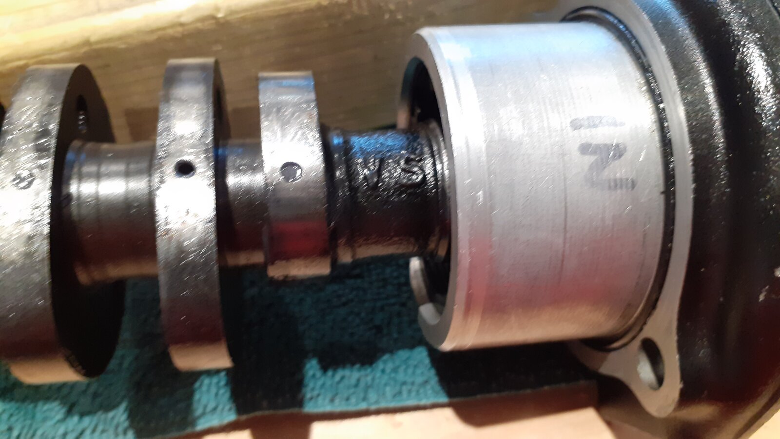

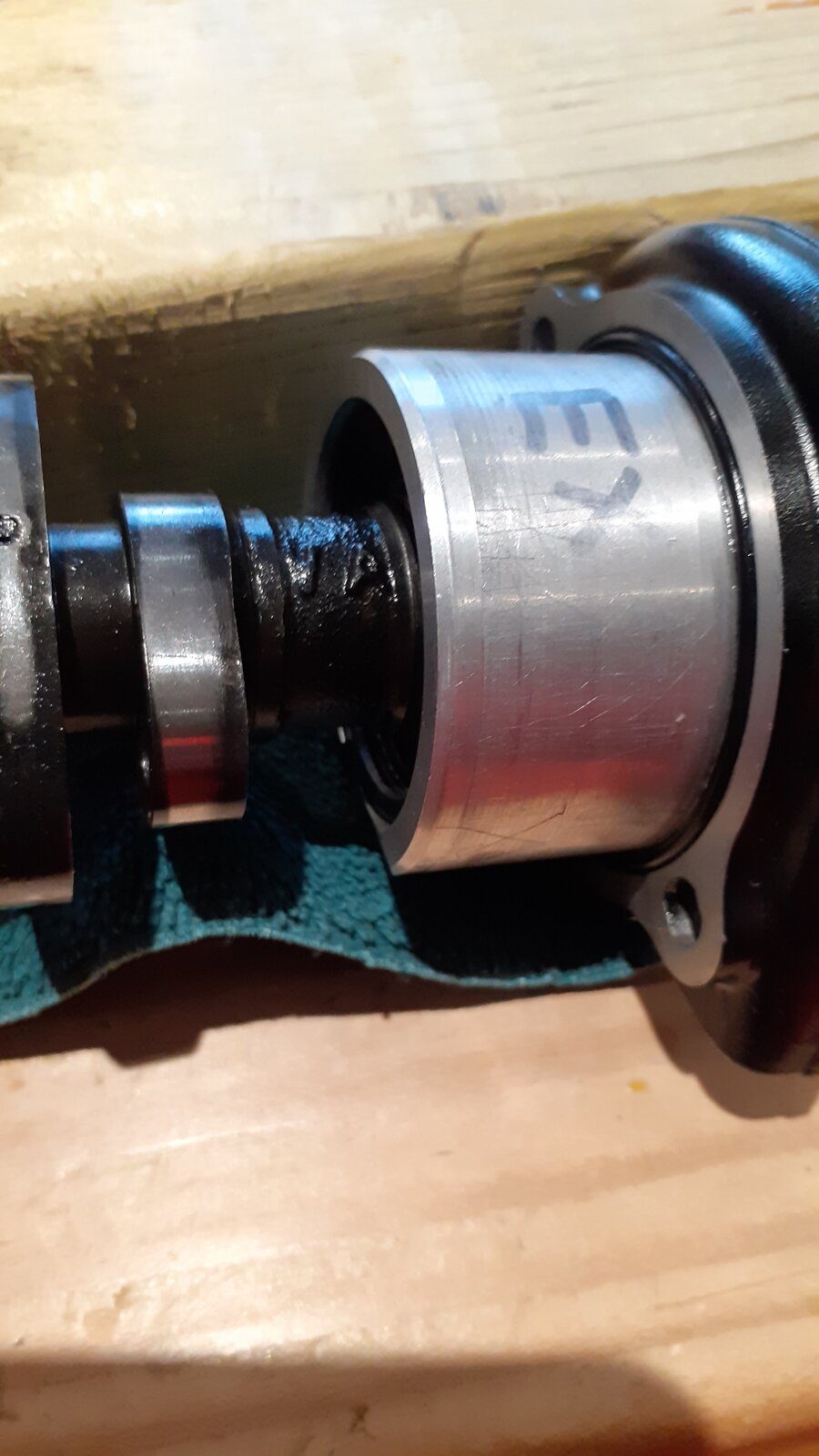

  12. So I think as Guillaume said be mind full the collets may not be seated correctly, I am sure this was the case at some point during the proceedings.
    Anyway, after replacing a shim on the Horz head the cam now fully turns.
    On the Vert the problem was the cams where the wrong way round. Someone had marked in black pen on the ends and that's what I was going on. While looking at a cam on the table I noticed the cast markings and realised the the problem.
    Iam sure you know but will say in anyway A aspirazione Inlet, S scarico Exhast.
    Not sure way it did not depress the valves, answers on a post card.
    So need to measure some clearance now.
    Cheers Gaz.
  13. The most important thing when putting these cams back is to make sure the oil ports are facing each others (cam to head).
  14. Yes, I did notice that thanks.
    Cheers Gaz
